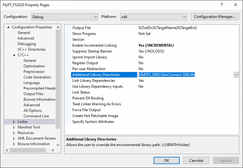

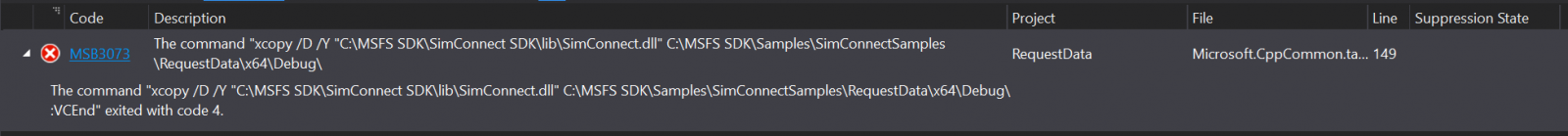

    thank you very much. I reinstalled the SDK (again) and now finally found the folder in C:/MSFS_SDK
    I wasn't able to compile the "RequestData" project. It complained about something with the build target...
    Does that ring a bell with you?, because I am clueless.
    However, I was able to compile C:/MSFS_SDK/Samples/SimvarWatcher. A WPF app that allows you to watch and set certain variables inside the sim :) I think I can learn a lot from this. At least now I have the feeling I am digging in the right direction :)

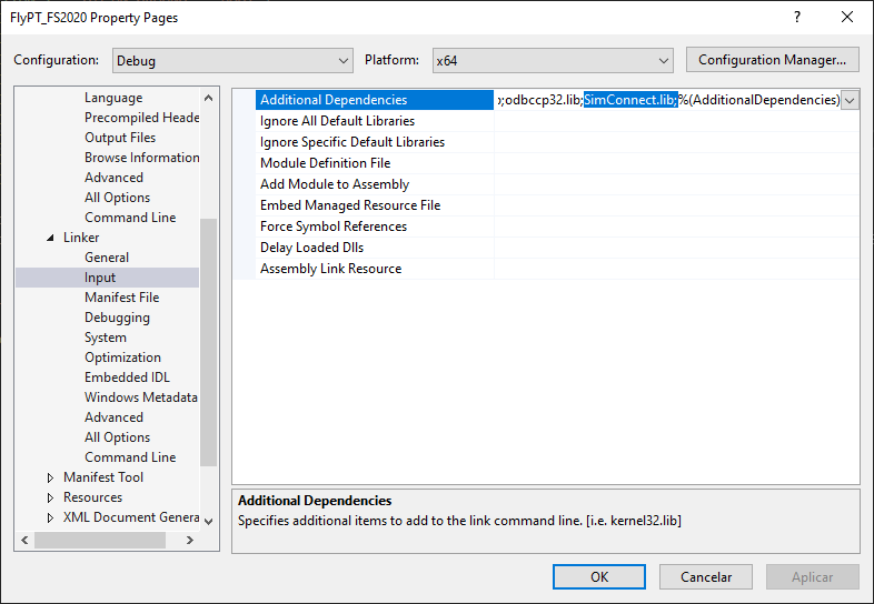

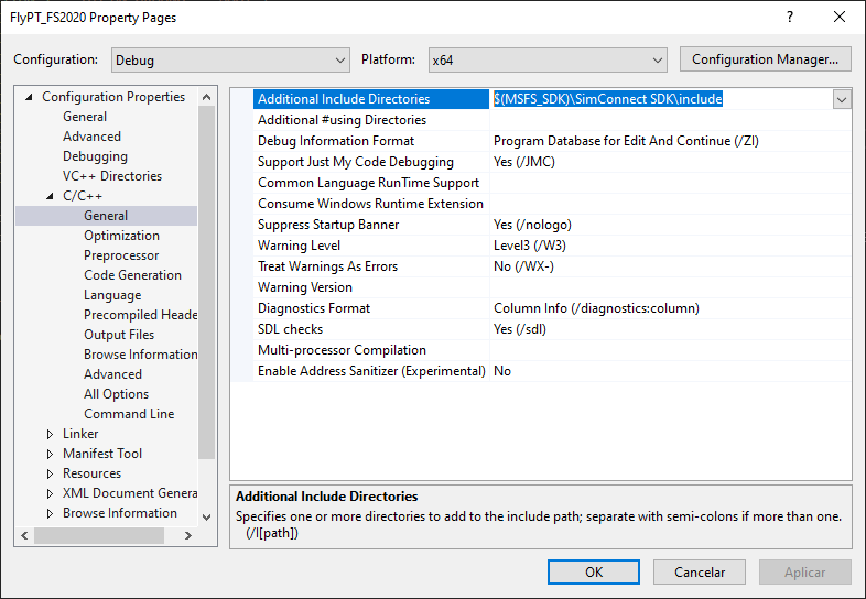

    Go to project properties and make sure you have this:
    And don't forget to copy the SimConnect.dll to the exe folder of the debug and release

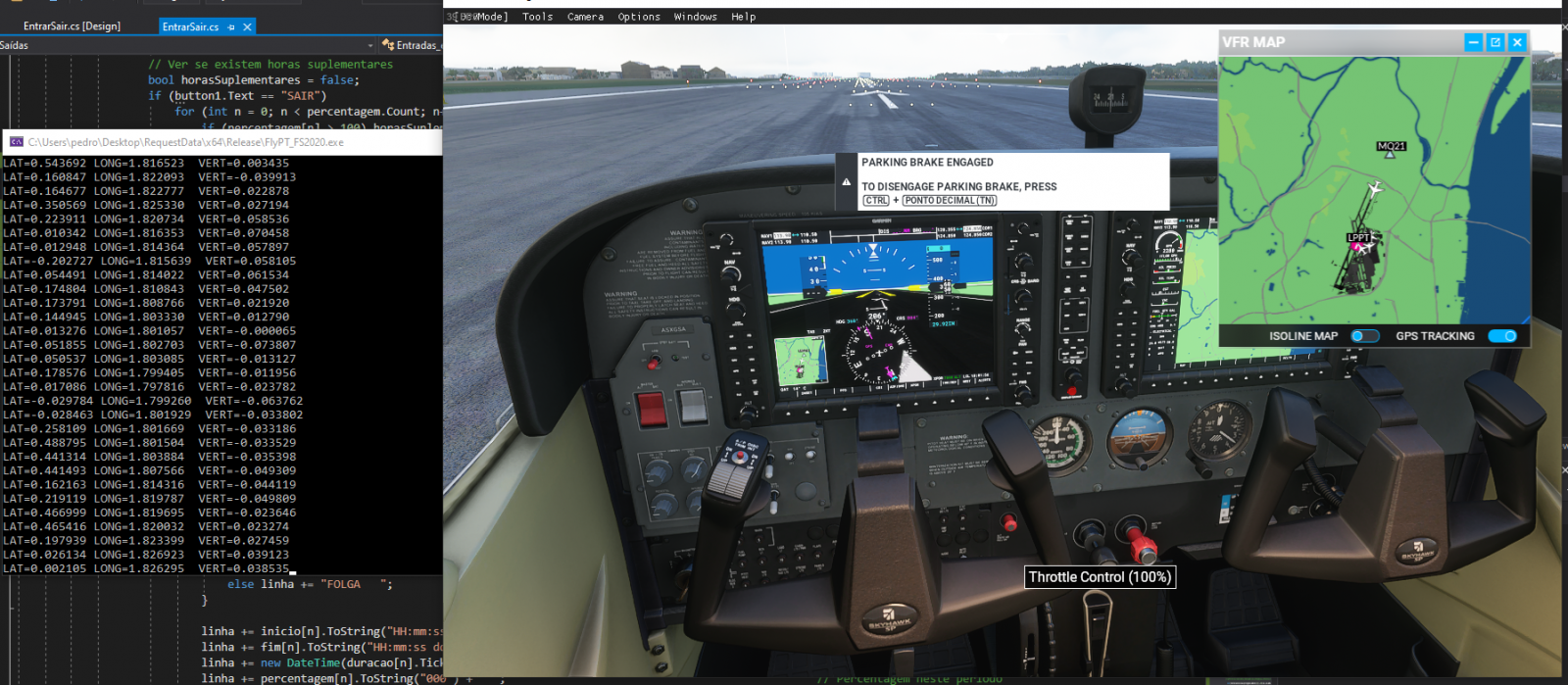

    So tonight, I decided to verify everything again.
    We never know... I find so strange that longitudinal acceleration.
    But it's there. I cleaned everything and data is direct form game, no Mover here.
    Took some shots this morning.
    Full throttle with brakes:
    Picking up speed (no brakes):
    Amazing how instead of progressing we are stuck 30 years back or even go back (PCARS3 :()
    (don't look at the frame rate 39fps, I have everything maxed just for testing)

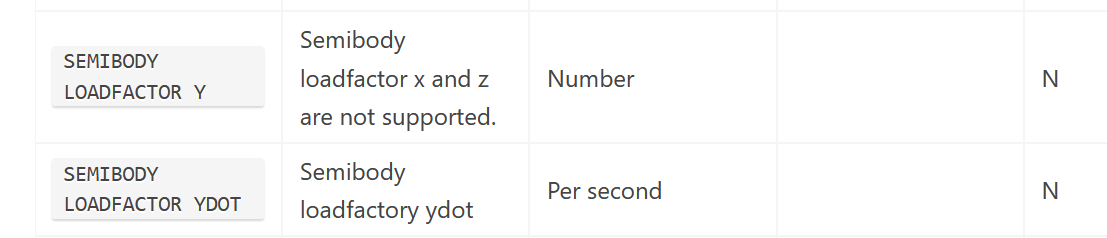

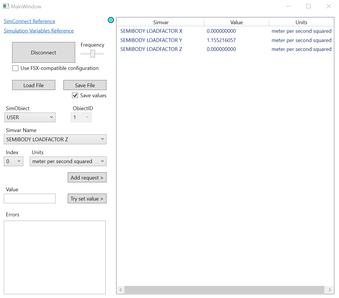

    I think I got it :)
    At least I got a trace!
    @hexpod sent me a link to an interview with the developers this morning and I was wondering why in the world they used the term "loadfactor". That's not a term I would ever use.... So I looked for a variable called Loadfactor in the SDK...
    And found it:
    At least vertical G,... oh sorry... I meant "SEMIBODY LOADFACTOR Y" is available. :thumbs The documentation stated that X and Z are not supported.
    Then I looked into the Sim variables directly and indeed, I found "SEMIBODY LOADFACTOR X" and "SEMIBODY LOADFACTOR Z" also.
    even though X and Z stay at zero, but at least they ARE THERE! I hope that they will at some point fill those slots with life.
    @pmvcda , can you check if those variables are also available in FSX/P3D? If they are NOT, it means that they have added them specifically for FS2020. That would be a good sign for the future.
    And if they ARE there already, then at least you can now use them for FSX/P3D
    What do you think?

    Yes, on SEMIBODY LOADFACTOR Y the gravity component is present. I don't quite remember which value it starts with, but while static on ground it has a value close to 1.
    As far as I tested it, it represents the vertical acceleration in the vehicle coordinate system during all phases.
    Try it out and tell me what you think.
