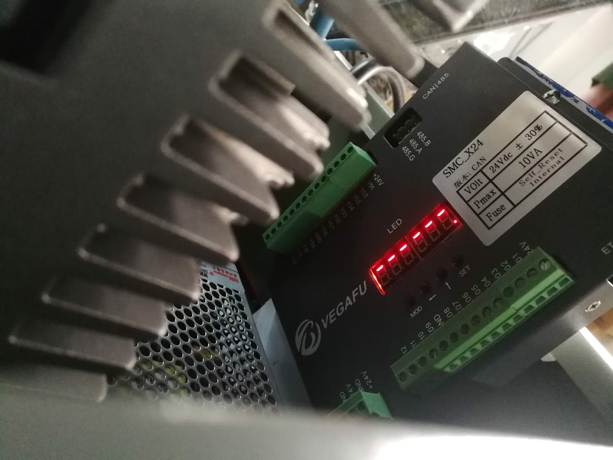

    I have project to program 6 DOF from China in C# program. I have experienced with Arduino and serial connection for Simtools's link but this new project I have to develop in C# program because I have to send Axis's data to Vegafu Controller and I have Vegafu Controller's protocol and example in C#. So I want to use Memory Map File in C#
    https://www.xsimulator.net/community/attachments/mmf_starter-zip.38136/
    My requirement is exactly like this.(this example from yobuddy )Axis 1-6 positioning data. But I need to convert to C# programming . Could anyone help me to convert it or explain this program work. I very newbie for C# programming.

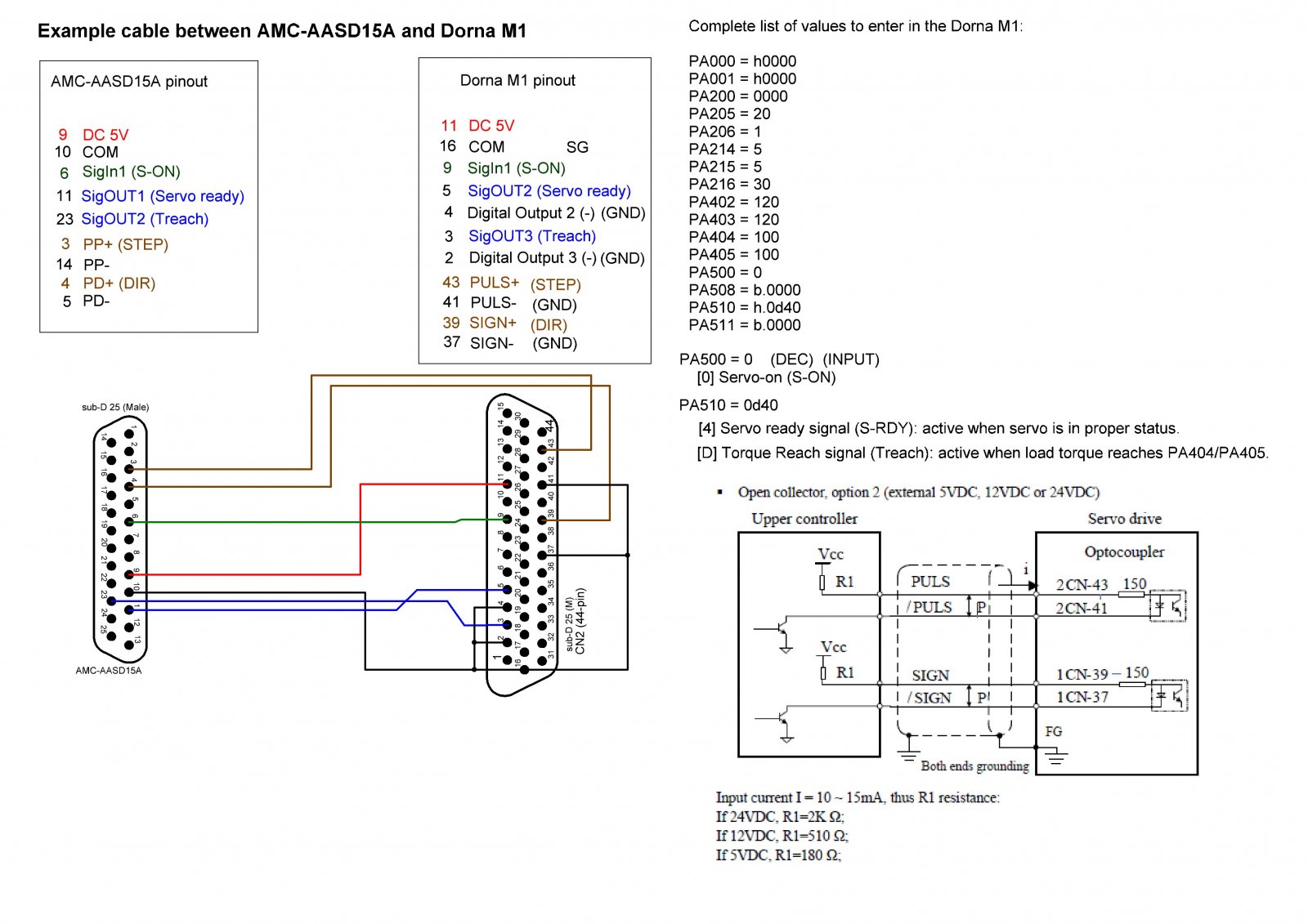

    Ahh, good luck with that... no-one was able to use that code they give for the vegafu is garbage.
    I'd suggest looking into bypassing the vegafu and interfacing the Dorna servos directly on a real motion controller for servos like the AMC-AASD15A.
    It supports the Dorna servos with custom wiring and a few parameters in the Dorna servos panel:

    Can you share the Vegafu Controller's protocol?

    Thxs Thanos, I study your project in YouTube. Your controller might be my last option if I can't do it. I will replace Vegafu controller but I need to try first.
    Please see attached text file
    If you can explain me I really appreciate that.
    Btw. anyone can explain me about MMF please

    Like I said, that is not the actual code but instruction to use the actual code in your application... is that all they sent?

    I am in China,and got some vegafu or mbox controller before,this kind controller mostly for VR sim platform.
    if you have motion position map file,just convert the data to G-code, but firstly flash GRBL code to stm32 or Uno r3,then just send g-code to serial port and control your 6axis platform.
