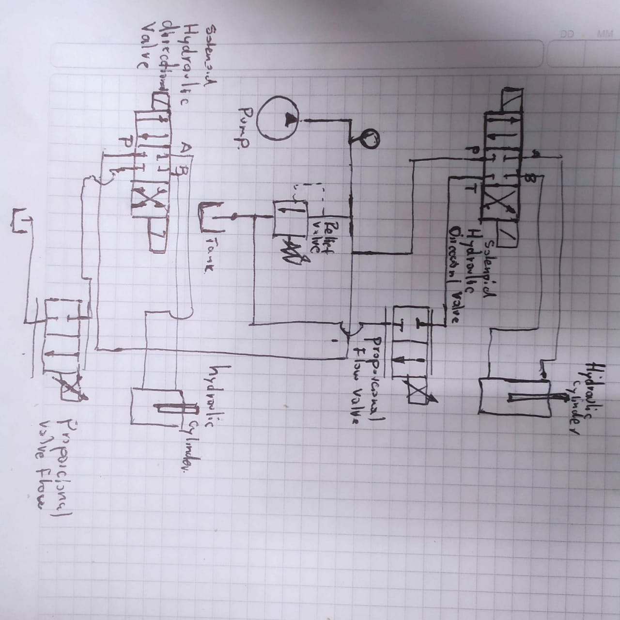

    hi, i am trying to buit a 2 dof plataform
    I have a proble whith the configuration whith the software smc3 utilis, the actuators ony move one directions
    I need help
    thanks

    Can you please specify what control hardware you are using and post pictures of all of your SMC3 settings.

    Hi, its the seme used to 2 DC motors using the IBT-2 ,
    2 directional hydraulics valves, and two proportional flow valves.
    the sistems works, but unly one direcions, there is not change on directional valve

    this is the hydraulic diagram, I want to control the solenoid valve, but I don't know how do for works whit the software scm3 , for change direction
    The coils are connected by means of octocoupled relays to pins 2, 3 - 4 and 5 of the Arduino respectively, and pin 8 and 9 for the speed by means of the proportional flow control valve.

    I think , I Have wrong whit the coil conections

    hi, for move one actuator, needs put one coil high, the other low , and PWM
    the pins are for coil 2 an 3 y for pwm pin 9
    for the another actuator moves whith pins 4 and 5 and, PWM whith pin 10

    I think that in that order of ideas, I should put the SMC in mode 1 as if I were using the H monster bridge, what do you think?

    hi,
    like i said, before when I put the mode1 , its works two directions,
    I'm going to try with lieve for speed.
