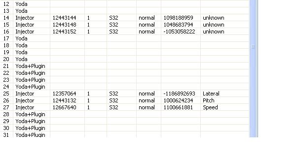

    I know about that, but thanks anyway. i had to use 20000000 in the max with using factor 0.01 :tape:
    Anyway i tried 2.1.0.3, but the injector is the same with FLOAT factor x1000 getting low values from 1 to 100...
    Sorry about all the questions, i just want to figure it out....

    Then you should get values from 1 to 1000 with FLOAT and *10000, which is fine.

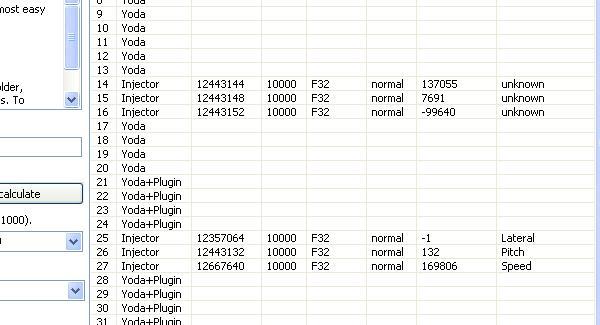

    This is when using float, the upper values are from cxc, maybe i need to try those they are higher than the demon (below) values....

    Okay i have finally some motion...
    Used float and x10000 factor and used in the profile (!) 15 max. it DOES work, however if we could multiplie the factor in the injector more, it would be a lot smoother!
    Also i agree we need more addresses for this game, as i am sure there are more. only lateral/speed/pitch is not very much.
    So if Sirnoname could add some more factor, then this game is playable with some motion.
    Till then i will try to figure out what the rest of the addresses (cxc) mean...
    Regards

    Okay So i now have some proper lateral movement, and pitch. Thanks to Sirnoname! that multiplier did the job. :thbup:
    The cxc adresses seem to be the car movement of some sort. so now i have speed,lateral and pitch. but no longitude like forces :(
    If someone has more adresses for NFS Shift that would be great.
