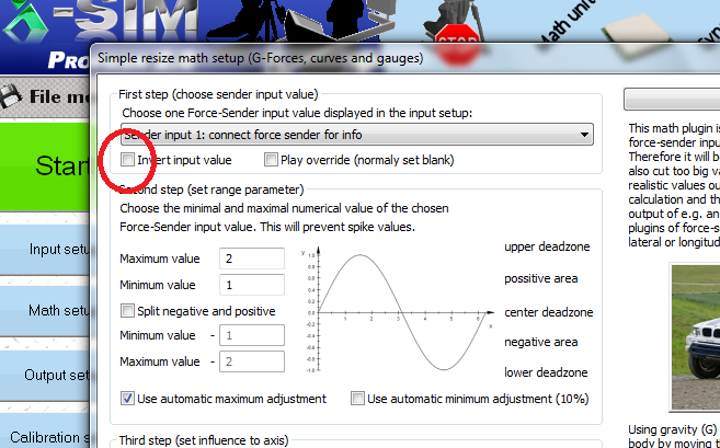

    I have isolated all the values separately to see whats what and i noticed there are 6 of them.
    DEMON:
    0x00BDDDFC
    0x00BC8DC8
    0x00C14AF8
    CXC:
    0x00BDDE08
    0x00BDDE0C
    0x00BDDE10
    I have movement, but its way too hard, if the car just moves a little the values jump up like crazy.
    When i tested the lateral values, the seat only moves forward/backward, and not sideways as it should. Am i missing a setting here?
    @Demon:
    Lateral G's: float: 0x00BC8DC8 * 60000, limits (-70,70)
    what do you mean by 60000,limits? the min to max value? and what is -70,70?
    I am not giving up though.....

    So the mystery of val. * 60000 ,Limits -70,70 unfolds.
    Step 3 in injector has 2 parts. (1) how you interpret the memory address and (2) factoring.
    The 60000 thing is the factor that I use to produce a value that I can then throw a little math at to
    produce a stable value. The max factor allowed by Injector is 10000. So in essence, from this step
    forward, you guys are going to be working with a value that is 6 times smaller than mine.
    The Limits -70,70 thing has to do with Profiler. Bring the value in as Output 1:1(G-force) and in
    step 2 (set range parameters)
    Maximum value (me)70 (you) 12
    Minimum value (me) 1 (you) 1
    Minimum value (me)-1 (you)-1
    Maximum value (me)-70 (you)-12
    *don't use automatic adjustment
    the resolution of your axis is going to be low, only 24 steps because X-Sim only works with whole numbers at the UI level. I am away from the lab until Monday so I can't verify the Information provided above. Rock On!......D :yes:

    Look, in case NFS provided a raw value of, lets say +/- 0.01000, then you would have to mulitply the raw value with 100000 in order to get the recommended input value range of +/-1000 in the Profiler.
    An incomming value of +/-1000 into the Profiler is recommended by the Injector, but +/- 10000 or 100000 are ok as well. Just +/-0...99 is not enough at all.
    An input value of +/- 12 is defininitely not sufficient for the use with SCN5 actuators. As well as +/-70.
    Selecting float in the injector (step 3) may do the trick to get a higher input value in the Profiler (select float, and then try to scale the value using the injector multiplier to a Profiler input value of +-1000).
    Btw, the offsets you get via these adresses are g-force values already. You dont need any conversion in the Injector for these offsets at all.
    To get an input value moving the Frex type simulator sideways instead of back and forward, you need to invert the input value for one axis (left SCN5) while the other axis ( right SCN5) remains uninverted.
    For longitudinal forces (accelleration/braking) the axis (SCN5) have to remain either checked, or unchecked at the same time.
    If the value moves the seat sideways then, but inverted, then you have to uncheck the inversion you have made on the actuator, and then check the inversion checkbox of the other actuator.
    regards

    If you get an input value of +-1000 into the Profiler, and you set your min/max values to 1/12 for example, your rig will freak out, as it just switches from one endposition to another.
    In case of +-1000, you have to configure a max value of 1000 (or more) for example.
