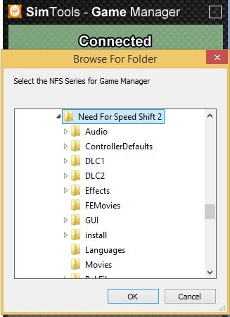

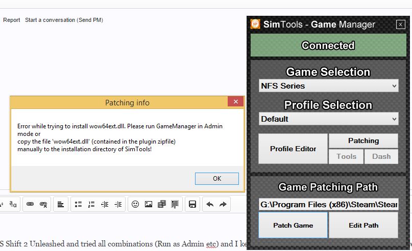

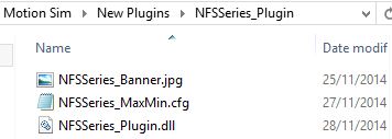

    Hi Guys,
    Trying to patch NFS Shift 2 Unleashed and tried all combinations (Run as Admin etc) and I keep getting the "wow64ext.dll" install error, however the plugin does not contain a wow64ext.dll file in the Zip, just the Plugin Title .dll file.
    I am clearly missing something obvious? :)
    systems is Windows 8.1 64bit. NFS Shift 2 is the Steam Version. (32bit Version)
    Plugin (when unzipped)
    Attempt to patch and the path:
    The error:
    Thanks in advance :)
    Archie.

    Thanks @value1 - Talk about "customer service!" :) - I jumped ahead and already made a Zip file with the wow64ext.dll file from the NoLimitsPlugin, however still no joy.
    (and also just tried with your updated plugin)

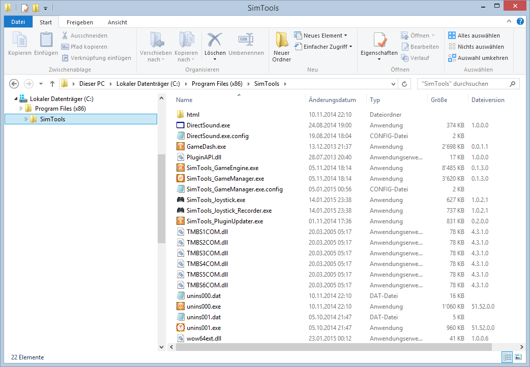

    I did notice, unlike other plugins the prompt says "Locate your simtools" directory when patching. What is the path for it? Could you provide an example of the folder content so I know I'm looking at the right spot?

    It's like C:\Program Files (x86)\SimTools

    Thanks @value1 - Managed to resolve it. I had put Simtools on G:\Program Files(x86) (My steam drive) rather than the default C:\Program Files(x86)
    Once I backed up my AppData, removed Simtools and re-installed to C:\ and restored my settings all is good now.
    I had to manually copy wow64ext.dll to C:\Program Files(x86) still, but I suspect it's my PC rather than a common issue.
    Thank you so much, sorry for causing you more work than was needed :oops:
