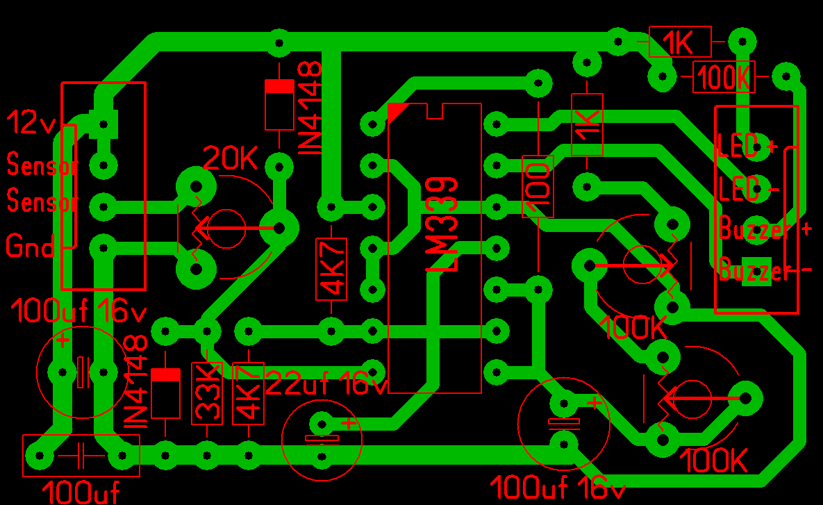

    i need some Help. Can someone make me a PCB-Layout from the following PDf-Files.
    It is easier for me to solder the Plate with a PCB-Layout. :)
    1. Circuit Overview
    2. Cirquit Diagram
    It`s a PCB for a DIY Coolant Float Sensor for a MGF. My new Toy for the Summer :clap: 8)

    Hi Michael N.
    I may be able to help if you give me a few days.
    Just a few questions about the project.
    Is it going to be mounted in a plastic box.
    Is it mounted under or on the dash of the car.
    Do the variable resistors need to have knobs or can they be minitures on the PCB so the circuit can be setup and forgotten about.
    Are the two 100K variable resistors a dual device or separate devices.
    Are you going to etch and drill the PCB yourself.
    Regards Senetor.

    Hi Michael N,
    Nearly there, here's a preview of where I'm at so far. It measures about 51mm X 31mm.
    Just a couple of questions,
    In the photo of the circuit in the blue box, there is a red polyester capacitor , the value of these only go up to about 3.3uf and in the circuit diagram it says it's value is 100uf , so obviously this must be a misprint , have you any more details on this project.
    Regards Senetor.

    thank you for your work till now :thbup: . I have no contact to the owner of the page. I sent an E-Mail to him, but no response.
    I ask someone another an he say, that the picture of the cirquit in the blue box was the prototype and perhaps the capacitor was changed to a ceramic capacitor (10uf-100uf). He think the capacitor is against high frequency Glitches, thus usual operating voltage buffering on the Paltine.

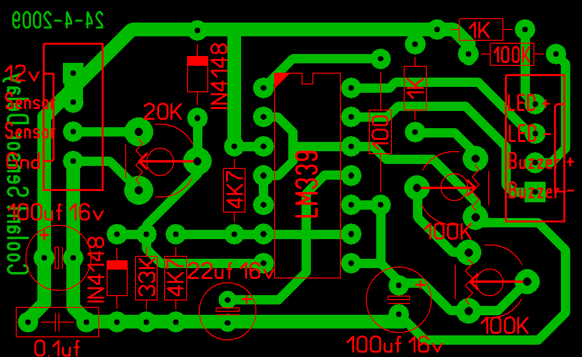

    Hi Michael N,
    This is what I have finished up with.
    I have put the Sprint Layout .lay file in the Rar with the rest of the files.
    Coolant Sensor DelayPCB.rar
    Coolant Sensor Delay.rar
    If you download Sprint Layout 5.0, do a Google search, and you can open the .lay file and have a play yourself.
    Regards Senetor.

    Thank you very much Senetor :thbup: :cheers: .
    Do you think a capacitor of 0,1uf is enough?.
  9. Senetor
    Senetor Member
    Oct 23, 2008
    90
    Australia
    595Coins
    Hi Michael N,
    It looks to be a filter cap for the incoming 12v, it already has got the 100uf cap and as you were saying this 0.1uf is for the high frequency ripple.
