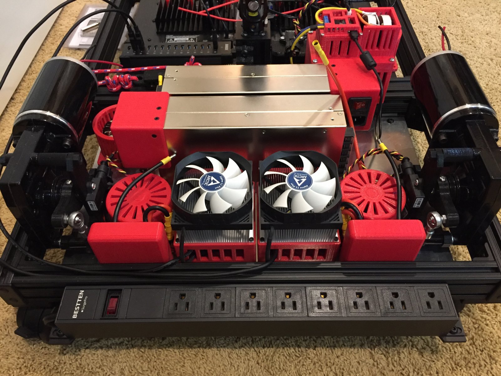

    Just about done... :thumbs

    Thanks all! It's mostly down to finishing the wiring and fitting the last few bits. Checked center on the Hall sensors and comms with the computer today. Just got to finish up the other two coils and connection to the motors and I'll be able to power it all up for real. Getting close to motion!

    @djkc - The outlet strip is from Amazon: http://a.co/fcRAoxD. It's a rack mount 8 outlet strip with surge suppression. Probably just MOVs but I was after the mounting, color, and form factor.

    what are the coils you're talking about?
  7. Zed
    Apr 4, 2017
    1,040
    USA
    5,842Coins
    +1,043 / 4 / -0
    Hey Matt, the coils are/go in those round housings and are chokes to cut the back EMF and slam from the motors due to the PWM. I don't know yet, and hopefully never find out, but they may be even more important to have in circuit to keep the differential amps in the bar graph interface circuits from getting killed from overvoltages. I've got the bar graph circuits between the coils and the motor controllers with the wiring between the coils and the motors the dirty voltage no-man's land. I decided to add the coils a long time ago since I'm using the JRKs and planning to push them pretty hard. @Avenga76 did a really good writeup of why they are good to have depending on the controllers you are suing. I guess the Sabertooth controllers don't need them, but depending on how hard you push other controllers - like the JRKs and MMs - they can be helpful. Avenga uses chokes in his wind generators to protect the MMs.

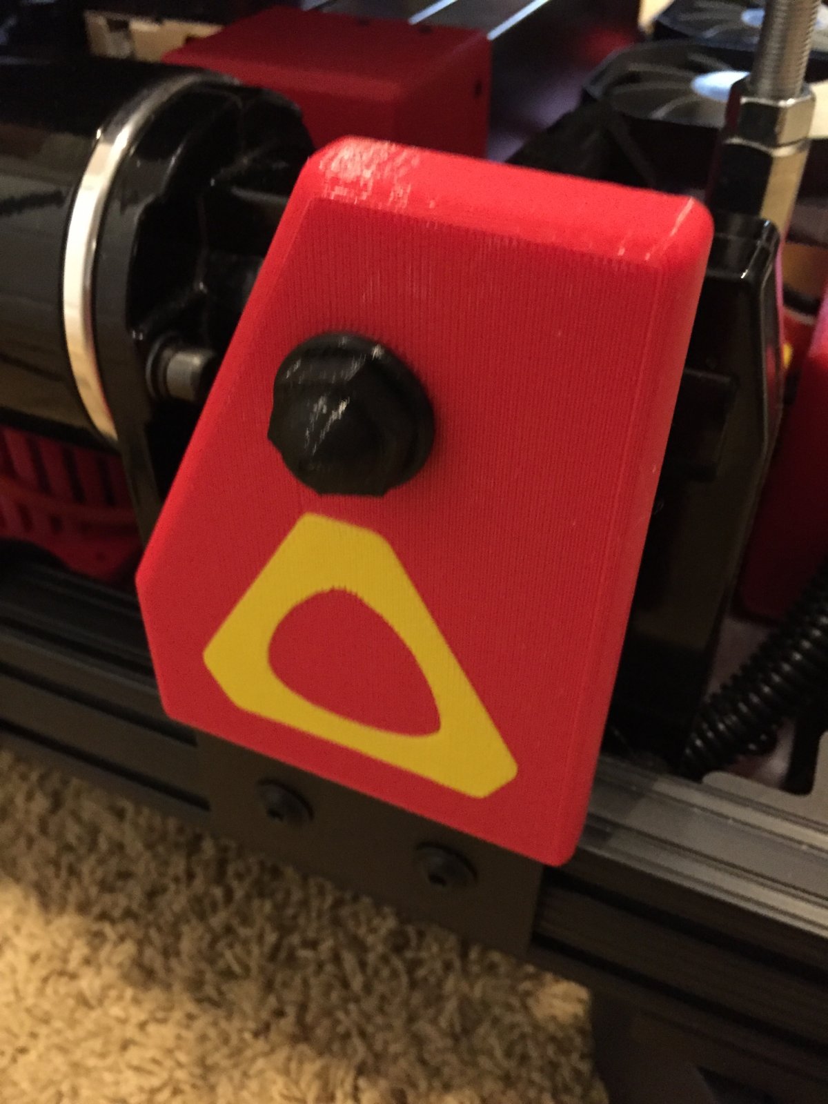

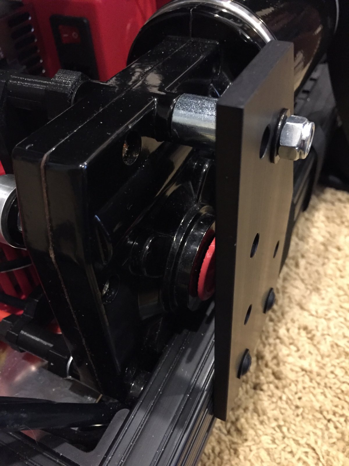

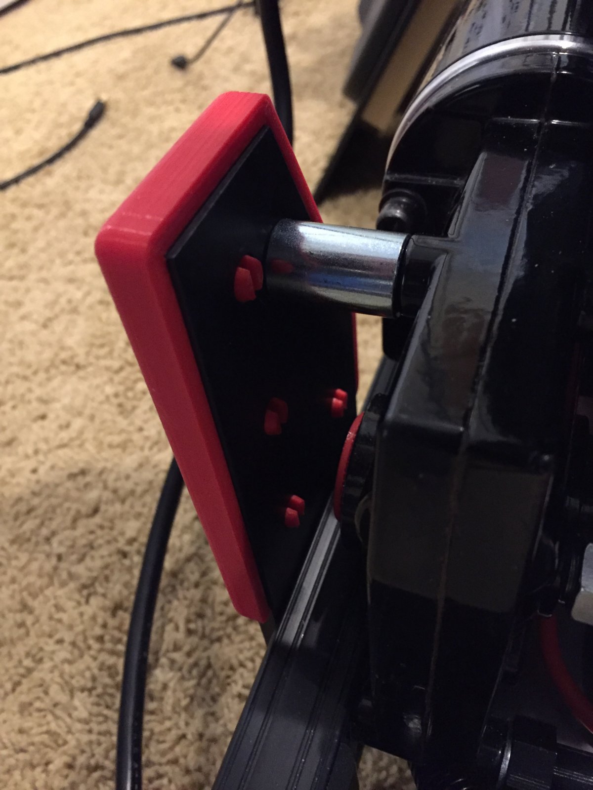

    But some minor updates. I only mounted my motors using the bottom two mounting holes and was getting a little flex especially when things get violent. I added a plate and spacer on the outside to really stiffen up the mounting and keep the original mounting from fatiguing the frame strut. And since this is the 3D printing section, I’ll own up to going over the top with a printed plate that snaps into the spare mounting holes but covers the sharp corners with rounded plastic ones to protect shins. But I also experimented with doing inlay provide some contrast. The Vive logos were just recesses in that shap where I then extruded the shape to slightly thinner than the recess and printed them separately. A little work with a knife to trim to fit into the recesses and some gap-filling CA to glue them in place. Also made little friction fit press-on acorns to cover the lock nuts.

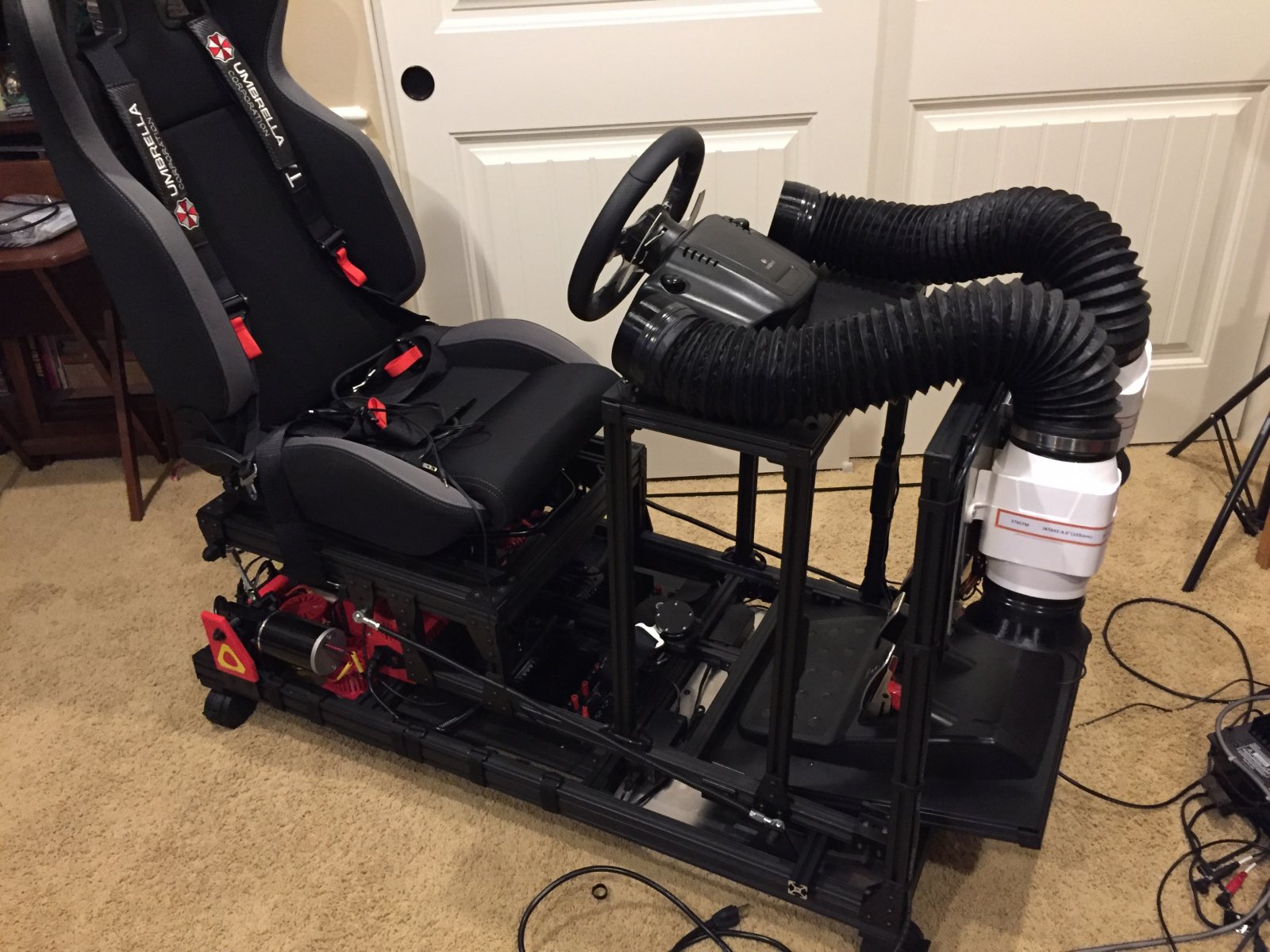

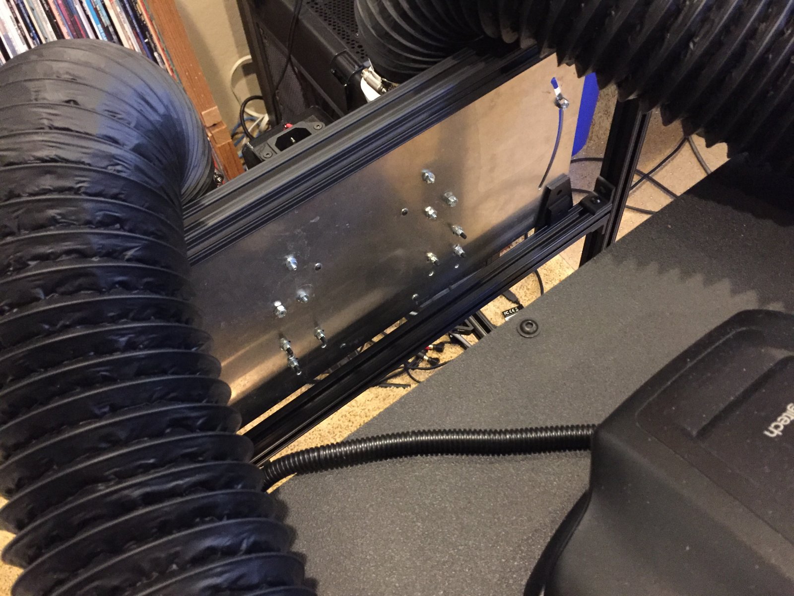

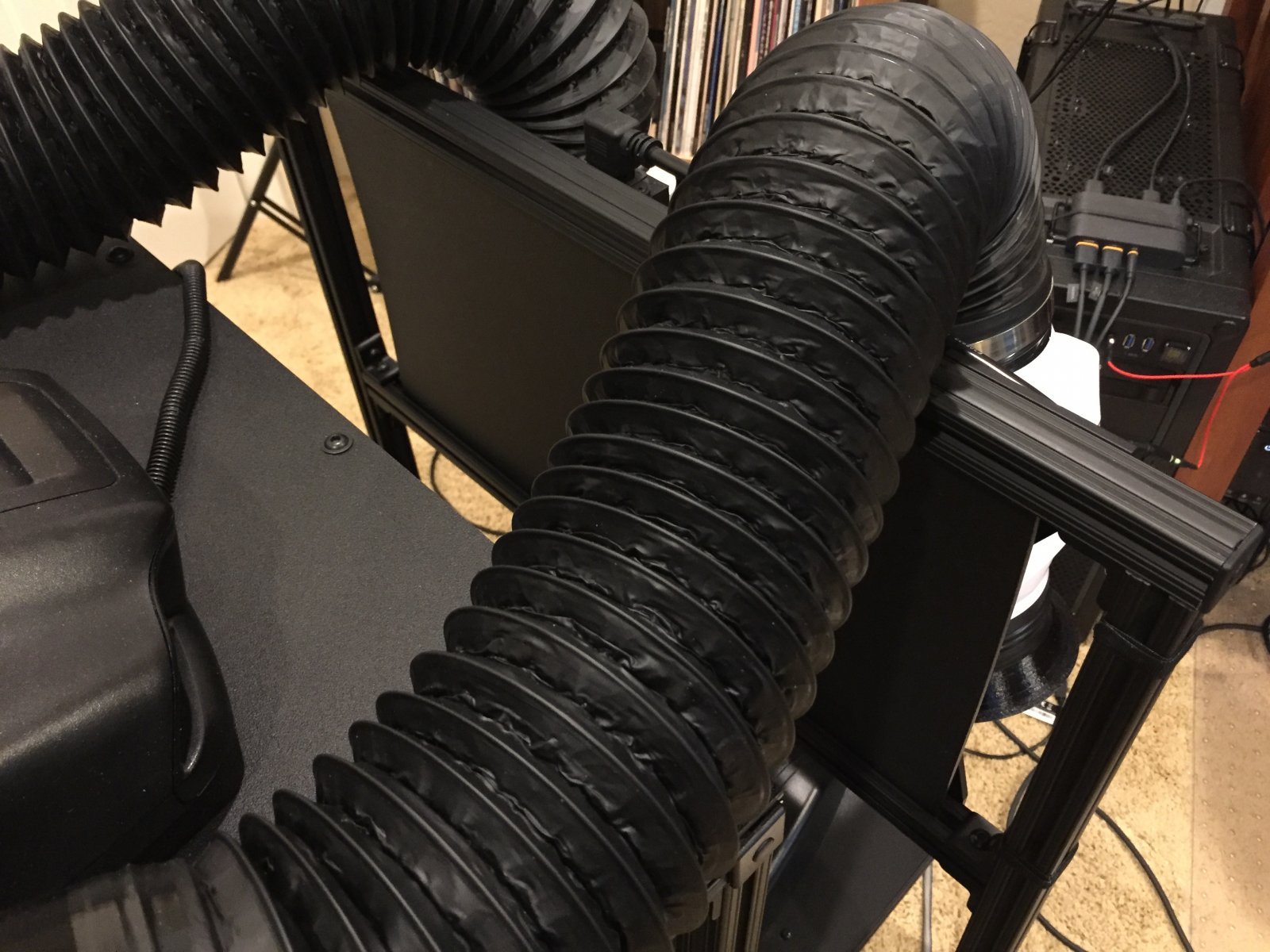

    No 3D printing on my part but I finally mounted @Avenga76's wind generator on some spare strut on the lower frame to allow shortening up the hoses. Since it mounts to the lower frame, the only weight on the moving part are the flow straighteners.
    02979F16-1108-4333-948A-10E898601680.jpeg 949381C1-B583-4B24-BE3C-50DAE0FBFB7D.jpeg
    Hid the driver side of the wind generator mounting plate with some black HDPE slid into the strut groove. Last photo shows there is plenty of clearance.

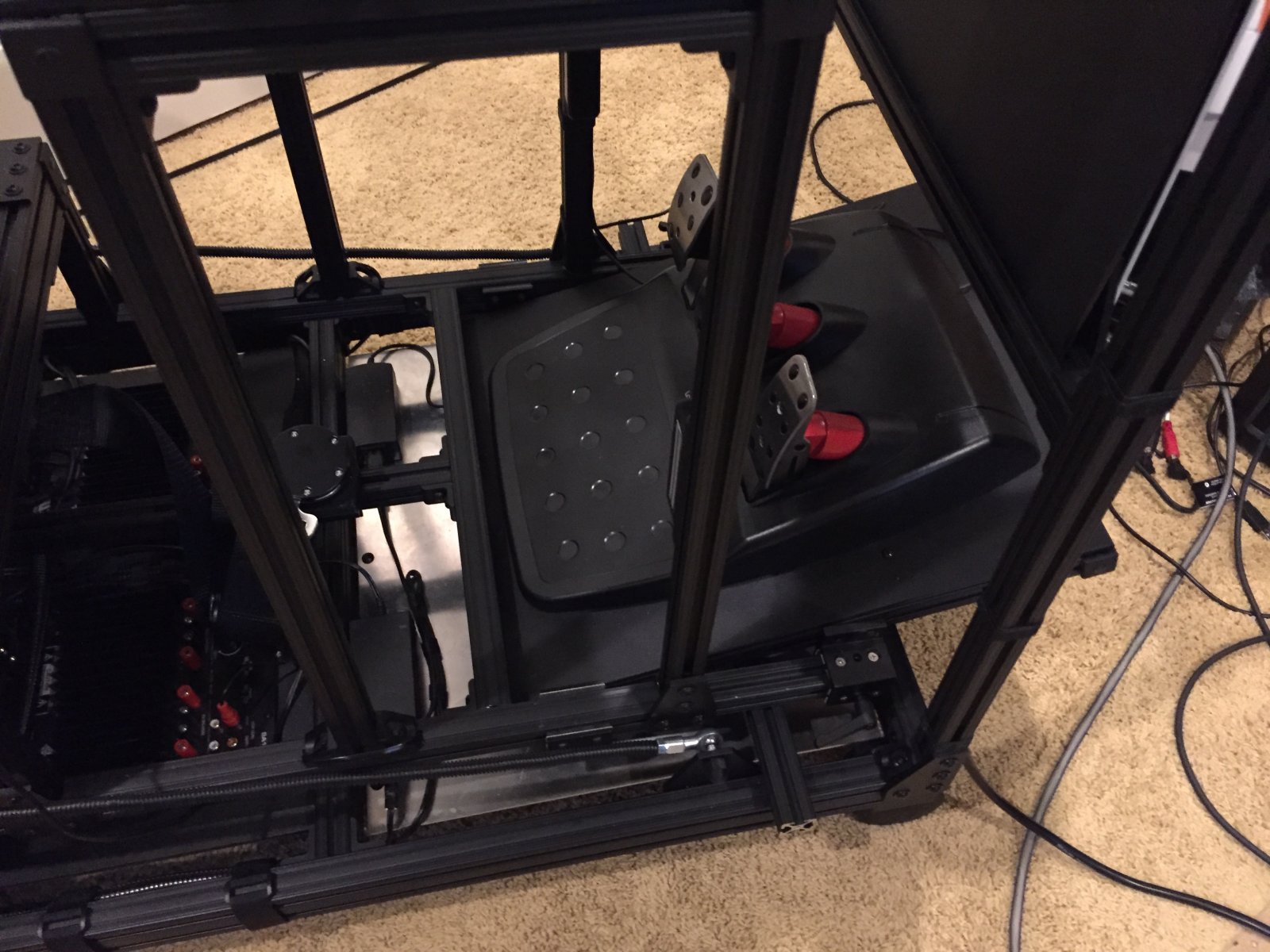

    Now I’ve just got to get the flight stick and pedals set up to finish it all off. Or sort of finish it off. Archie is right... :thumbs
