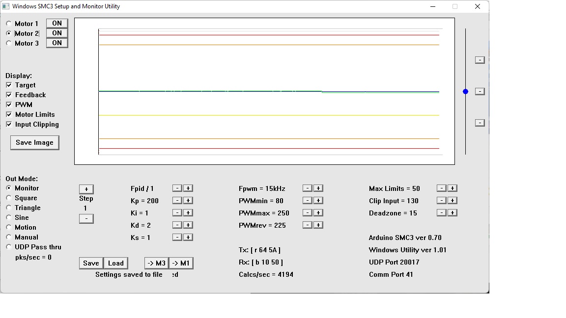

    You use SMC3 for motor pid calibration, this setup varies according to the motors, drivers and power supply you use. I will place mine with these motors and 24V power supply.

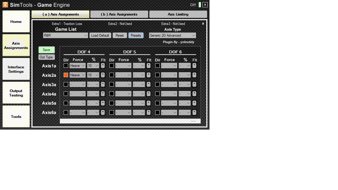

    Regarding the assignments of the axes, here too the values vary according to what one wants to receive as a response to the reaction of the motors according to the feeling one wants to have. For now I am using this configuration on RBR that I use for more time with which I am very comfortable.
