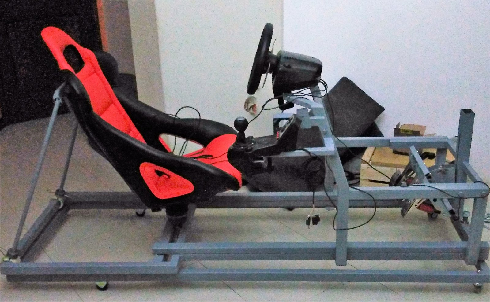

    Hello, here I share my first simulator achieved with all the information I could get on this great help page
    I clarify that I use a translator because I do not speak English only Spanish so I apologize for that

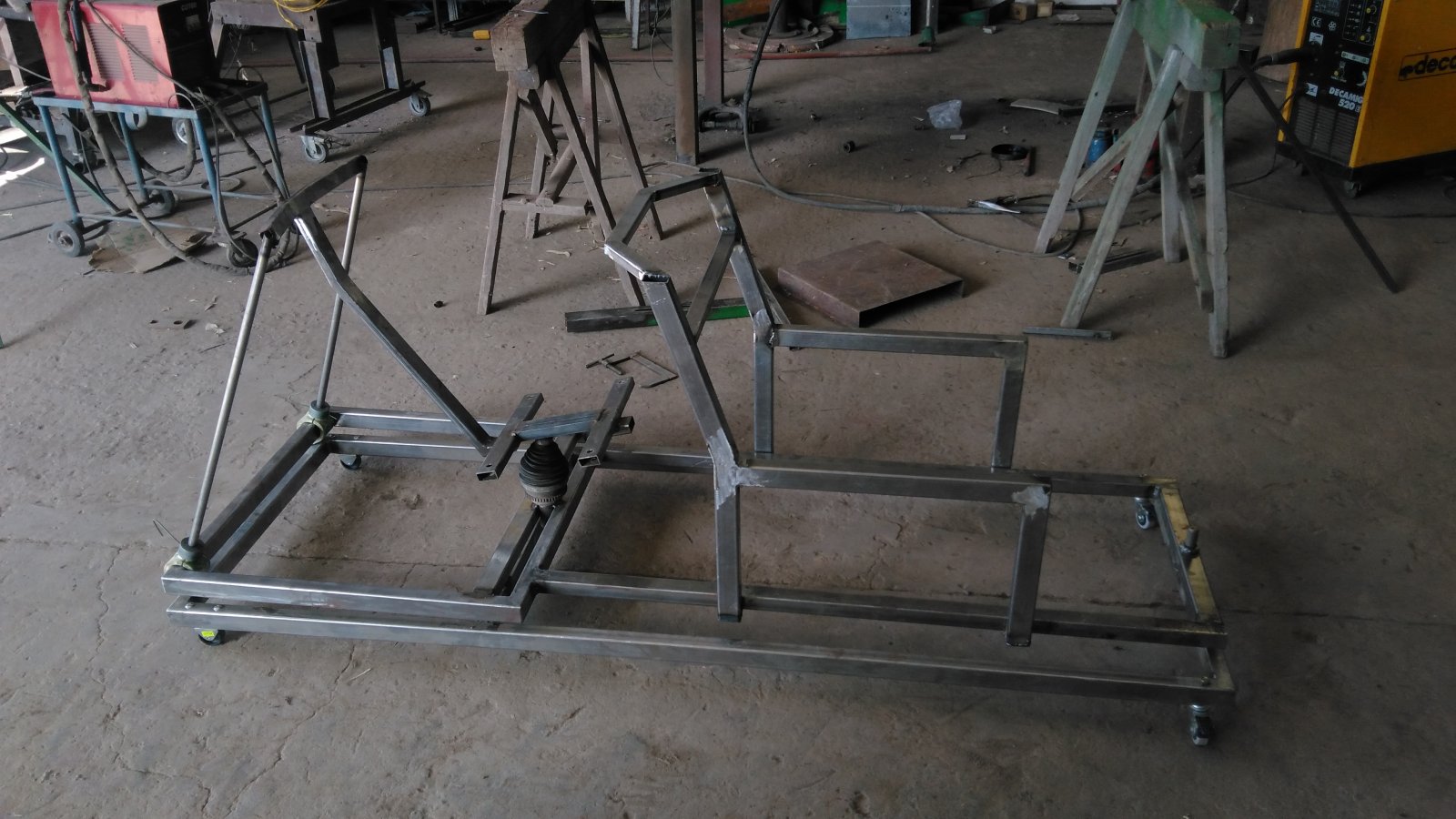

    So my platform was taking shape, I told you to use a structure built with approximate measurements of the driving position of my hyundai genesis. IMG_20160403_184437.jpg

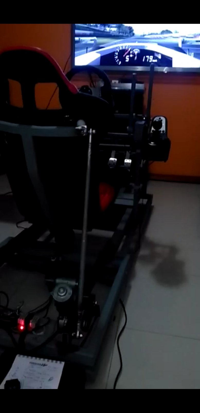

    Here is a sample of how I look

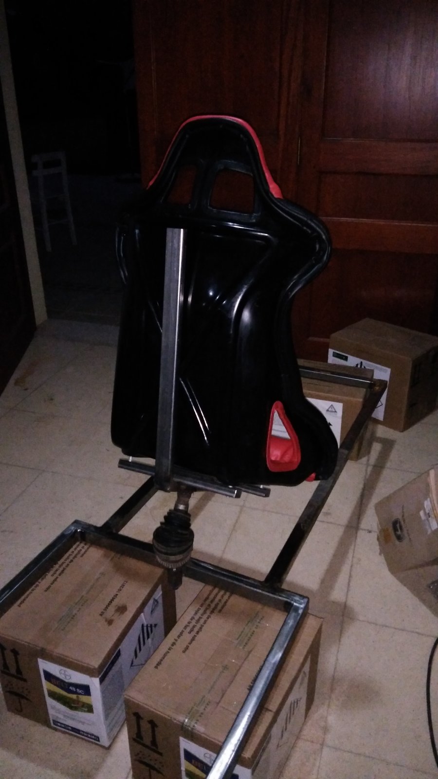

    The seat was installed on the axle shaft of a car

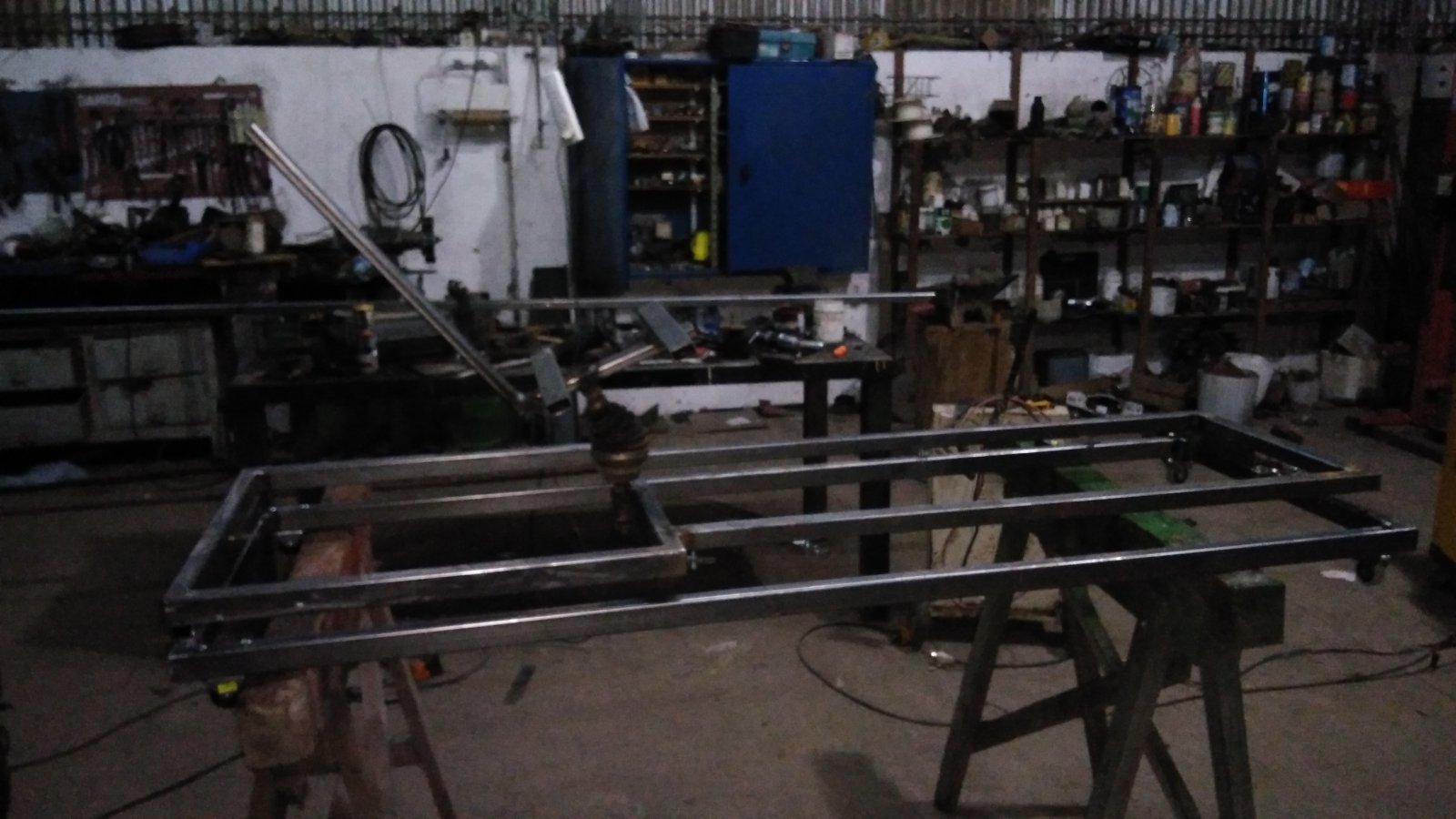

    two structures were made one on top of the other that pivots from the front end and moves the part of the seat to the sides to achieve the effect of loss of traction

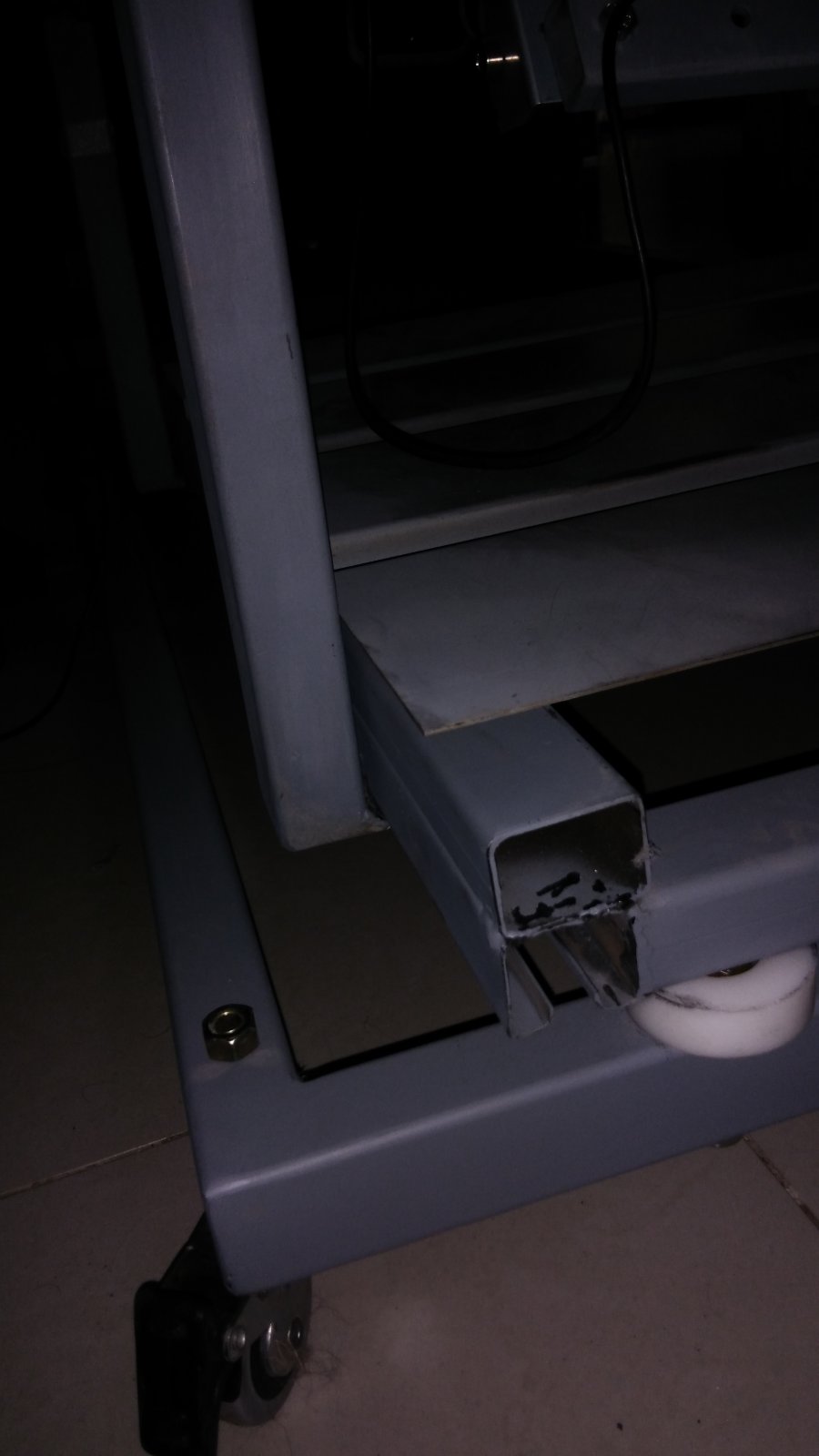

    It has wheels with locks underneath to be able to carry it from one side to the other and fix it where it will be used

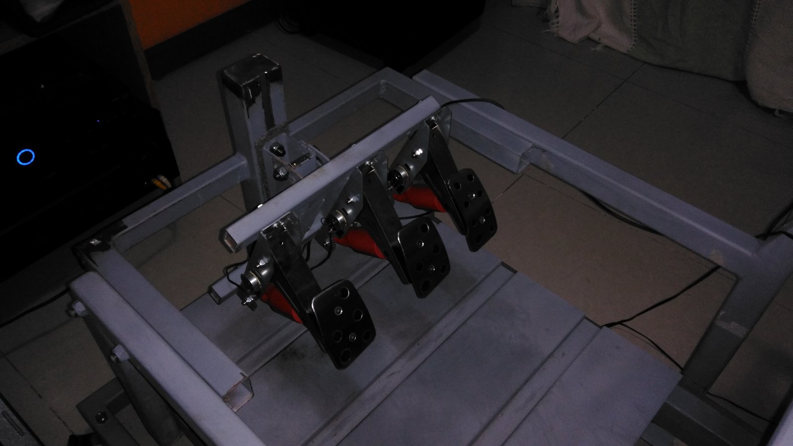

    all the part where the steering wheel and the pedals are placed moves back and forth to allow regulation
    the pedals took apart a g27 and got inverted and relocated

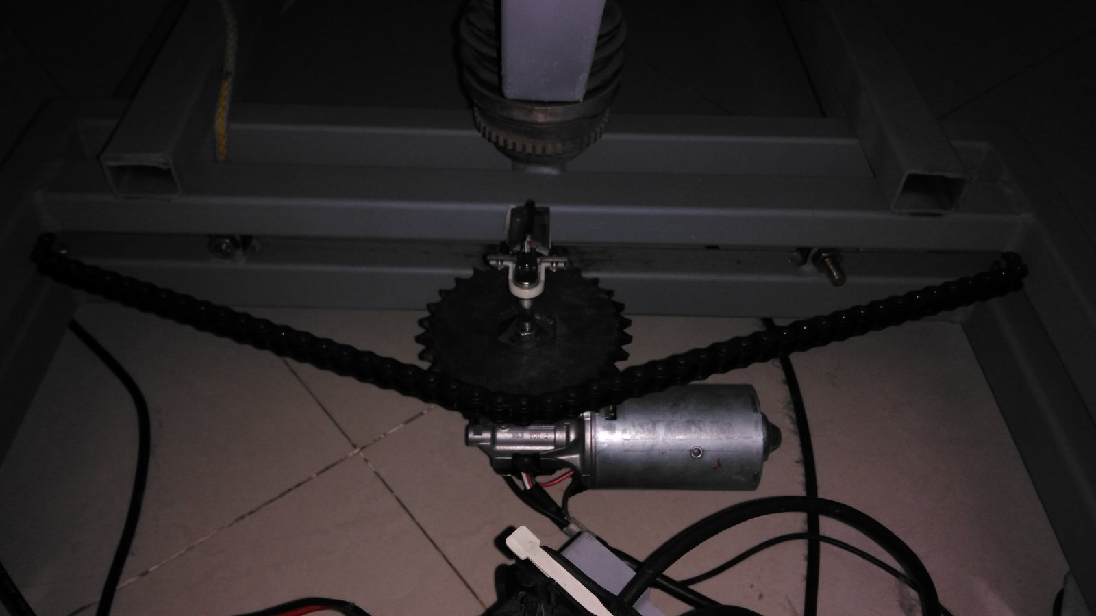

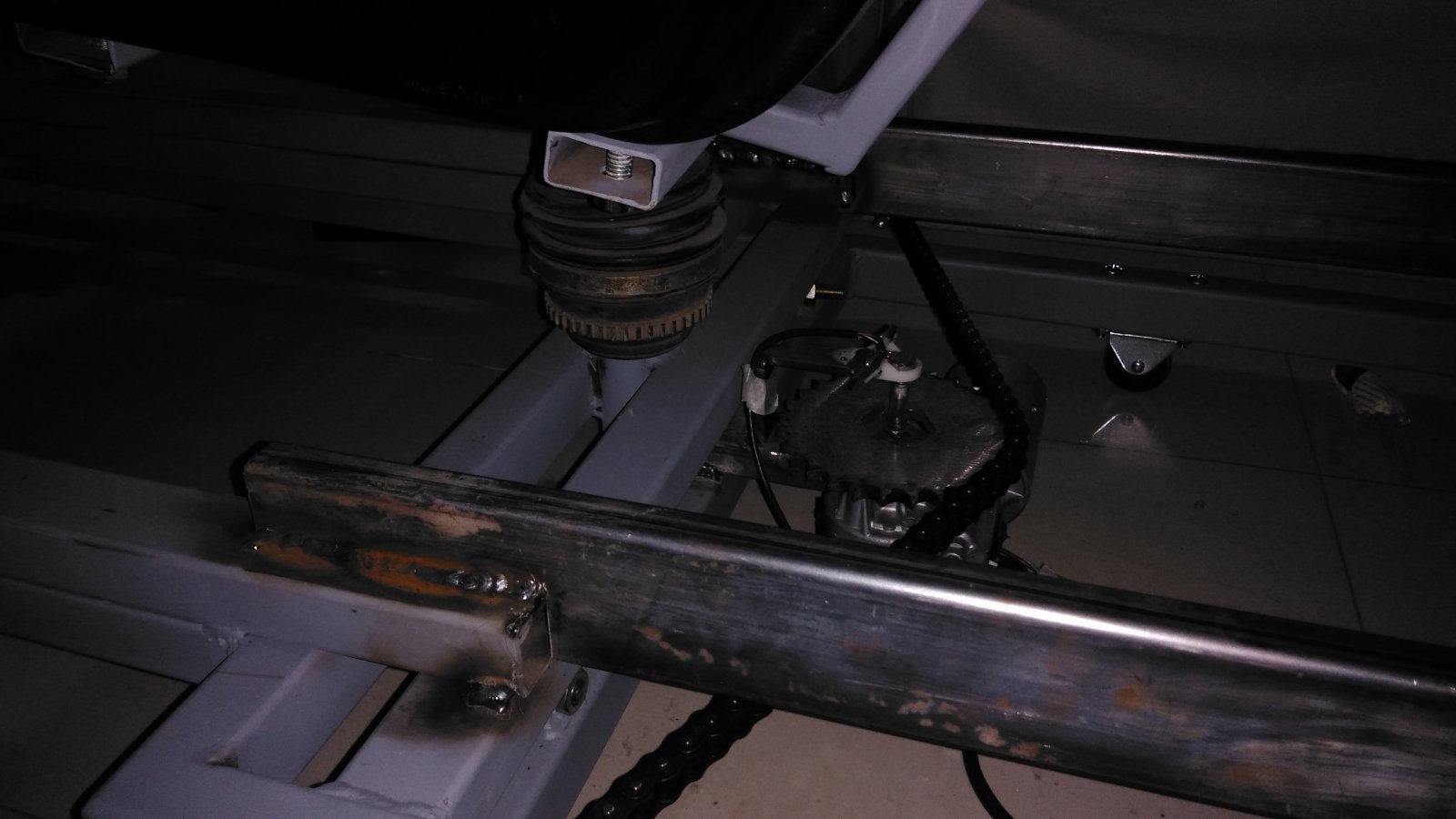

    The loss of traction effect was achieved with a motor and potentiometer connected to a chain by means of a gear that makes the structure move by bearings on the other lower structure

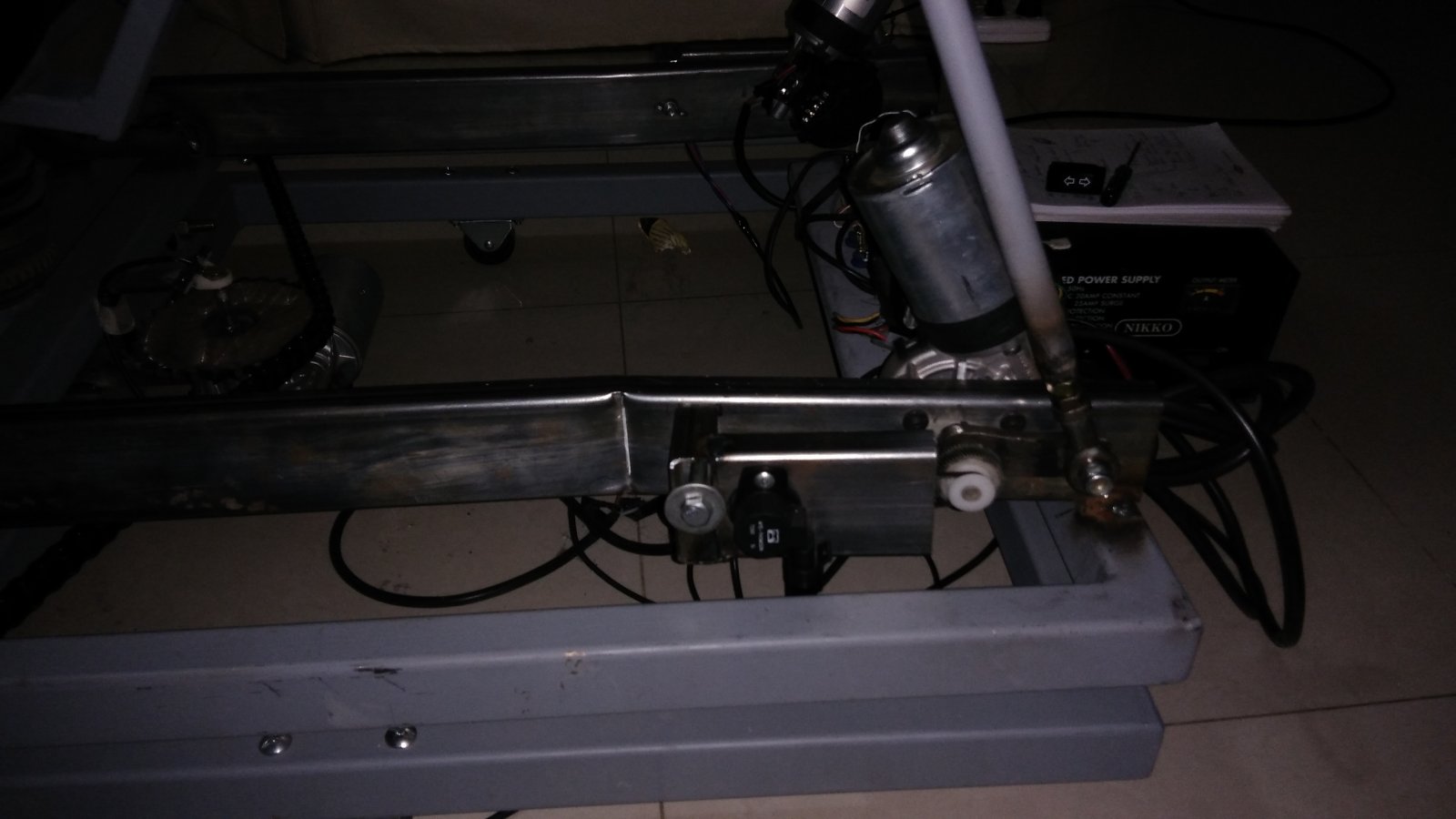

    the rear engines are bosh trucks mercedes benz coupled to the volkswagen gol car throttle potentiometer, coupled by gears and timing belts, since the rotation of the potentiometers was less degrees than the rotation of the engines. In any case, it is the least expensive option available in Argentina and they are very precise, they do not generate electrical noise. Try with potentiometers from the electronics provider and they did not work. Try with hall effect transistors and do not make them work either.

    Here you can see the profile used at the bottom to make the regulation slide and the wheels with lock
