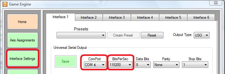

    +16 / 0 / -0
    after inspection , they were both attacked and came 5v each , one more thing , in the simtool configuration type output in the picture you can not find it because I USE ?

  9. Historiker
    2,163
    9,212Coins
    +2,177 / 19 / -1
    Not sure of your question either but I do notice that you have it set for USO rather than SER (SER for Arduino serial connection).
  10. luky_90
    luky_90 Member
    Mar 3, 2016
    106
    276Coins
    +16 / 0 / -0
    The photos I took from Racingmat guide.
    Are not my setting
  11. Historiker
    2,163
    9,212Coins
    +2,177 / 19 / -1
    Ok, but it might help to also post that when you ask a question :)

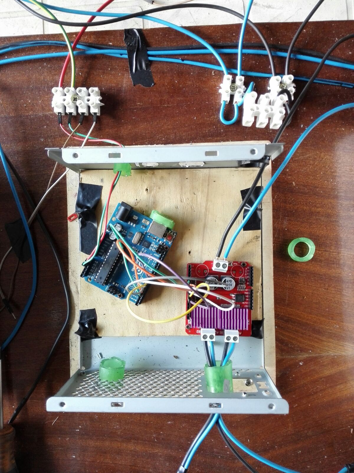

    questo è il mio cablaggio è un disastro, ma la sequenza è questa:
    ARDUINO / MONSTERMOTO
    ..... GND <-> pin GND
    ......... 5V <-> 5V
    ..... Pin 4 <-> pin 4 inA motor1
    ..... Pin 5 <-> pin 5 PWM1
    ..... Pin 6 <-> pin 6 PWM2
    ..... Pin 7 <-> pin 7 inA motor2
    ..... Pin 8 <-> pin 8 inb motor1
    ..... Pin 9 <-> pin 9 inb motor2
    ..... PinA0 <-> pin centrale del piatto 1
    ..... Pina1 <-> perno centrale del piatto 2
    ..... PinGND - pin potenziometro 0 di Ohm 1 e 2 <>
    ..... Pin 5V <-> pin potenziometro 10k di Ohm 1 & 2
    così io lavoro solo un potenziometro, ho notato che se si elimina o positivo o negativo da un motore continua a funzionare come se alimentata dalla staffa, potrebbe creare problemi? @RacingMat
  13. RacingMat
    2,234
    21,094Coins
    USO is in the beta version... I should update a bit :oops: but i'm waiting for V2! :)
  14. RacingMat
    2,234
    21,094Coins
    you HAVE TO wire both potentiometers, if not, the arduino outputs are floating and motomonster won't react correctly
  15. luky_90
    luky_90 Member
    Mar 3, 2016
    106
    276Coins
    +16 / 0 / -0
    potentiometers are all attached but only by moving a potentiometer working properly and the other works only from one direction , and both move both engines simultaneously !!
    the engines are both attached to the structure and saw that eliminating the positive of a motor continues to run also , it is possible that it is not isolated from each other if an engine is moving is also moving the other excluding the potentiometer ?
  16. luky_90
    luky_90 Member
    Mar 3, 2016
    106
    276Coins
    +16 / 0 / -0
    simulator arranged guys ,
    I do not know where it comes from but I have the mass that runs through the frame and sent haywire all, I now have isolated potentiometers and engines and all is well .
    after turning it on and seeing if everything finzionava I found that while performing the roll while the engines are fast pitch with the speed of the motor drops more than double , and is very slow . why?
