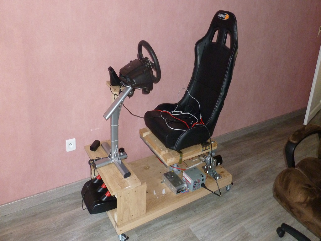

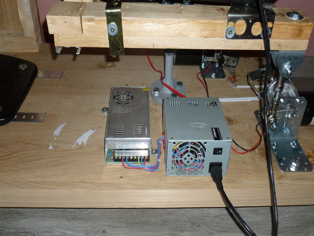

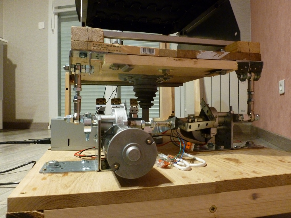

    Hello everyone
    I come to present my simulator 2DOF that I just realize with few tools and tools.
    So I left on a wooden whole and with recovery as the cardan and the heating flanges.
    + Various screws and squares.
    The engines found at an official supplier as well as Sabertooth and Arduino micro and potentiometer also.
    For the steering wheel and playseat I had a long time but I wanted it to move.
    Pictures to support and a video of not too good quality.
    The correction of the sway was made after the video as well as mini and maxi axes config.
    Tank you

    Very nice, what kind of wiper motor do you use.(truck or car wiper) Are they heating while played an hour.

    Good evening everyone
    I would like to evolve my simu in 3dof.
    This is my idea and you will tell me what you think.
    The idea is to add 4 electric actuators, here is the link http://www.controle-sans-fil.com/index.php?main_page=product_info&cPath=433&products_id=1549
    At the 4 corners of the base plate. When I turn on the simu the verins would rise to arrive in dead zone and ready to operate.
    They would be ordered together (climb and descent) by the Arduino with well on the sabertooth that goes well.
    These cylinders are relatively inexpensive but I do not know what they are worth at the intensive level. It is 200kg per cylinder with a development of 100mm and a speed of 30mm / s
    I sent a mail to the seller for more details.

    OK thanks for your answer.
    I also suspected that these jacks were too slow.
    Too bad and given the price of the verins verins it is too expensive for me.
    I'll put engines.
