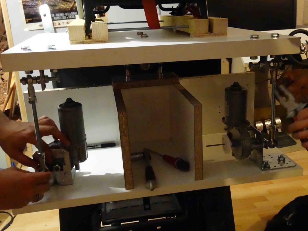

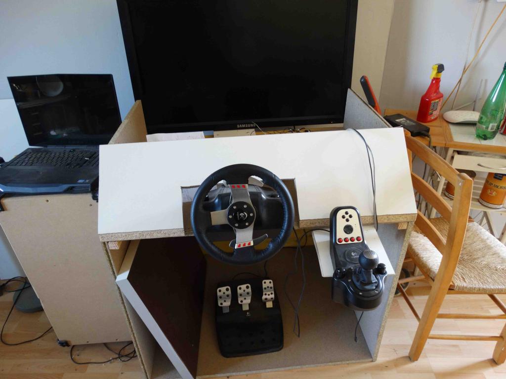

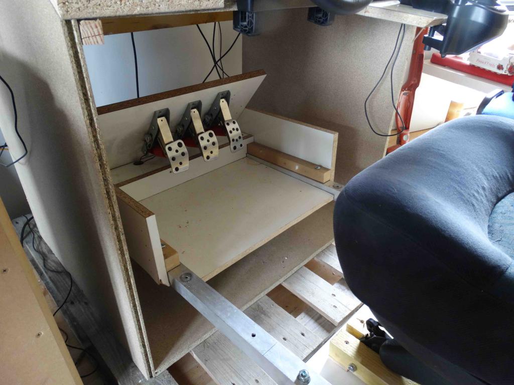

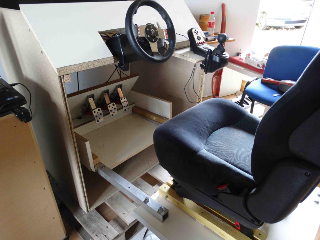

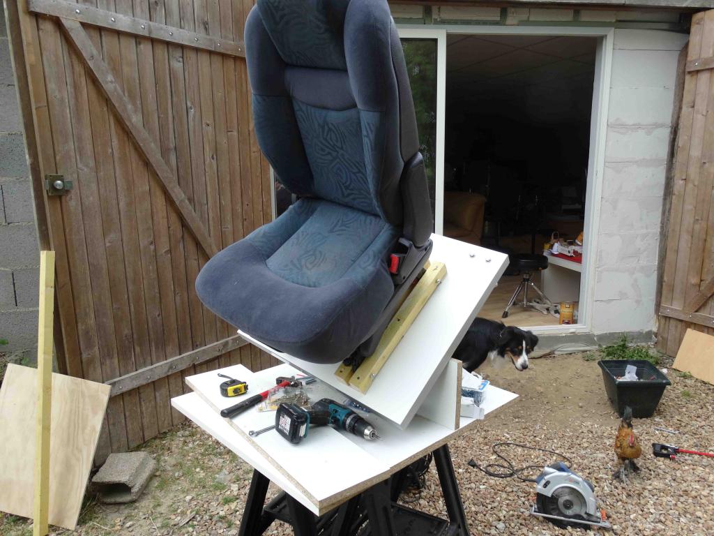

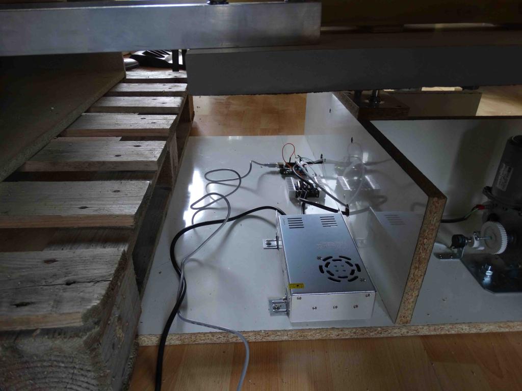

    Thank you to the HSSC team for their valuable help;)[​IMG] [​IMG] [​IMG] [​IMG] [​IMG] [​IMG]

    Maybe you can describe what parts you are using (electronics cards, power supply, etc...)

    I use 120w engines with a sabertooth 2x32 and a 24v power supply

    I find that the use of agglomerate is not sensible, because very fragile.
    The seat of renault espace 3 is well found, I no longer mine is true
    It lacks reinforcements to hold your planks together, otherwise they will break at the screws.

    Moreover, your engine squares are too fine, you will have to reinforce them to avoid that twists.
    You did not put your engines in the same plane. You laugh at having strange movements in operation.

  17. obobo
    obobo Active Member
    Nov 8, 2016
    248
    1,323Coins
    +77 / 1 / -0
    tes moteurs sont à 90° l'un par rapport à l'autre
    The motors are at 90 ° to each other
