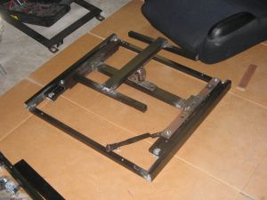

    Here's the main base frame of the moving part of the chair. I'm trying to keep the whole thing as low to the ground as possible, so I'm mounting the sliders low on the inside of the frame rather than just sitting them on top. Please ignore the ugly welds, at this point I was still using my stick welder.. the new mig is a million times better for thin metal.
    Here's another shot of the base frame. You can see I kept the sliders down low.
    Here are a couple of shots of the u-joint where it's gonna get bolted. In keeping with the effort to keep things low, I've cut down the u-joint to make it as short as possible. I welded two pieces of flat bar to the joint for mounting.
    This is what the seat will actually be bolted to. Just a simple frame. I later added arms to the frame for where the motors will actually move the seat frame.
    Here's the subframe placed on top of the u-joint.
    Here's the chair mocked up on the frame.

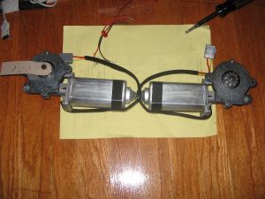

    These are power window motors from a 80-83 Ford Mustang. Some other motion sim builders are using windshield wiper motors.
    Wiper motors were made to run in one direction only, which means that if you try to reverse direction by reversing the leads, you'll often find that one direction runs faster than the other. They probably optimize the motor timing for the single direction and thus timing is all wacky when reversed. Power windows are obviously made to run in both directions. So both directions should run about the same speed. And indeed these motors tested at 100rpms almost exactly both ways.
    And since wiper motors were designed for one direction, one of the motor leads is often grounded to the case, since it's always going to be the negative lead. If you try to reverse the motor without isolating the leads from the motor case, you'll dead short your power supply. So one has to modify the motor to account for directional speed changes as well as isolate the motor leads from the motor case. Window motors have no such problem.
    Another advantage is that window motors come in pairs, while there is typically only one wiper motor in a vehicle. That means I can buy two window motors that are mirror images of each other. This helps aesthetically and simplifies mounting.
    One disadvantage is that window motors typically have gears attached, while wiper motors typically have a convenient arm attached ready to go for a motion sim. But I have a welder, and I can weld on an arm.

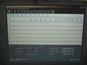

    But of course, it's not that easy.. when i hooked it all up this way, it sorta worked... but the motor was running full speed all the time. It could reverse directions, but there didn't seem to be any speed control. Hmm... There must be something wrong with either the signal going to INA/INB pins, or the motor driver wasn't fast enough to keep up with the PWm signal. I suspected the former since someone else reported that the motor driver works fine when pulsing the inputs instead of the PWM.
    So how do I determine if the signal is ok? I need a oscilloscope or logic analyzer and I don't have one!
    Or do i?
    Well I didn't.. but I bought parts to build a simple logic analyzer for the parallel port! I found several plans on the web and they were all pretty much the same.
    http://www.xs4all.nl/~jwasys/old/diy2.html
    http://akikorhonen.org/projects.php?action=view&id=59
    http://tfla-01.berlios.de/
    The plans called for a 74HC245 octal bus transciever. I was in berkeley last weekend an found Al Lasher's Electronics. Imagine an electronics store in the 70's and crammed packed with components and parts and all kinds of misc stuff and this is it. This is what a radio shack should be, and exactly what we need in the city. *sigh* I kinda miss living in San Jose just because there are a TON of places to buy components. Here in San Francisco there's nothing!
    Anyway. They didn't have a 74HC245, but did have the 74LS245, which according to wikipedia is.. different... I don't really understand all the ins and outs of logic ICs, but apparently one is TTL and the other is CMOS, and they have different input/output levels. The pic above shows the 10k resistors to pull all the inputs right, but that didn't work right. The inputs sort of latched high when it saw a high. I don't really understand why, but things were ok after I removed the pull-downs. The inputs just float high, and that's ok I guess. I put a 7805 voltage regulator on to run the 74ls245. I have it running off my old K6-300mhz laptop in XP. It has 8 channels, and I was able to get about 660ksamples/s. Which is very slow as far as real logic analyzers go.. but it's good enough for me. Especially since it cost about 5 bucks to make..

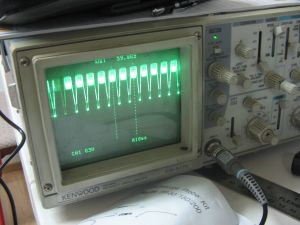

    Look at that! This is part of the sample where the motor switches direction. So going left to right, Line 7 is high, 8 is low, the motor is spinning full speed in one direction. THen it starts to slow.. but instead of starting to pulse 7 and keeping 8 low, it pulses 8 high! It finally transistions to spin the other direction by keeping 8 high, and slowly pulsing down 7. Well this is weird, but according to the truth table, if both INA and INB are high, it should brake to VCC, meaning both motor leads will see 12v and the motor will stop. So theorectically it should work.. but it doesn't.. who knows..
    So I looked for more answers. I tried looking for the datasheet for the PT2422-X chip in the servo..
    I couldn't find it, but did find a reference to a FR6461 in a google search for pt2422 servo
    Googling FR6461 servo led me to the FR6461 datasheet and a Russian page with a reference to a Renesas part number: M64611FP.
    It looked like the FR6461 is a clone of the Renesas part, and the pins on the PT2422 looked like they were going to the right places, so I think it's pin compatible with the Renesas M64611. So it looks like pins 5 and 6 are the outputs of the chip. So I call my brother to see how real engineers hook probes up to tiny surface mount chips and he says that they usually design in accomodations for logic analyzer probes. And that if there's nothing convenient, you have to just solder a wire somewhere and hook a probe on that. So that's what I did. I found two somewhat convenient places to solder to pins 5 and 6
    SO I soldered some wires on and hooked it up to the Logic Analyzer.
    That's more like it. One side's held to ground while the other is pulsed. Let's hook it all up!
    Looks just like a normal servo except for the two extra wires. The feedback pot is still connected to the output shaft. I'm going to be using a linkage to connect the window motor to the pot.

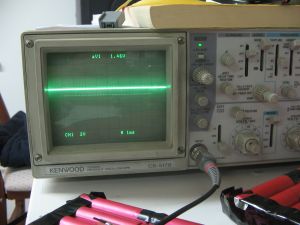

    Now I needed to think about powering the chair. In all the test videos you've seen before, the system was temporarily powered by some drill batteries. But that wouldn't do for the long term. So what I needed was 12-15volts, at maybe 10 amps? I don't really know the current draw on the motors, but 10 sounds about right. So I tried using my modded PC power supply but it shuts down as soon as you bump the motor. The inrush current of a big DC motor probably triggers some kind of protection on the power supply... bummer. So I had to come up with a new solution. How bout just a big transformer, rectify it with a diode bridge, and smooth it out with a capacitor? Sure why not...
    What we have here is a cheap car battery charger/engine starter. Harbor Freight to the rescue! Well not really, because the charger pictured is the second one I got from them. The first one almost burned down my house due to a short in the secondary winding of the transformer. After turning it on and verifying the output, after a while, it got super hot and started smoking! So I brought it all the way back to Newark, and yelled at the kid at the counter, and got a new one. Anyway, buyer beware.
    So the charger has two of the components I needed: a transformer, and a diode bridge. A rectified AC waveform looks lumpy like this (on my new oscilloscope!):
    It's all peaks and valleys because the rectifying diodes merely invert the negative part of the AC wave. To get a decent DC output I needed to smooth it out with a capacitor. With large currents I thought I better go with a largish capacitor.

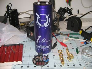

    This is a cheap car audio capacitor that I got from Ebay for about 25bucks. It says it's 1 Farad ±5% but who knows. You can see it has some circuitry and a LCD display on the top. The circuit turns on a LED when you first hook it up, then 10 seconds later, a relay trips and THEN it connects the capacitor to the voltage source. I think they do this for safety. If Joe Blow hooks up a big capacitor to a big battery backwards, he'll *really* blow. This way you have ten seconds to realize that you did something wrong.
    And this is the big cap taken apart. I needed to override the relay because I think I'm smarter than Joe Blow (not really, i exploded a cap on the motor driver :) ). And because the circuitry wasn't playing nice with my battery charger.
    What happens is this: Plug charger in, cap initiates countdown, after ten seconds the relay connects capacitor, empty cap acts as a dead short initially which causes large current draw, large current dump causes massive voltage sag in battery charger, voltage sag freaks out the capacitor circuitry and causes relay to disconnect cap, now voltage returns to normal, and relay reengages, and starts the vicious cycle  again. So I just jumpered the input and output of the relay.
    This is the finished power supply with cap attached.
    And here's the output of the charger/cap combo. Smooth as butter. It's about 14.6 volts DC (using a 10X probe, so it shows 1/10th the value on screen).
