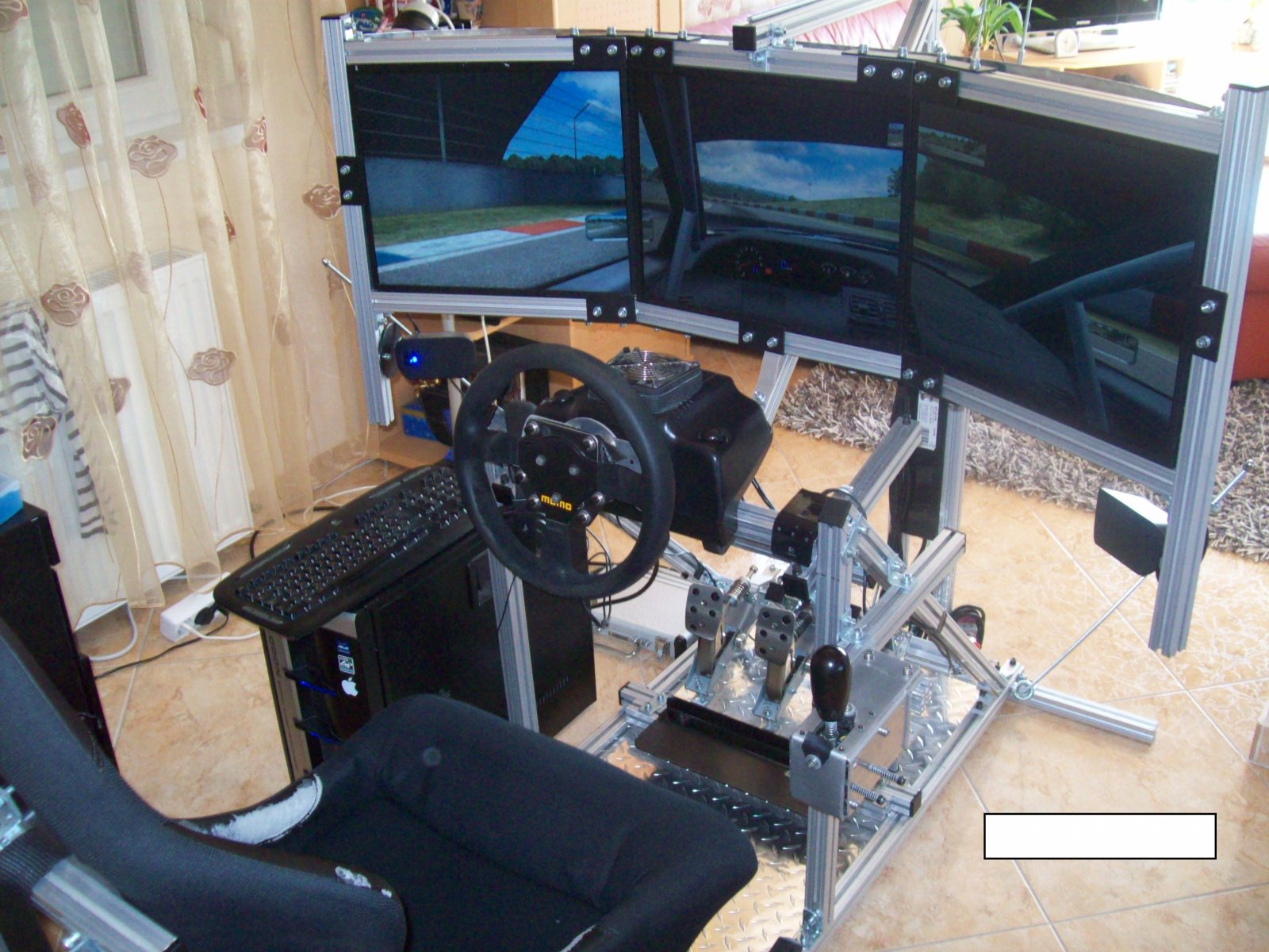

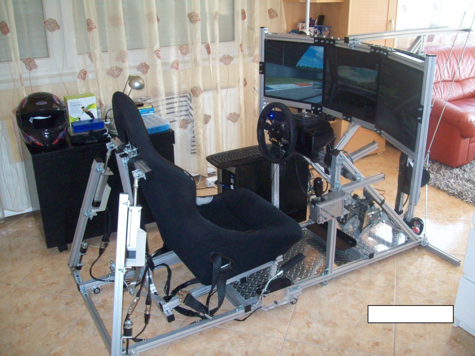

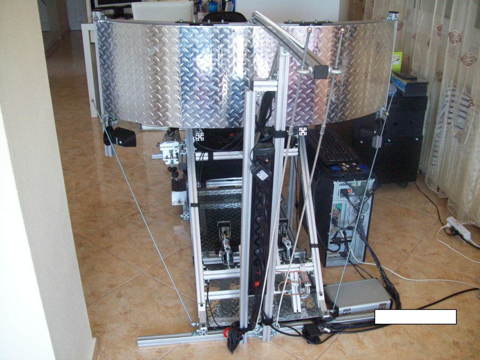

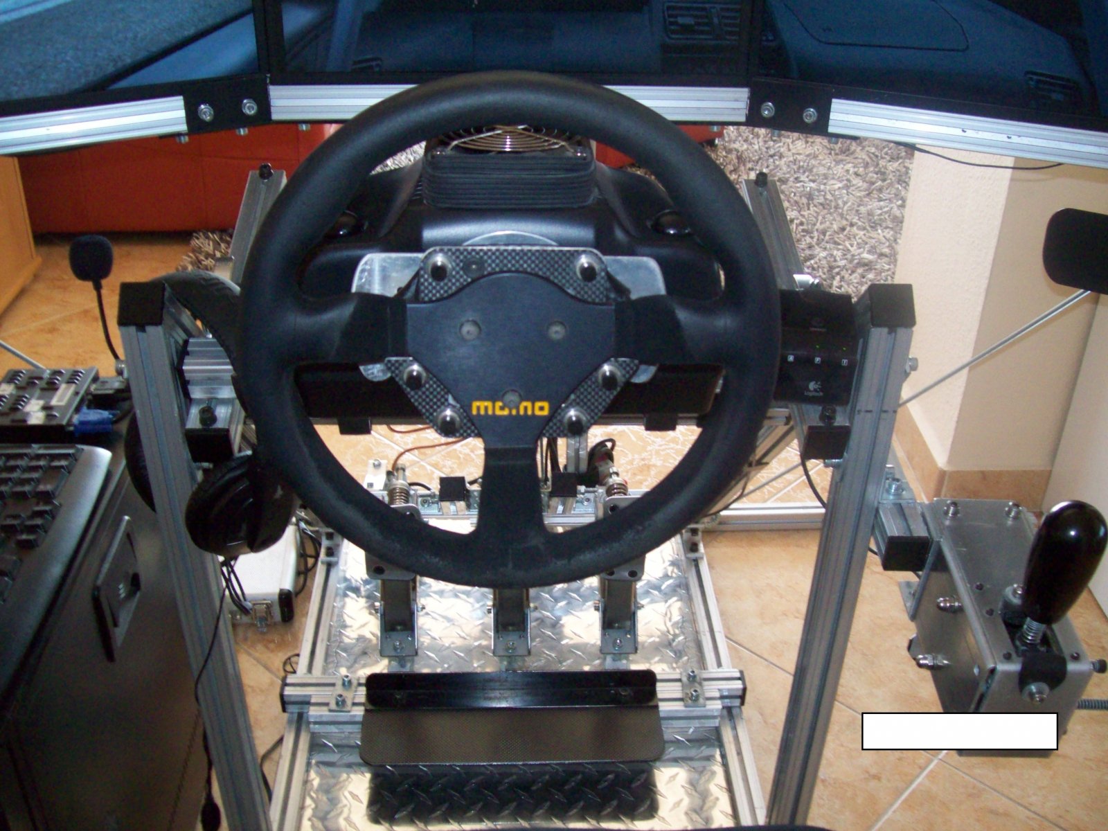

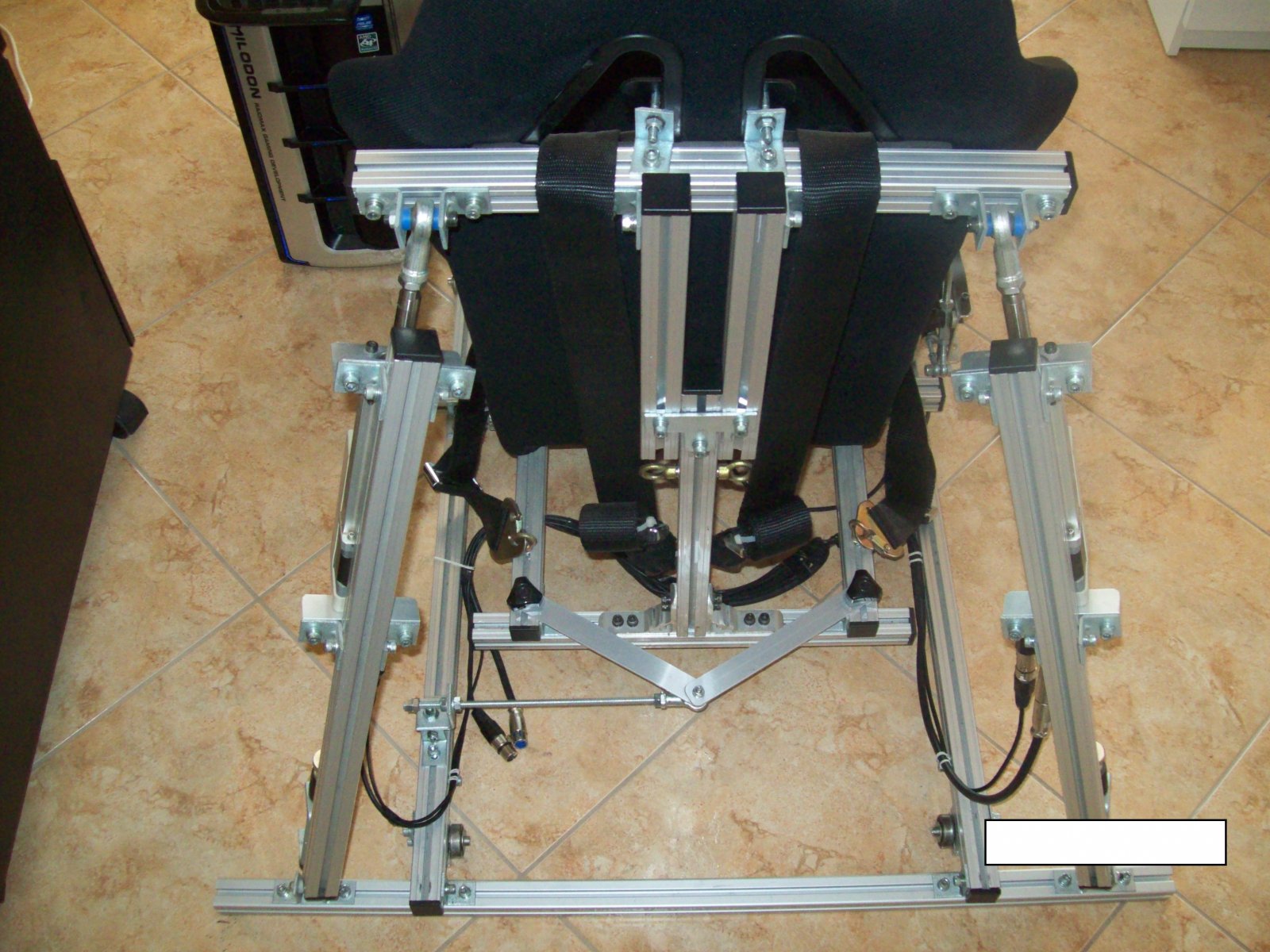

    As all of you, I built a sim too :)
    Asked me to post some picture, so I post here, I think this is the best place to do this.
    So, here some pictures about my sim.
    I started with Frex basics but I quicly changed parts to my DiY trials.

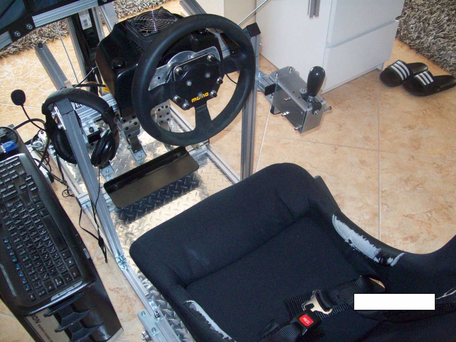

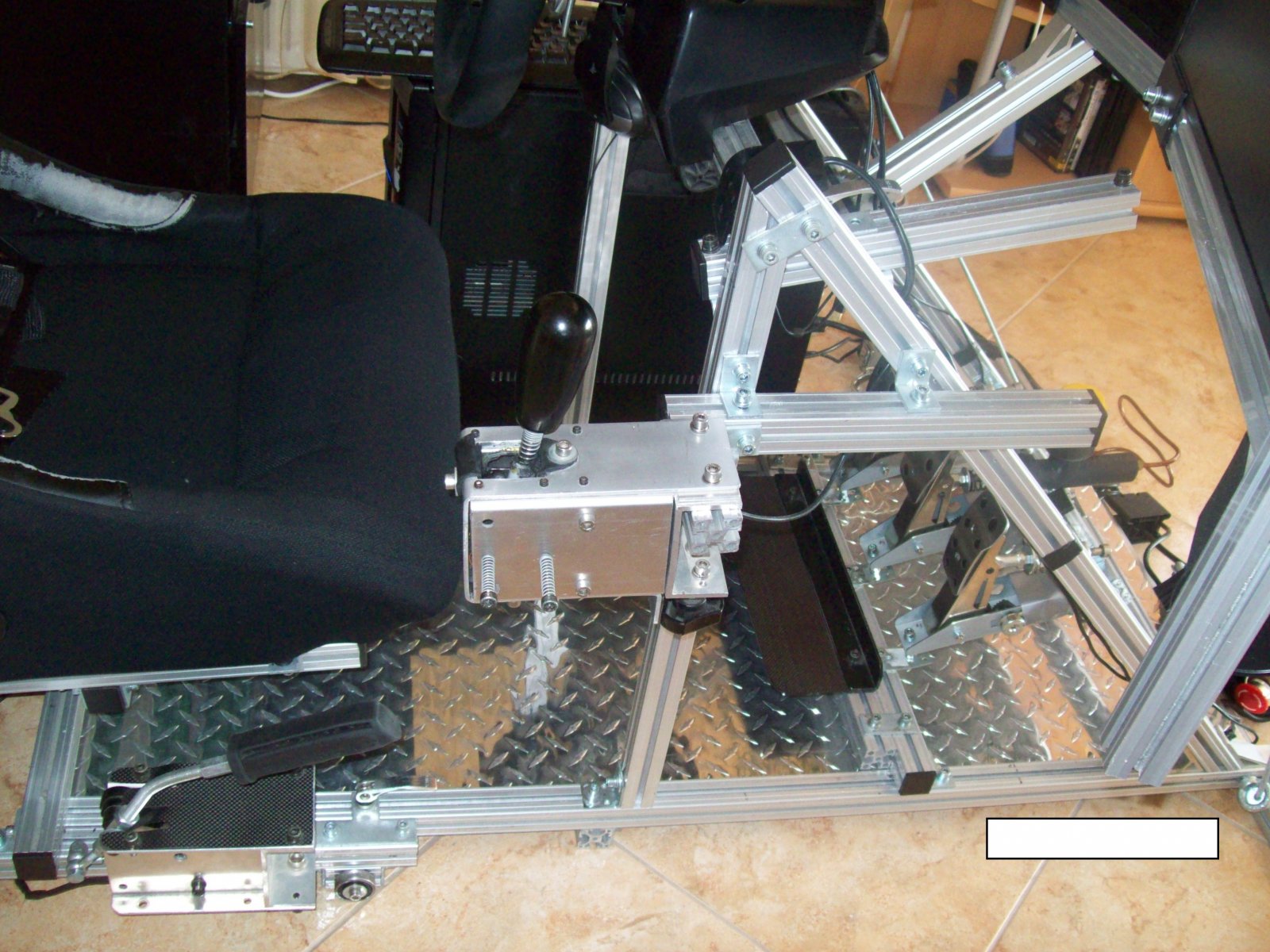

    It's about 4-5 years old, so it's used a bit. I do hardtest on it all the time, must be strong because of the trainings.
    That is why I modded a G25 and I changed everything inside to metals and steels :) Modded pedalkit and H-shifter to make it stronger and made a hydraulic brake system for pneumatic feelings as well.
    Dropped expensive japanies controll system for a cheapest version: I use a simple rs232 to rs 485 for actuators (couple of euros in Hungary...) so I can use this great software called Simtool. :D
    The simulator is massive, strong machine, no problem with it at all. I can recommend by heart, really.
    I know, time to renew some parts and a save money to change my displays to 3D led Tv's, change g25 to at least a Thrustmaster t500 rs (off course it will mod immadiately) and I'd like to build a pro sec-shifter (like in racecars) and a hidro-handbrake for my stepson.
    I decided long time ago beside SCN5, because it's so simple and great developping. More than enough speeding, more than enough informations about g-forces, and it has lot of benefits against others. Only one wrongside is the price of actuators...
    Anyway, this is a neverending story, if you start, you can not stop building and developing at all :)

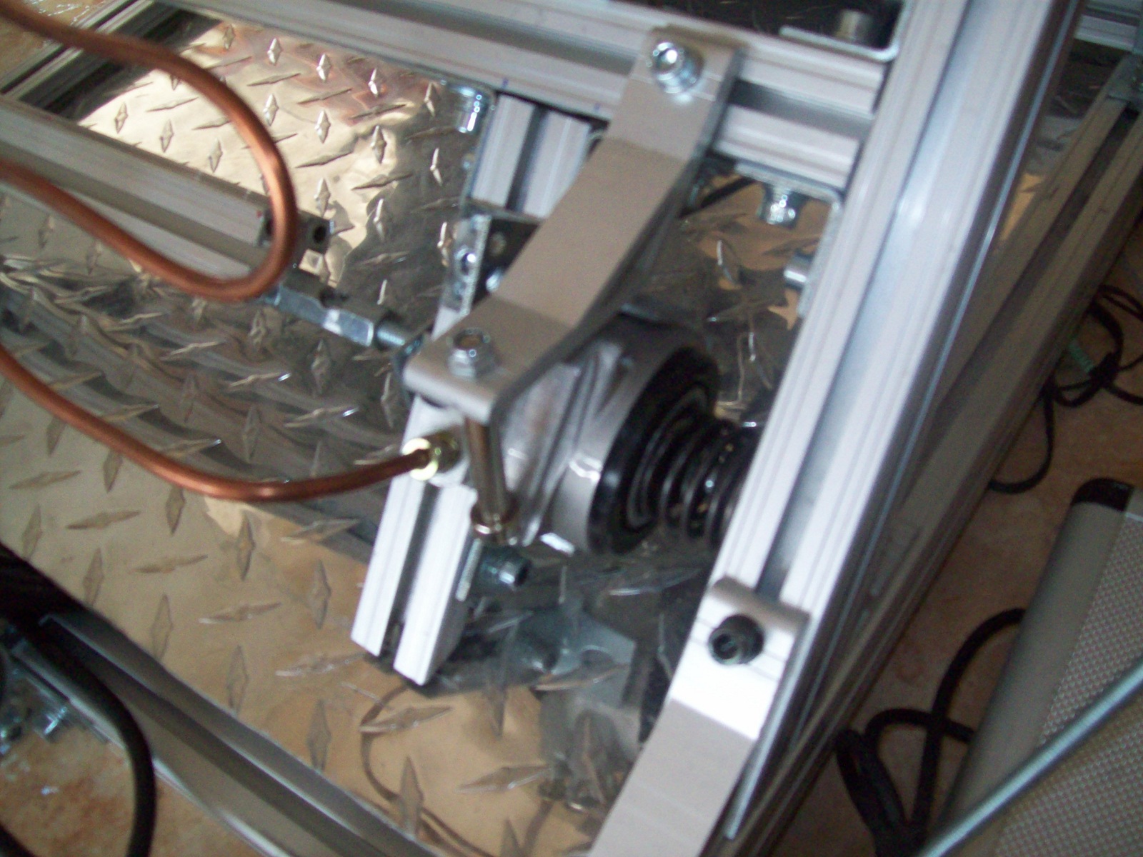

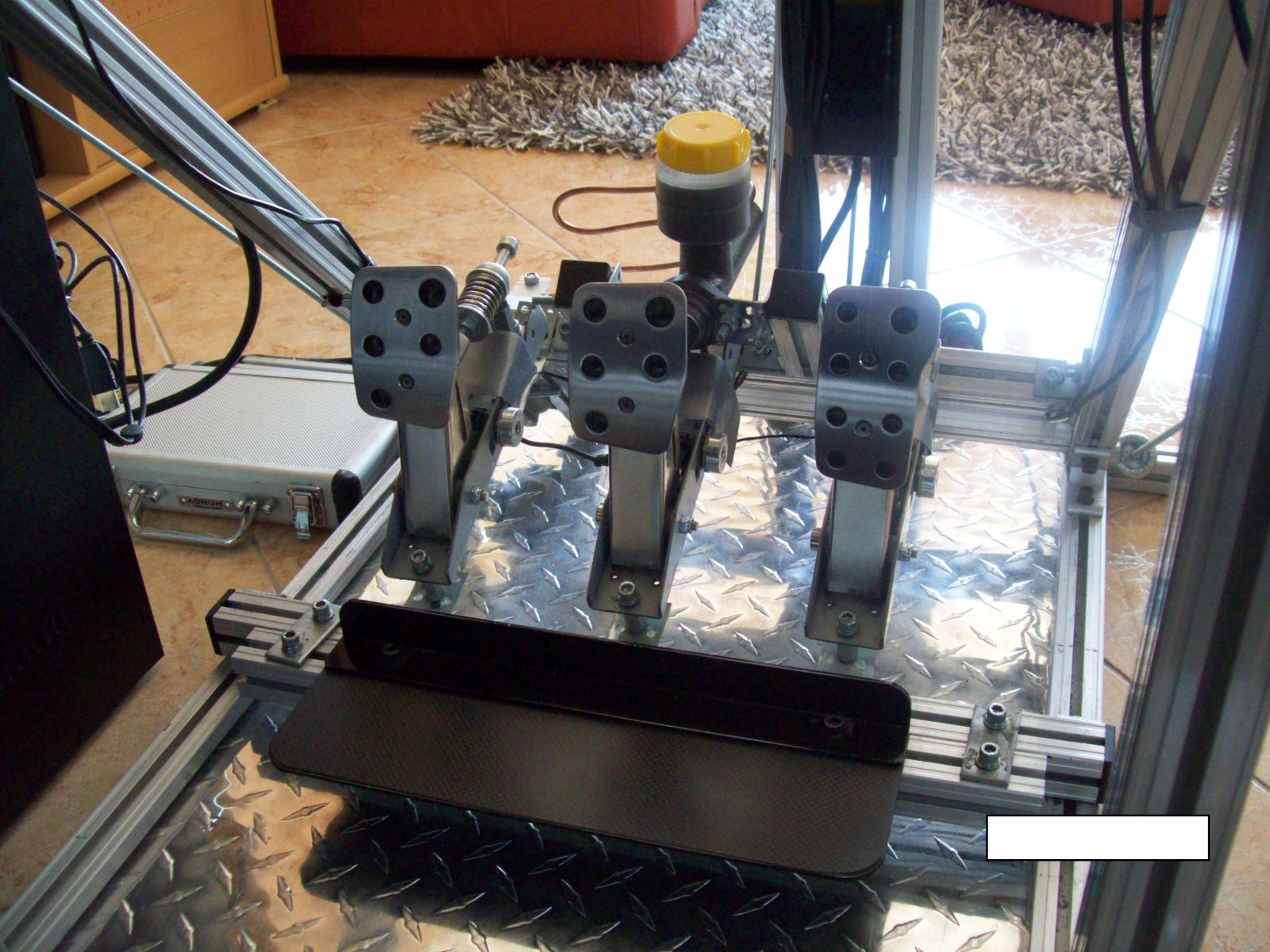

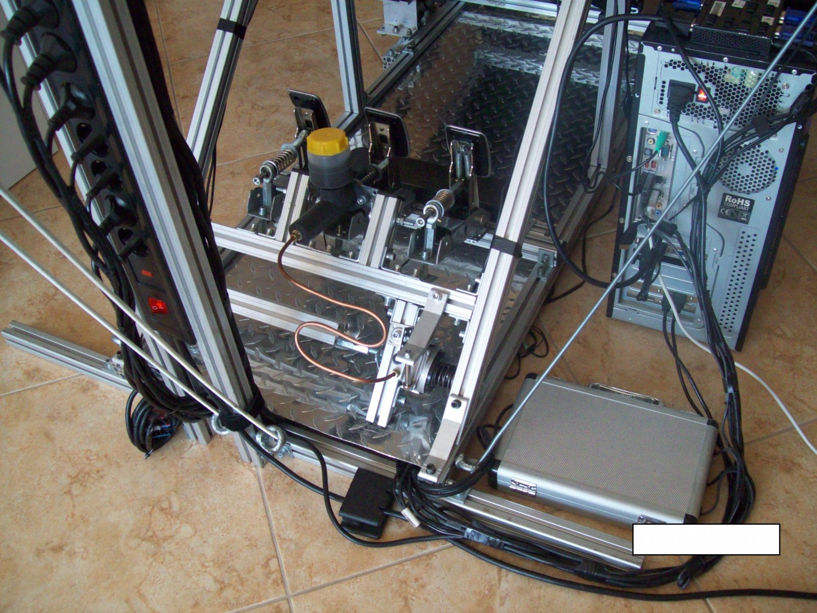

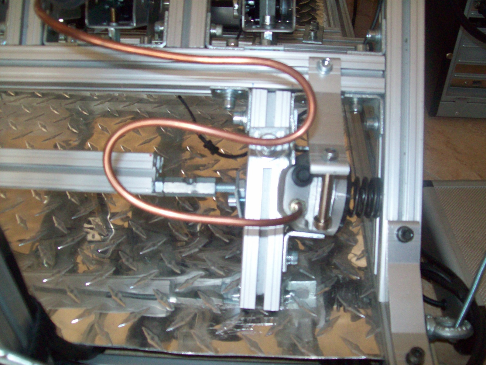

    Cheap hydraulic brake, priceless feeling.
    I made this one year ago, so this period was an endurance test. I was thinking simply, nothing special...
    It works perfect without any problem.
    Sorry to say that have no any picture of mounting, it's a relatively old project. I can post only about finised product by now, if anyone interested to build one.
    What could be more realistic than the real carparts.
    I did not spend lot of money to buy good quality simulator components for that and make some kind of expensive pressure sensor one.
    The pot still more than enough for me. It is true, pot send linear data, even I got good result in feeling. I think enough to feel the pneumathic impact (in my opinion).
    Totally cost around 30 euro (present).
    Fortunatelly eastern carshops still alive in Hungary :)
    I use a trailer master cylinder and a LADA's caliper, what is works against valve spring.
    I recommend to go a shop of used car parts who's wanna feel great braking and don't want to spend lot of money.
    One great thing. Smells like real cars :)
    (Just kidding) only at install
