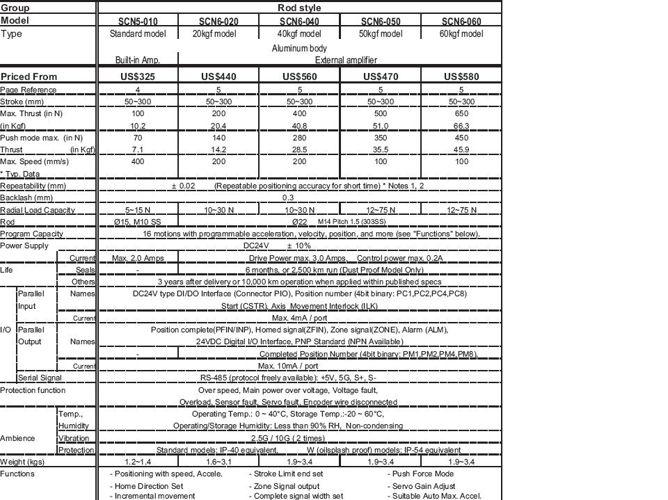

    If I buy 2 SCN5 for 325$ as it is in http://www.miraiintertech.com, which is the post in X-Sim that is best for me to follow having in consideration my already built project?

    The SCN5 you are mentioning are most likely the 50mm ones. But these are too short. You need at least the 100mm ones.
    Regards
    Christian

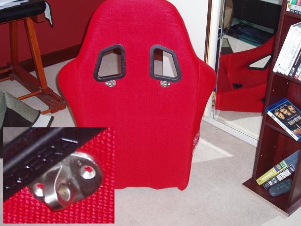

    I have not attached these hooks but I am thinking this is best way too attach the scn5 actuators.
    They might need a plate behind them as they are small. But you can maybe get bigger size and the seat cobra monico has metal back which you can drill through. hook.jpg

    Now i'm confused. I read bvillersjr's post (viewtopic.php?f=22&t=1528&view=next), and he said:
    I went to http://www.miraiintertech.com/home/scn5.php and got the following description as you can see in the file attachted. And already sent an e-mail to them to confirm the measures....
    Which is the post in X-Sim that in your opinion is a good solution for me to read after buying the actuators?

    It was a typo most likely. Mirai sells the 100mm ones for 400Dollar.
    You can get them a little cheaper from http://www.frex.com/gp
    But I dont know if they provide product warranty if they know that you are not using them with their motion hardware.
    As well they have other type of connector for power supply.
    It's up to you, but I would propose to rather order the 100mm ones from Mirai, if you asked me.
