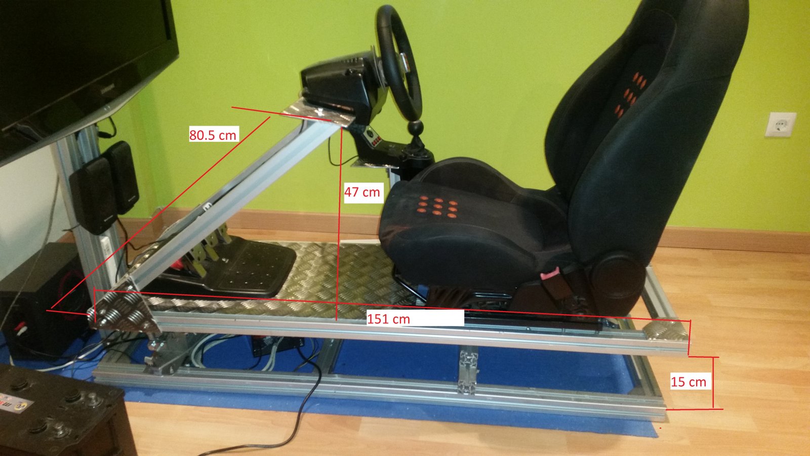

    Hello I present my project 2dof with front engine and hidden.
    to see if I can just enjoy it and can not wait.
    The cockpit is handmade and is all aluminum.
    Aluminum parts donated by my brother
    Scrapping the seat is given by a friend
    I bought motors and screws.
    and midfielder g27

    Thanks for sharing the pictures of your simulator, the construction looks nice and clean. Do you have a video of it in action?

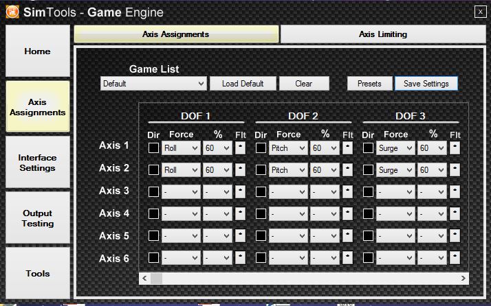

    Hi if I have a video I upload tonight that I have to edit
    Although it not is running simtools but is working.

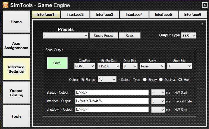

    the problem that I have with simtools is that when I connect the battery moves me to a position engines and when I open the software I get to do the test in motion leaves me another position axes.
    you know how to adjust this I followed the manual racingmat

    hello!
    congrats for your building skills
    your concern sounds like "startup - output" and "shutdown output" setup is not done in Game Engine
    can you paste some screenshots?

    I've checked the connections and are well-connected
    ok thanks

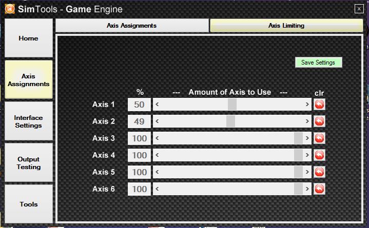

    You have too large an Axis allocation total, it should be close to 100% and you have 180%, see here: http://www.xsimulator.net/community/faq/axis-assignment-percentage-totals.120/
    I am guessing you have axis limiting low because you are concerned while setting up. Normally it would be 100% and once you know everything works put it back to 100% before spending a lot of time refining a motion profile..
    You can download and follow @Pit's guide to developing a motion profile: http://www.xsimulator.net/community/faq/comprehensive-guide-to-simtools-and-arduinos.118/

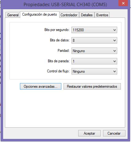

    and according to the code, "output bit range" should be 8 bits and not 10bits

    hello thank everyone for the support I am glad that this forum so alive.
    at the end of the movement that was moving on and the proof was the start of 10-bit I've already changed to 8 and it works.

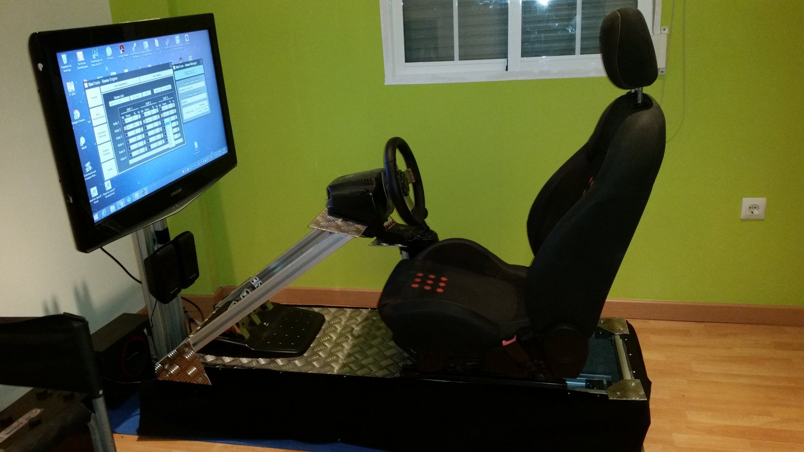

    Hello every time I am leaving the simulator more about these advances have done all thanks to this great forum and support you in your and this great program.
    I have some photos
