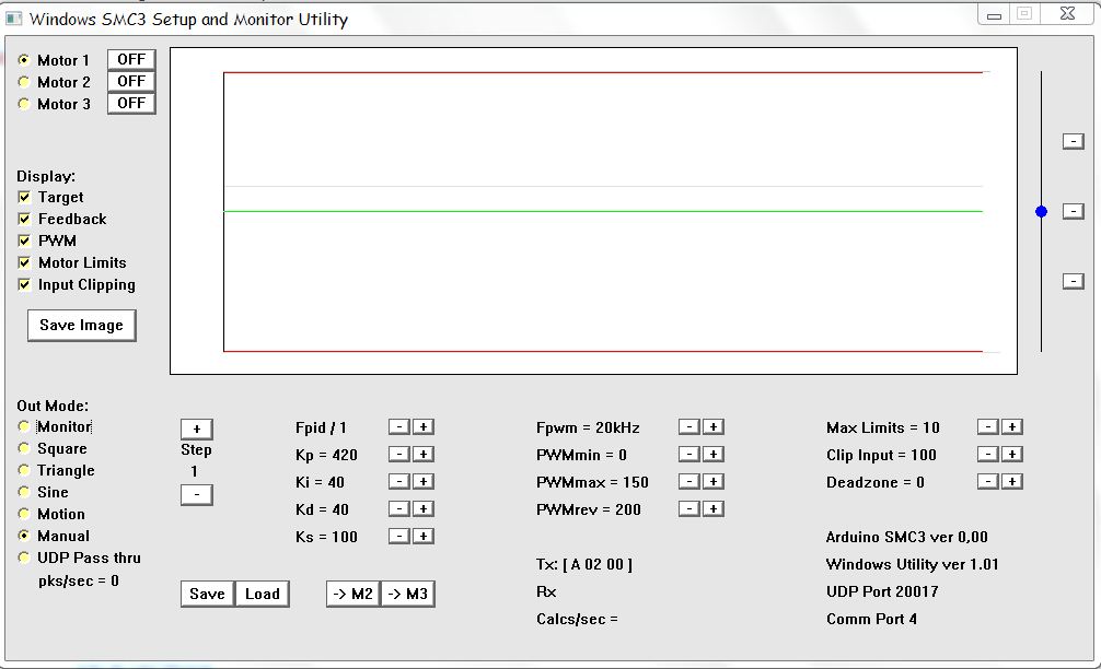

    Hi. I am having problems with my engine. Pots are working engines spin but only near the limit of 5v. If I select Motion in smc3 util nothing happens. What settings did you use in smc3 utils for those motors. I am atm clueless. Have tried also different arduino but the same results.
  5. Arielnac
    Arielnac Member
    Nov 20, 2017
    79
    Argentina
    240Coins
    +35 / 0 / -0
    Hi. Are you using BTS7960 ???? You set MODE2 in the line of code for the arduino ???
  6. iLLuac4
    iLLuac4 Active Member
    Jun 19, 2019
    136
    893Coins
    +58 / 0 / -0
    Yes I did. Can you screenshot the settings of your motors from SmcUtils please?
  7. Arielnac
    Arielnac Member
    Nov 20, 2017
    79
    Argentina
    240Coins
    +35 / 0 / -0
    Keep in mind that SMC3 is a software for testing and its use can burn the BTS7960 even without load on the motor shafts, since it can generate very sudden movements of them. For example, if you use the maximum power and generate a sharp change in the direction of the motors.

  8. iLLuac4
    Jun 19, 2019
    136
    893Coins
    +58 / 0 / -0
    TNX. I was able to get one working. The other one is still a mistery. Hall sensor seems to work but motor spins only in one direction. Will try with spare BTS7960. It is also funny that I have burned the fuses on the motor that I have implemented in my setup on one motor. Will troubleshoot further.
  9. Arielnac
    Arielnac Member
    Nov 20, 2017
    79
    Argentina
    240Coins
    +35 / 0 / -0
    If the engine only makes movements in one direction, it is because one of the BTS 7960 chips of the IBT-2 was burned. That's why I told you to be careful when using the SMC3. I advise you to work with 18V unless you are going to burn the IBT-2 when using simtools.

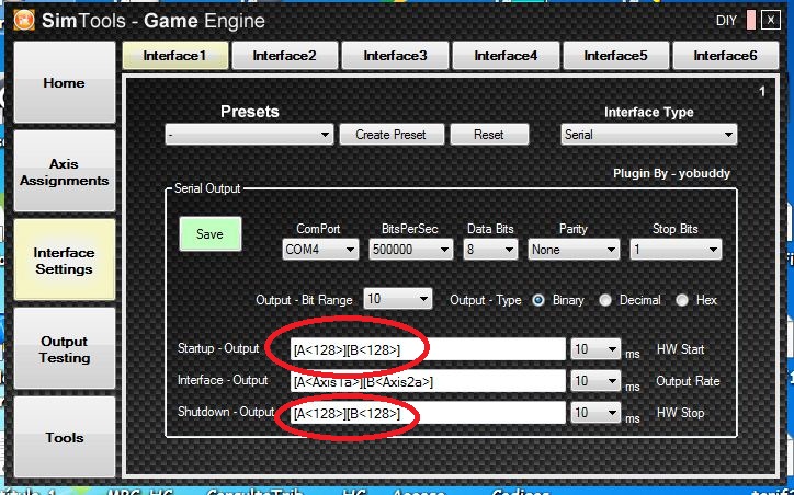

    What you should do is first turn on the computer, once I load simtools, just there you have to energize the power supply. The motors are going to position themselves in the neutral position.
    The motors in this case do not have a specific polarity. The polarity will be given by the correct movement of the axis with respect to the sensors
    So that the axes do not have that small movement, there must be a little load on the lever. When you have the platform mounted you have to look for some weight. that will neutralize the small slack of the engines.

    I prefer to do it manually, it is no problem to do it and it gives me the assurance that the motors receive energy once simtools tells arduino what the neutral position is.
    Just there I get on the platform.
    The neutral position is given by the axes setting, usually at 128 which corresponds to the 2.5V of the sensors.
