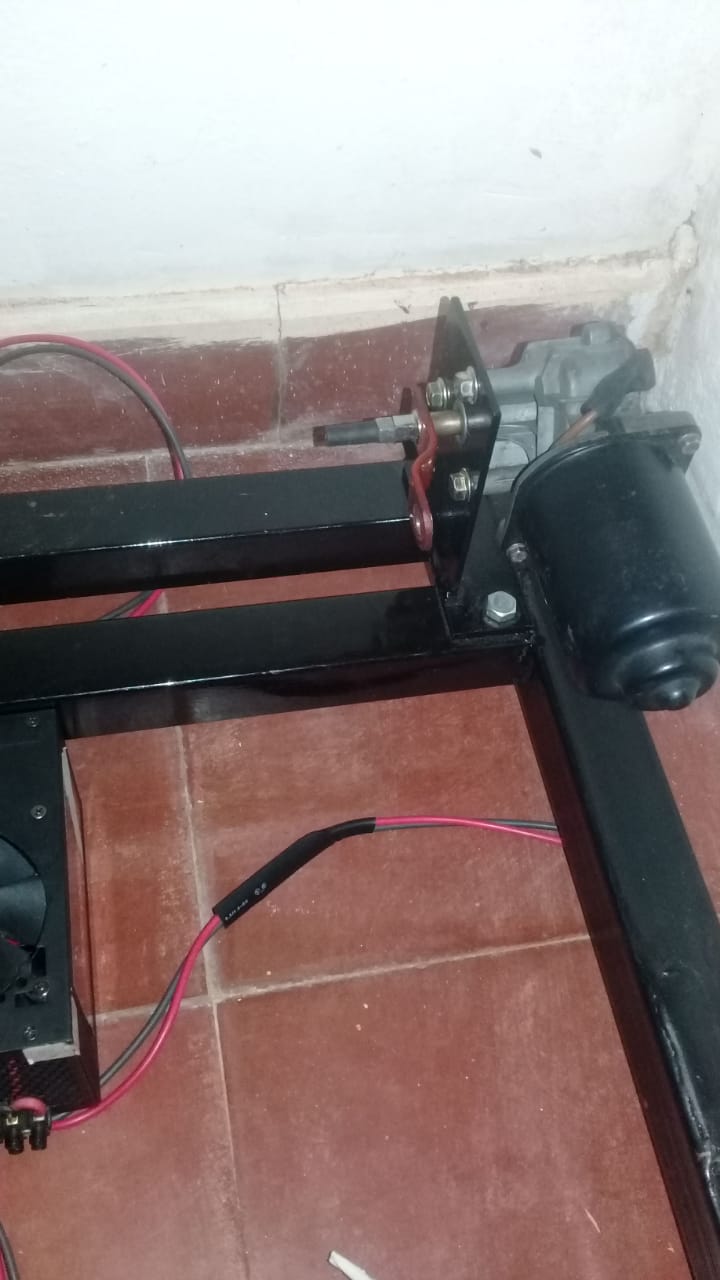

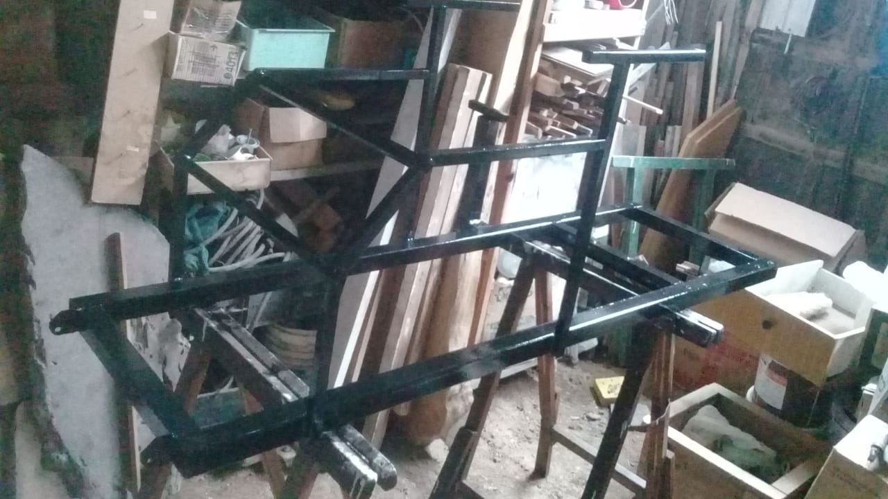

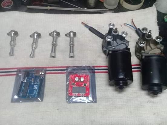

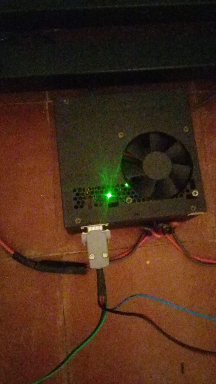

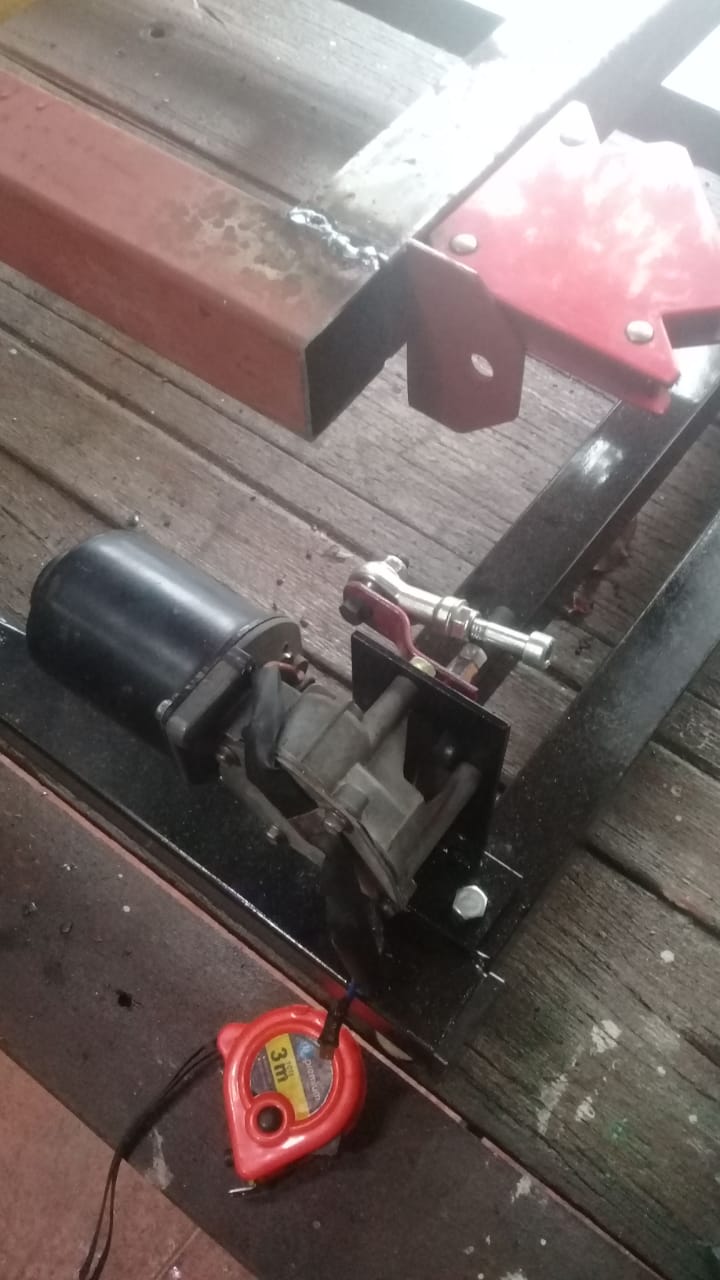

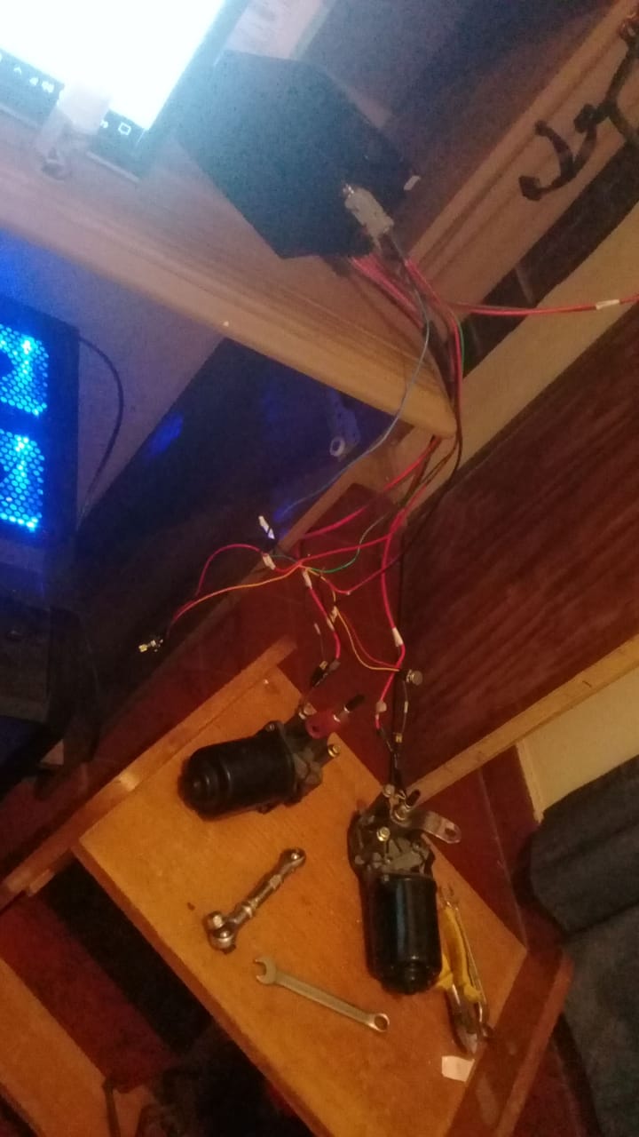

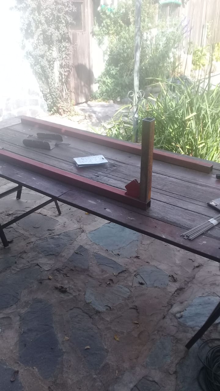

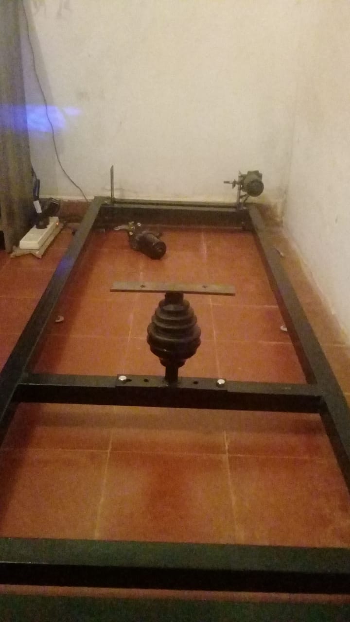

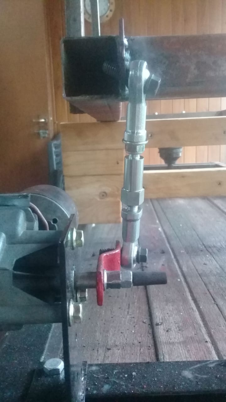

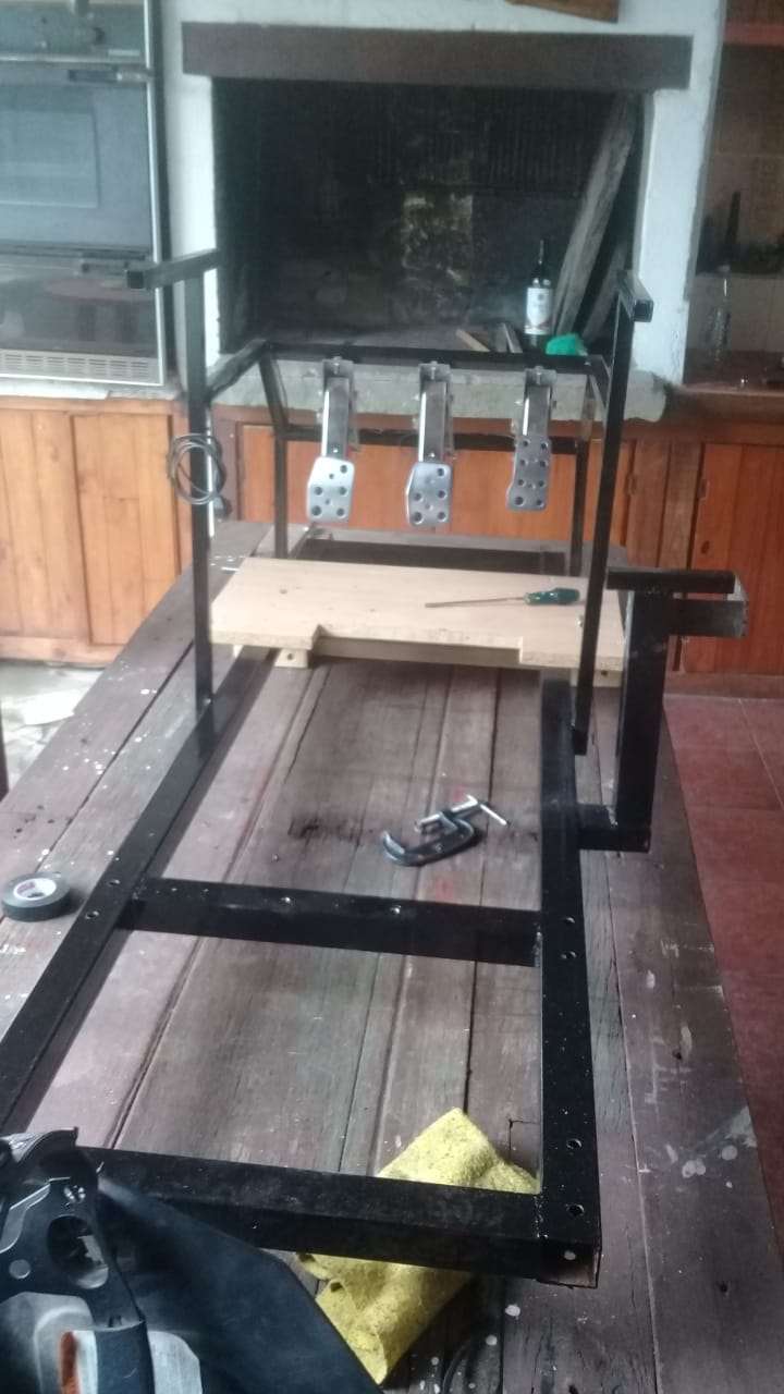

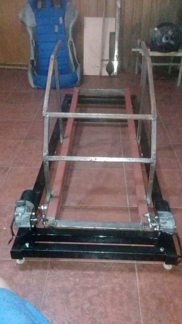

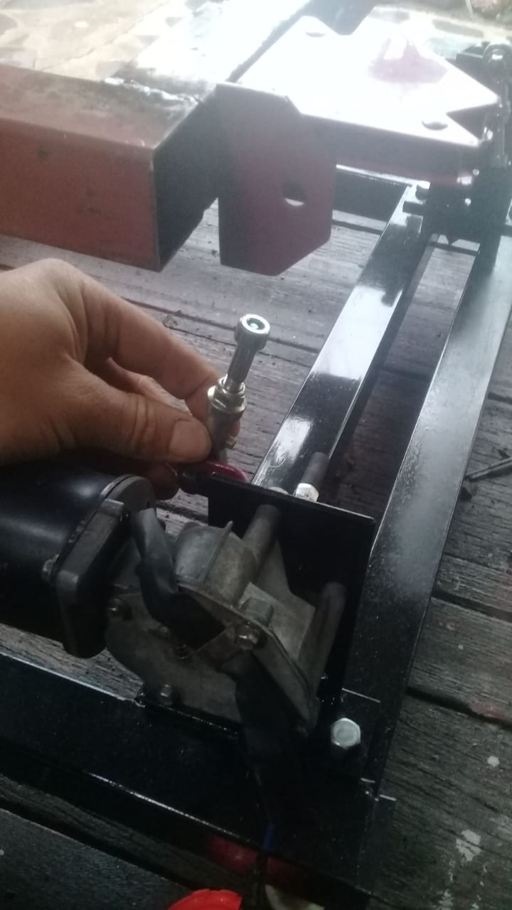

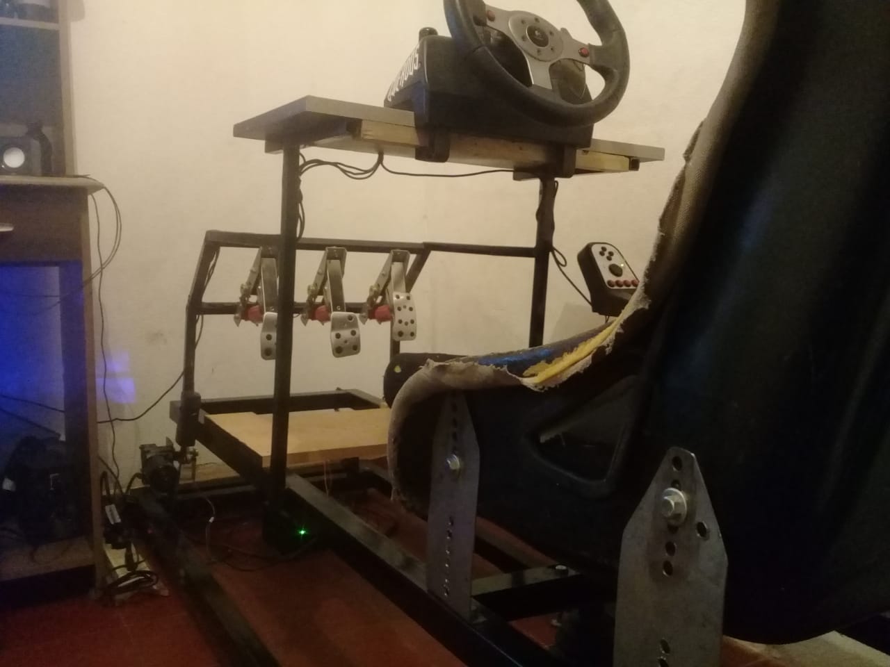

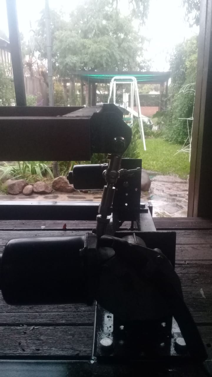

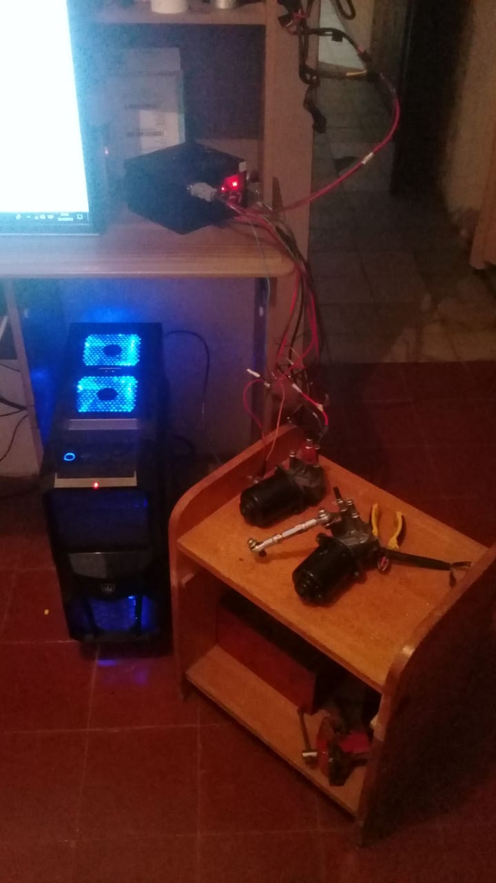

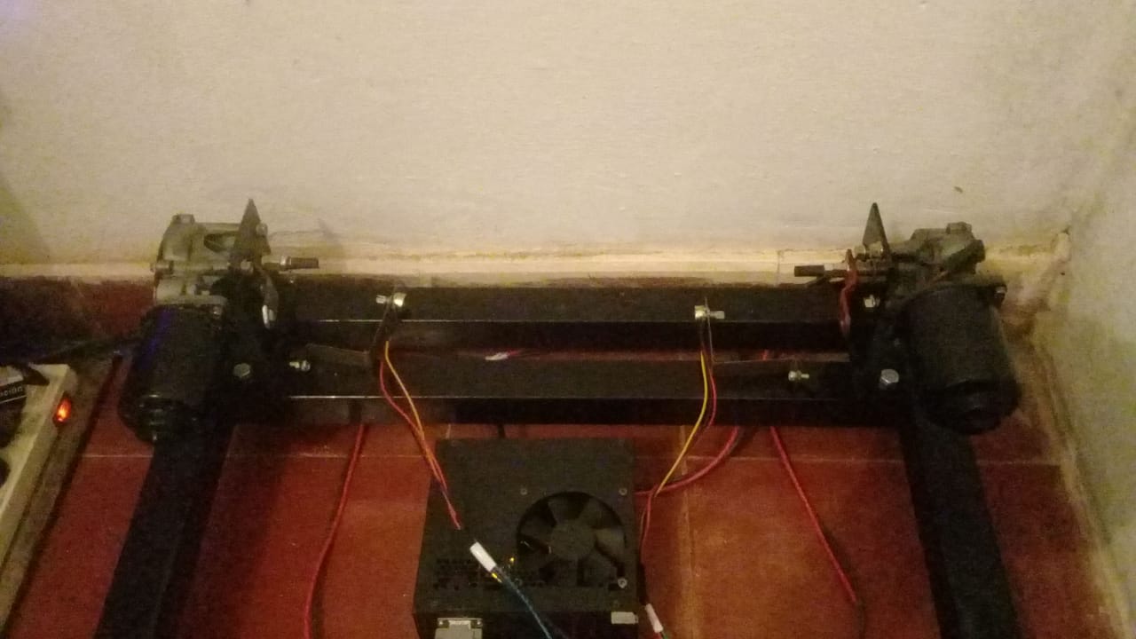

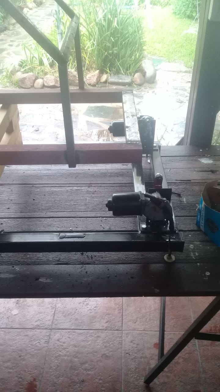

    IMG-20190427-WA0277.jpg IMG-20190427-WA0279.jpg IMG-20190427-WA0267.jpg IMG-20190425-WA0083.jpg IMG-20190427-WA0275.jpg IMG-20190424-WA0055.jpg IMG-20190427-WA0272.jpg IMG-20190427-WA0269.jpg IMG-20190427-WA0277.jpg Hi my name is Pablo Ochoa, I'm from Mina Clavero, province of Córdoba, Argentina ..
    I present my 2DOF project.
    After trying two different models of structure I tilt for the side to move the whole structure, with the engines ahead and move the entire platform.
    With the help of some friends who are here in the forum with similar projects I have managed to finish my project.
    It has two glass cleaner motors, Arduino Uno R3 board and a Monster Shield.

    nice job but im confused by you saying the motors are GLASS CLEANER MOTORS ? where did you find them?
  6. pablo ochoa
    pablo ochoa New Member
    Apr 11, 2019
    7
    176Coins
    +9 / 0 / -0
    I mean clean buffalo brand windshield engines

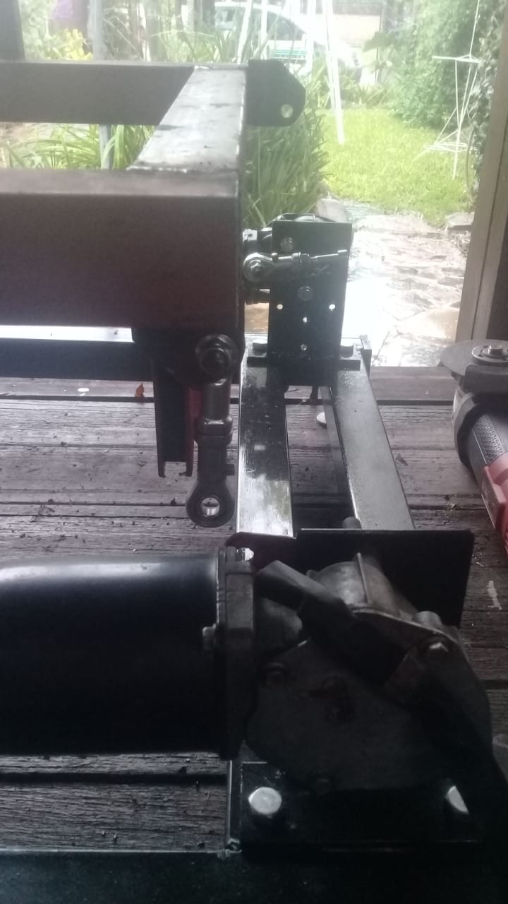

    i have a similar setup but one thing i wish i could and probably will is taking out the u joint for the pivot and replacing it with a 200 lbs compression spring to give heave . i think it would smooth the ride out a lot. ... that bottom framing. is that a 2" bed frame followed with 1" square bar on the top frame?
  8. pablo ochoa
    Apr 11, 2019
    7
    176Coins
    +9 / 0 / -0
    I think I should endure well. Use a 40x40 spout 1.2mm thick and support it well.
