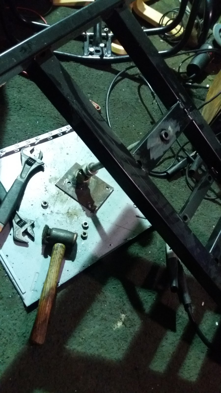

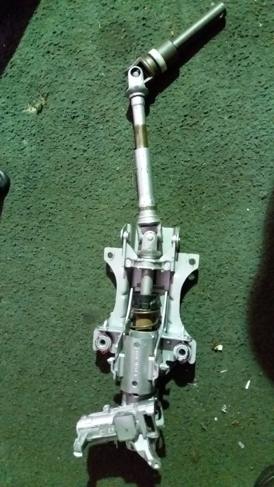

    I acquired a steering column shaft inclu. CV joint.

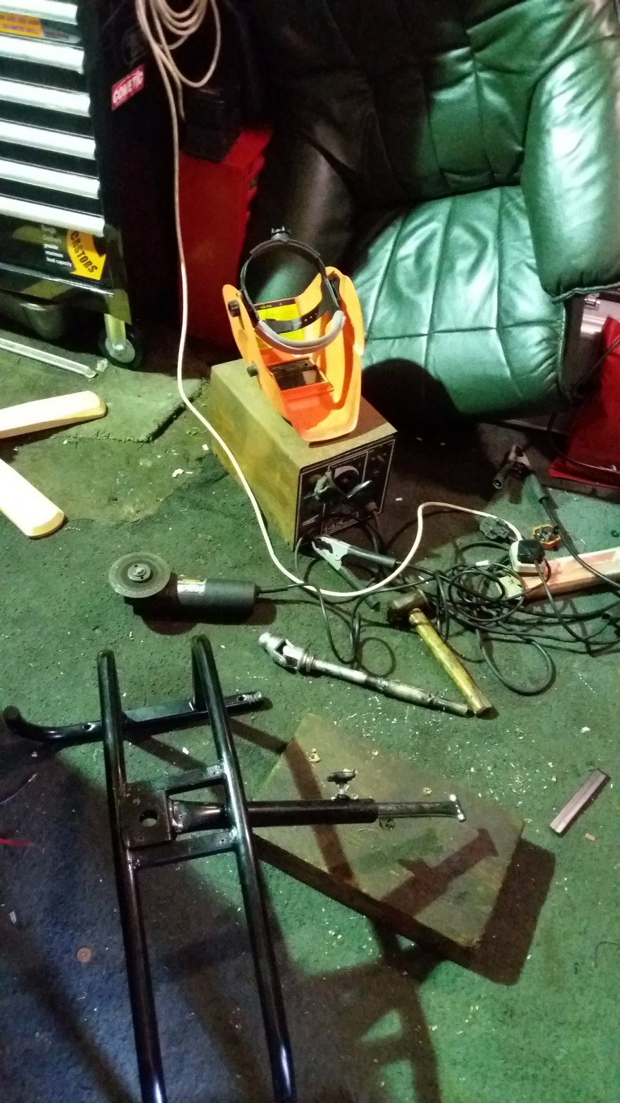

    This was chopped and mounted to my steel base. the exec chair was modified to fit. The leather seat can be removed from its steel cradle making setting up fairly straight forward (levelling, welding etc).
    I then set about making up some motor mounts, making brackets and cutting 10mm threaded bar to use as the actuator arms from motors to chair.
    Build images follow;

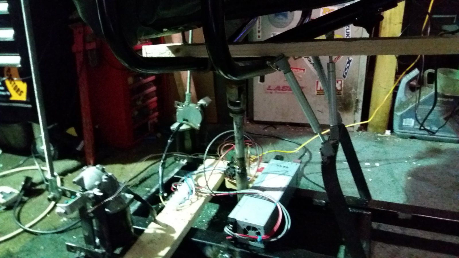

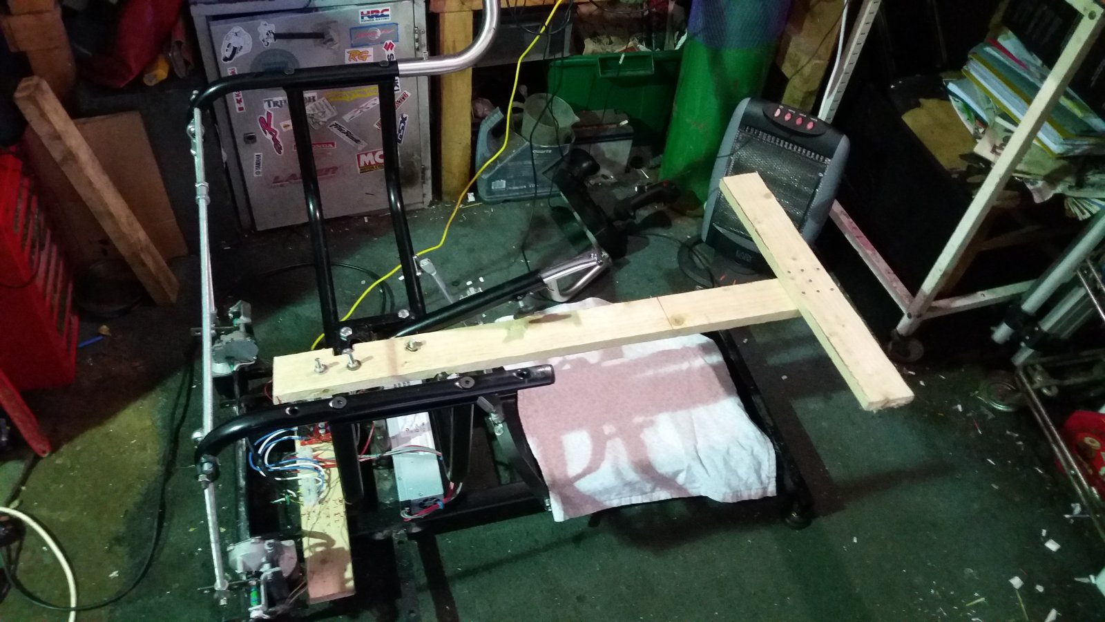

    more build pix focusing on mounting the chair cradle to the CV joint;
    fitting uj.jpg finished uj closeup.jpg making the pivot.jpg levelling - large motors.jpg
    The 12v wiper motors arrived so I gave them a bench test with ED and joystick (did this on the dining room table as missus had gone away for a couple of days and garage was bloody cold!);
    Next task was to get fit these wiper motors to the sim chair and get the chair moving.

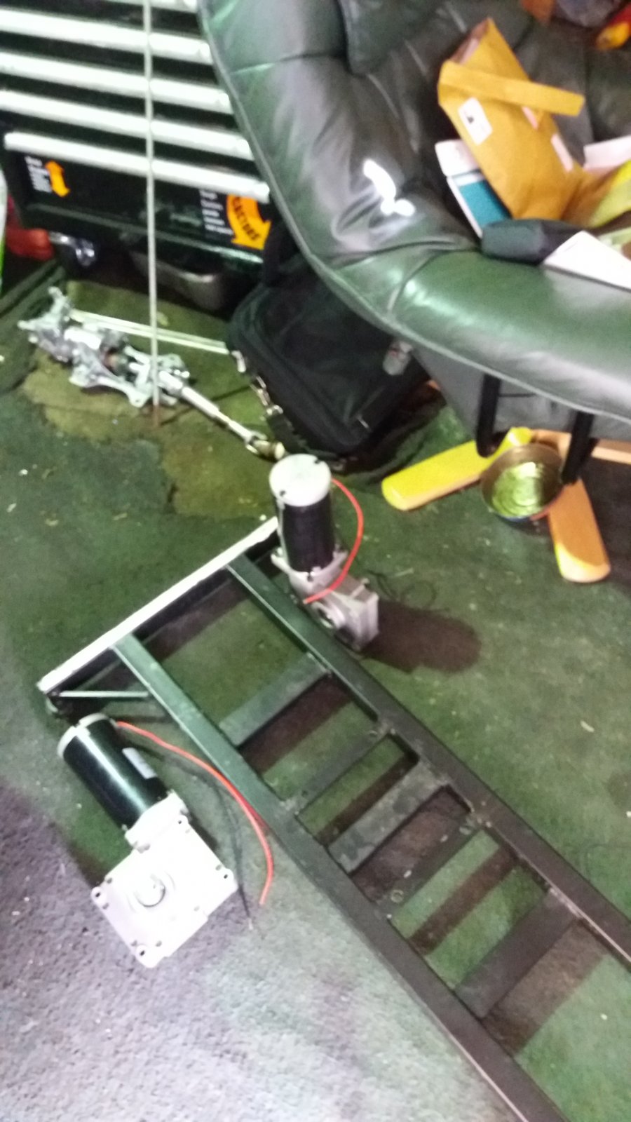

    More build pix
    monster moto cooling.jpg wipers and arms closeup.jpg wipers and drives close up.jpg
    Next job was to mount and zero-up the pots, boot up Simtools and ED and hopefully the seat cradle will move;
