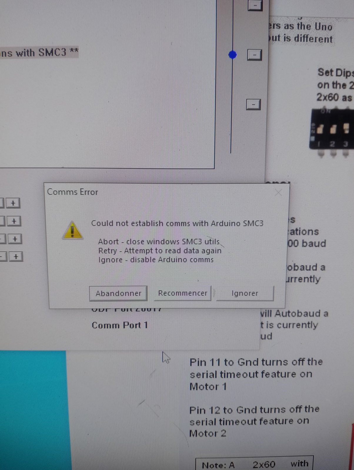

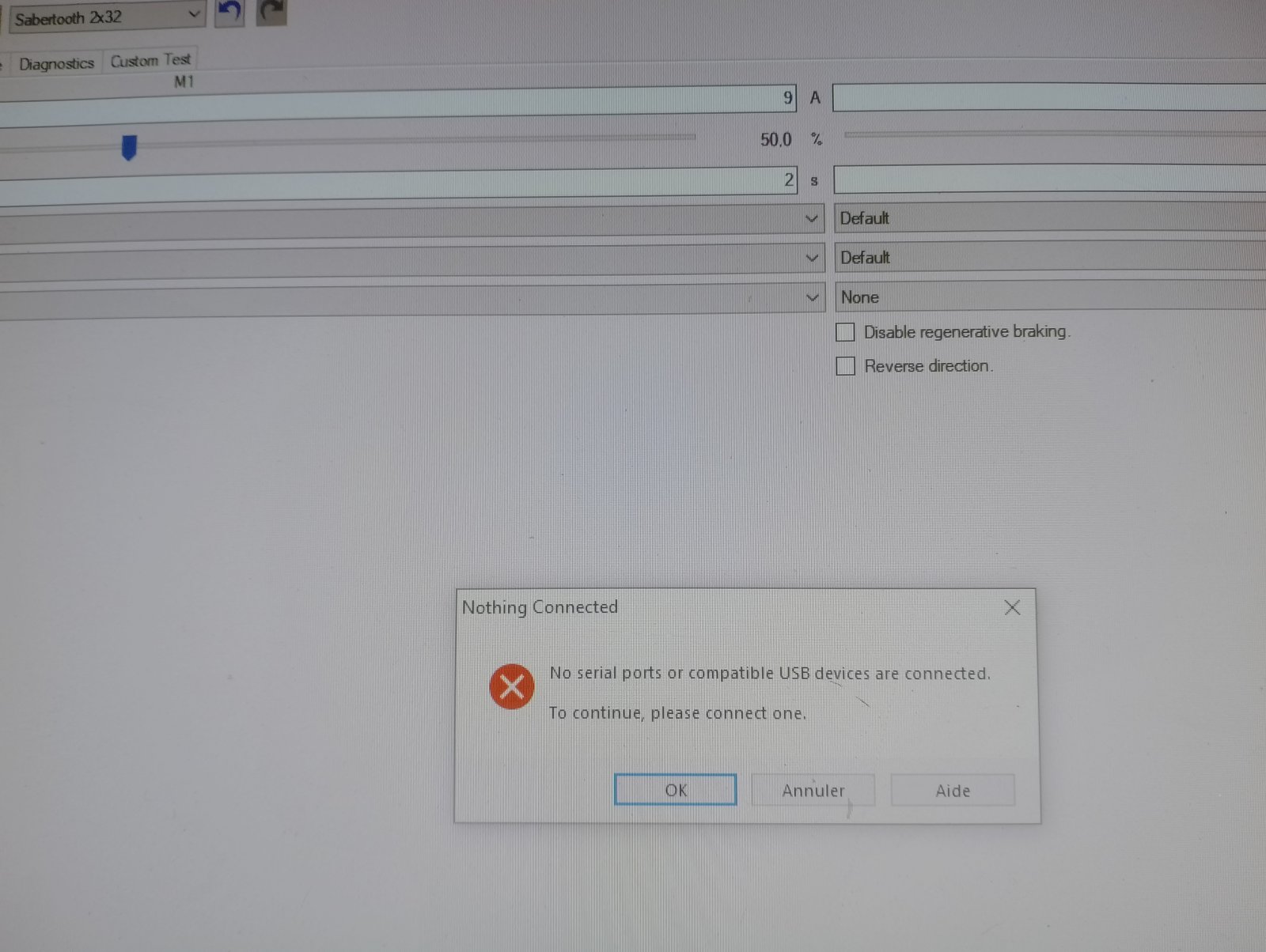

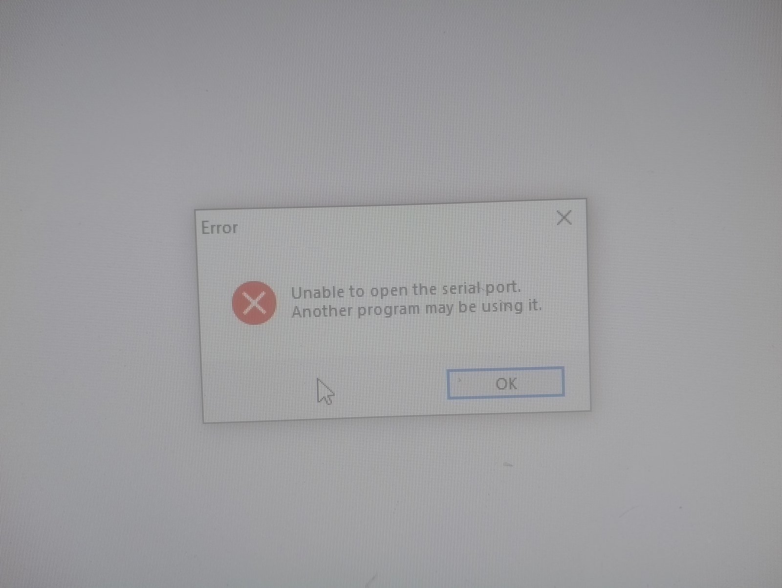

    hello friends. after a few years of absence for family reasons, here I am to continue my project my 2dof simulator, I bought a new sabertooth 2*32 card but the problem is that my computer does not arrive there. recognize on USB. I have an error. there was someone who could give me a hand it's very nice friends keep it up. thank you

    Can you please post a picture of the error, so members have some context and basis to offer advice.

    This seems to suggest you have two programs running that are trying to access the same ComPort:

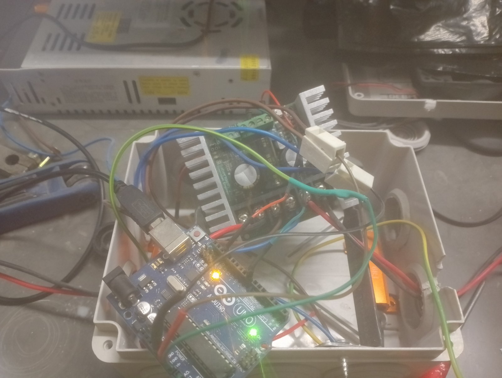

    Hello friends thanks for answer I will answer Noorbeast first I did the programming without any USB plugged in and it gives me this now. I put a photo I also have the green and red light that comes on at the same time. thank you

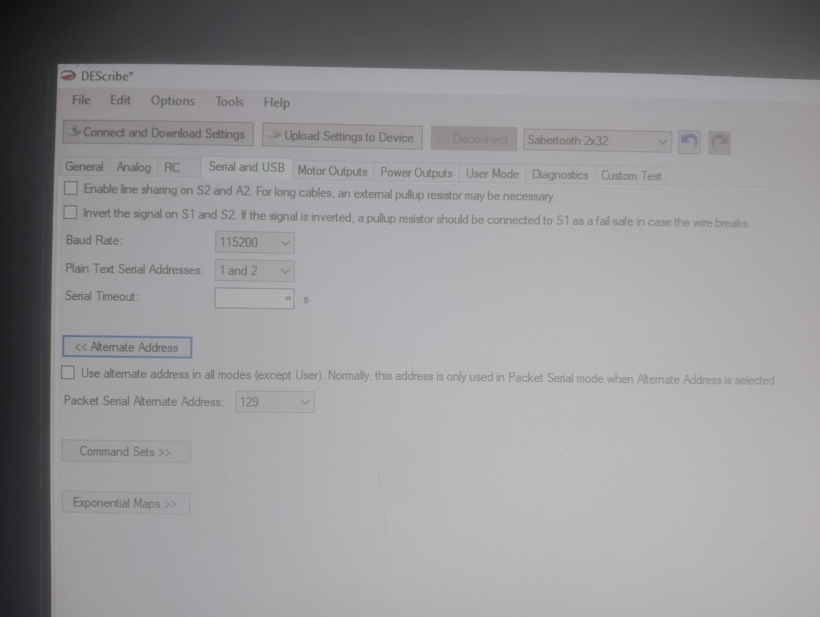

    Hello I just downloaded the file you asked me for but I have an error that is displayed immediately like this photos. thank you

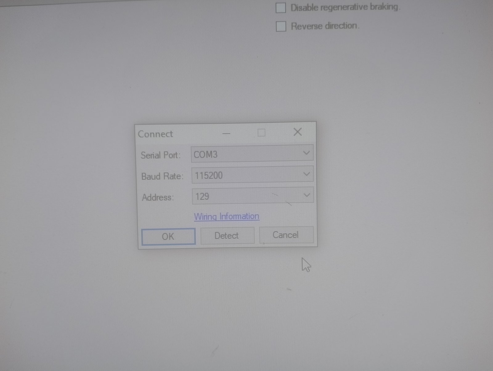

    My guess is that you are not using the correct port in SMC3. You can find the Arduino in Device Manager of Windows, note the correct port number, then configure SMC3 correctly.
    Also make sure the Arduino IDE is correctly configured for the Uno.

    Hello thank you for your answer yes I will do the configuration I will put photos to follow the evolution good continuation to you thank you very much.

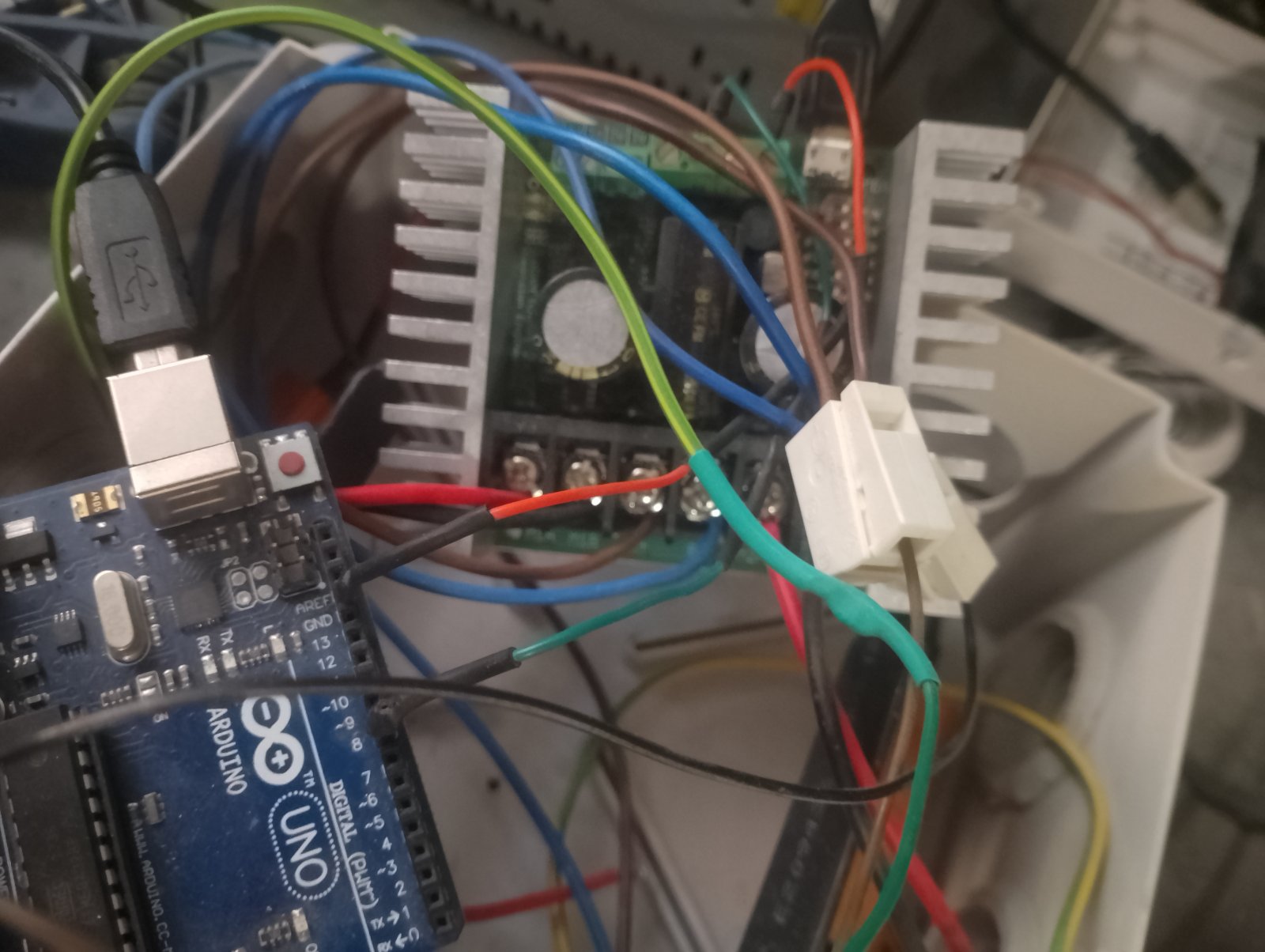

    hello friends following several messages posted I managed to connect my tout savoir card to my computer knowing in fact that it was a usb cable which was not good

    Me the problem that now it disconnects every time

    Under what circumstances do the disconnects happen? As soon as you plug it in, or during violent movement, say like in a crash?

    hello every time I shut down the computer and I come back the next day to make the new settings well that's when it shuts down I have to reset. thank you

    That sounds like it could possibly be a port conflict, are you running SMC3 and SimTools at the same time, or anything else using the same port number?
