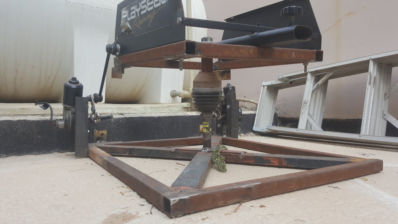

    I really need diyy license...

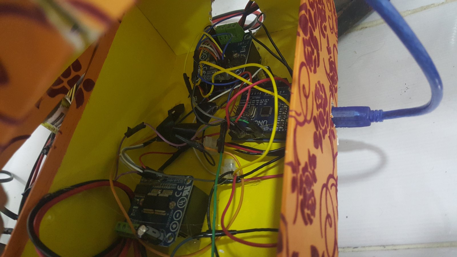

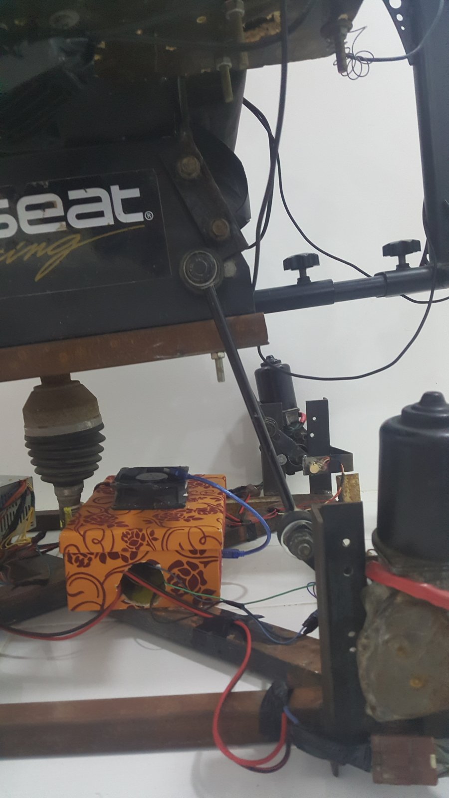

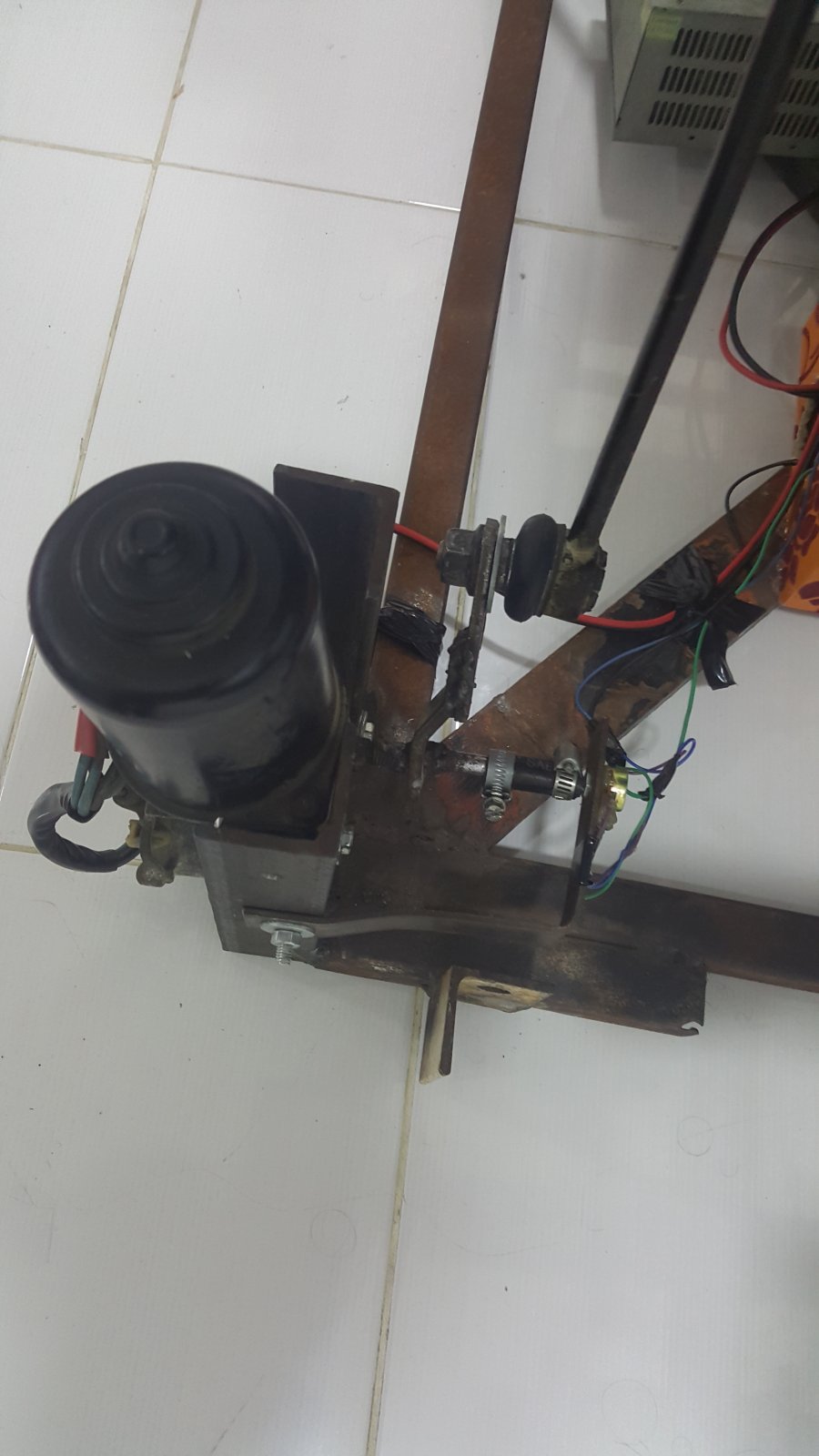

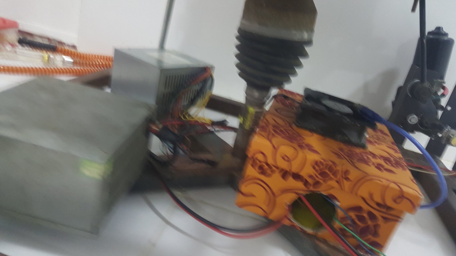

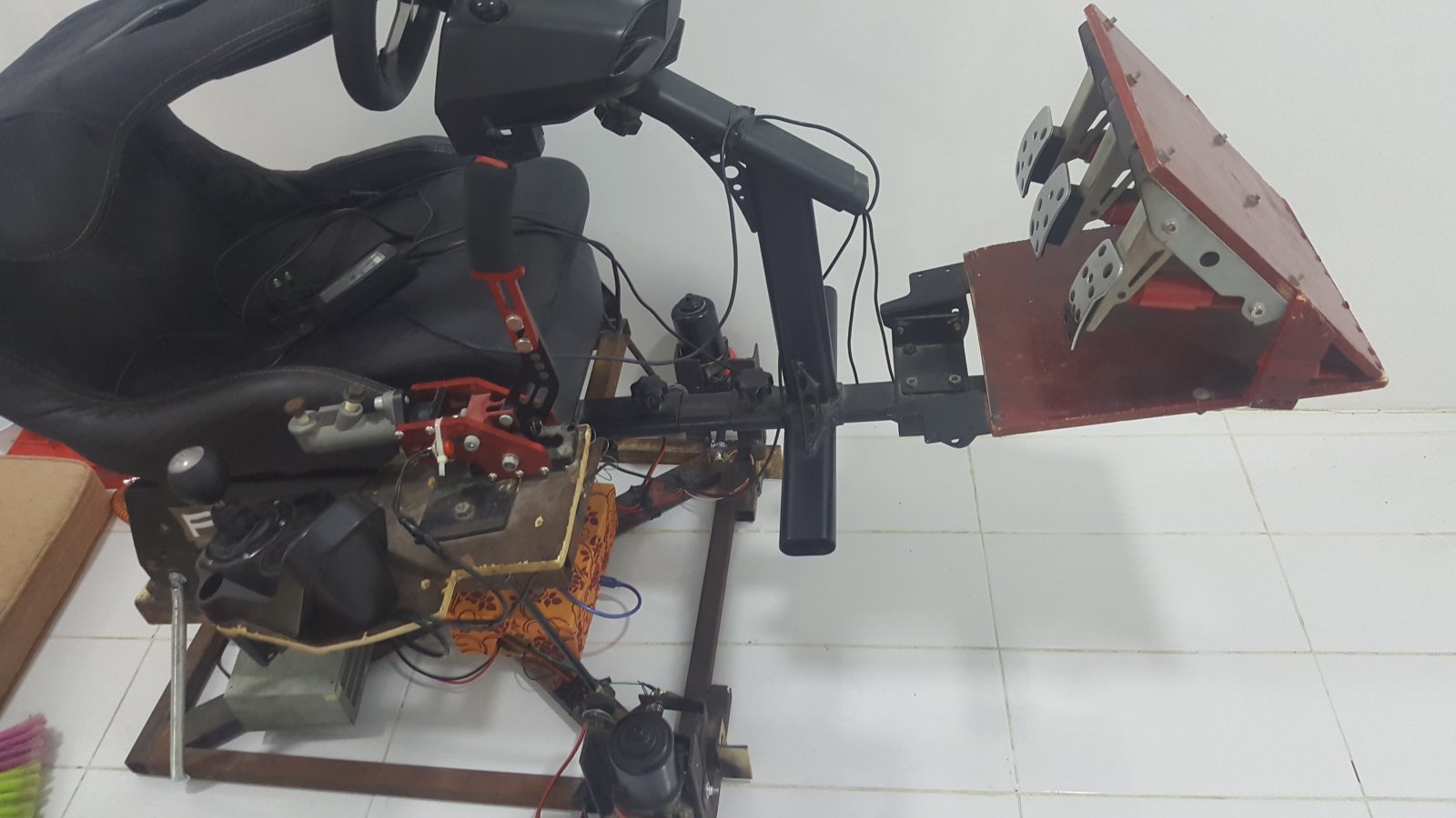

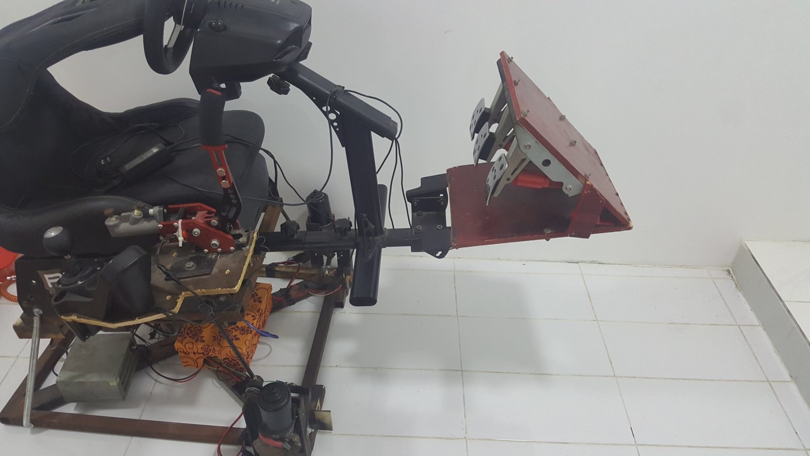

    this is my project be wait for next video
    20200517_063840.jpg 20200517_063828.jpg 20200517_063822.jpg 20200517_063820.jpg 20200517_063811.jpg 20200517_063807.jpg 20200517_063759.jpg
  3. absyfadhel1
    absyfadhel1 Active Member
    Oct 19, 2017
    346
    bahrain
    550Coins
    +37 / 0 / -0

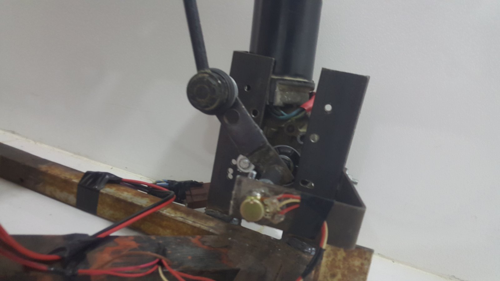

    first i made the seat stand with car shaft..
    then i change the place of the motor to less the weight..
    i used smc3 tools so i used arduno and ibts or some like that..
    i placed the potenmetier on a steel that i solder it on the motor ..
    so thats it....
    you can see the test video at this link
    hope i get diy license

    Nice build :) I might even modify mine a little (building right now) as your foot well and wheel mount might cause me less issues. Thanks for posting.

    Thanks for your support.. my build need some edit .. like when its go down the motor wont turn back becuase of wieght... i will add tomowro more spring in the back and i will check if it will solve the problme.. be waiting

    even if anybody can tell me how to incress the power of the motor and thanx:roll
    21,738
    152,201Coins
    +11,065 / 56 / -2
    One of the problems when starting multiple threads is that information is scattered about and easily missed.
    See my earlier comment about the limitations of wiper motors on this thread: https://www.xsimulator.net/community/threads/2dof-motor-problme.14676/#post-197684
    Yours is really a design issue. If using weak motors like wipers then lots of inherent design leverage is needed, along with minimal mass, like a shoulder mount seat shaker design. For a compact design you need plenty of torque, I use 200w motors with 60:1 wormdrives on my compact rig.
    Use SimCalc to get your head around the trade offs between physics and design, for a given performance: https://www.xsimulator.net/communit...e-linear-speed-and-forces-of-your-design.270/

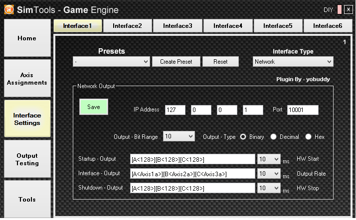

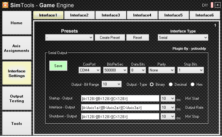

    i have 64 bit and i followed what you said and its the same this is the setting i use
    i tryied to use network for interface type but nothing move
    then i tryied the serial type
    but its the same
    Note: the serial type worked with all game i used exept DR 2.0
    this is the axis ajustment if you want it

    We would still need to see screen shots of the Game Manger side of things, and one of the min/max numbers in Game Engines tuning center to really be able to help buddy.

    You don't need to change the Interface settings and @yobuddy is right, we need to see how you have configured Axis Assignments and the Tuning Center, please include a picture of the Tuning Center with the game running (you may need to have it in window mode).

    Check in your
    hardware_settings_config.xml or
    hardware_settings_config_vr.xml if you are using VR,
    found below
    C:\Users\*your username*\Documents\My Games\DiRT Rally 2.0\hardwaresettings
    and make sure that it has this line in there
    <custom_udp enabled="true" filename="SimToolsCustomUDP.xml" ip="127.0.0.1" port="4123" delay="1" />
    example
    <motion_platform>
    <dbox enabled="true" />
    <udp enabled="true" extradata="1" ip="127.0.0.1" port="20777" delay="1" />

    so when i put this setting so i must use network on interface type or keep it serial?

    if you have movement on other sims then everything should stay the same just chack hardware_settings_config.xml for the line and if its not there copy it in and test see if it works then report back
