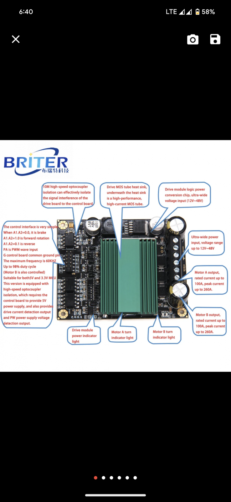

    but i cant do that because i use 100a drive same like monestermoto only one port to power , not like ibt2 each motor can add seprate power supply.
    Not using 1x 1000w psu will be enough for 2 of them?

    thanks alot bro, yes my motor need more amp than what they have now because i notice that my psu give only 40amp spilt in 2 motors so sure i need 1000w 12v 100a psu. am i right with this?

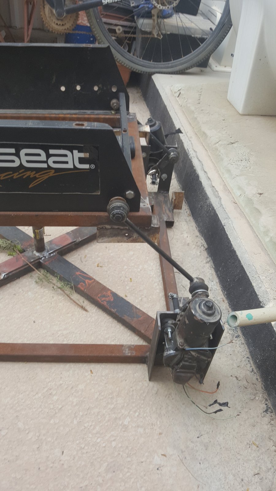

    @absyfadhel1 hey mate. Make sure you gusset that CV at the bottom. Brace it on both sides or it will fail!
  9. absyfadhel1
    absyfadhel1 Active Member
    Oct 19, 2017
    346
    bahrain
    550Coins
    +37 / 0 / -0
    i will check thanks again

    i use now 100a drive controller
    and i cant get battery to connect it with my psu, thanks for all advice you give i understand now the problem, but all i need to know now is if i take 100a psu instade of the one i have that give about 30a will solve the problem?.
