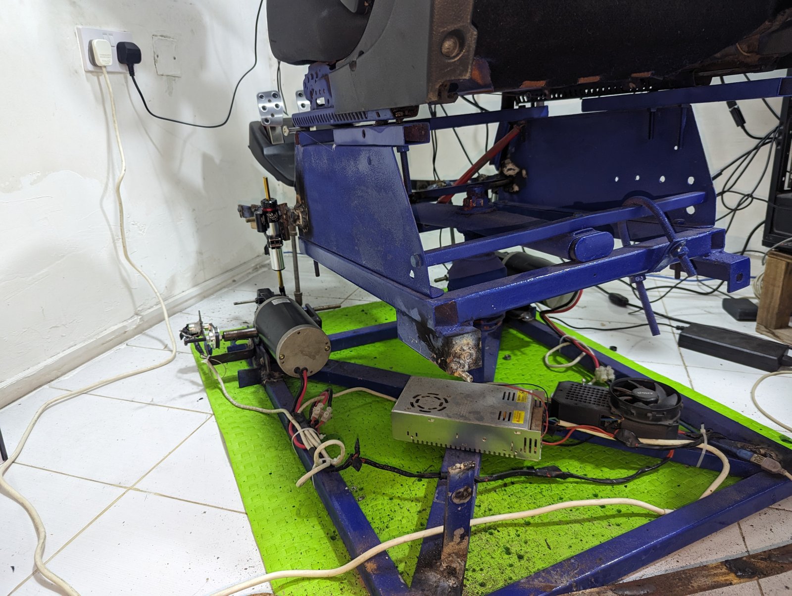

MY own 2 dof diy

    I guess you could lengthen the base frame and move the motors forward to connect to the end of the top frame under the pedals, that will enhance the inherent design leverage.

    yes this what i thought but i wasn't sure enough to do it, so you think it will help me achive easy movment with low backlash?, and where should i place the damper if i placed the motor forward?.. Thanks

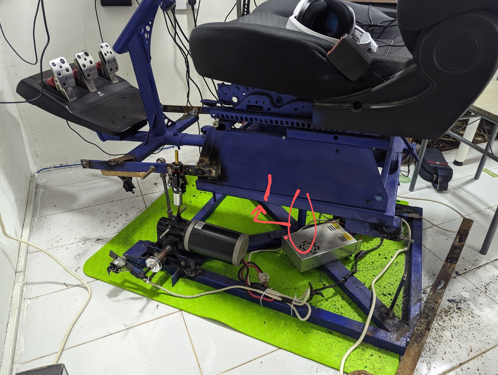

    i changed motor position and now i got too much movment and its not stable at all, i dont know what to dow, i add tringle in front that i thought it will help but nothing changed, help

    I am guessing you mean the motors twisting the frame?

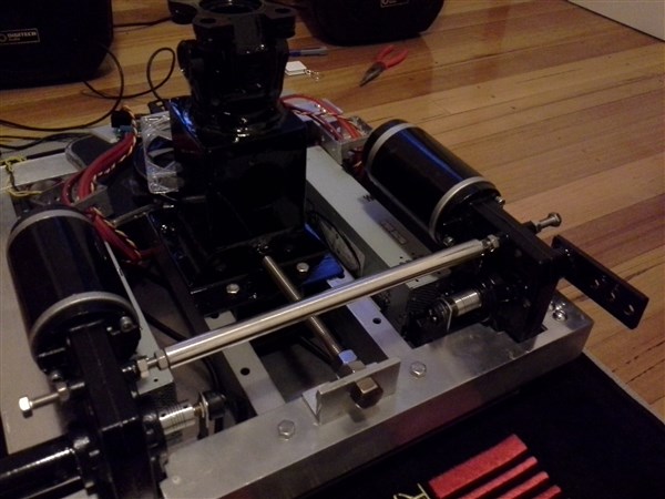

    If so I found running a bar between the motors helped stiffen the frame design, by making the motoirs part of the frame:

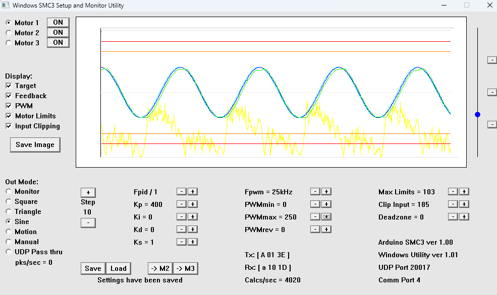

    i moved motors to front side under pedals but still green line not close to blue line, i use 300w 12v motors, 100a controller , smc3

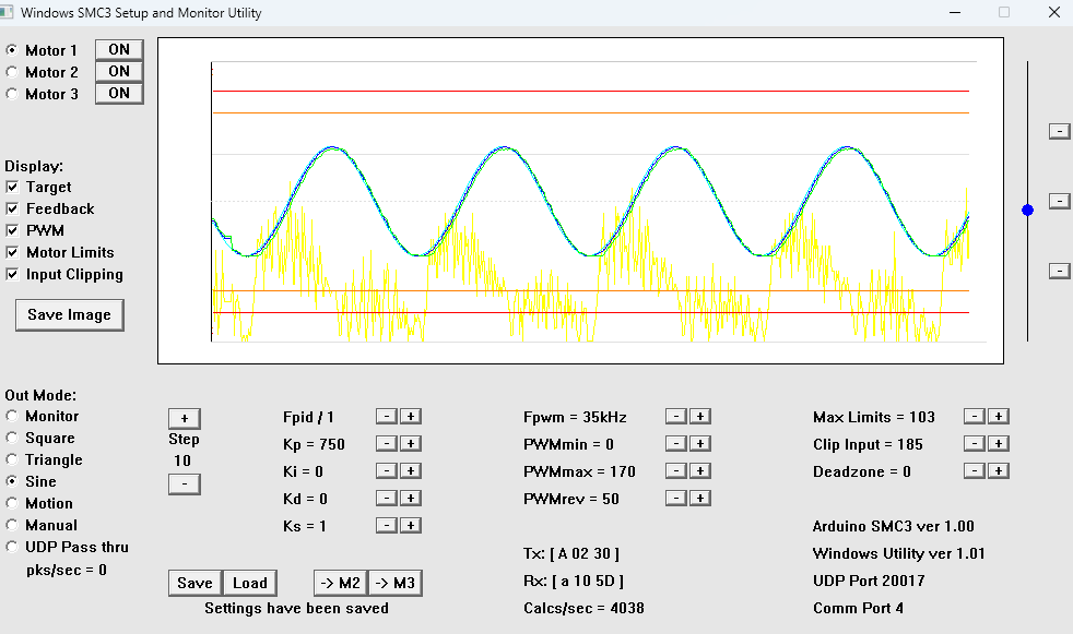

    So what are your SMC3 settings running the Sine test?

    +37 / 0 / -0
    like this

    +37 / 0 / -0
    this with 750 kp , 170 pwmax

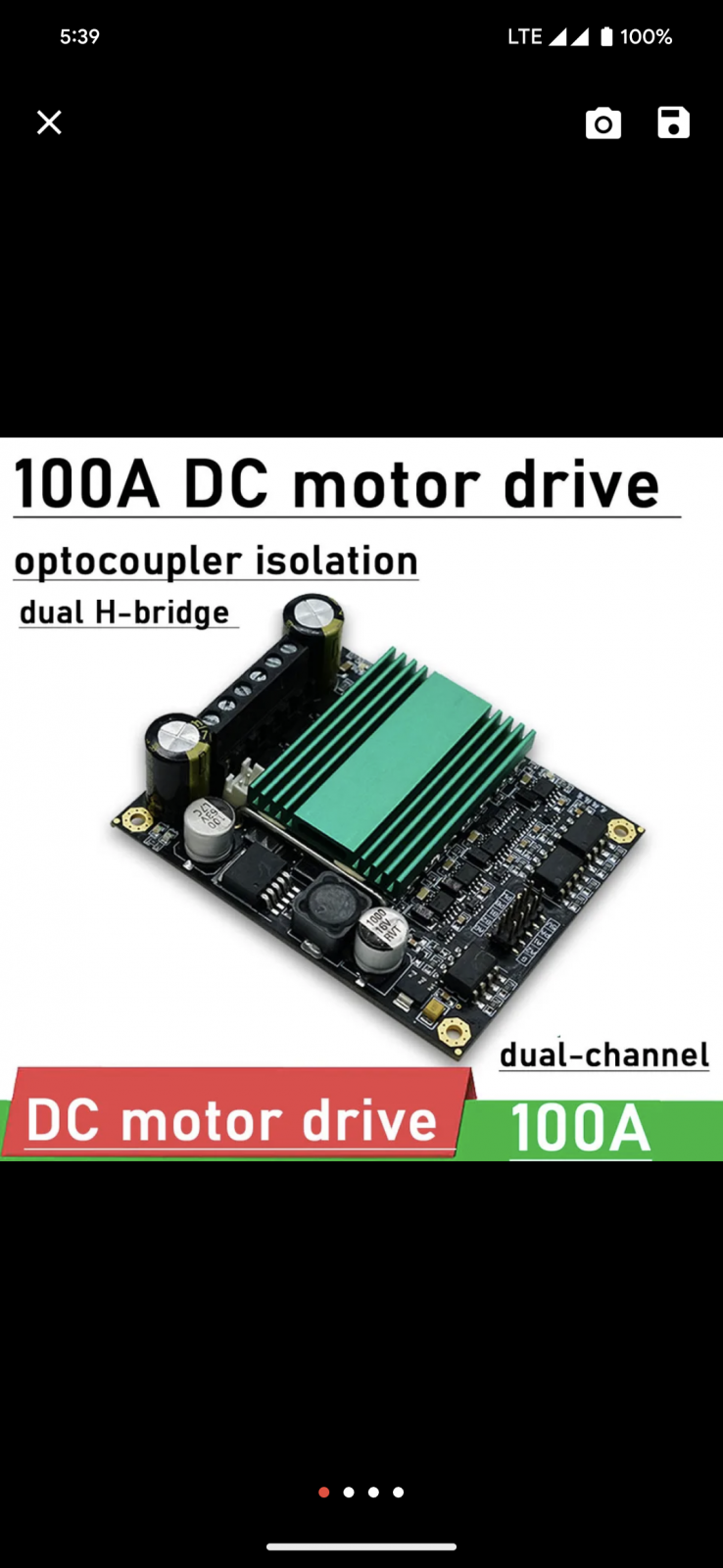

    Hi, my 100a motor controller burned ☹️, so what you suggest to use instade of it? cheap but good drive controller?.
    ibt-2 cant handle my 300w 12v motor, 100a controller is good but i want something butter because its taking issue when moving like its hard to move with it i mean its not give good power

    i used this one that burned
    so if i use 2x 100a as dual motor driver will work with this one and give more power?
    because each one cane move 2 motor so i use 2x100a to control 2 motor?

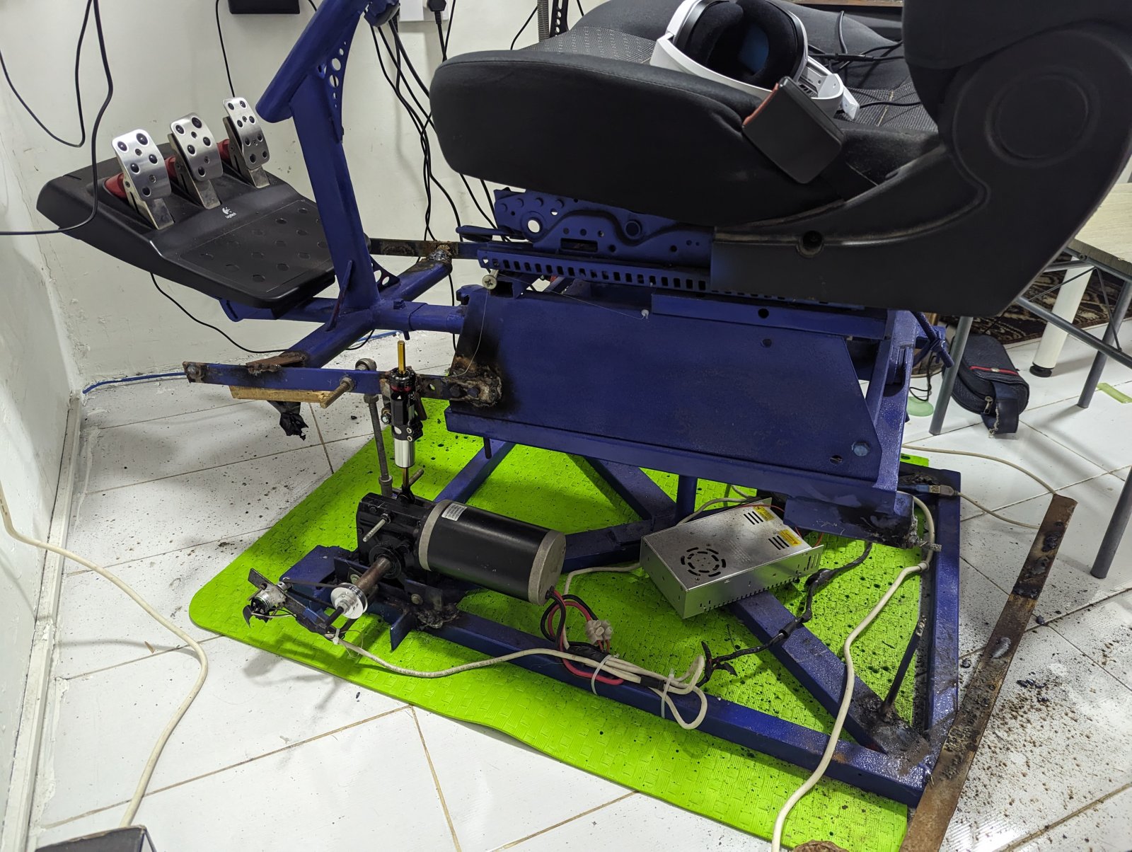

    Hi @noorbeast ,
    i'm thinking to repurchase the same motor drive i used before 100a 12v, but i think my motor got too much load because of that it burned.
    so i want to change middle shat position to forward because when i attach it i didnt try center of gravity.

    The rig must be properly balanced, with you and all peripherals in place, that is what determines where the unit joint is placed, see the FAQs here: https://xsimulator.net/community/faq/find-the-center-of-gravity-to-balance-a-motion-simulator.55/
