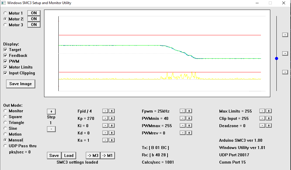

    left motor move more than right in simtools, smc3 work all good and move the same.
    also i use now hall effect potentiometer but its look like 100k pot, in smc3 this is max and min level i can reach in my rig now unlike 10k pot i use before

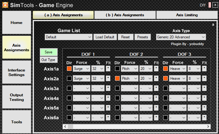

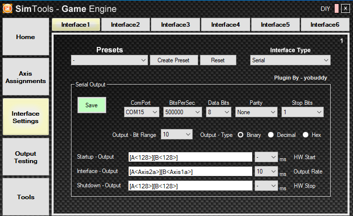

    this is my simtools setting

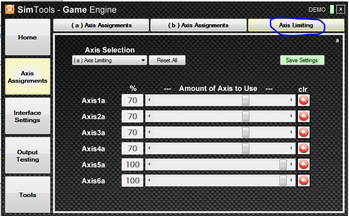

    You don't happen to have a limit:

    i limit axis to save my rig becuase pot move so large , i tried yo make limit 100 for all and test but its give same problem, left motor movebmore than right

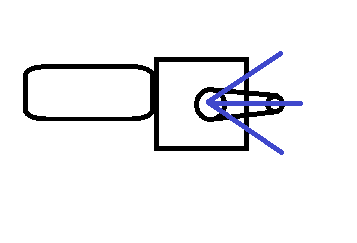

    Hey! If you use 60/20 then the lever will work in a partial range, something like this:
    It might be better to use 60/40. But I may be wrong.

    try every single setting in smc3 like
    lowering pwMin
    Kp higher or lower
    Ki lower
    kd higher until 200
    ks high and low
    nothing help, the motor mounted corecctly, pully tighted , all wires replaced, diffrent arduino, changed lever angle, Pc reigon is set to Us engilsh ....

  13. noorbeast
    22,032
    153,788Coins
    +11,150 / 57 / -2
    What happens if PWMmin is 20, kp 400, PWMmax and PWMrev are set 20 over whatever the rig starts to move at?
    How well balanced is the rig and how was that done?
