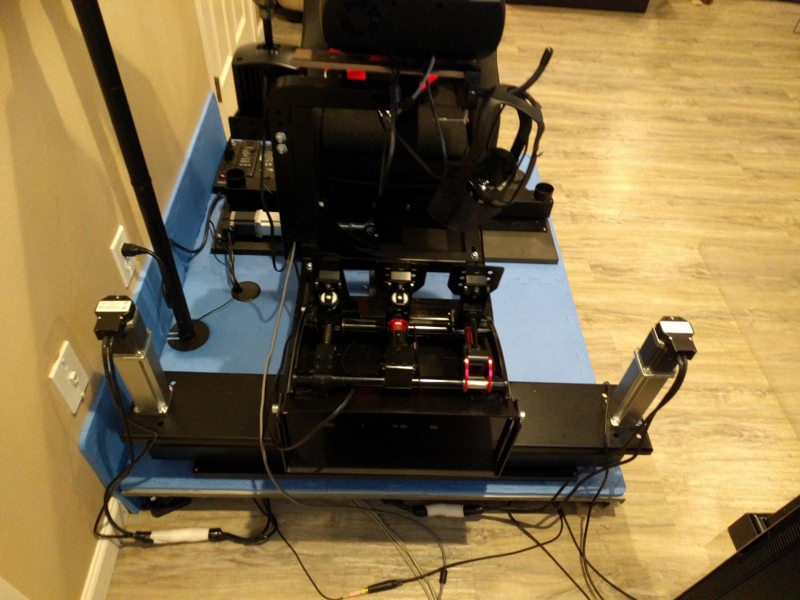

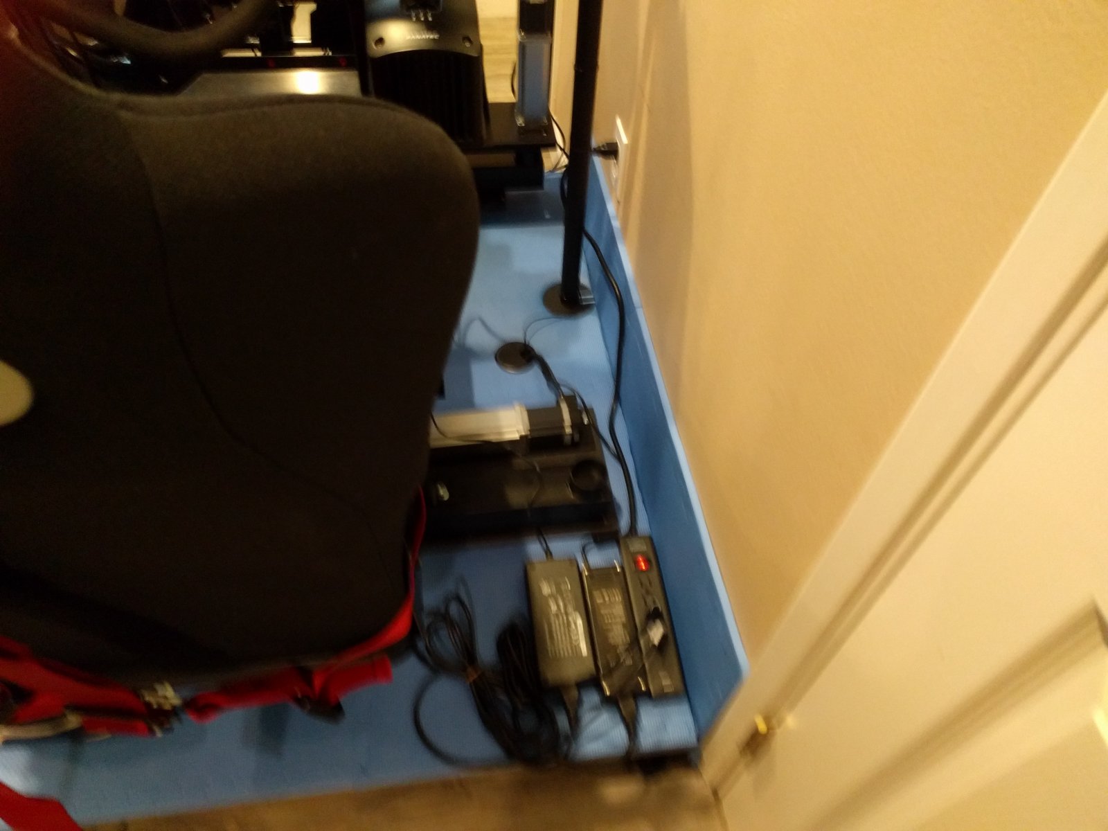

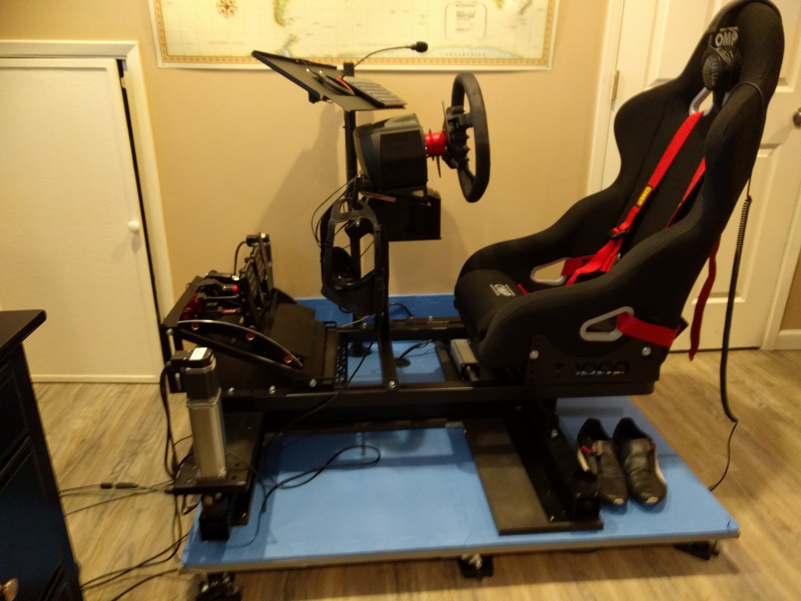

    Well guys, physical part of my build is nearly over, minus cables strapped (still need to figure out best wheel/seat pos) and possibly fans installed in an enclosure, other than that done. Thanks for all the pictures, and advice.
    While initial impressions are sometimes influenced by the novelty, they are highly valuable as well, because they show by just how much one just improved his sim experience compared to previous. So, I'd like to share my initial impressions, in case someone wonders what T1000 3DOF has to offer over racing with FFB alone.
    My impressions are from my primary sim - rFactor 2. I am also planning to give ACC a chance, if Kunos implements all the features they promised. I am still using default settings suggested by Patrick and software fine tuning is the next step.
    The bottom line: my experience with T1000 3DOF and SimTools has been very positive so far. A bit of first impressions:
    I expected mere g-forces (that's pretty much what I experienced with Forza + 15k system in a showroom), but I was surprised what I experienced:
    • Connection to the road surface, every bump is felt, feels like you are riding on a surface, instead of hovering on it
    • When car loses grip, it is felt in the system, even before it is felt in FFB. This is in my opinion largely thanks to third actuator, which to me seems significant step up from two.
    • When car jumps it is felt in the system
    • When wheel loses touch with the surface, and lands back, again it is felt
    • Off/on curb feels amazing, you can feel vehicle jumps on/off
    • When tires jump on tarmac losing grip again it is felt
    • Lastly, collisions are pretty unpleasant, that’s how they should be Even curb on/off is sometimes unpleasant (realistic).
    • I was also impressed with the materials used.
    • Aside from corner case crash in SimTools, Simtools and drivers has been flawless, zero glitches.
    The only negatives are a bit of flex in the steering wheel. Also, instruction manual was confusing especially for 3DOF, but that's very minor, I am picking hair.
    If anyone has questions about my build, feel free to ask.
    Update1:
    * what keeps amazing me is how precise this system is. I was planning on getting SimVibe, but honestly I am beginning to feel like there's almost no point in doing it. Of course, you can't tell each of the four wheels individually, but I am really surprised at fidelity. Also, I never cared before, but now quality of track matters.
    * I keep being surprised how well SimTools work. Have not had a single issue nor with hardware nor software. Also, SimTools work makes sense and is intuitive.
    * I can't get enough of surge/sway, this is due to fairly limited range of motion. But I knew what I was getting into, and precision is much more important to me than system that throws me around on a sea saw.
    Update2: I keep getting impressed with the level of details/immersion/fidelity this system added to my racing. When car is stopped, while turning steering wheel you can feel wheels rubbing on tarmac, exactly how it is IRL. When car is stopped, revving engine up creates exact feeling in the rig as you feel in the real car.
    I know I sound like a kid in a candy hop, but was also really impressed with feeling on gearshift (surge). Actually, I was never fan of hot lapping, preferring race events, but the added immersion of this rig is so awesome, that I can spin lap after lap in Apex GT3 SLS or S397 M8 around Spa and enjoy every lap.
    Prior to purchase, I was worried that T1000 will not provide sufficient motion range, however, that is not the case for me. To be completely honest, please note that I've severe health issues (fully fused neck), so I am not allowed to play American football or participate in cage fights. That said, I found myself constantly reducing the range of motion and not missing much. To be precise, what I am doing I created a spreadsheet where I use multiplier to extend Min/Max ranges, really wish SimTools had master multiplier.
    One more thing: it becomes more evident that rig will likely benefit from addition of SimVibe. Even though I can feel wheels slipping on tarmac etc, I can't tell when each individual wheel locks. I suspect I'll need shakers for that, but not sure yet.
    Update 3: It has been several months now (04/03/2019), two things I would like to point out:
    * I have not had a single issue with T1000 3DOF. Everything just works, no hangs, no reboots, no disconnects. Build quality is top notch as well, solid device.
    * One very interesting thing is that with motion system, every vehicle feels very different, and tracks feel different too. You can actually feel absense of any suspension in Karts/SuperKarts. You can feel suspension, weight differences between different GT/Touring cars, which is a really nice surprise.

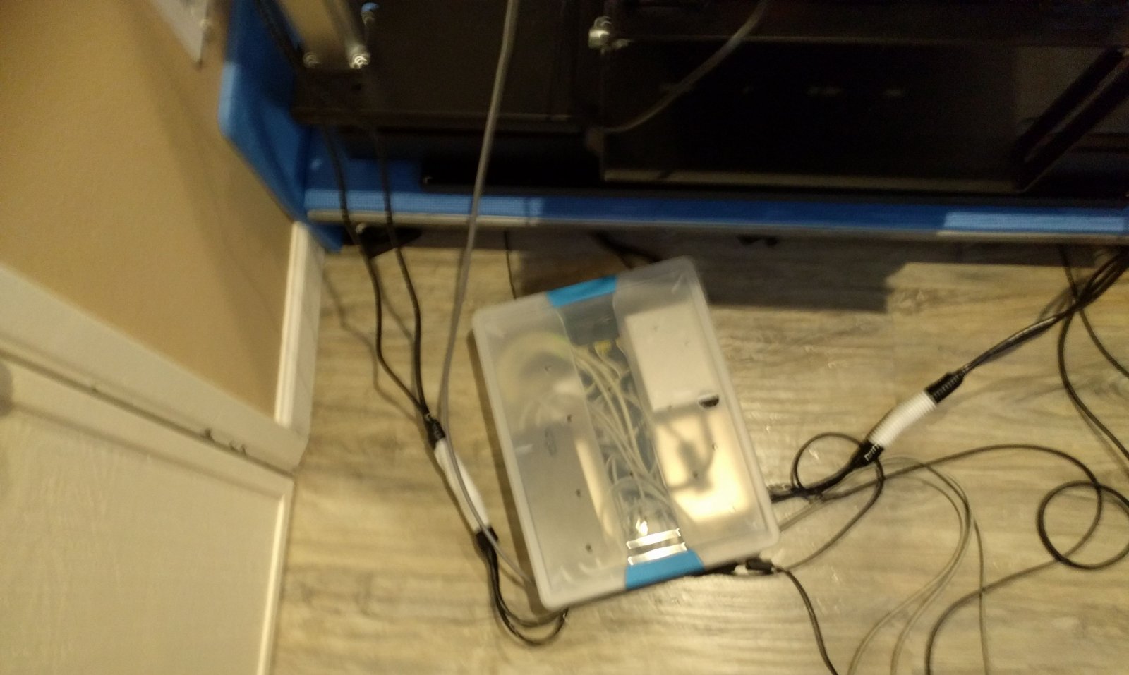

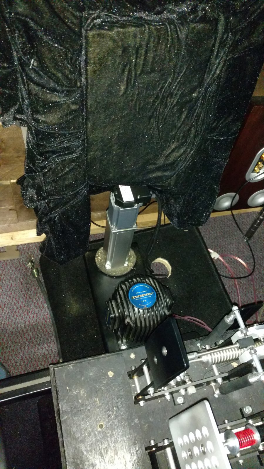

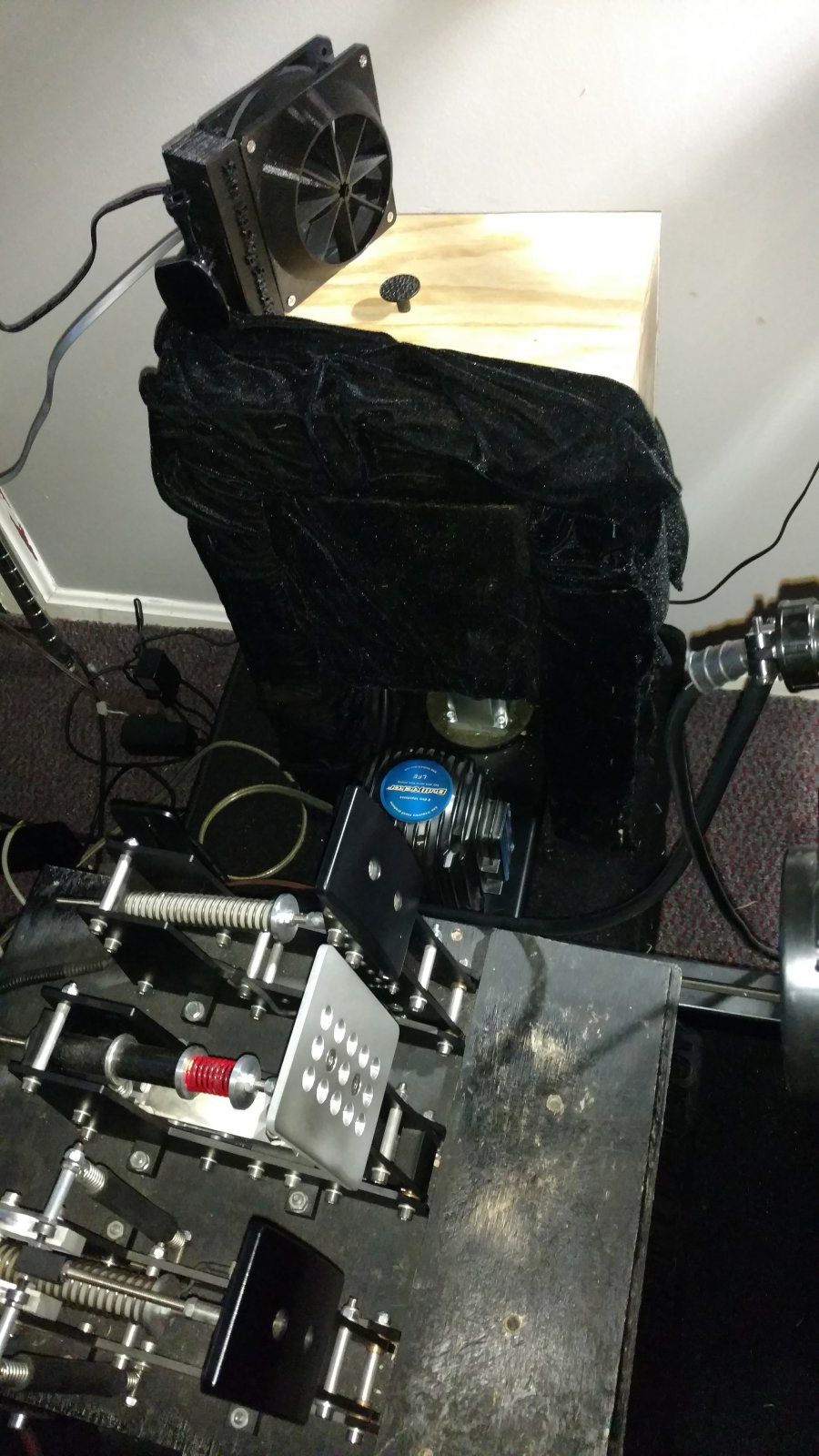

    * I also solved amplifier heat issues by using some Raspberry Pie fans in V2 of my enclosure. Attached image.

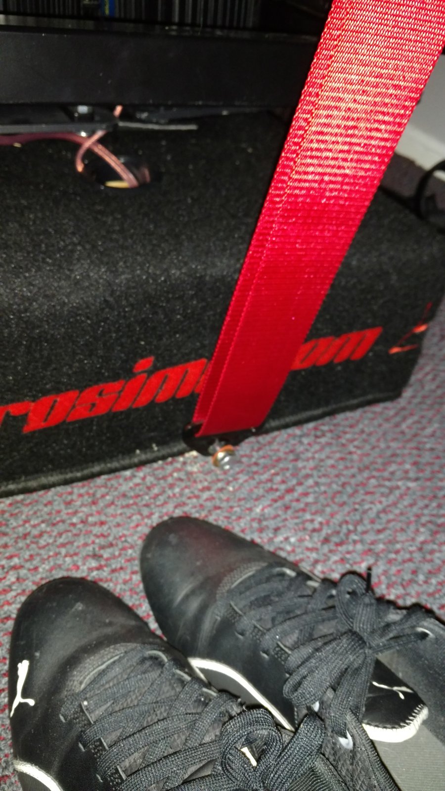

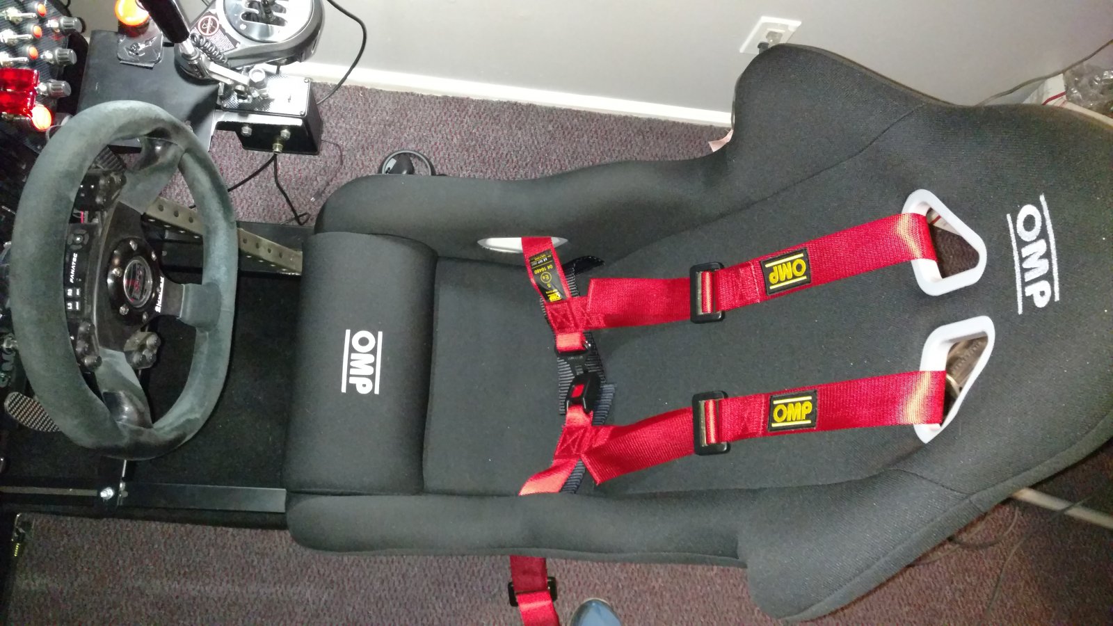

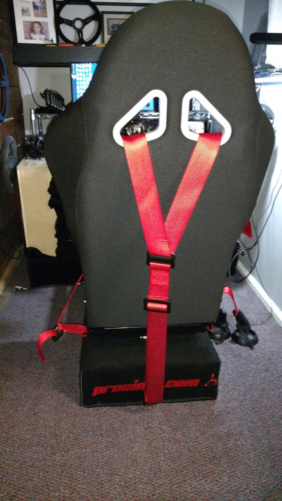

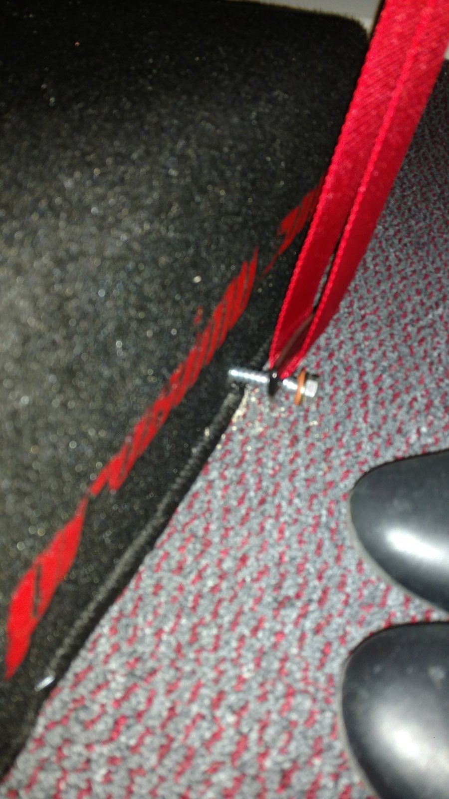

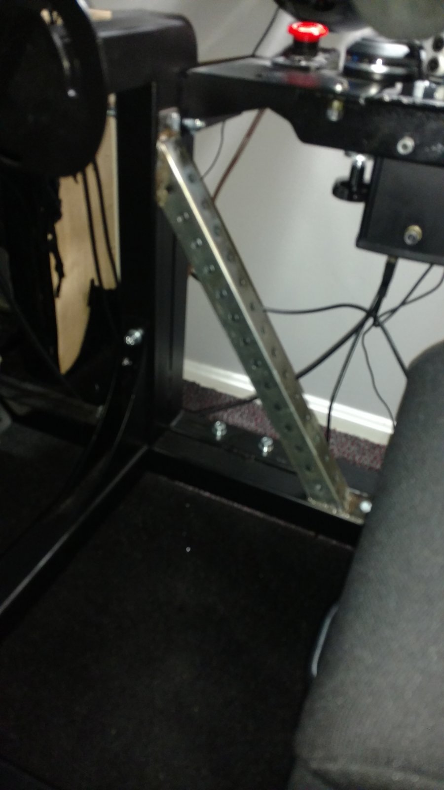

    IMG_20181202_150305712.jpg Nice setup Wolf. I keep fine tuning mine and love it.

    Really appreciate, I can see how to better attach harness now.
    Are you running 60/60/60/60/20 axes or you try to keep them close to 100% as per guidelines on this site?

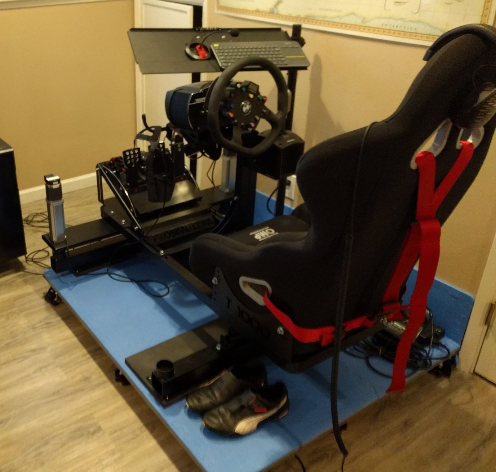

    Yeah, I was restricted too, so I can understand you. It is 39 by 46 inch, prosimu site specs are correct there:
    Space Requirements
    Dimensions: Length 1.20m (46") Width 47cm (18") Height 1m06 (41") Width near actuators (99cm - 39")
    Note that system tilts and in case of 3DOF rear part moves, so you need a bit more in width. I'll measure my board, it is a bit wider than absolute minimum. Also, system pitches a bit, so length, as especially at the top of the seat needs to have a bit of extra, otherwise you'll hit wall.
    Update: @Thug I'd say you need at least 2 inches on each side of extra space on sides for sideways motion. Length needs even more, depends on how inclined is seat.

    congratulations for the excellent work.
    the deflection of the steering wheel may be due to the fact that the steering wheel is supported by a single support.
    once you've found the right position, you could strengthen it with another medium.
    maybe you can use aluminum profiles.

    Thanks Giorgio. I saw Onaflyer's solution for strenghtening, however, I am a bit puzzled here, because to me it seems like it is not the big square arm that flexes, it is that thinner/weaker top part that holds the wheel. Drilling poses too much risk I'll ruin the frame. Drilling holes for CSW base alone took me half a day and 3 broken bits, which is not a bad thing, speaks good of steel used :) I'll probably have to live with it, or, maybe not :D
    Do you happen to have opinion on SCN6 actuator controller boxes cooling? What would be the safe operating temps in your opinion? They don't get very hot, but sometimes get quite warm and I am trying to understand if active cooling is necessary, or is it a waste of effort, time and money.
    Update: Patrick sent me SCN6 technical info and basically I know my answer - env temp for controllers should be below 40C

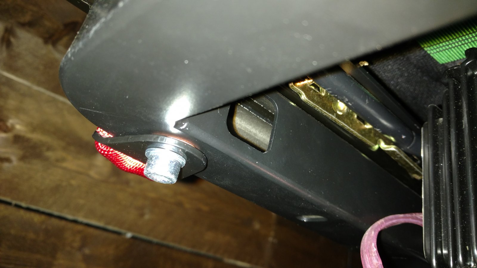

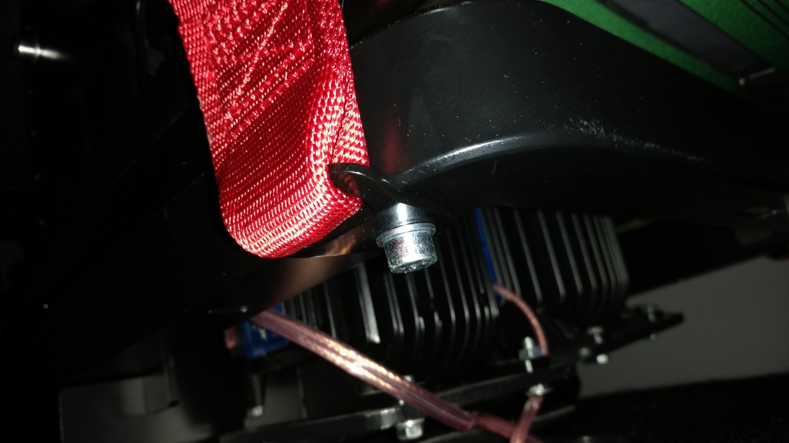

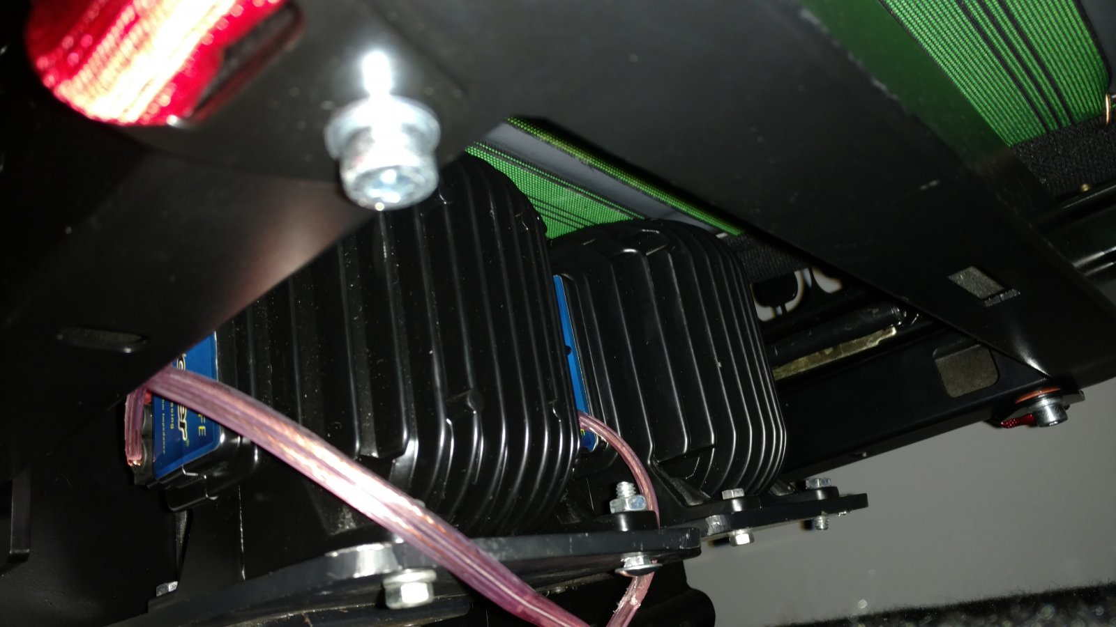

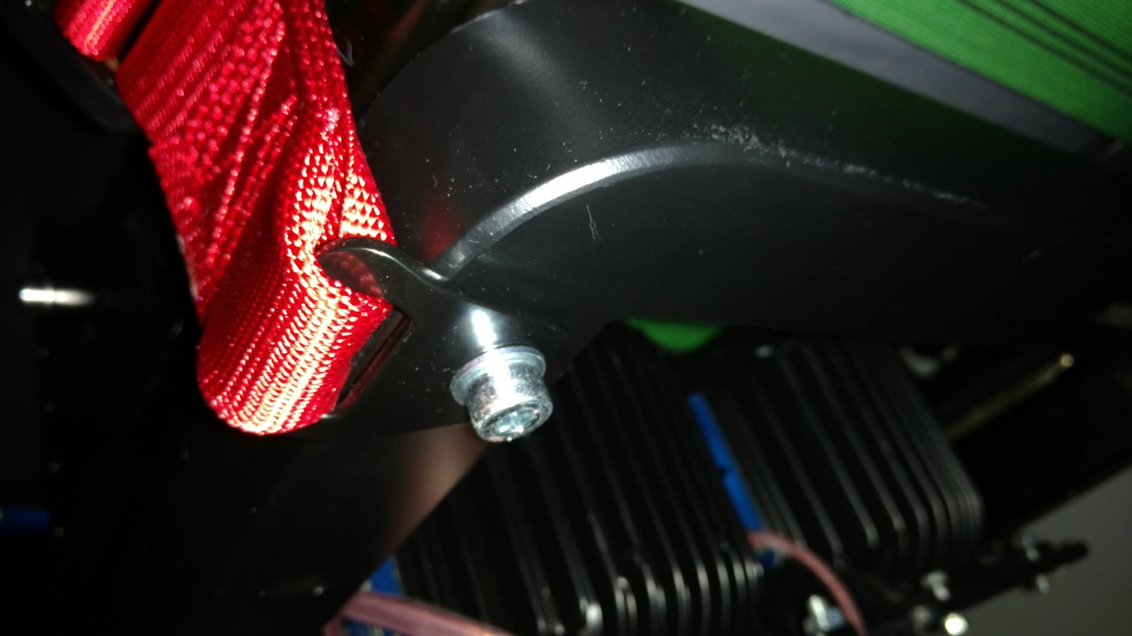

    @Onaflyer, in iMG_20181202_150240052.jpg you attached central piece of harness to the base platform, right? Did you do that so that harness tightens when system pitches forward?
    I am actually wondering if I could use some spring to attach that part to that platform, so that when system pitches forward harness tightens, but that might affect system balance. Anyone has thoughts on this?
    21,697
    151,827Coins
    +11,058 / 56 / -2
    It has been a common practice across a range of different sims to use springs that way, it is the most simplist form of harnes tensioning.

    Yes, I have it screwed into the base. I tried multiple springs and just couldn't get it to feel good. I do think springs would still work well but ultimately I will go with an active tensioner system.

    Yes, electronic devices should work at temperatures below 40 degrees. They can work even above 40 degrees but their life is shortened significantly. Proper cooling guarantees better use and longer life.
    I advise you not to put the devices in a closed box. The heat generated by the devices remains there, remove at least the cover.
    I advise you to cool the devices with extra fans so as to extend their life.
    Consider when it's summer, the room temperature rises and does not help the electronic devices.
    In the past I had problems with the steering wheel because with long driving sessions it was too hot. I solved the problem with two fans.

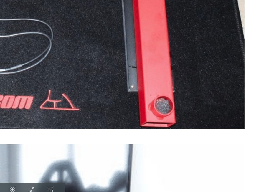

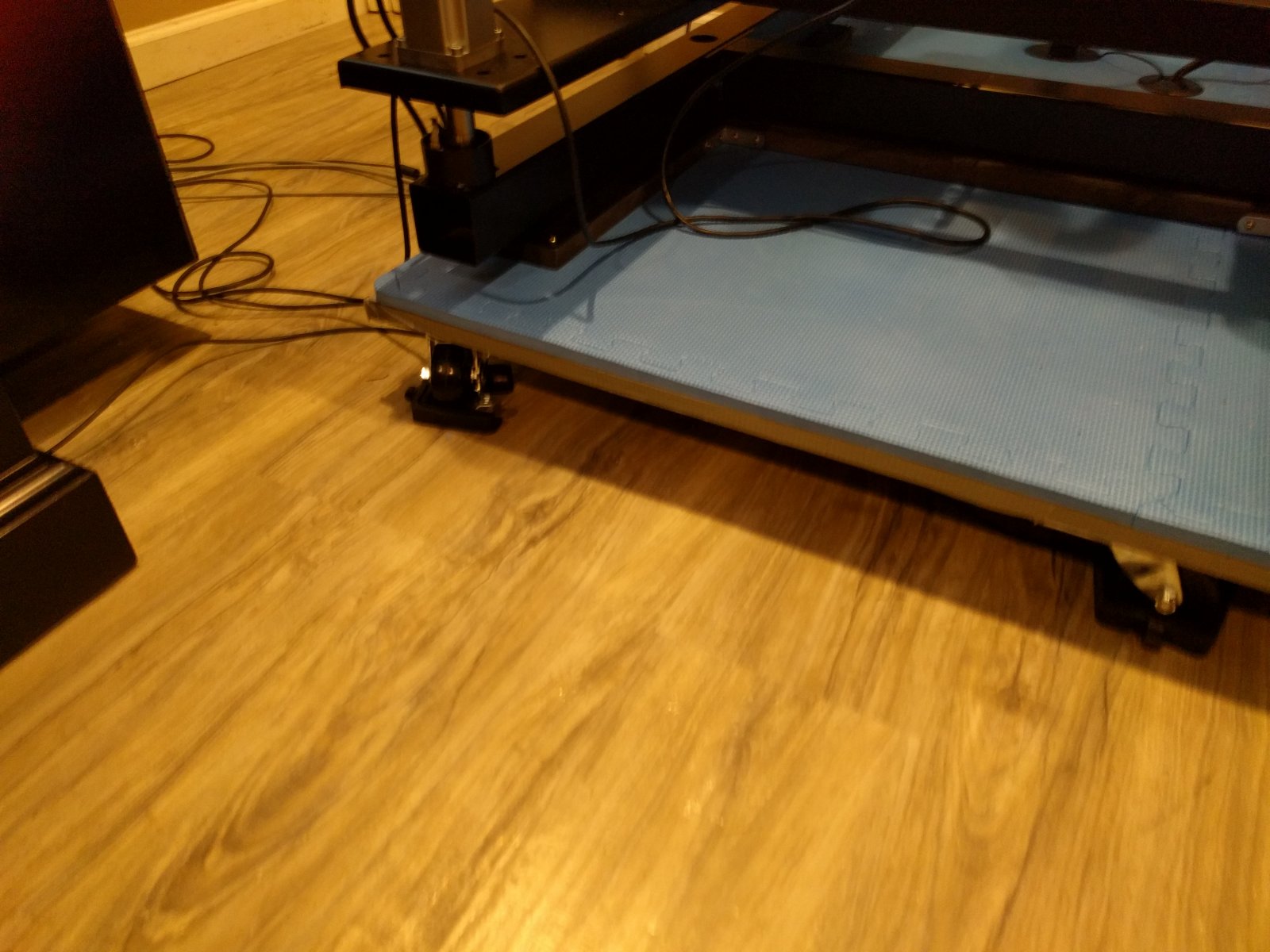

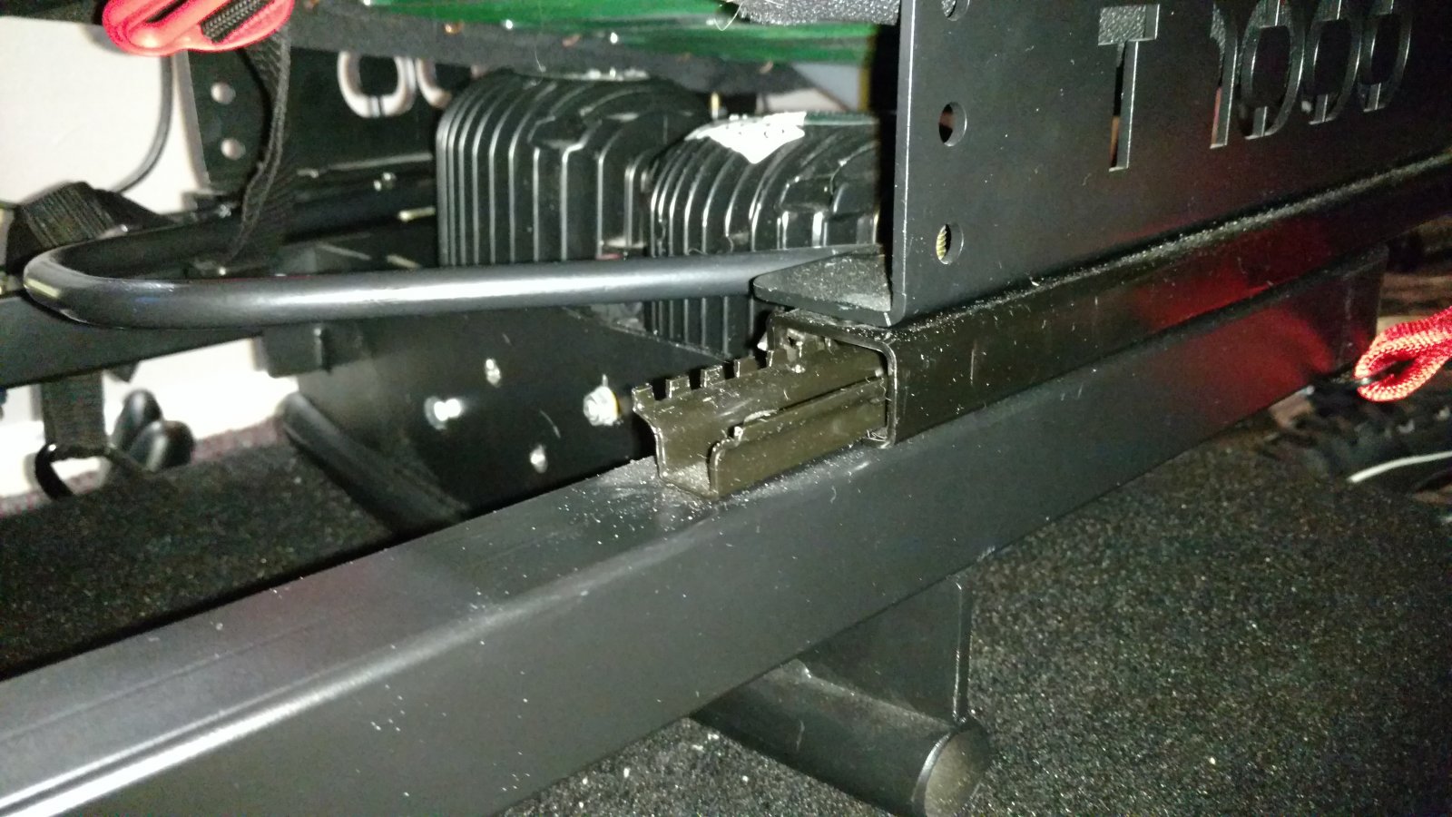

    sorry for being nitpicky guys, but one more question on physical aspect of T1000 3DOF. Mine came without rubber inserts depicted the picture attached. I currently have ~2mm rubber sheet in there. What is the purpose of this material, is it to prevent skid or is it damping to reduce impact, or just for sound reduction purposes? And, what would you suggest as a replacement?

    I think the rubber is used not to damage the actuator shaft.Without rubber, one would have metal against metal.I think it helps to reduce the noise too.

    Mine came with rubber feet, but they are rigid and solid. I imagine adding some layer of soft rubber into well will reduce actuator stress on motion stop. just do not want to loose those sweet precise details this system recreates so well :)

    you can try to put some thin rubber a little softer. see if you get an advantage without losing feelings.

    I replaced rubber with softer material but I am loosing too much detail. I wish I knew one thing: axes already limited to 85%, so is there still benefit for actuator life to soften the impact on stop? My priority is maximum details, but of course not at cost of killing front actuators in a year or so.
