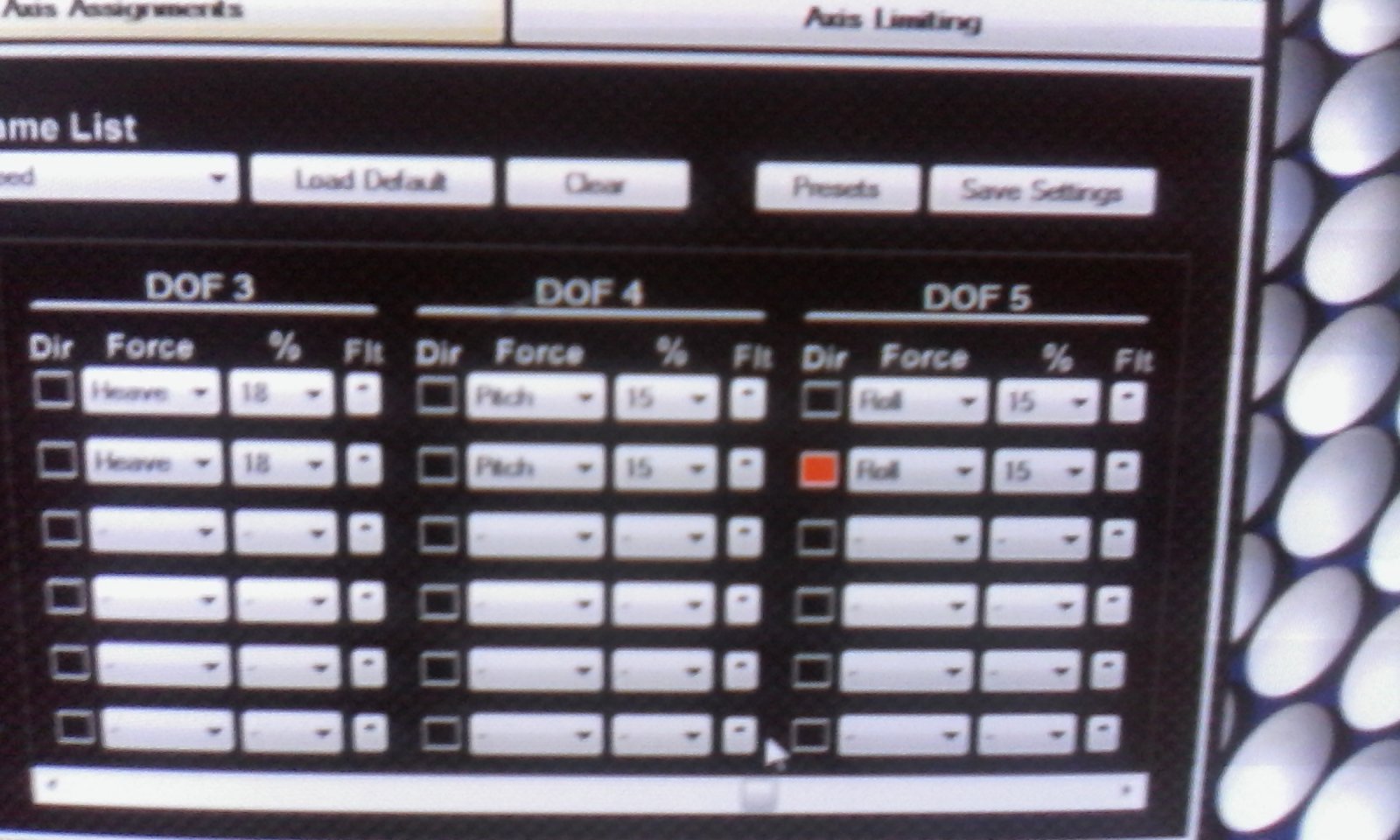

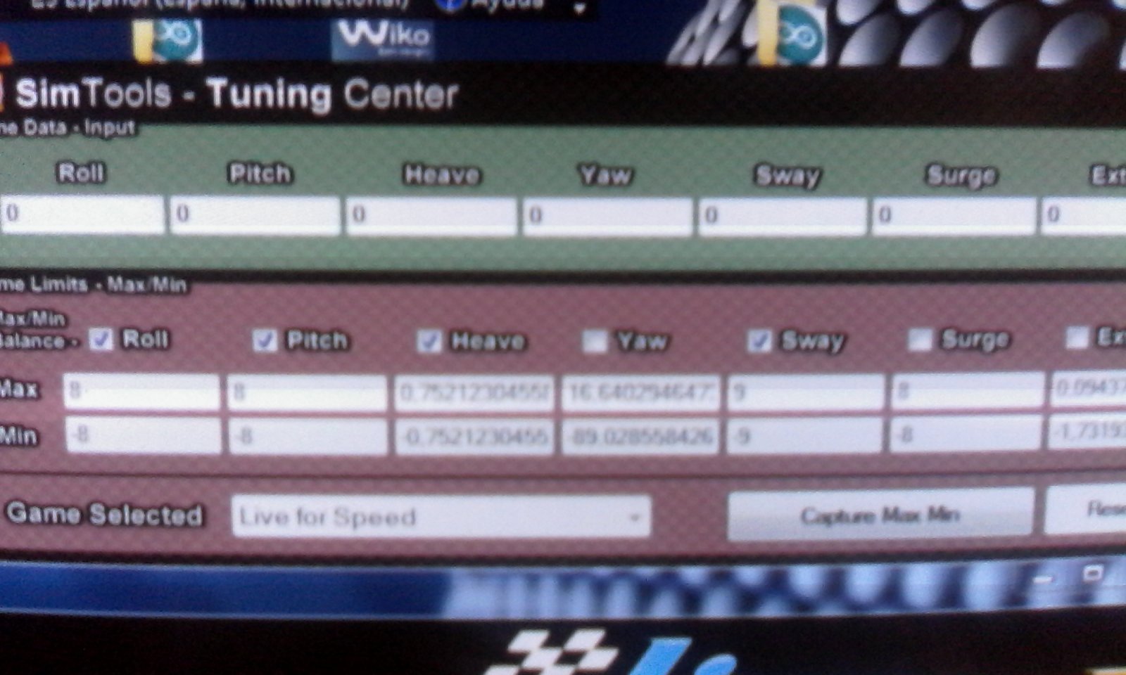

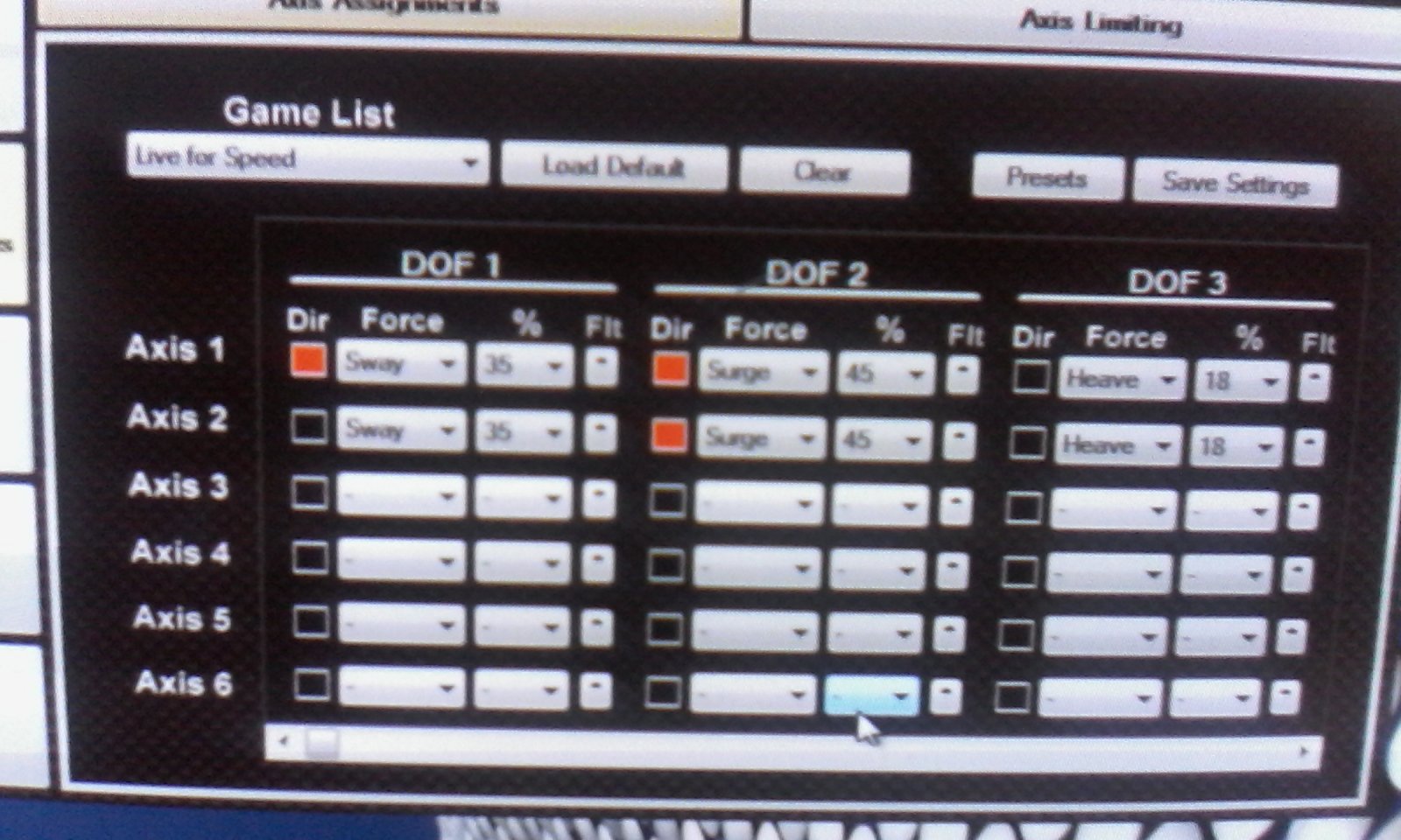

    After testing a lot of hours my settings for simtools all worked fine, until my girlfriend started using it. Well the way you drive influences a lot for the 120% margin on configuration. In the two hours the right motor stopped twice cause she passed the limits. That´s whyI must change the setings
  4. chu
    chu 2dof racingseat
    Dec 2, 2015
    149
    tecnician
    VITORIA
    937Coins
    +34 / 0 / -0
    these are my new settings: IMG_20160524_190055.jpg IMG_20160524_190120.jpg IMG_20160524_190131.jpg

    Maybe i lost a bit of realism. But now the motors doesn´t stop.

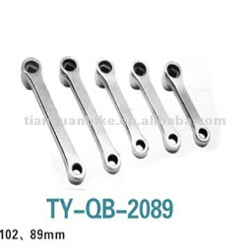

    I´m thinking about the posiblity of putting longer cranks on the motors. About 100mm long.
    To having more travel on the axes.
    Actually my cranks are about 70mm.
    Could this affect negativily to the nice working of the sim? or maybe the motors couldn´t move the seat?
    Anyone can give advice about what kind of crank to use that fix hard to the wiper motor? maybe a left crank for bicycle?
