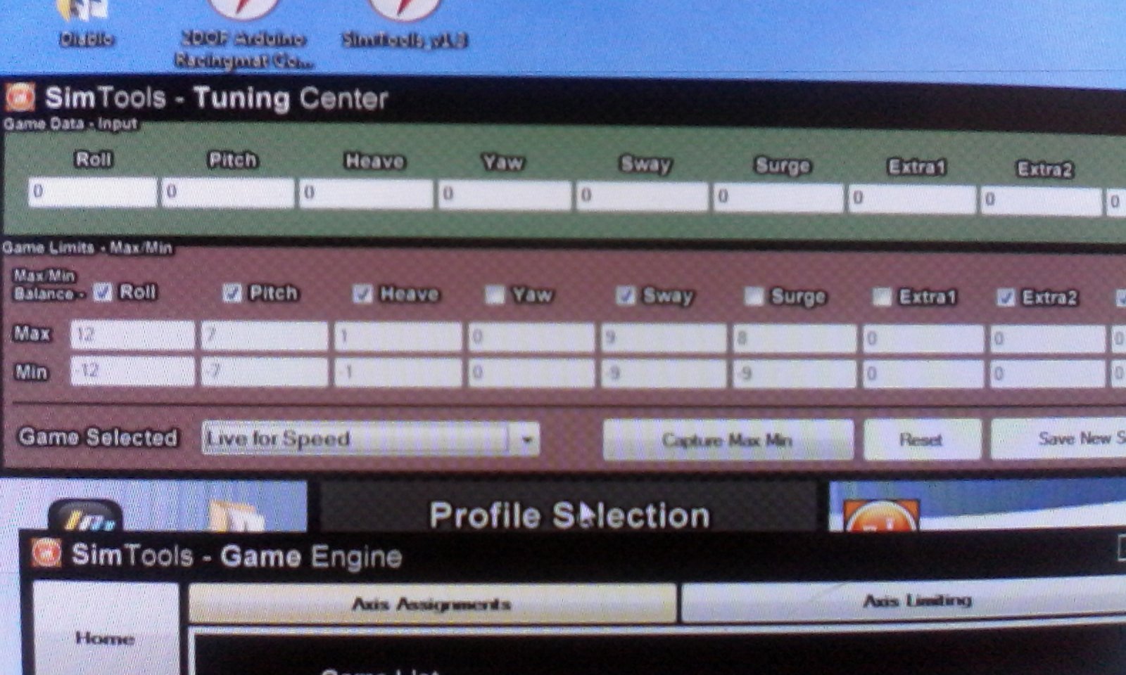

    For example 40% of surge 40% sway and 15% heave. Must I change also the tunig center for this values?

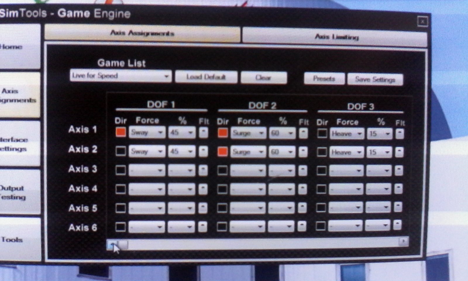

    After making a lot of test and following the advices of noorbeast(thanks). finally y change the settings.
    Acelerating, braking, lateral forces and the bumps and vibrations feels great. IMG_20160518_184130.jpg

    the tuning center stay like this way: IMG_20160518_184226.jpg

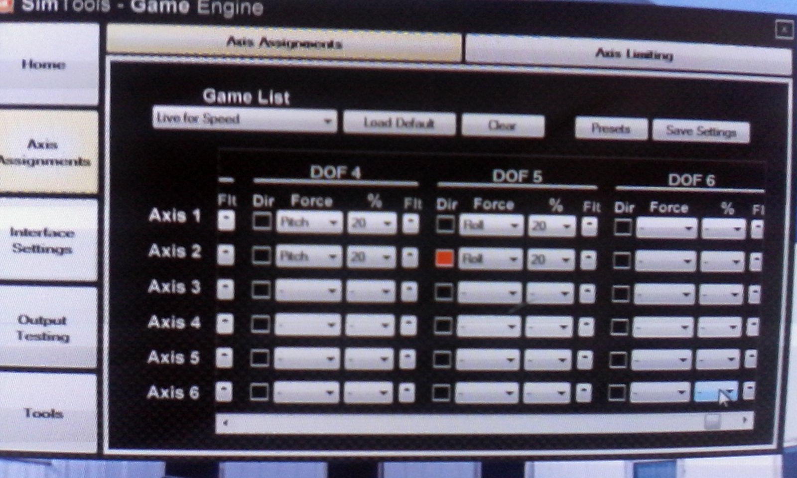

    I know that is axis percent is 120 %. There is no space for roll and pitch, but adding 20 % of each, doesn´t affect negative on other movements. IMG_20160518_184141.jpg

    I think this could be cause heave and pitch are opposite to surge, and roll is opposite to sway in my configuration. And in the case of for example the sway,heave and roll moves on the same values of the axis. They never pass about the 80%. The same way if pitch+surge+heave in the same direction never gets more than 95%. So if another strange situation come to the sim, the input limit doesn´t let the axis go for more. As i appreciate the sensation is great in every moment.
