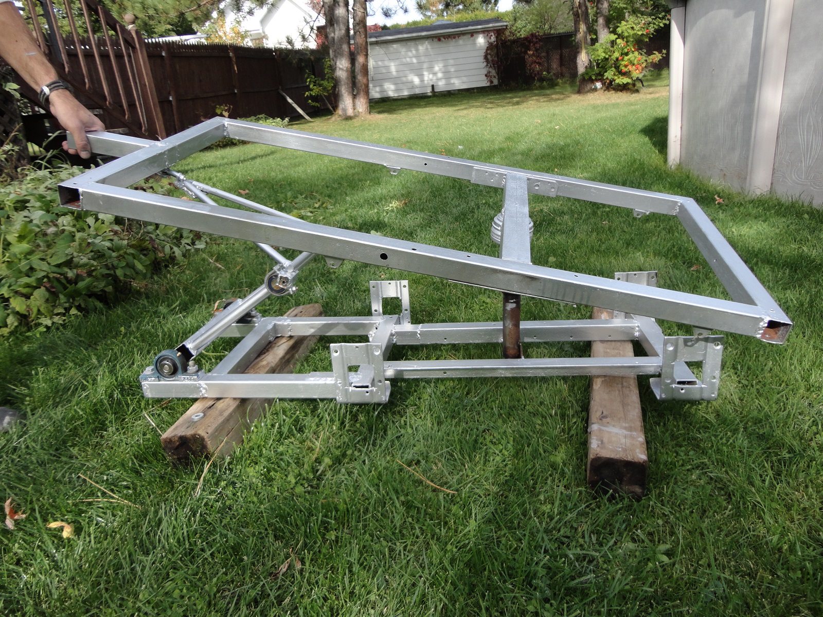

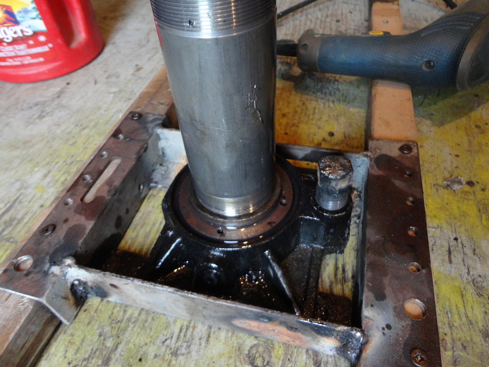

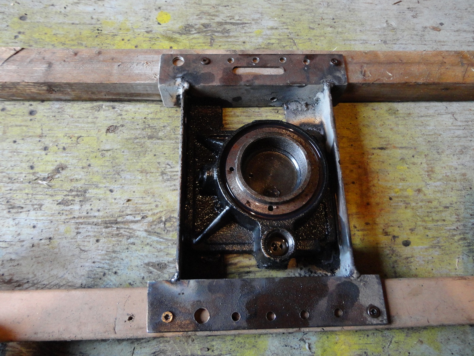

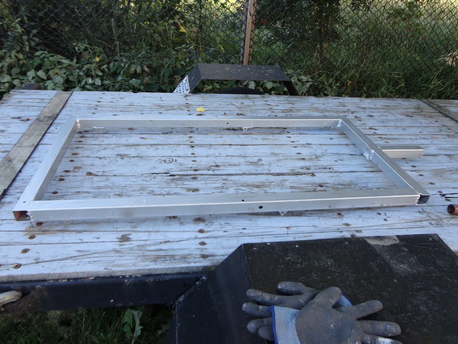

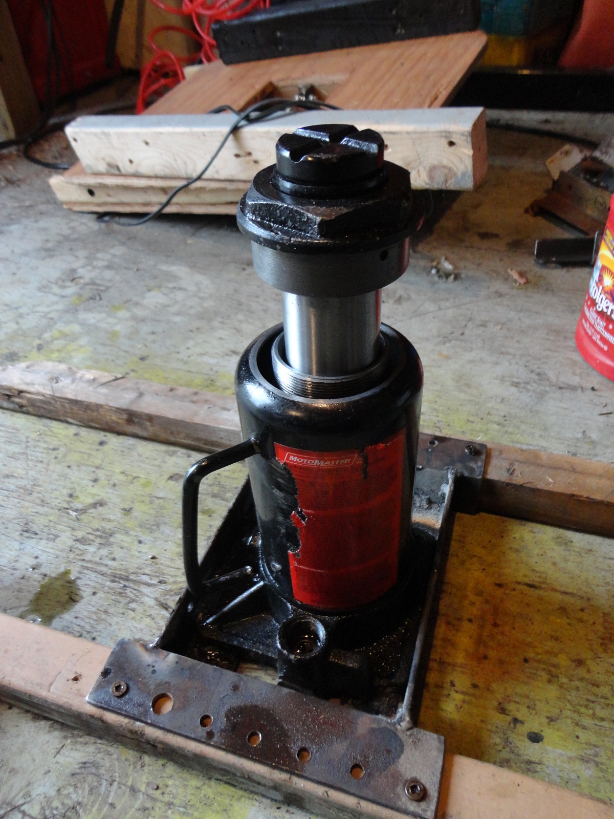

    Hi, first of all,
    I want to thank everyone who helped me and especially those who created X-sim, Simtool (my favorite) and plugins ..
    Here is some pictures of the frame :

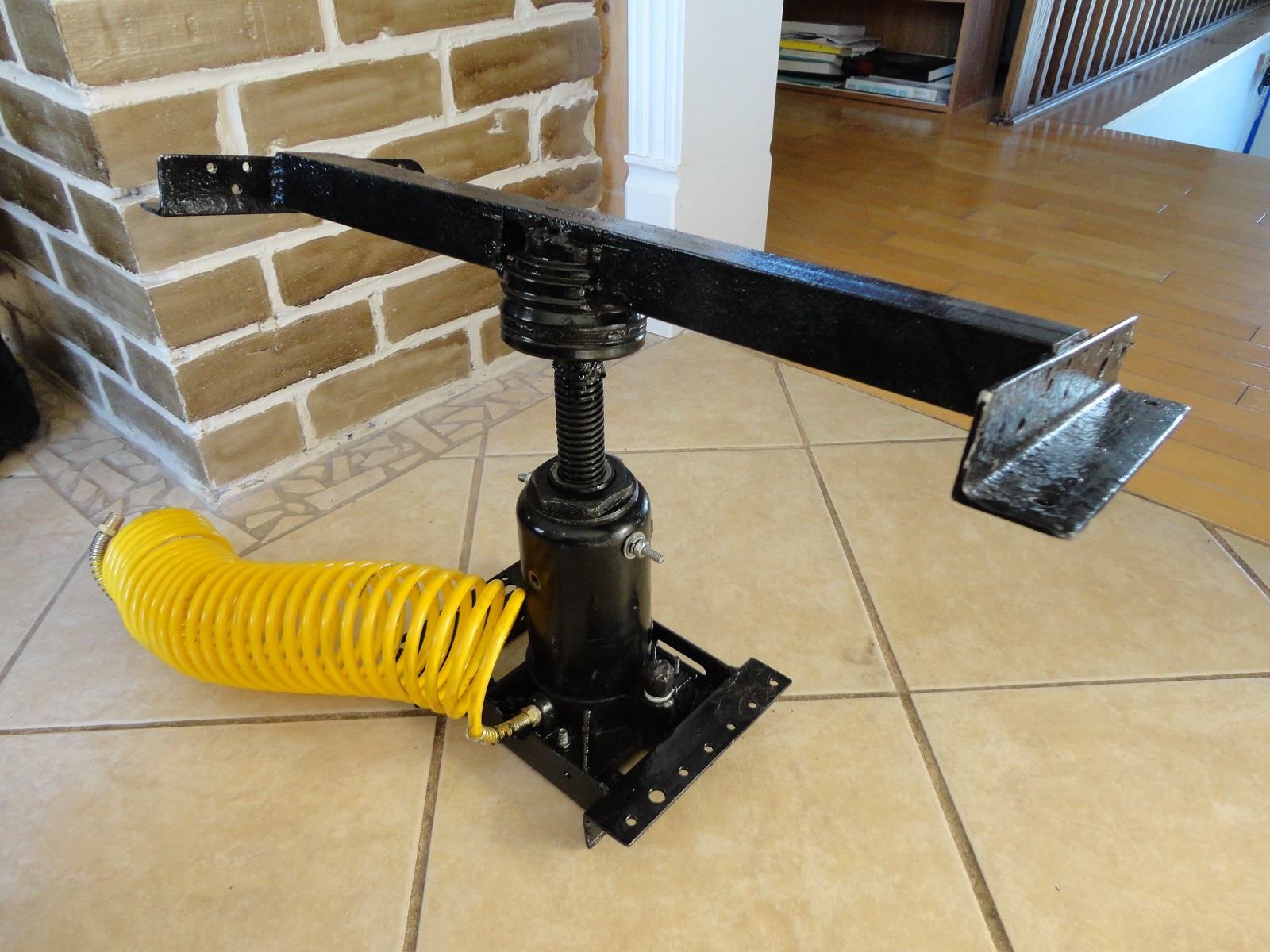

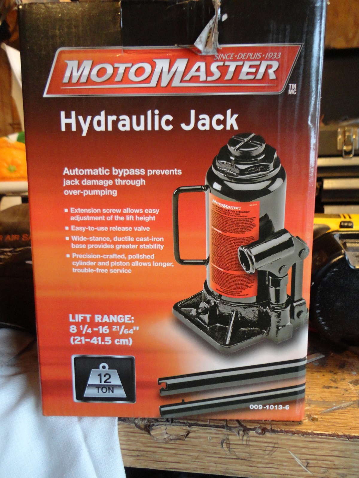

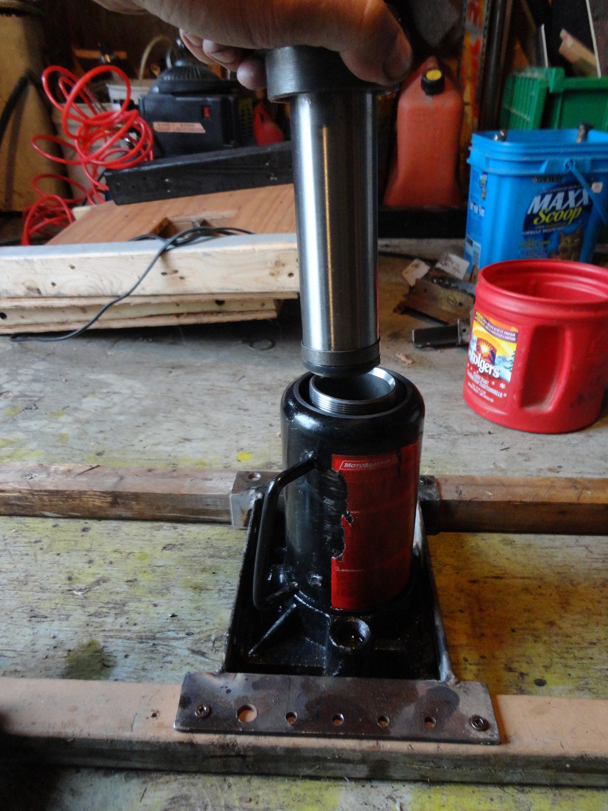

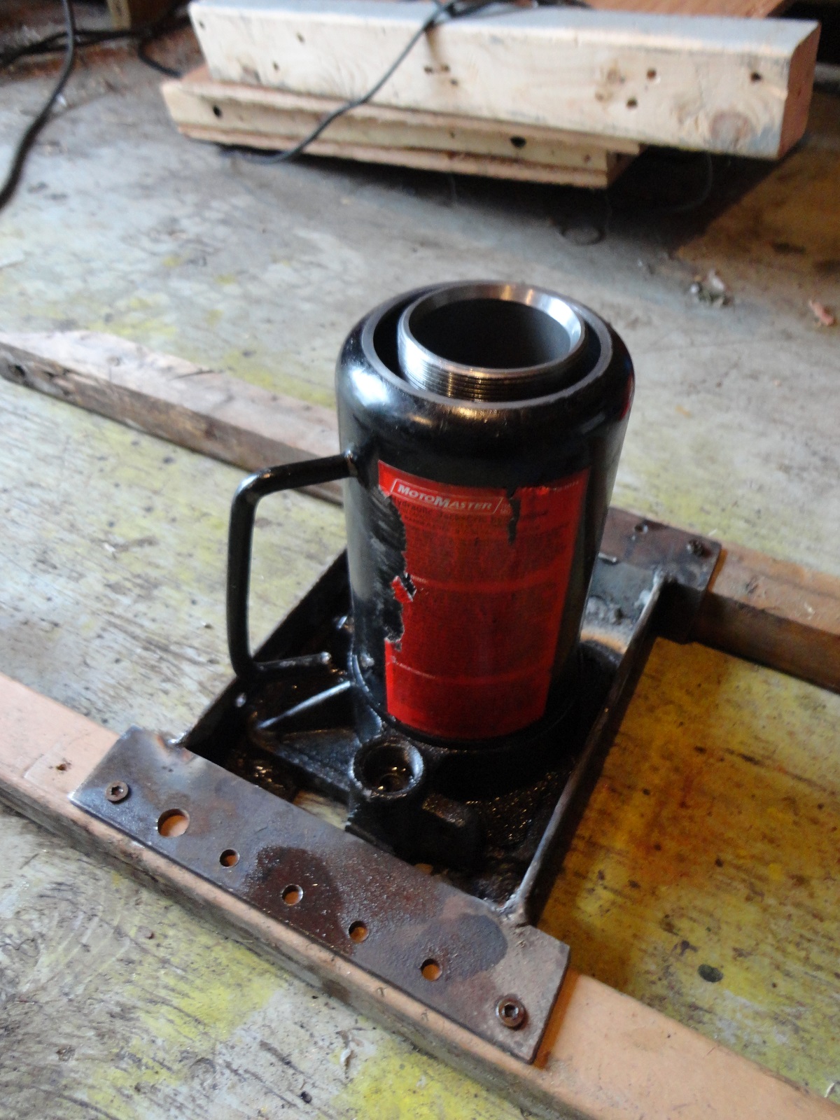

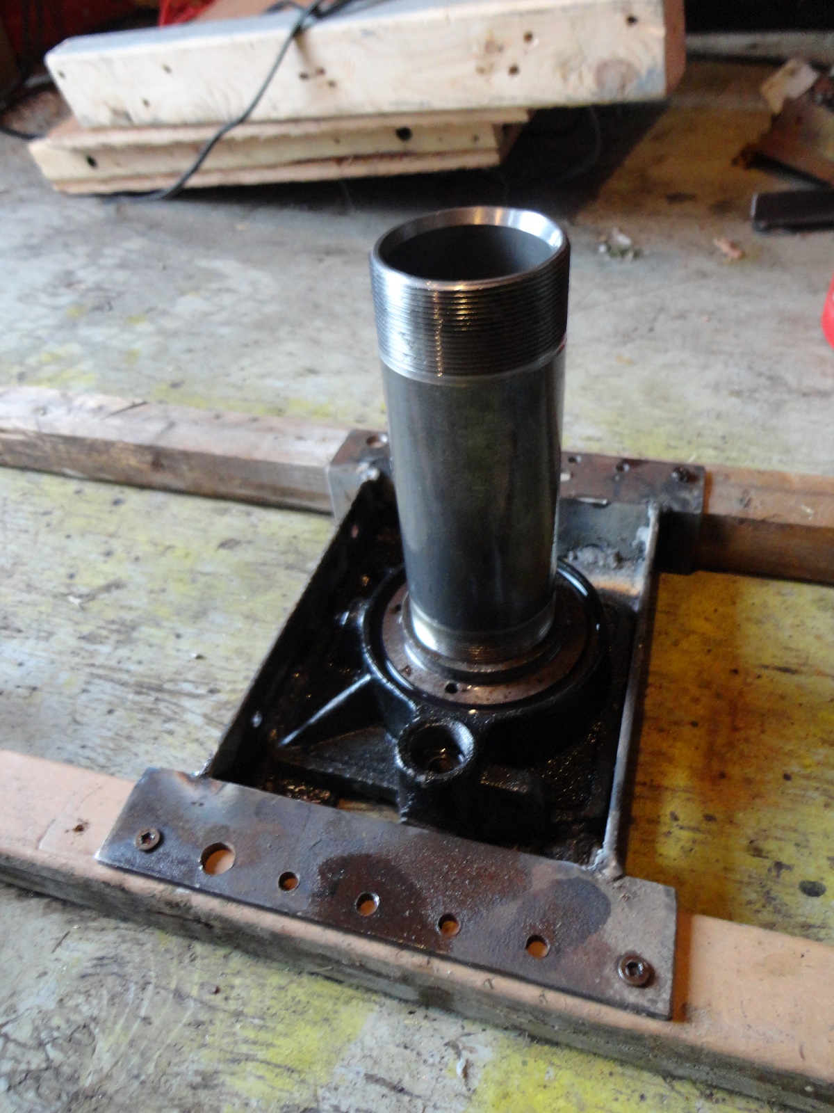

    I didn't use a spring for the dead load , i transformed a jack into air cylinder.

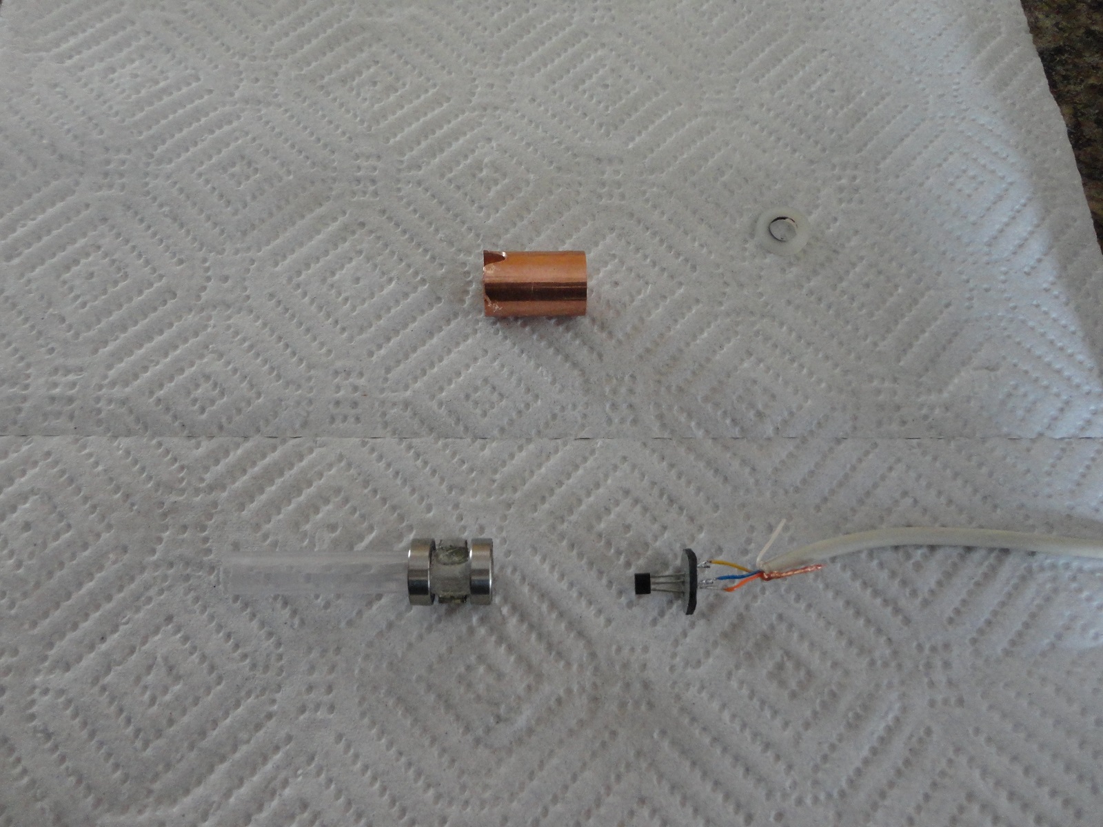

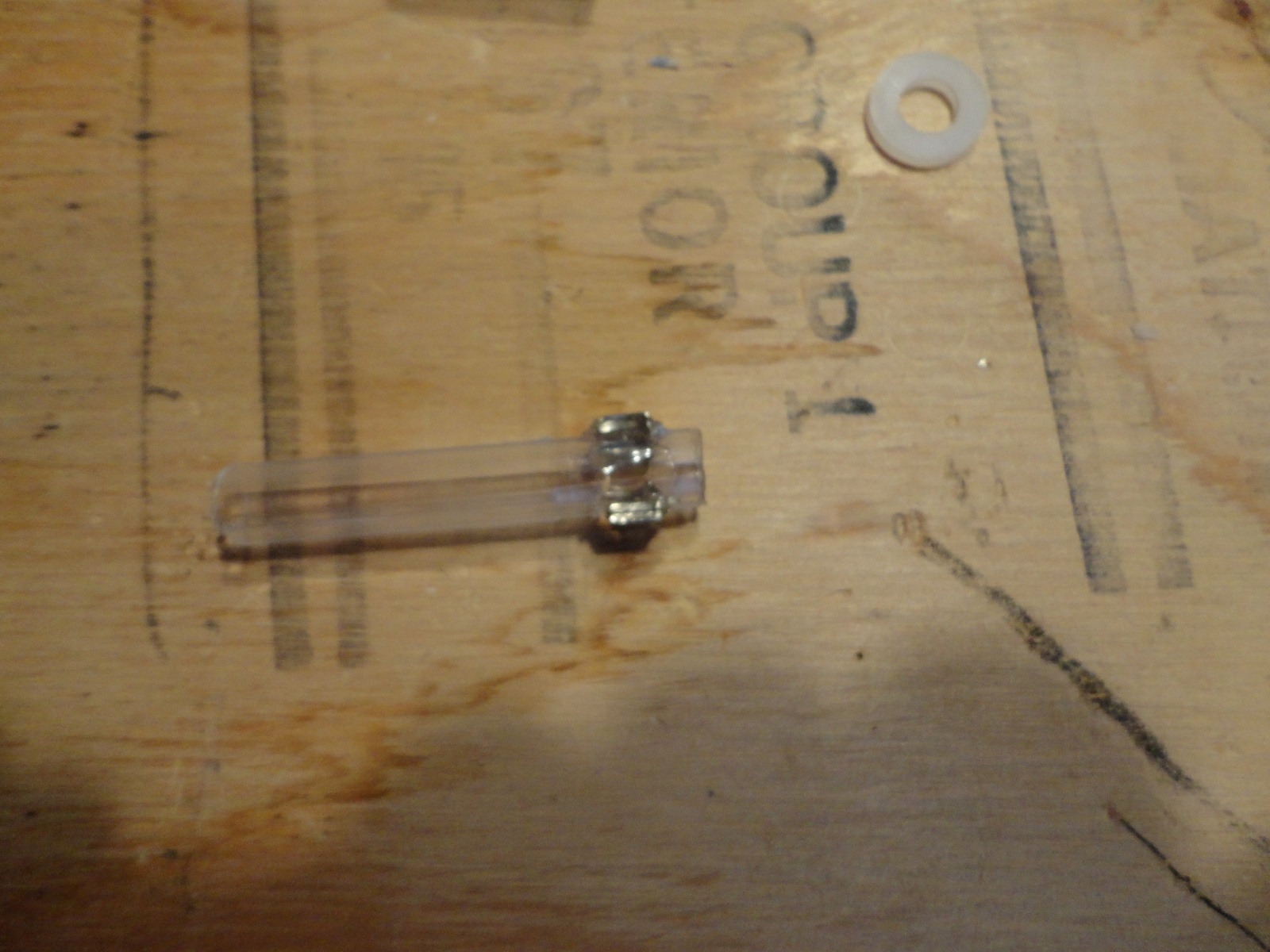

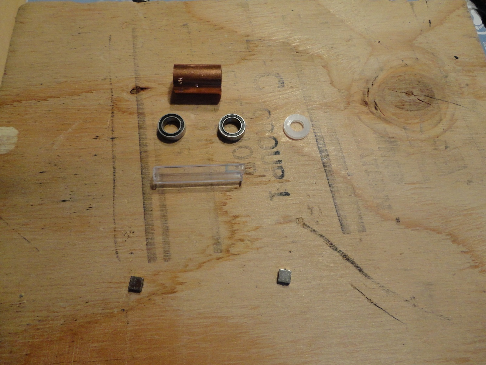

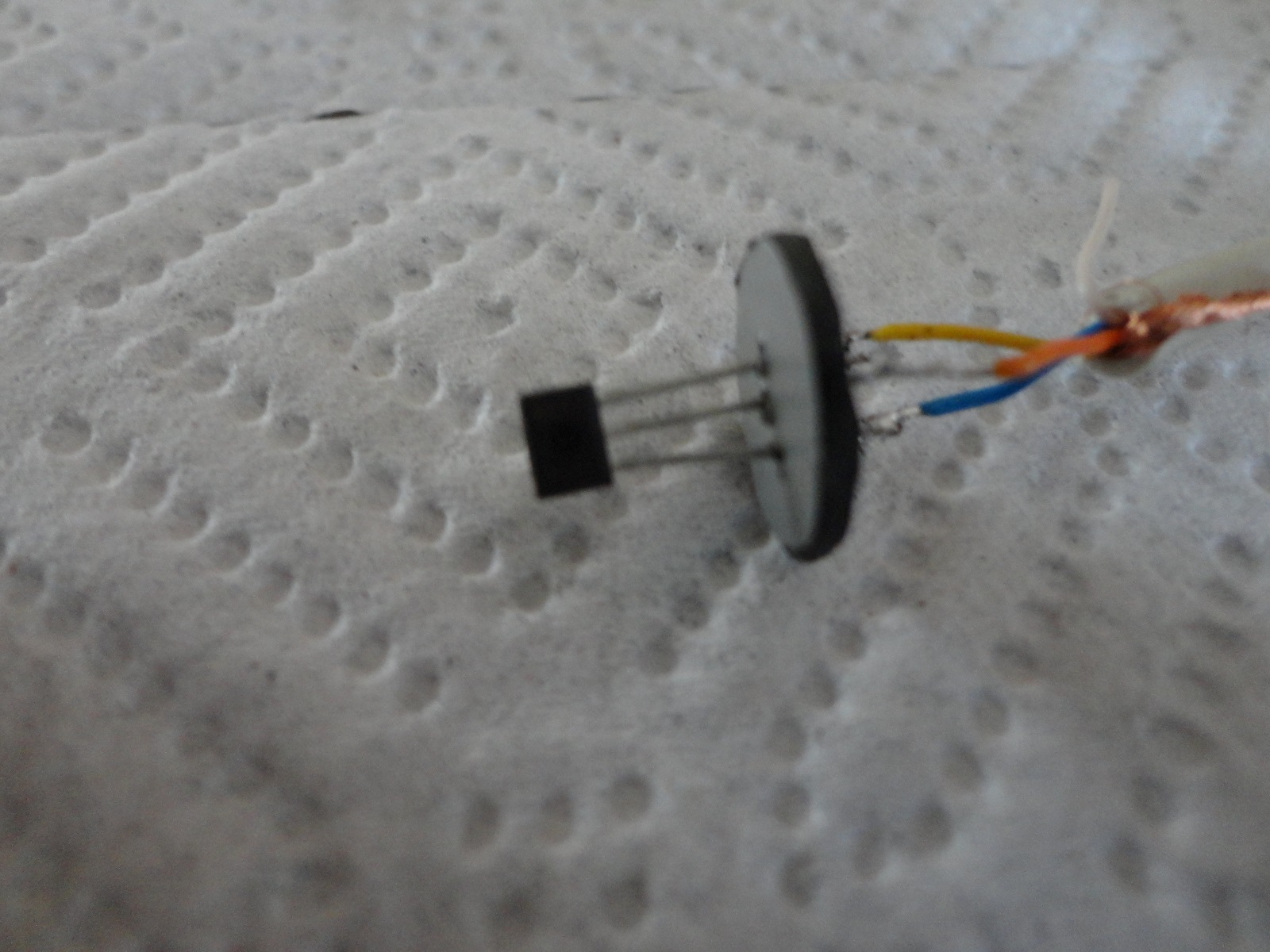

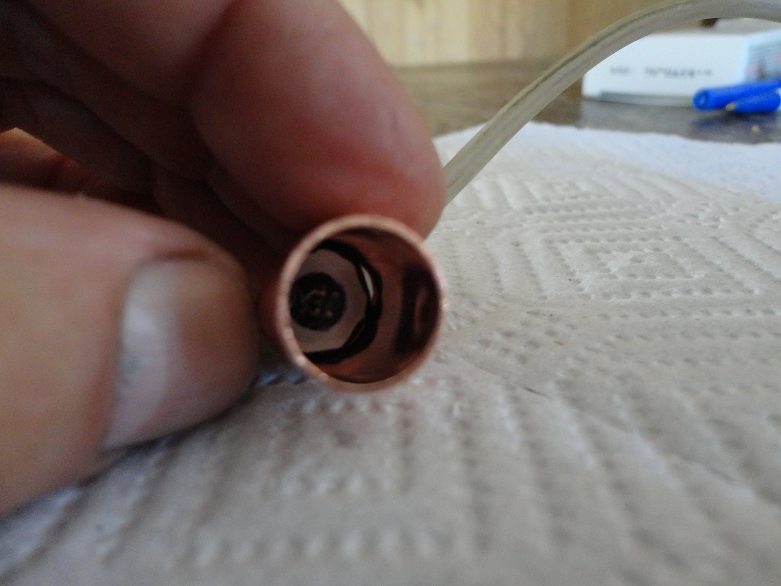

    the result of the air cylinder. It is adjustable with my air compressor close to the sim. And i can move it backward or forward for best balancing the dead load.

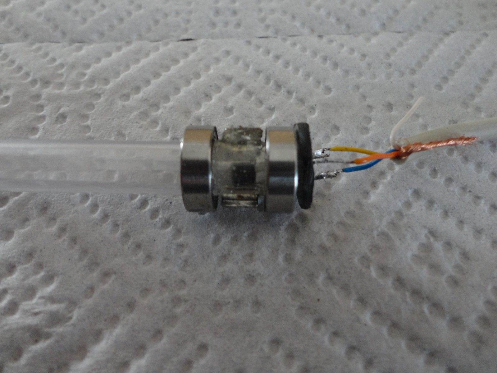

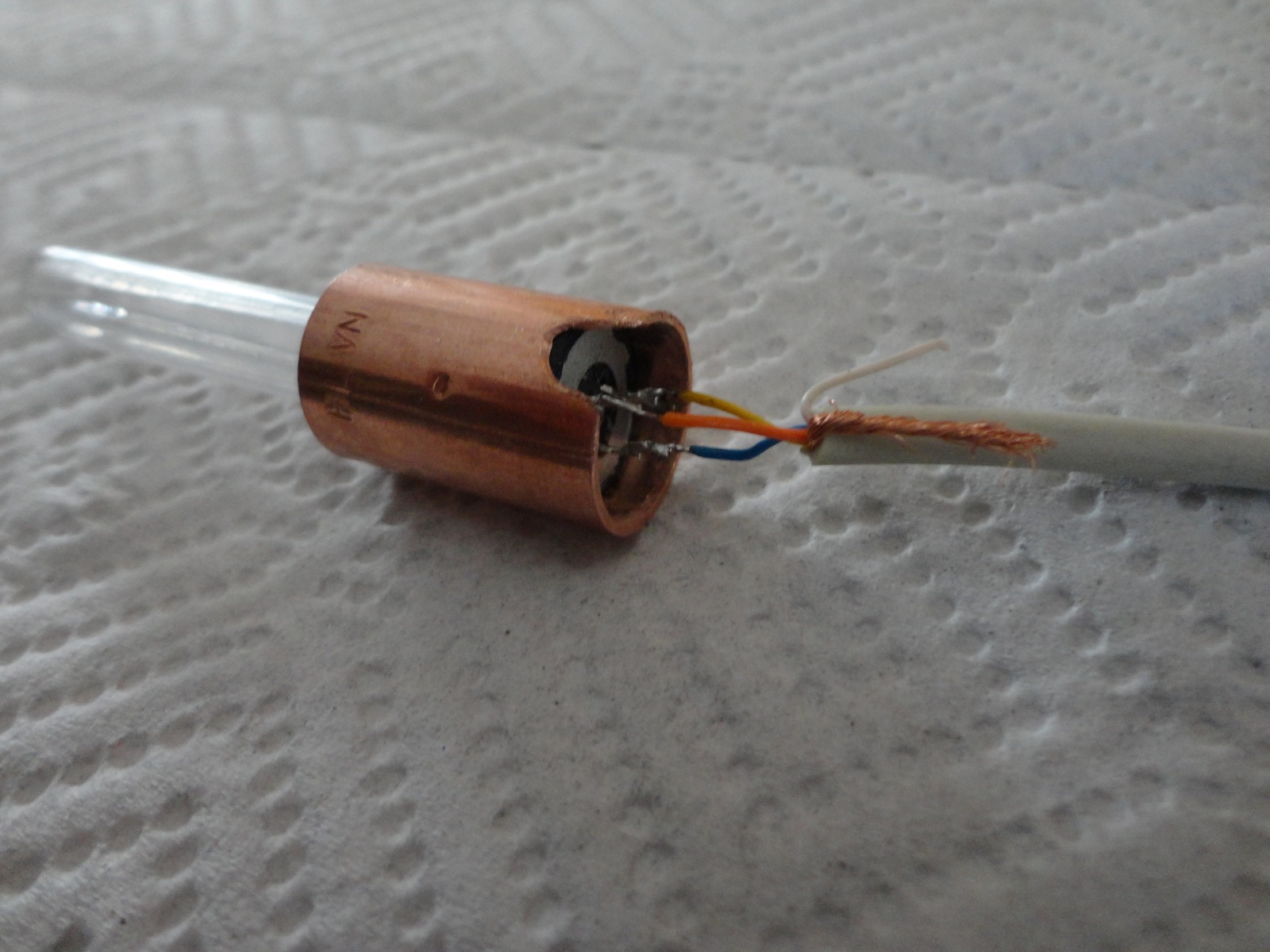

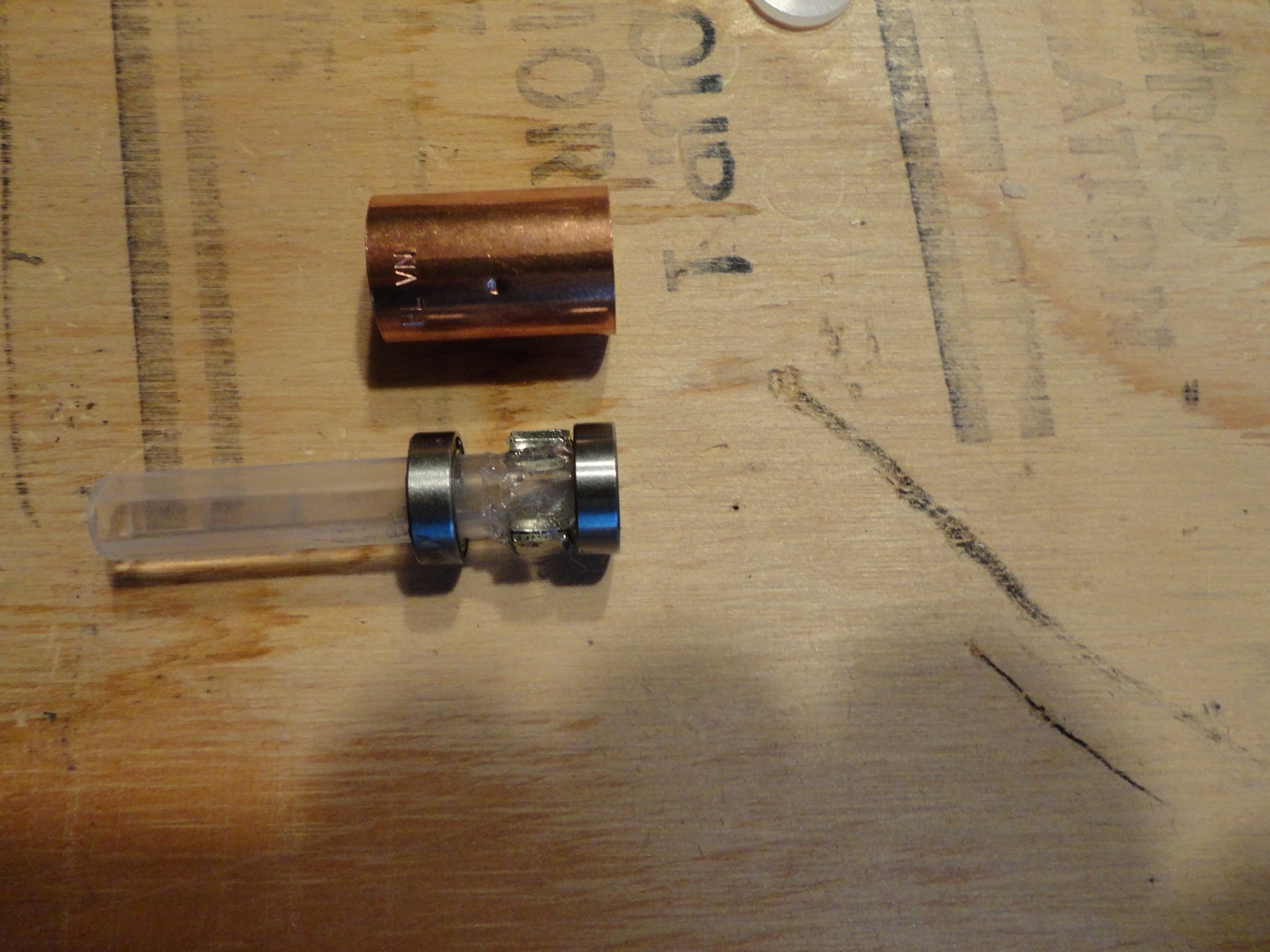

    For the sensor i used the hall effect (allegro A1301) . i follow this thread for building my own ;
    http://simhq.com/forum/ubbthreads.php/topics/3674791/DIY_Sealed_Minature_Hall_Pots_.html#Post3674791
    here is mine :
    DSC00206.JPG DSC00207.JPG DSC00208.JPG DSC00209.JPG DSC00214.JPG DSC00209.JPG
    it works very great but ......after built it , i realised that cost me almost the same price this one : 1560935-40.jpg
    around 20 dollars from digikey.
