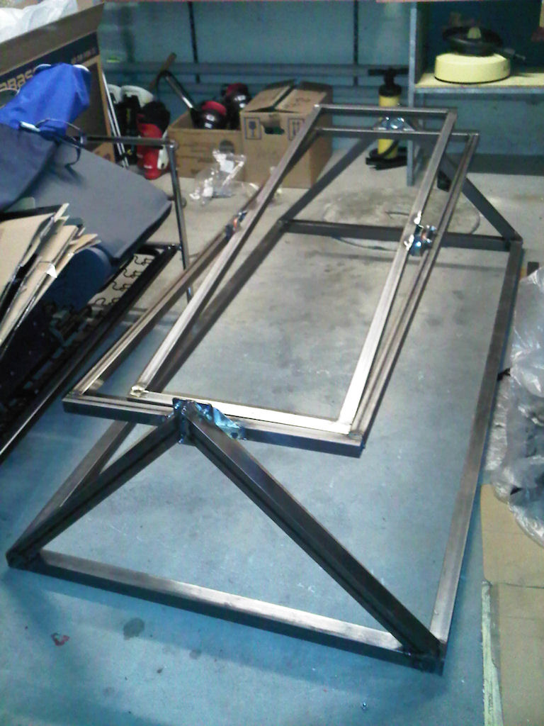

    Finally – after gone through hydraulics, servo and AC motors, actuators, real life measurements, 3DoF, 2DoF, welding course, etc. – my sim is coming to a life.
    It's a mixture of all different kinds of thoughts I leverage from the forum here. Thank you all, guys, for your help and your projects shared!
    After all I plan now to use 2 wiper motors driven by jrk's (too lazy/busy/scared for Tronic's AMC motor motion-controller with pwm/servo output)
    The screen shall be attached to the inner frame as well as the seat. The theoretical pitch angle is 30°, which is 0.5g. Let's see what the motors can stem.
    The motors shall pull 2 steel cables connected to the inner and outer frame. Geometric details still to be worked out.

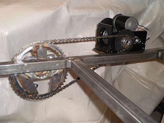

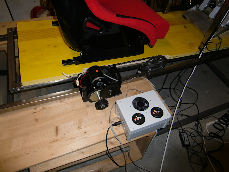

    Today I kicked out the wipers. They stalled at 9V/18A :( I mounted a winch (Arwin TRC9202) instead. Man is it noisy and screams for a good headphone ;D
    But it has the power! It easily moves my 25 kg sandbag up and down :yippiee:
    This is the Christmas present for me :D

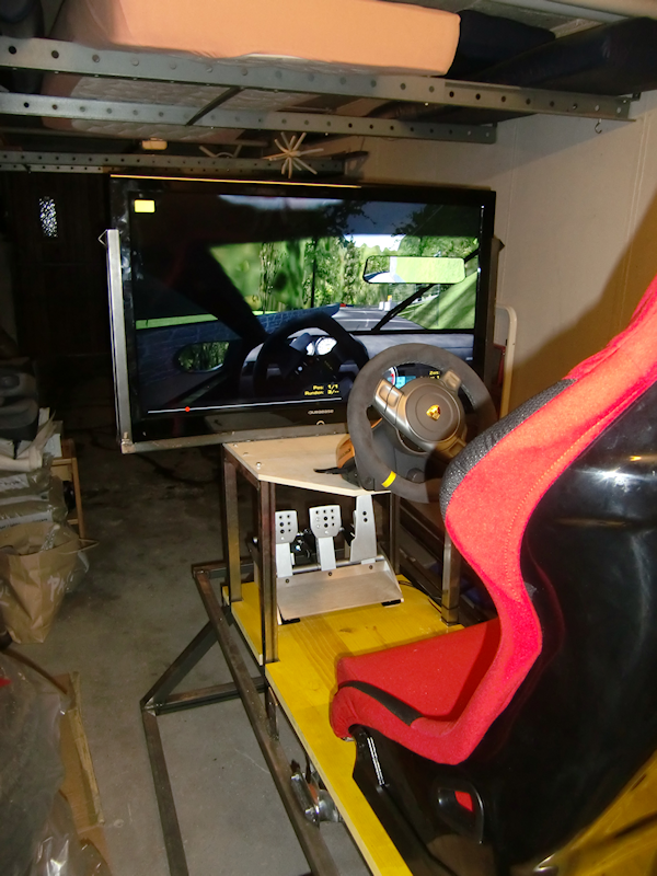

    Today for the first time I drove up the Klausenpass with my 1DoF sim :D
    It finally moves back and forth with me in the seat and the 40 screen in front. What a feeling! Still needs some tweaking of the settings – and the roll axis…
    The 12V winch works great in combination with the Jrk. The bicycle chain drive probably needs changing at a later stage.

    Here some video footage.
    At this stage the joyrider is very much a proof of concept. The Jrk is fantastic easy, all the components work nicely together, the winch can handle the ±36° up and down easily (18-20 A consumption max. so far)!
    Several things will need adjustment:
    • The gear ratio of the drive must be lower, i.e. the movements are too slow.
    • The backlash is hilarious. The bicycle chain is not the most efficient way to drive this platform. A timing belt might be better.
    • The computer needs an upgrade. The poor little Pentium®4 @ 3 GHz with rFactor @ 1920x1080, x-sim Sender and Profiler running is by far overloaded :cry:
    • The second axis must be constructed. A 1DoF is not worth the effort – although it's quite impressive how much more you feel like driving with the movement.
    • Tidy up the cables and paint the rosty steel…
    More to come…
    :D
  11. bsft

    The reasoning behind having the axis below the platform was that I want to have the movements as uniform as possible. In the traditional design the head is moving to the left while the feet are moving to the right (roll axis) and the head is moving forward while the butt is moving backwards (pitch axis). As a nice side effect of the chosen design the feet are not being moved as quickly and strongly. This apparently is an issue with the FD301
    Let me see how the winches and optimised drives work. I'll keep you posted ;)
    I must admit that I'm a little concerned about the intrinsic instability of the platform due to this design. In case of failure of a drive (chain) the platform will tilt hard to a side or back/forth. I’m considering installing couplers like these – unfortunately they are a little expensive. Similar clutches are widely used in cars for the A/C compressoraffordably priced – but the wrong way round: freely moveable during power-off, closed under voltage.
