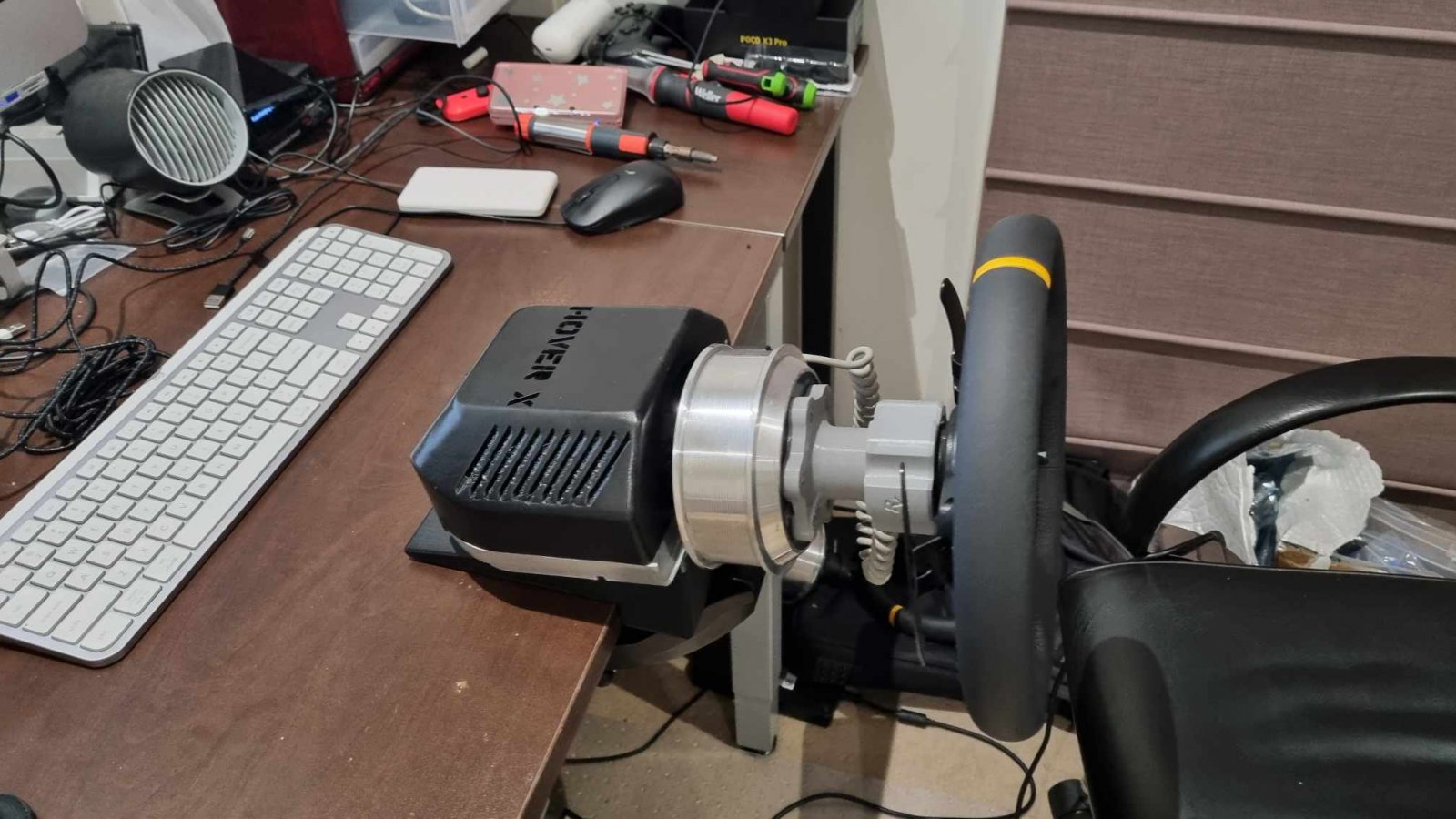

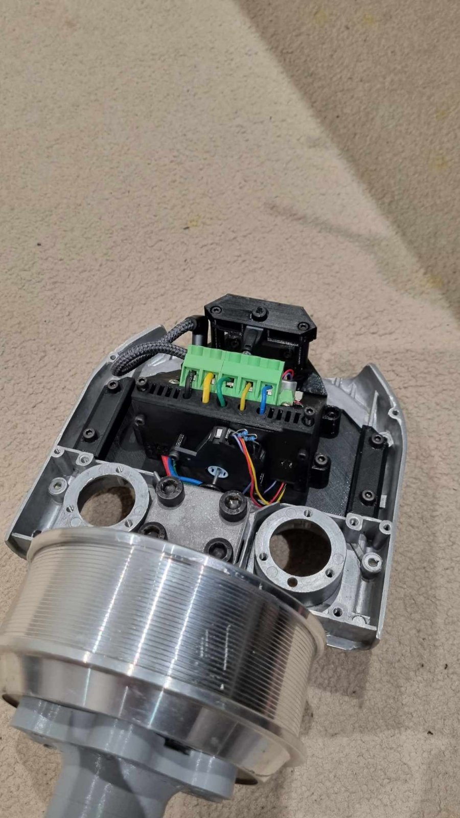

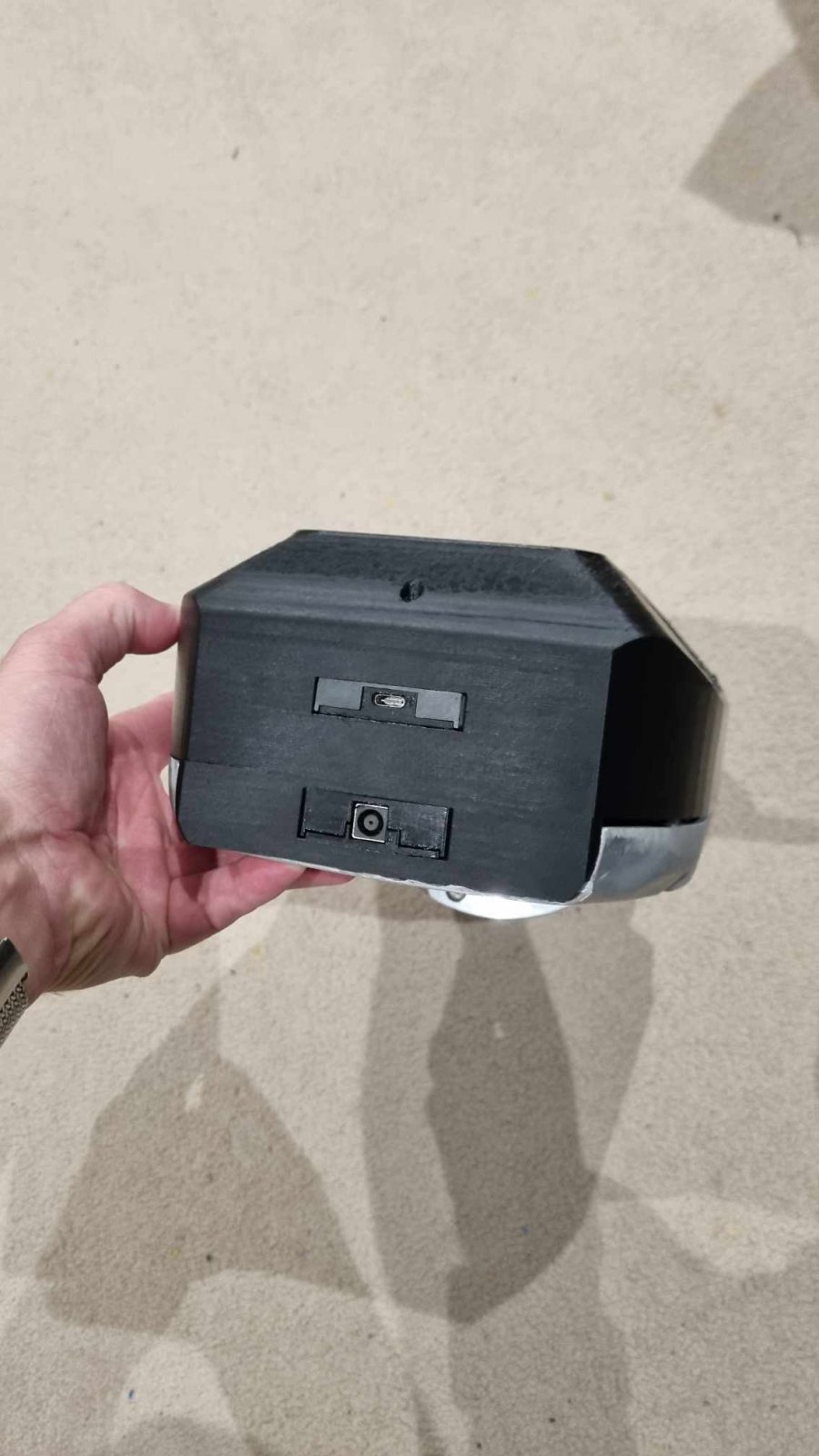

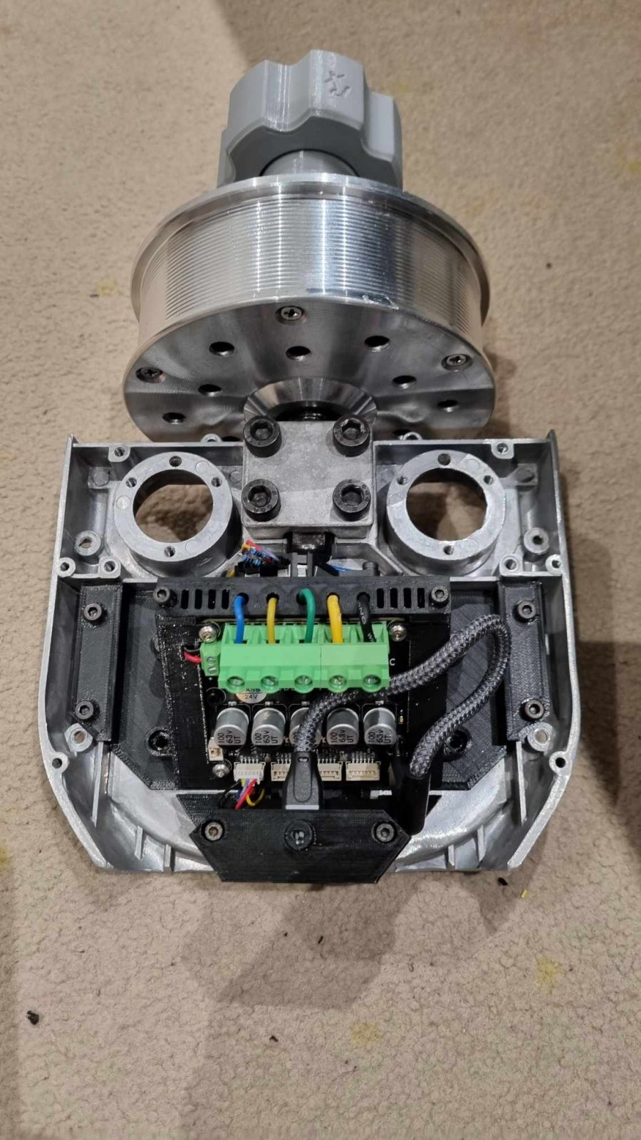

    Made a second one for my brother in law. This one has a few design changes:
    - Braking resistor mounted directly to hoverboard chassis for better heat dissipation
    - Vented rear cover for the hoverboard motor (i found my original would get quite hot after a couple of hours of F1 23)
    - ODESC 4.2 Controller
    - AMT 10E2 encoder (5120PPR/21480 CPR)
    - Remixed @Chris_Beeves cover with a new bottom half based on scanning my hoverboard base in then blending in the top half of his, then added some vents, an internal fan mount and my own "Hover X" text
    This uses the original FW from the github, not the new beta FW from discord, as the original firmware works perfectly with the Thrustmaster wheels with all the buttons working, The Beta FW doesnt support the D-Pad but @Roman Smoliakov might fix that one day....
    I also made a different desk mount, loosely based on the TM 300RS mounting system. it isn't as good as my original "brick". It has too much downward play if pushing down on the wheel. Going to come up with something else leveraging table clamps instead.

    I'm using a dell/alienware R15 laptop power brick. It puts out 19.1v 12.3A which is plenty.
    I have the power output limited to about 45 within the settings app and often turn down the FFB in game.
