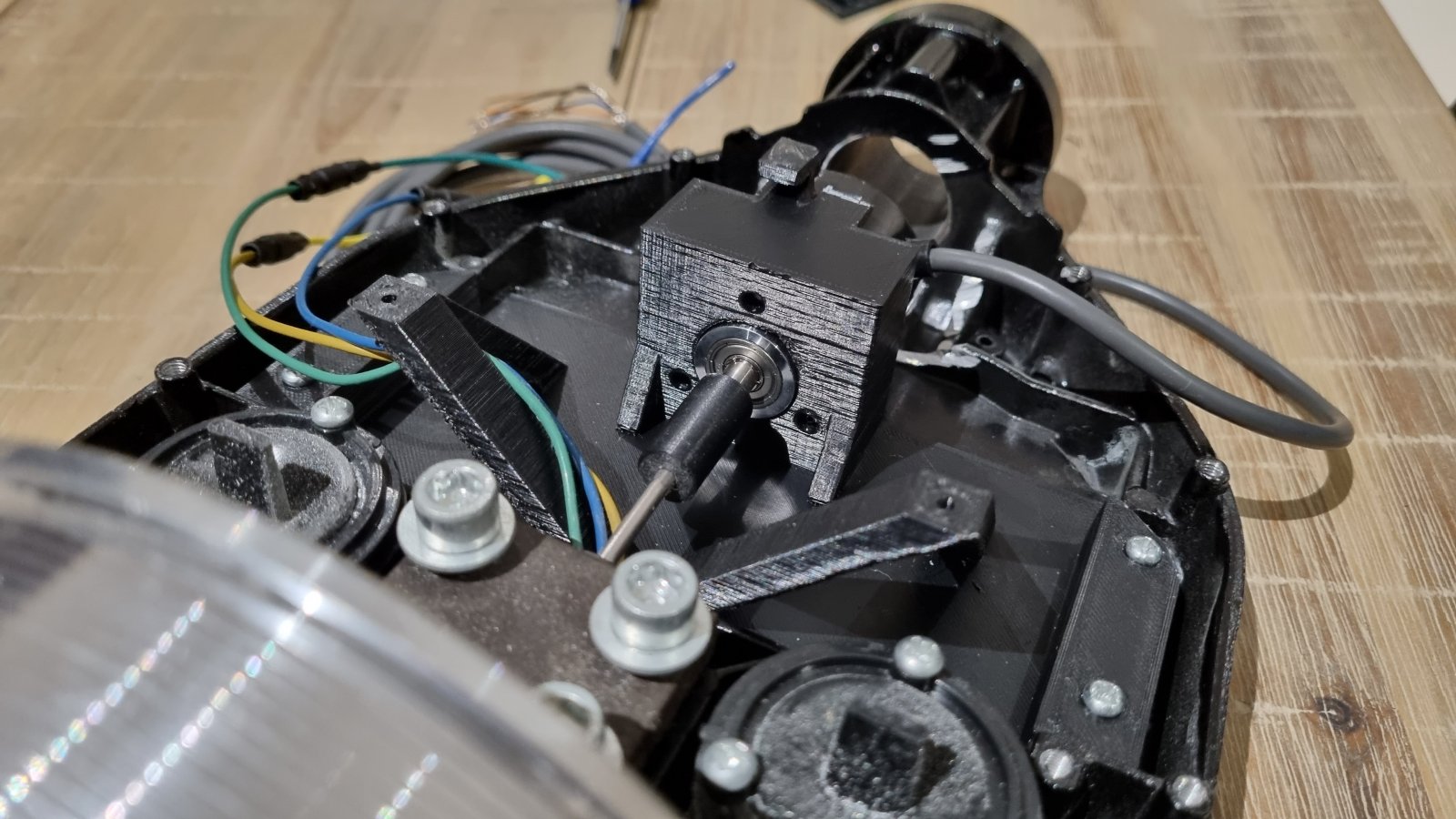

    First post here. Just wanted to say hi and show what i've built so far.
    Started with a dead hoverboard and removed the motors.
    Disassembled the motor and drilled the shaft out with a 9mm drill bit and removed the wiring and circuit board for the inbuilt hall sensors.

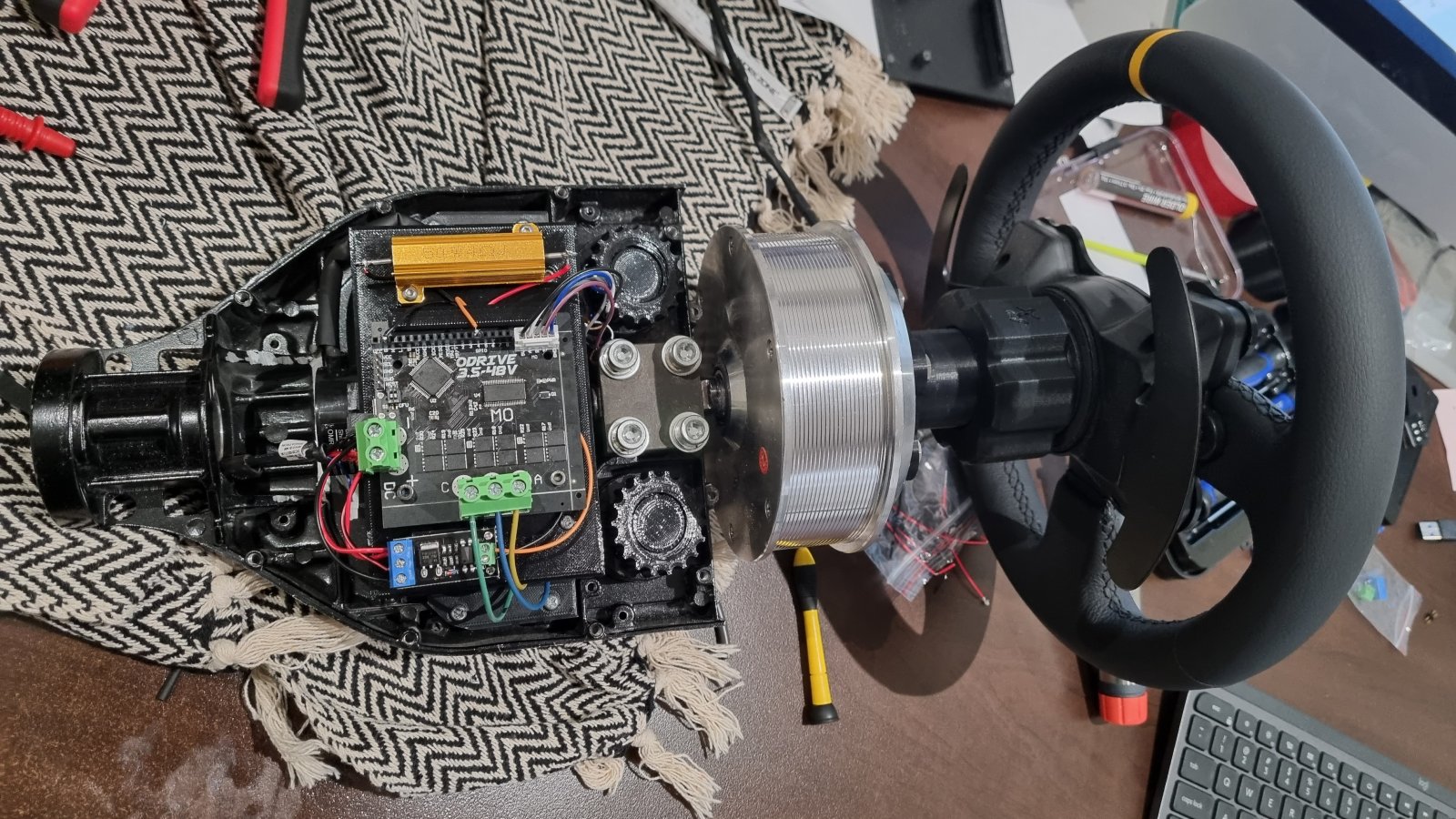

    Then i designed and printed various mounts for the encoder, odrive 3.5 (clone), FN120 mosfet and 50wR4 braking resistor.
    The encoder is connected through the shaft to the adapter i printed to mount a thrustmaster wheel using 3mm stainless rod which then connects to the 6mm encoder shaft with a printed adapter. I still need to wire up the mini-din 6 pin adapter but need to figure out how i want it to interface/connect to the case first.

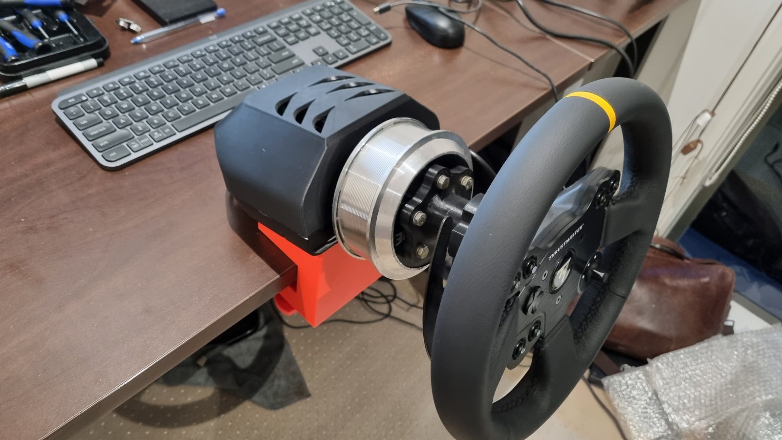

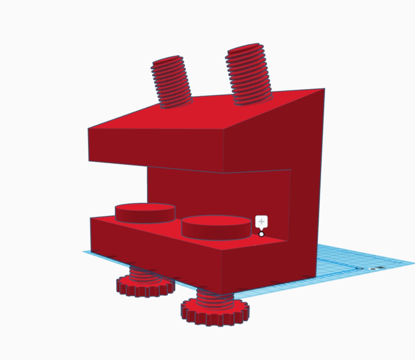

    I also designed an angled desk clamp setup to secure it in place.
    angled mount.jpg The whole thing is powered by a 19.5v 12.3A laptop power supply from Dell/Alienware. I will chop off most of the round part at rear of the chassis and make up a panel to secure the power supply lead and usb cable. Still have to design a cover for the top of everything, however another member on the forums seems to have done something similar so hopefully he'll be able to find the file to share.

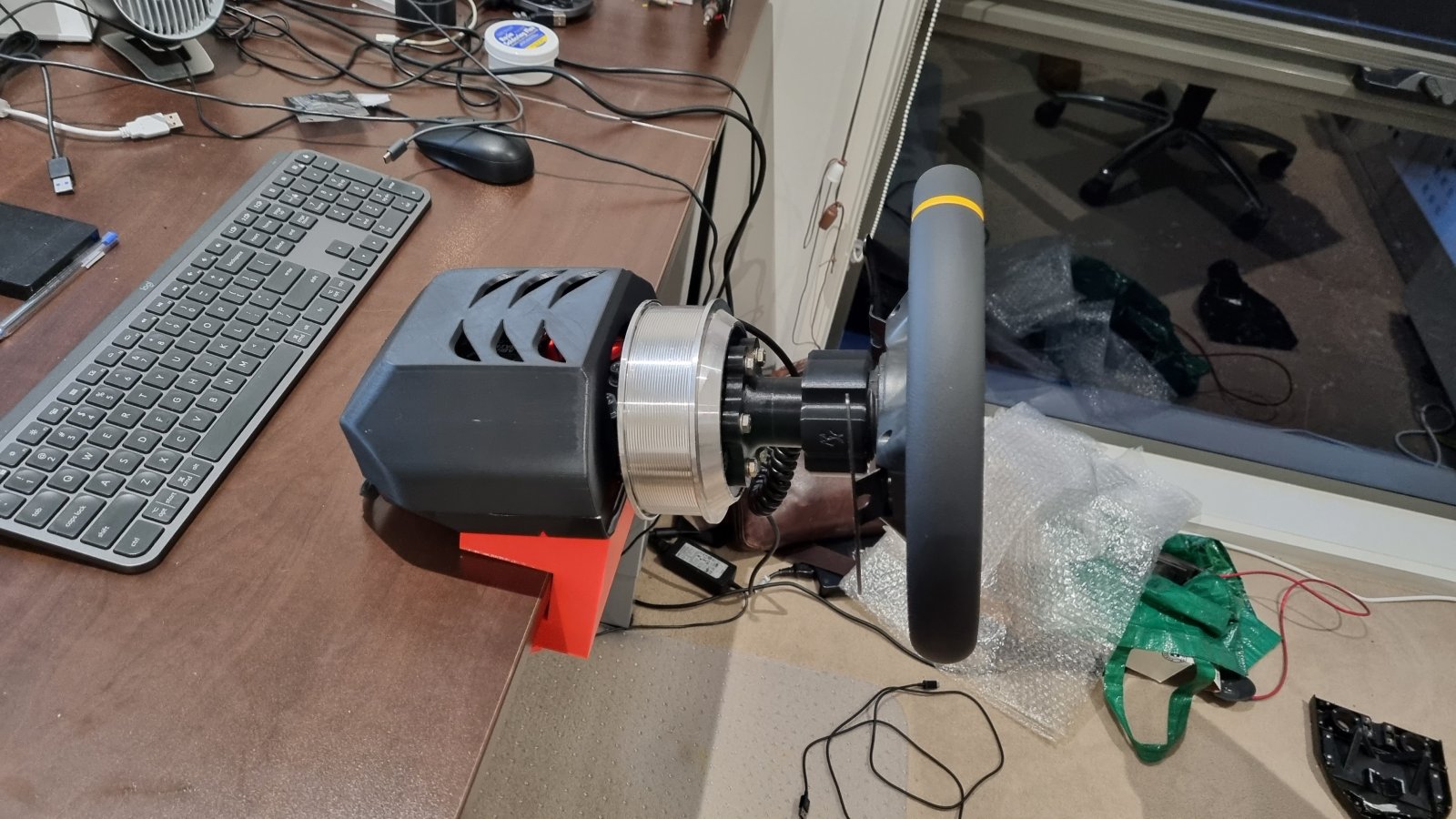

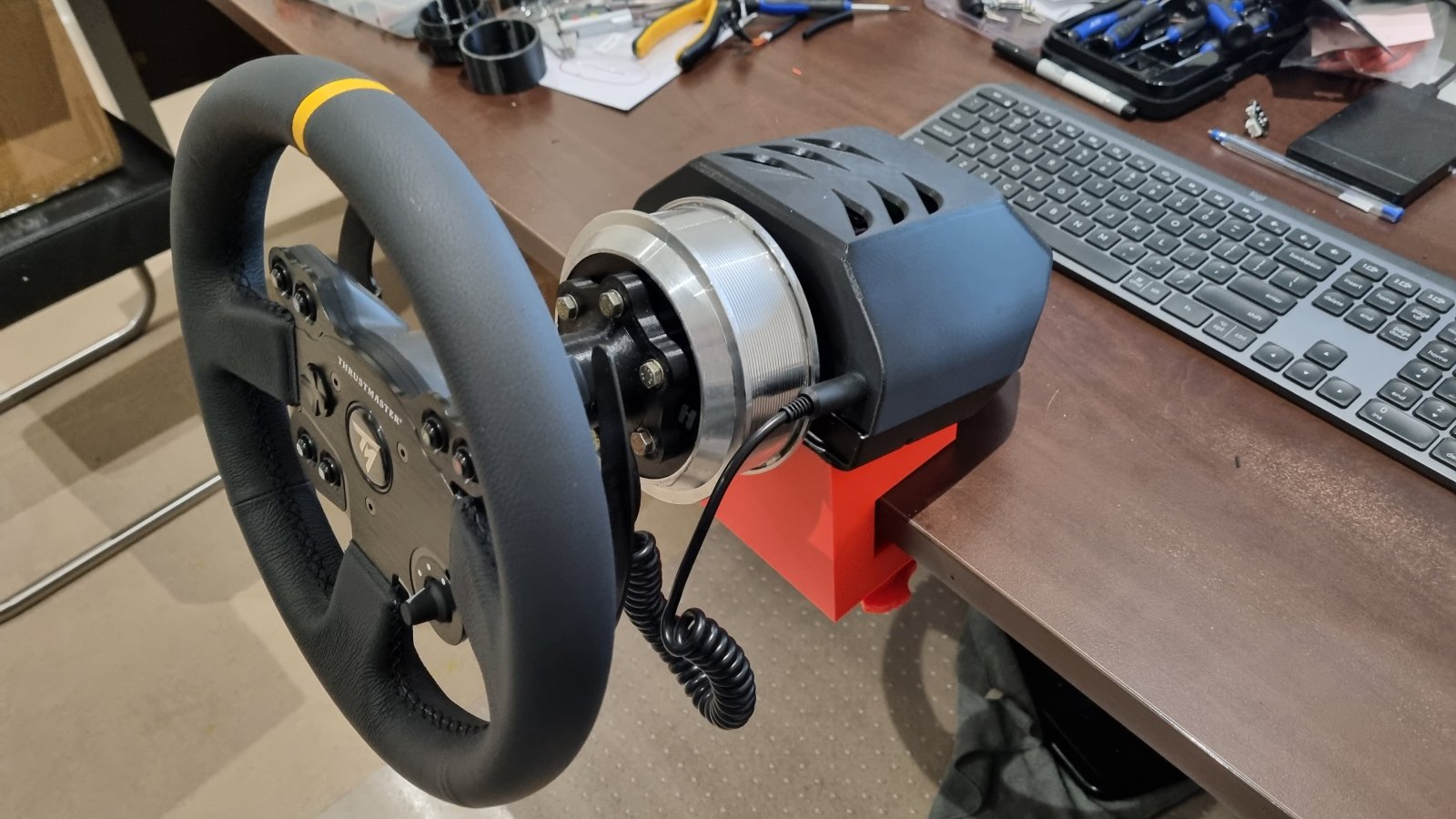

    Finished product.
    Thanks to @Chris_Beeves for the stl for the top cover!

    Does the encoder axle share the 9mm hole with the motor cables now?

    Yes the encoder shares the hole in the shaft. Theres possibility for very slight rubbing, however i dont foresee this being a big issue given the speed and amount of rotation being fairly minimal.

    So with this setup you dont need a separate controller board but you use that built in stm32 in odrive(clone) to control the force feed back? am i getting anything wrong here?

    It’s all-in-one. Just connect power, motor and encoder and you’re set.
    Well, you need to add a braking resistor and a mosfet for that, but no external mcu.
