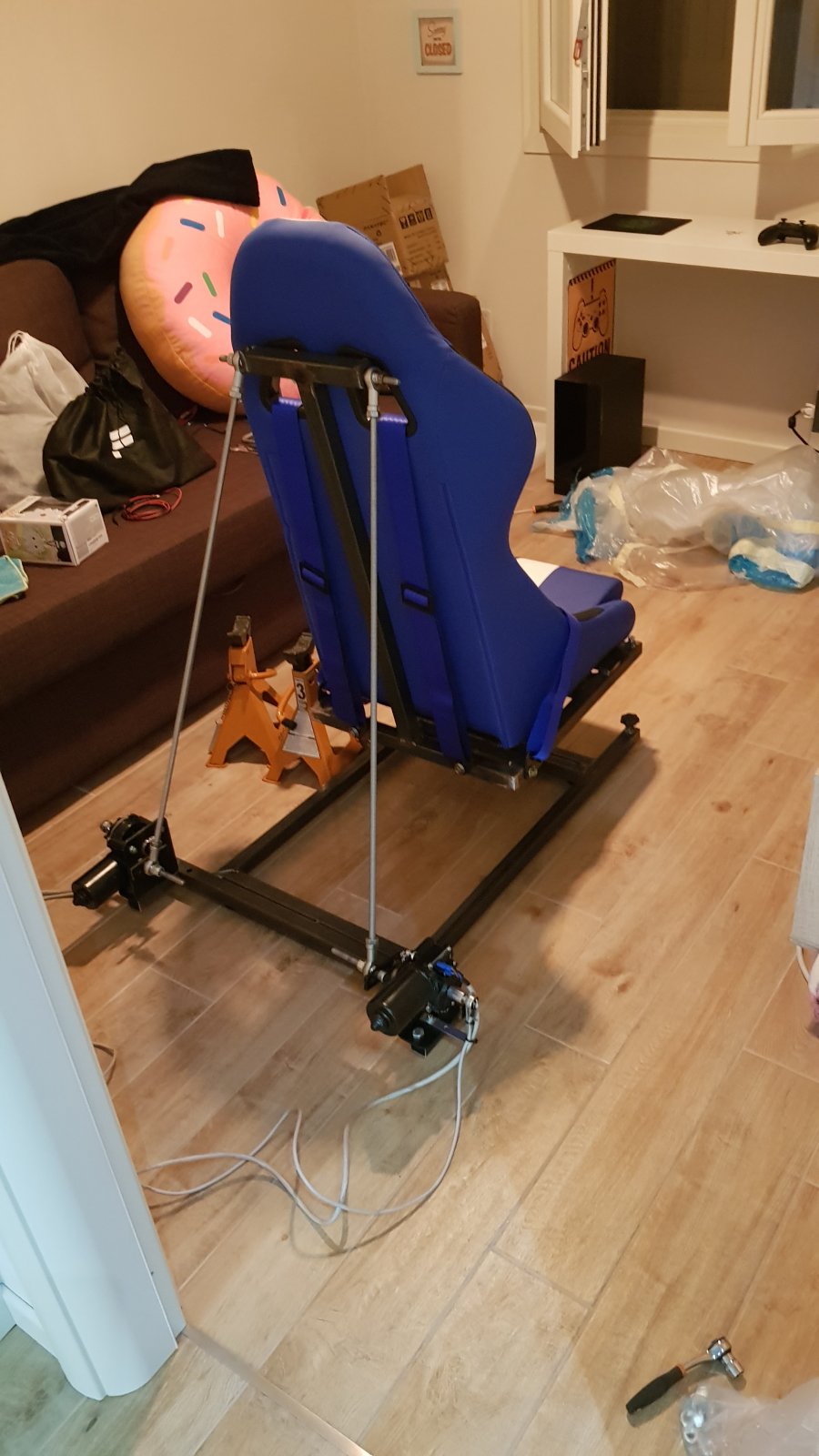

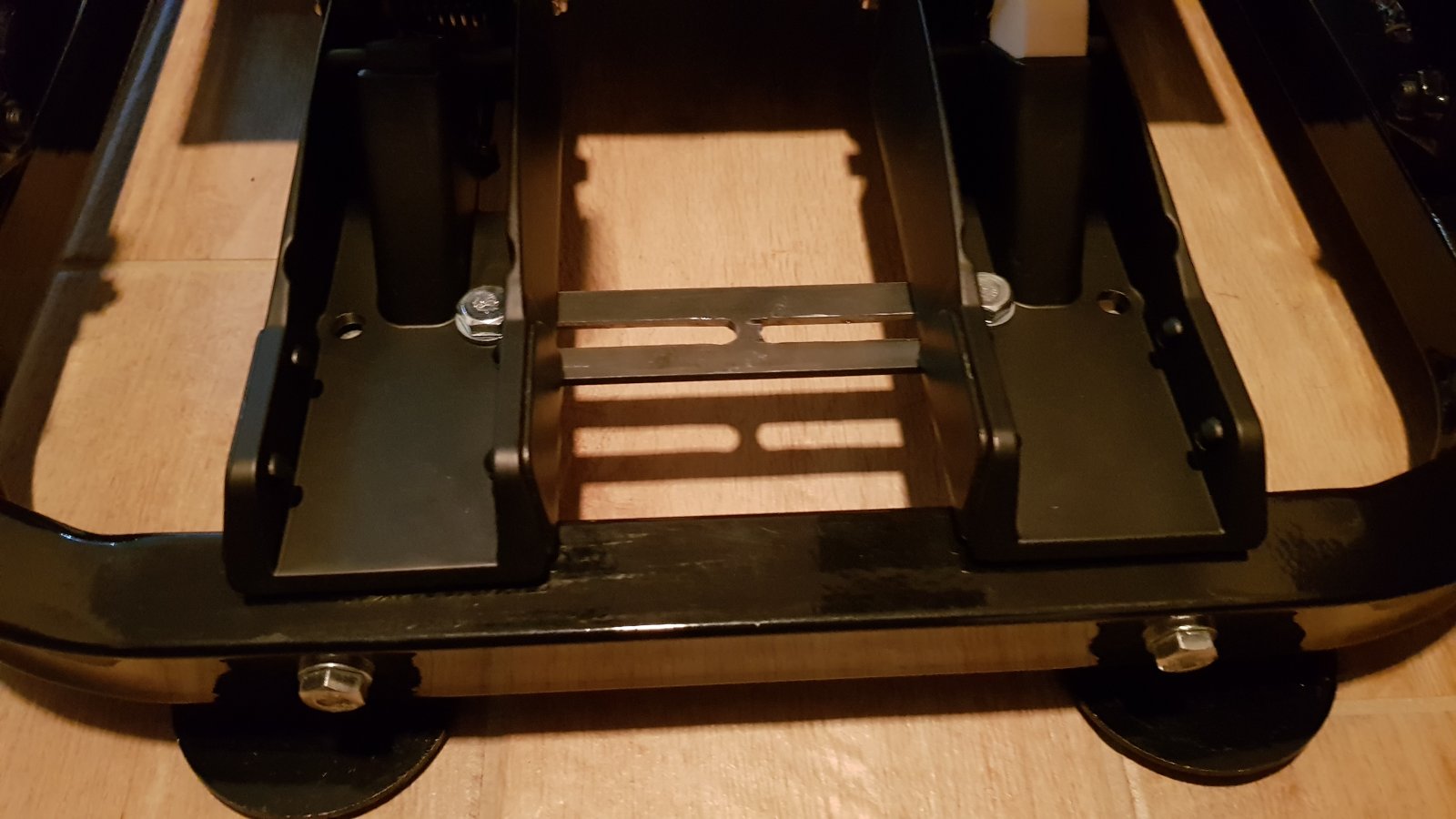

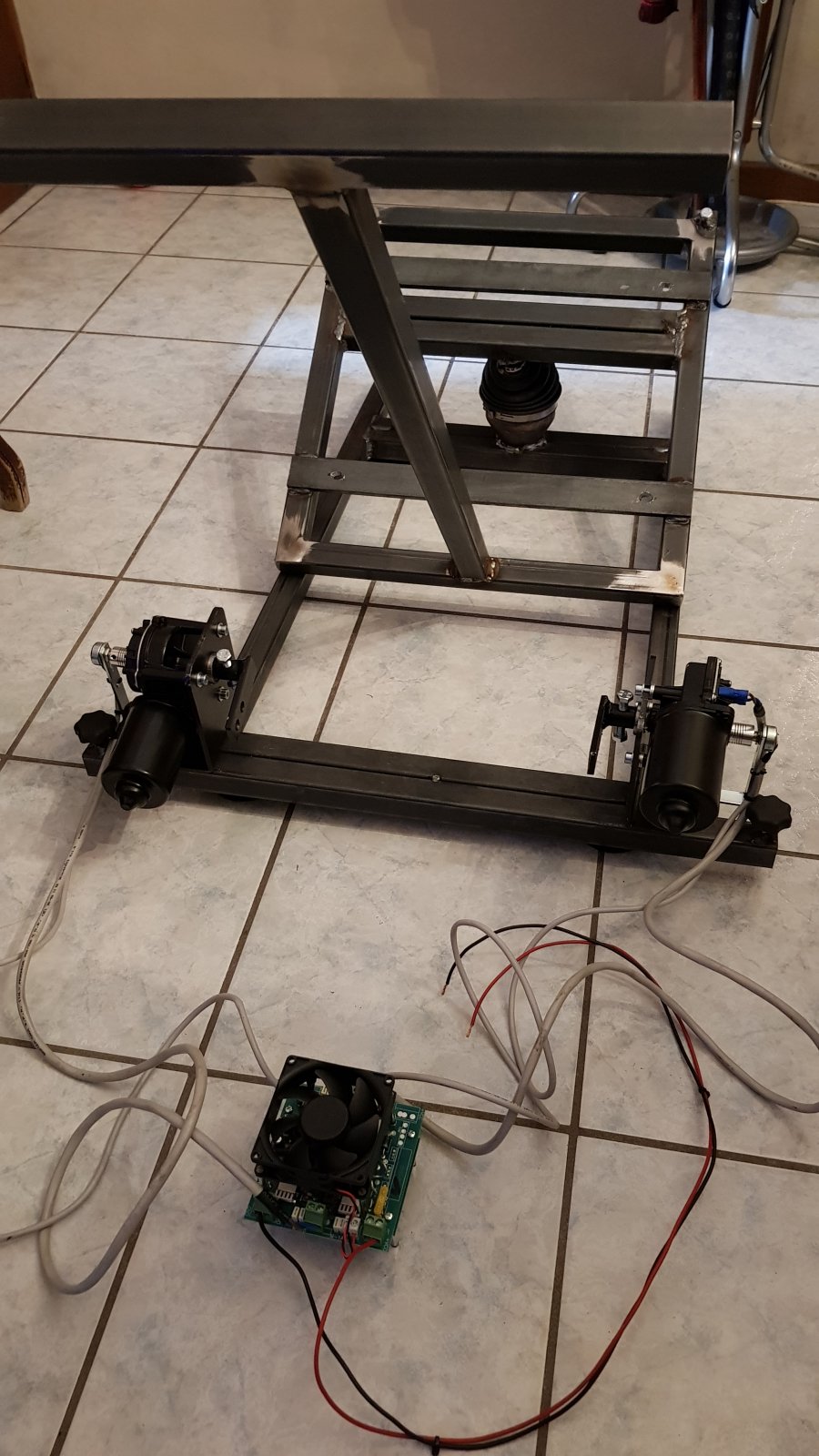

    I wanted to present you my project almost finished 2dof dynamic simulator 24v checked with Arduino a special thanks to Dinamic Symulator Italia for support and you for your fantastic software
    20171208_125716.jpg 20171208_125729.jpg 20171208_125716.jpg 20171208_125729.jpg

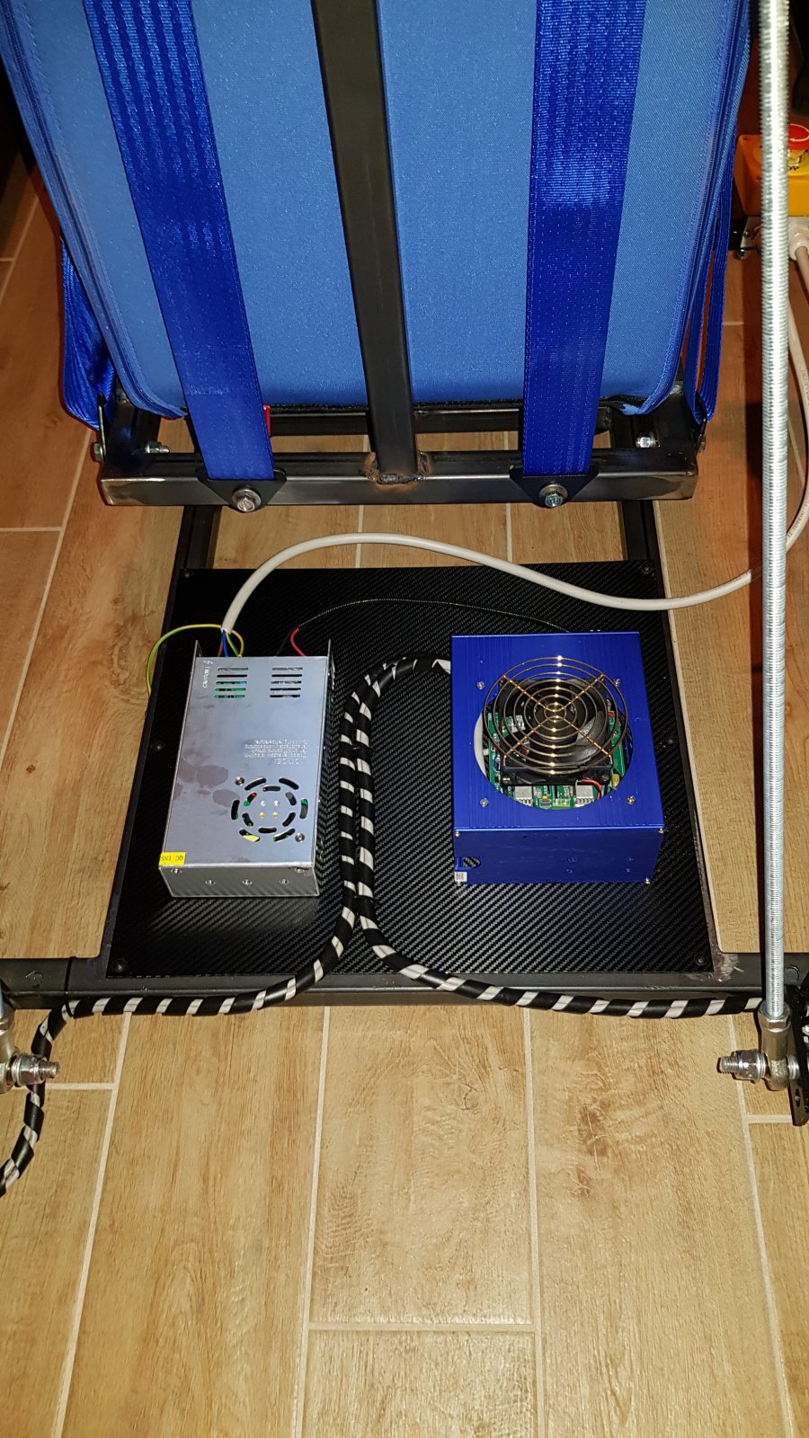

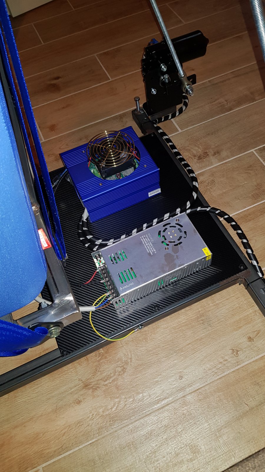

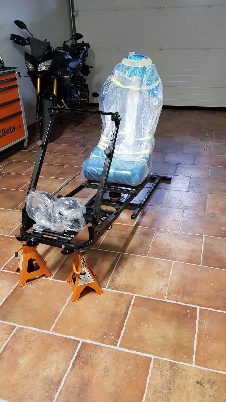

    the project is in continuous development the electronics have been placed inside an old power supply they were really satisfied with the final result

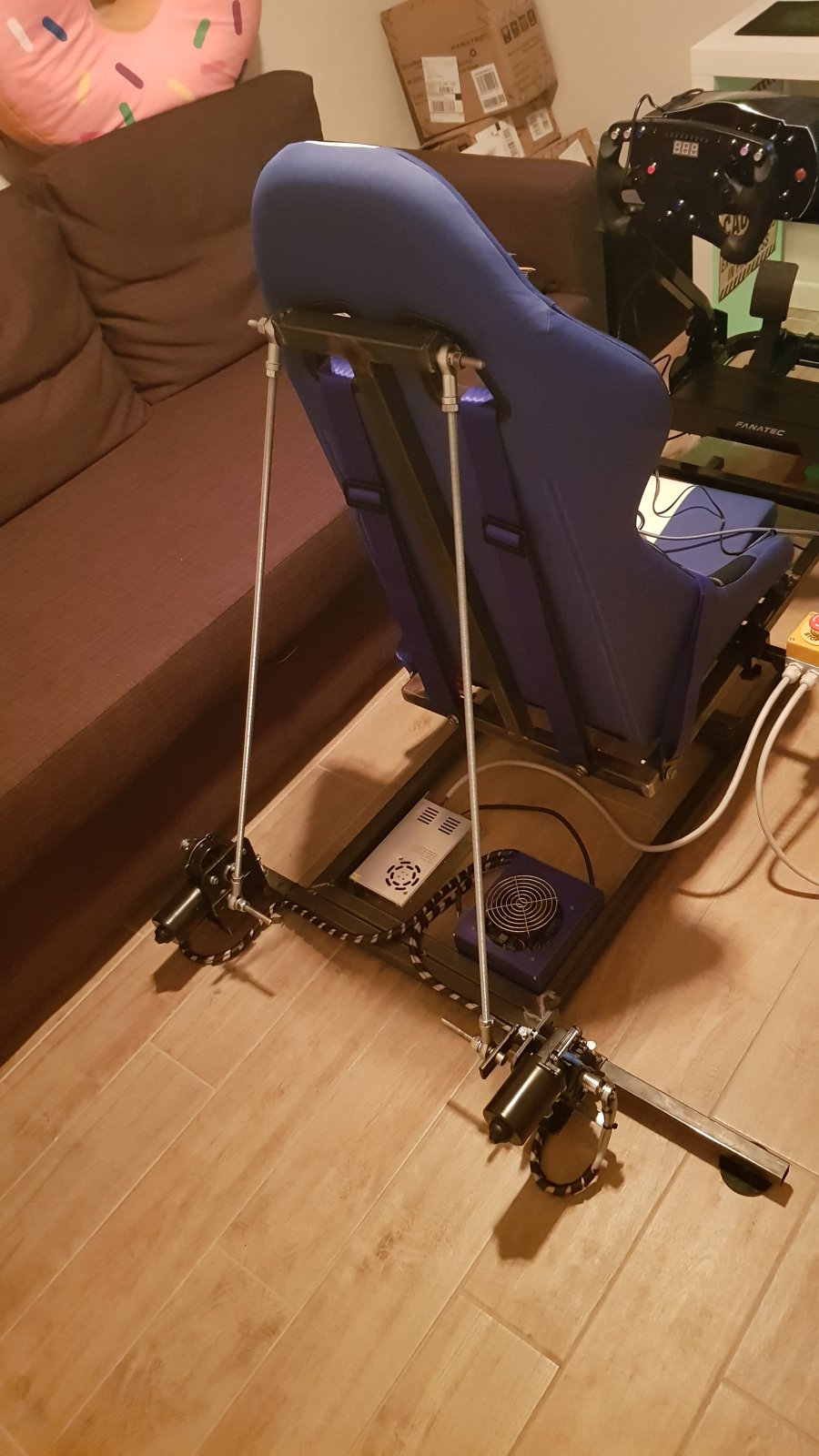

    the station is completed from the fantastic Fanatec ClubSportV2.5 steering wheel formula and elite pedal board with load cell
    I'm studying a system to cushion the side thrusts .....
    two of these should help the engines return
    the result is fantastic the result is fantastic, we will update in the next days with some improvements......
    someone can advise me how to amortize the structure??

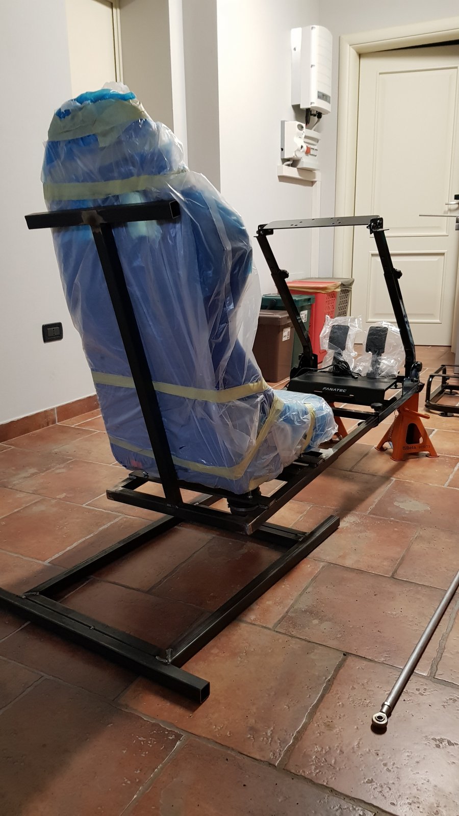

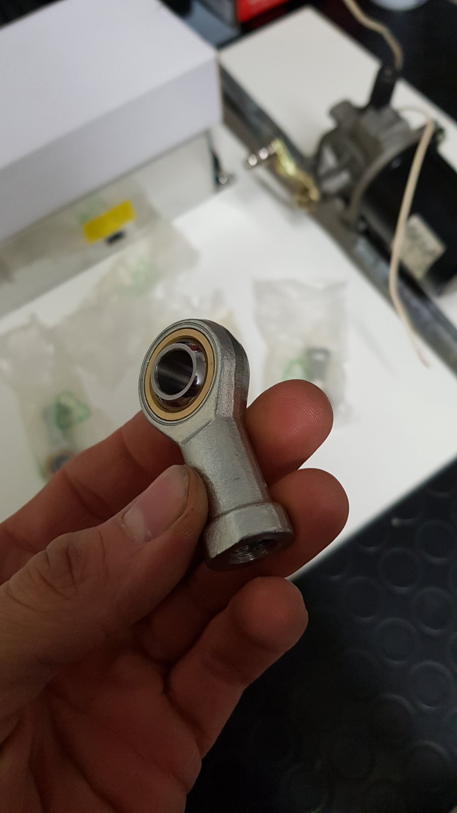

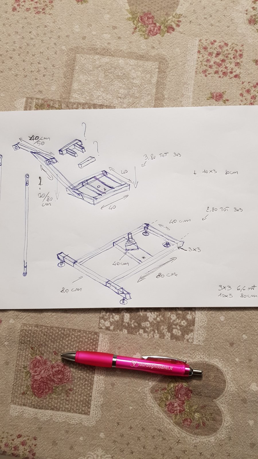

    next improvements......
    remove threaded bars e add aluminum bars turned and threaded m10
    background painting and final black paintwork

    I use furniture amortizer. There are different resistance and dimensions.
    Good luck with your project!
