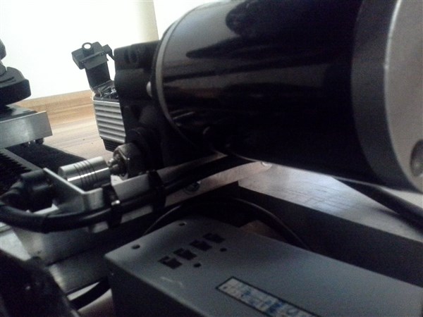

    Ok, I've been looking at @rundmg build and I think have a good grip on the basics. My concern at this point is all of the smaller connections. I'm not sure how the metal rods attach to the pot and motors. I can see quite a few bolts and L-joints (sorry if that's not the correct term) and some glue on the top of the motors holding the joint in place. It's the small connectors that I can't quite see from the pics of how they all fit. I'm going to start the base frame build this weekend and am thinking about ordering the jrk boards, motors and pots soon (most likely the same ones from @rundmg build since it sounds like those are decent and quiet). Thanks for all the tips! I'm a little nervous about building this from scratch since I obviously don't want to screw it up and waste the money that I'll spend on parts, lol...I'm just trying to get as much info as possible before I start!
    21,723
    152,051Coins
    +11,063 / 56 / -2
    There is a FAQ on various ways to connect pots: http://www.xsimulator.net/community/faq/how-to-connect-potentiometer.13/
    Using a coupler of the right size is a pretty easy way to go, if that fits your design and motors: http://www.xsimulator.net/community...f-simulator-conversion.5914/page-3#post-63809
    The bracket that hold the pot should have some give and it is better to attach to and move with the motor, rather than be attached to the frame, as the latter can cause binding and strain.
    Don't forget you can pose a specific questions or put forward an idea before doing anything as you go along.
    21,723
    152,051Coins
    +11,063 / 56 / -2

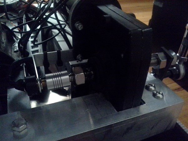

    OK I just took these close up front and back shots of how I mounted my pots, which is just one way of many to do it.
    I used 20x2mm flat aluminium mounted directly to the existing back holes in the motor case. I was very careful in getting this bracket spot on and actually made about 6 of them before I was happy that they correctly aligned the pot with the shaft coupling. There are plenty of other ways to achieve the same thing.
    I had originally planned a direct attachment of the pot to the motor shaft, mainly to save space, but changed my mind at the last minute and grabbed a coupling as it allows for some variation and movement if the hole in the shaft is not dead center. Hence I adapted what I had already done in drilling the M8 hole in the shaft to how I needed to connect that to the pot coupling, so it is more complicated than it should have been if I had the correct coupling and planned to use that from the start: http://www.xsimulator.net/community/threads/dx-racer-compact-simulator.5866/page-3#post-63105
    Hope that helps more than confuses, just keep in mind we all tend to adapt a solution to suit ourselves!

    Thanks @noorbeast, I appreciate you taking the time to take the pics. That looks amazing! I don't have any mechanical equipment to drill into metal so can this be done with off the shelf items from a hardware store?
  8. Nick Moxley
    17,056Coins
    +2,506 / 30 / -2
    Coupler's are going to be your best bet Ben. They just clamp on to what ever round shaft you want, like the Pot and Axle bolt. Just get the proper size the first time for your Application.
