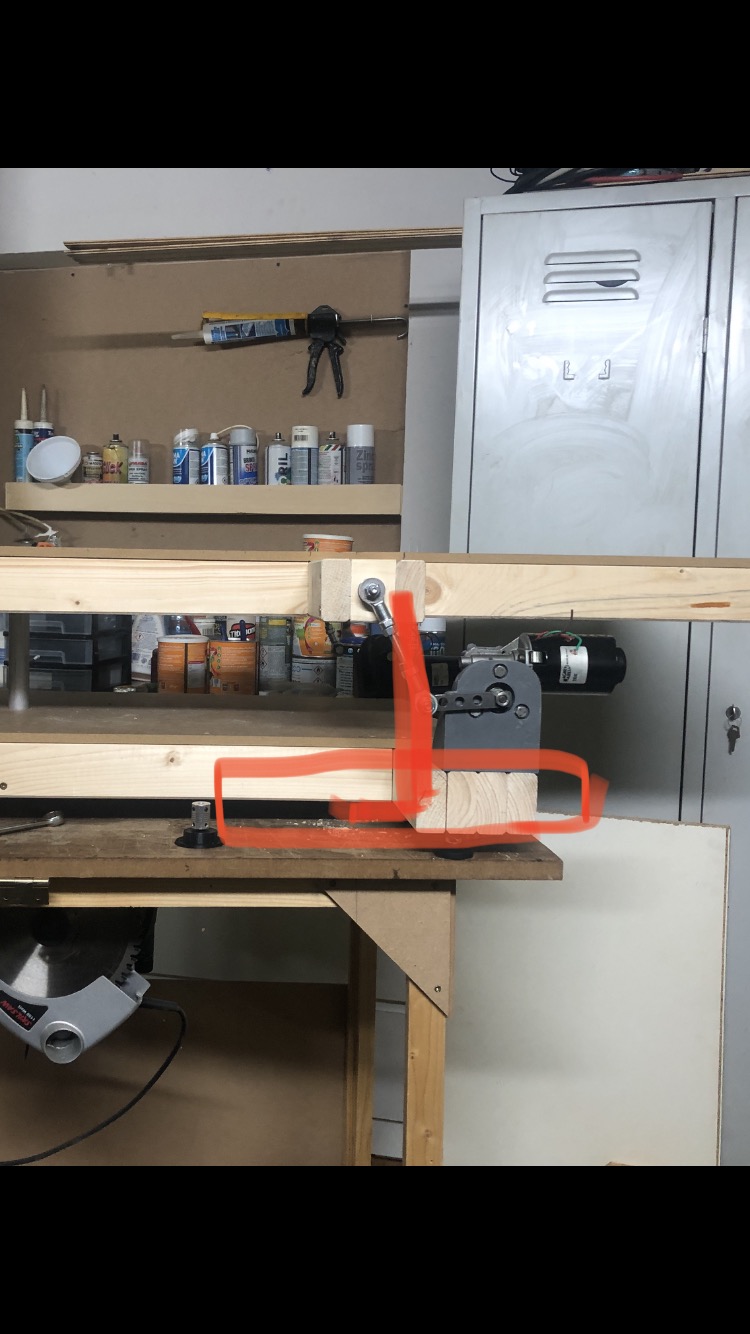

    thanks for the information, in the meantime I had an idea on how to move the motors without them being in the way, I build an iron bracket that will be screwed into the wood and will support the motor horizontally

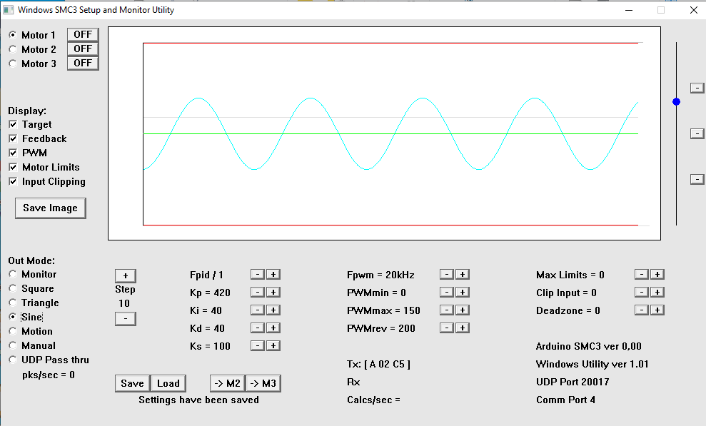

    I don't understand how to reduce movement more with scm3, I set max limits to 255 and clip imput to 255! is it already at a minimum like this?
    21,665
    151,644Coins
    +11,044 / 56 / -2
    Reduce both max and clip values.

    but whether I increase or decrease them, the movement it makes is the same, only the margin changes..
    21,665
    151,644Coins
    +11,044 / 56 / -2

    I also read now but from what I understand it serves as a limit area, I would like the engine to make a smaller movement but any value I put does not change it. the blue line always moves by the same amount. sorry but I don't understand, be patient.
    21,665
    151,644Coins
    +11,044 / 56 / -2
    It is the “Green” feedback line moving toward the “Blue” target position that is important.

    yes I understood that, in the photos I hadn't connected arduino but it was just to show that the width of the blue line didn't change. if I change the values of the bit imput and the other, the movement that the motor makes is always the same
    21,665
    151,644Coins
    +11,044 / 56 / -2
    Please post pictures of your SMC3 settings running the Sine Out Mode.
