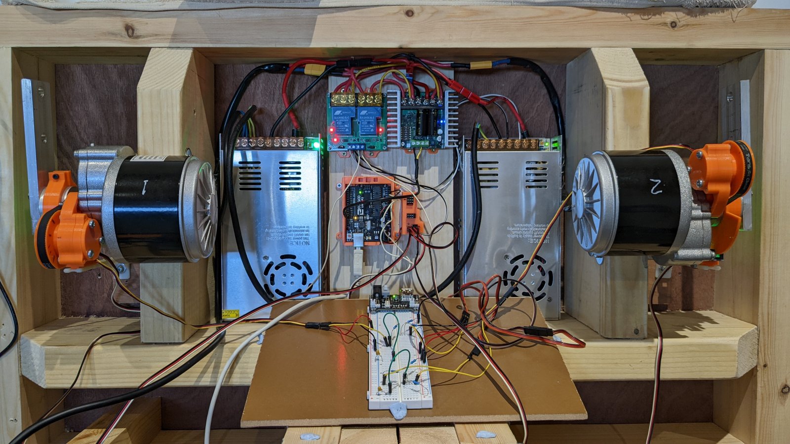

    The motor link doesn't show in my last post. This is the motor.

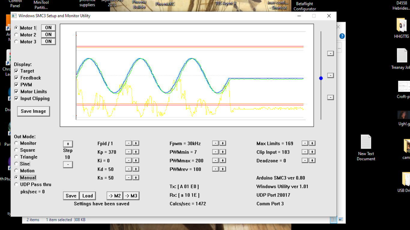

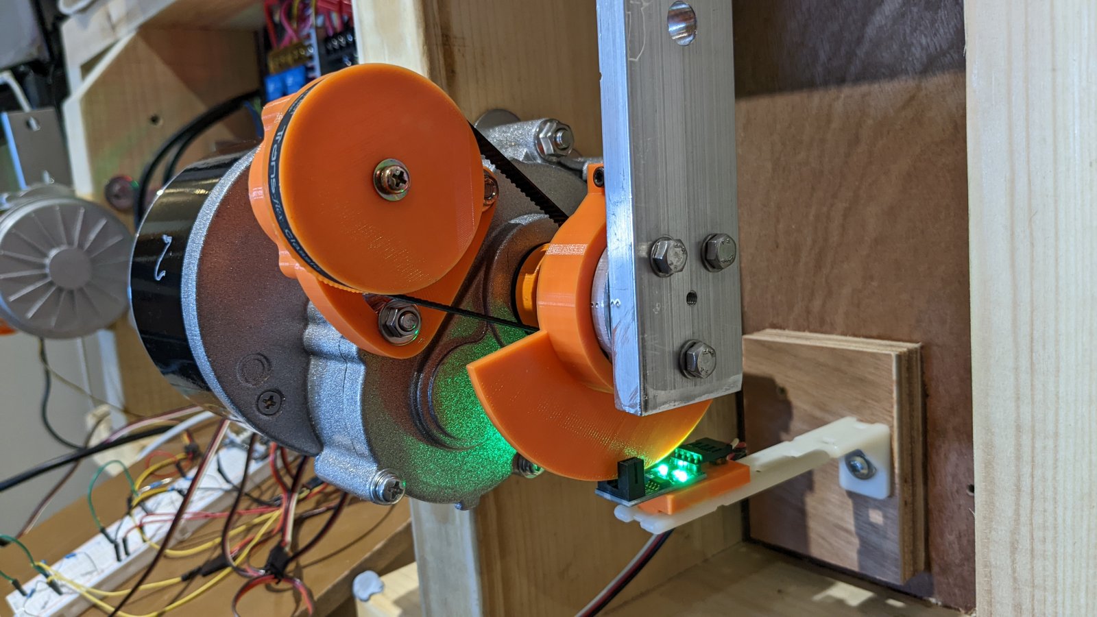

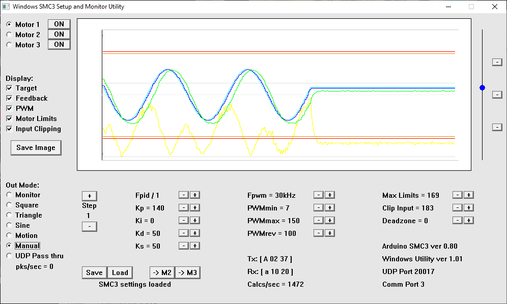

    Yes, the slower and gentler the movement, the more noticeable the steps become. For ages I was convinced it was some sort of digital resolution thing, and perhaps it still is, but the motors are now my prime suspect. Maybe it's the toothed belt drive I have to the position sensors but I don't think so.

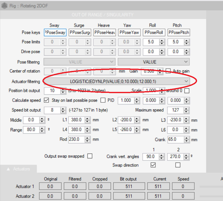

    I've attached my FlyPT and SMC3 settings to this and if anyone wants to take a look and see if I've got something wrong then I'd be very grateful. The only slight oddity I've noticed is that any I gain at all, even just a value of 2 or 3 in SMC3 seems to cause the motors to randomly kick and twitch every few seconds so I just leave it at zero, hence the small error visible in the trace due to my weight pushing down on the motors. I have read of this behaviour elsewhere on here.

    May I suggest refining your SMC3 settings from scratch, as they are not smooth nor precise. Try increasing Kp and run Sine so we have an idea of how your hardware tracks.

    If I increase the P gain then, as you'd expect, the feedback and setpoint curves match more closely, but the motion starts to become uneven. The motor seems to pulsate at about 2Hz. It does this regardless of load. The pulsing shows quite well on the PWM curve. I don't know what's causing this. It's not like the sort of oscillation I'd expect if the P gain was too high and it's persisted through two types of motor driver and two types of position sensor.

    May I suggest starting from scratch and follow the SMC3 instructions, please note at what value the response starts, run Sine and please post a picture of that.

    I have exact the same motors, but run with much higher KP (420) and I run with the IBT's.
    What I can confirm is that even with slow movements, there is no stepping, so the issue is definitely not your motors. What voltage are you using, as I am using these engines on 19v. Maybe this is somewhat low on your side? My first build was with 12v motors and IBT's, where the IBT's got really hot, now with bigger motors and 19v... the IBT;s never get warmer than 40c where the motors are max 25C

    Thanks for chiming in @Radje748 I'm away from home for the next couple of months so my project is on hold for now, but I'm feeding my motors with around 23.8 volts and I have used IBT2s before I got the Sabertooth. I guess perhaps if you can find decent ones (or just get lucky) then these drivers are great, but the ones I had hardly had time to get hot before they died, or just never worked from new, and the stepping issue was still present. There's also the fact that I tried driving my motors from a simple RC source thus bypassing all the Arduino/software/feedback stuff and they still stepped. Perhaps, in a world full of fake/cloned Arduinos and IBTs the same might apply to motors too. My setup is basically a copy of the one shown by SCK Gaming on Youtube and I notice his motors have a logo (UniteMotor) cast into the gearbox whereas mine are just plain. I can perhaps see some other small differences in the casting so who knows.... They were very cheap.

    23.8V is somewhat High for these IBT's, when I tested them on 22-24v, they were getting very warm quickly.
    Now I am running 19v, and the temp is always between 25-45C(depending on the outside temp). I also placed a fan above the IBT to cool them extra....

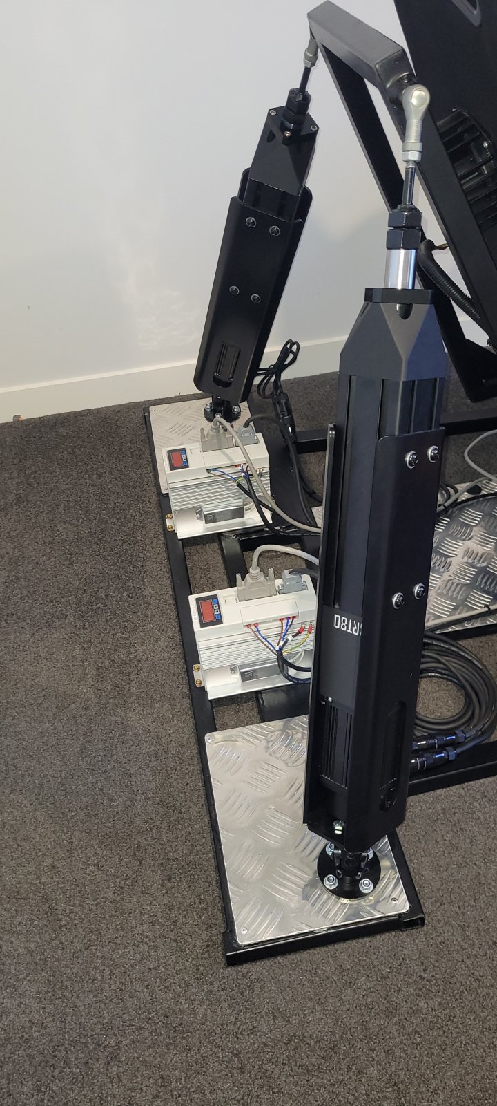

    Hi guys Just my 2 cents,I built my 2 dof 3 years ago using the 12v worm drive motors that many on here use.
    I was never happy with the stepping and also the play in the rig from the gear meshing.
    It was great for racing but not so good for flight Sims which is my go too.
    Anyway In the end I got fed up with it,I sold the motors and power supplies and and purchased 2 srt80 linear actuators and servo drives with a Thanos controller.
    I modified the rig a little to put a little rear weight bias to it.
    The result if amazing ,like really.
    Super smooth,heaps of movement if needed.
    It was a bit of work but it's everything I wanted.

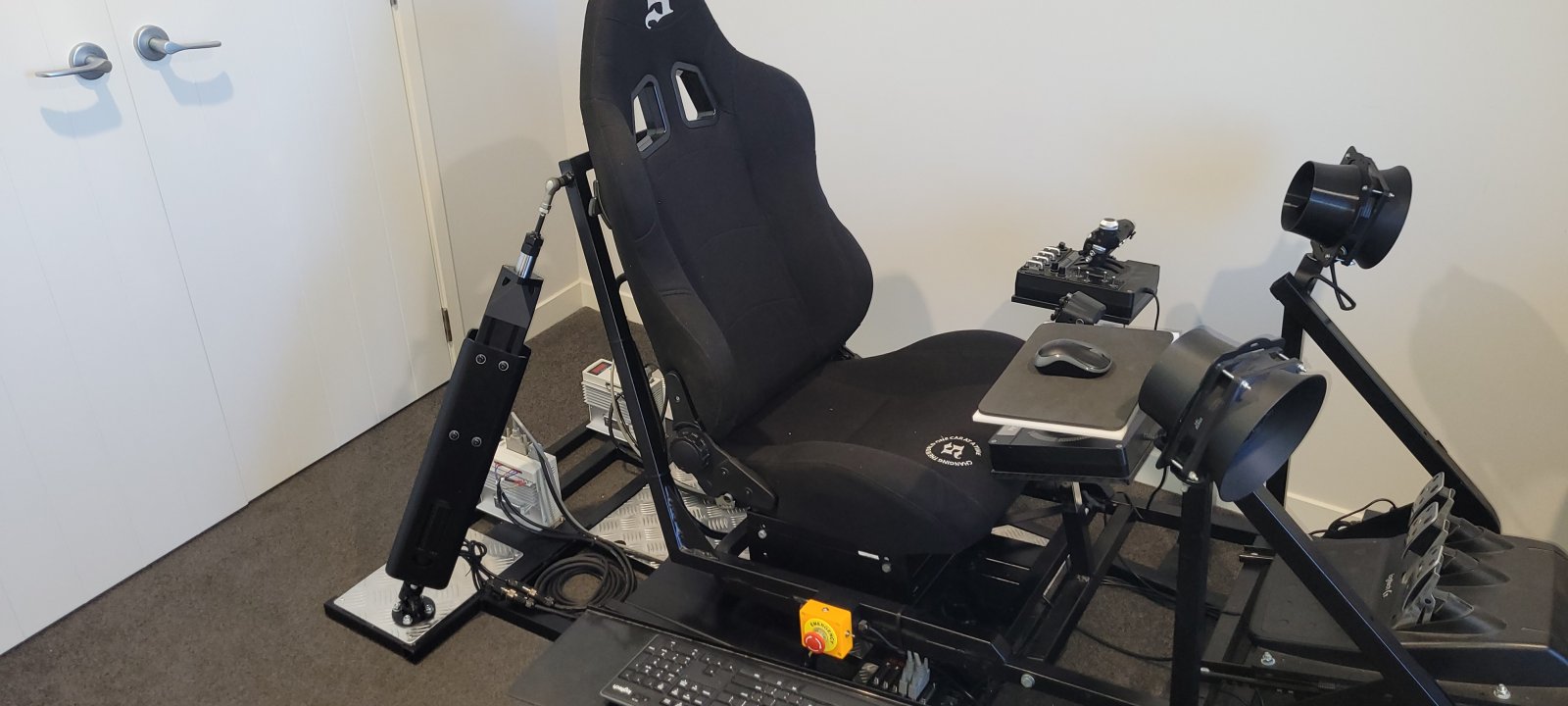

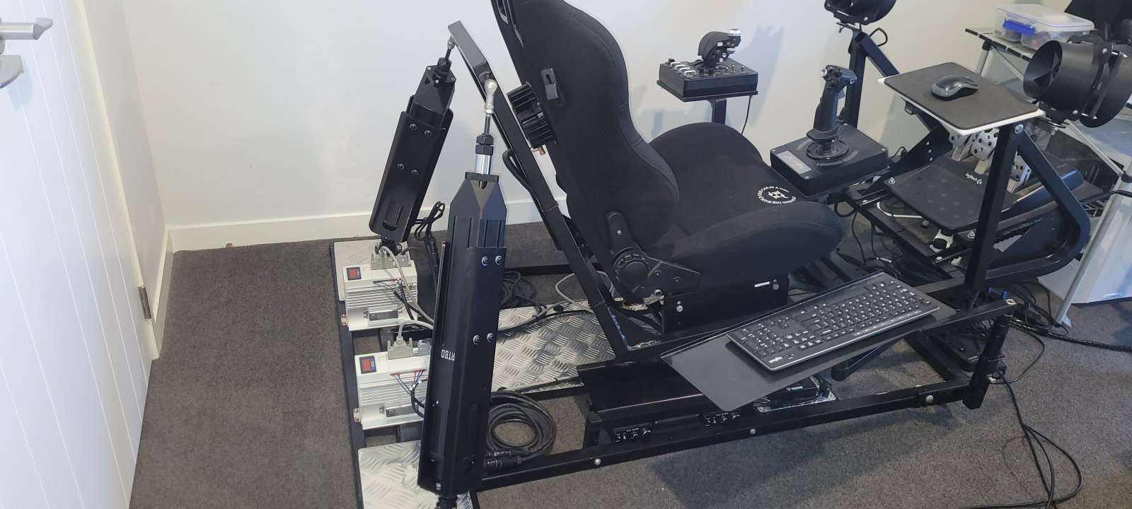

  18. Richardamo1
    Richardamo1 Member
    Apr 2, 2023
    61
    307Coins
    +12 / 0 / -0

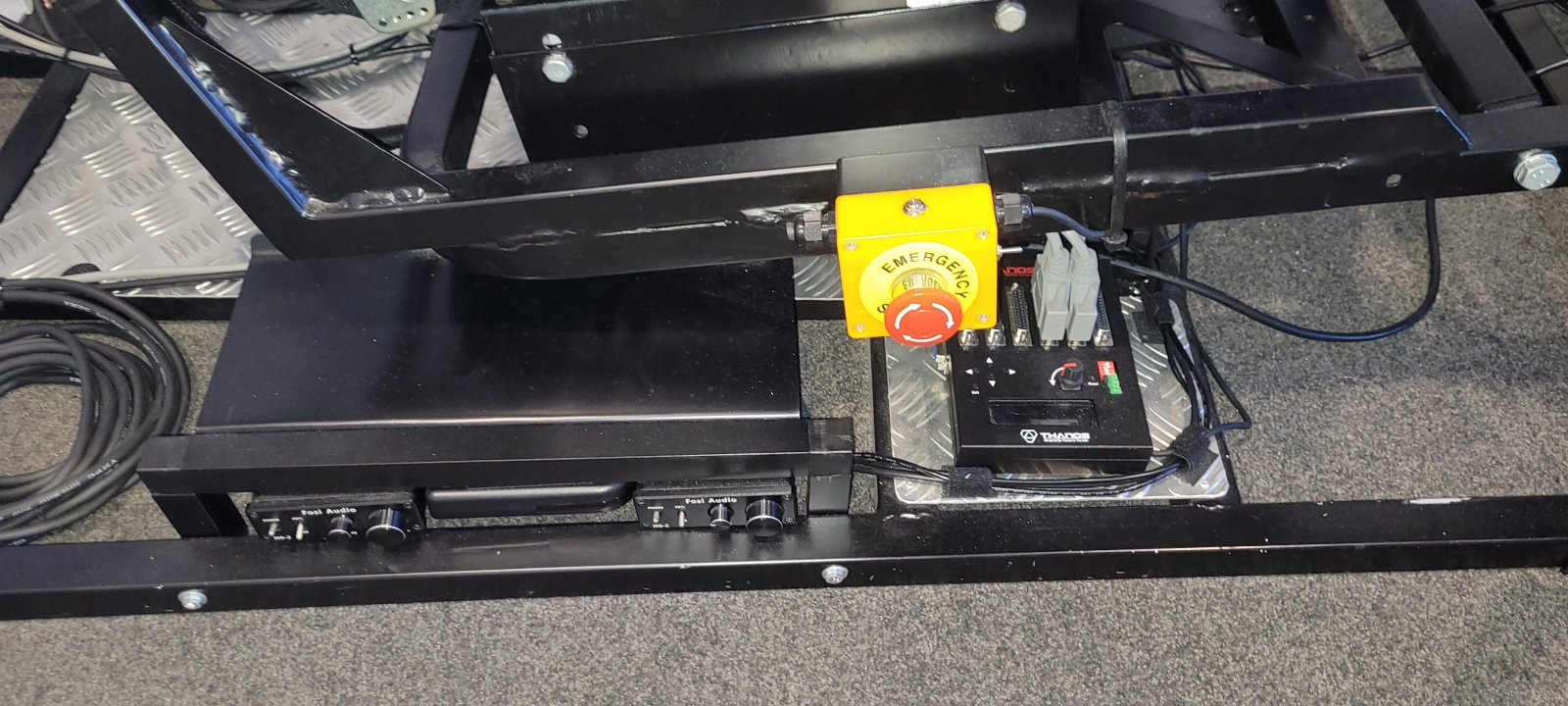

    Yes it is,great kit ,but was a fair bit of work to move the rig rearward and extend the base but hey the results are amazing,and for racing I just pull out the joystick and insert the wheel and gear change, only takes 30 seconds.
    Here's some pics if your interested
    All the best. 17401701884076752260271363314373.jpg 17401702365155800586971245935203.jpg 1740170263539934628160048379885.jpg 17401702817618563495533624735668.jpg 17401701884076752260271363314373.jpg 17401702365155800586971245935203.jpg 17401702365155800586971245935203.jpg 17401702817618563495533624735668.jpg
