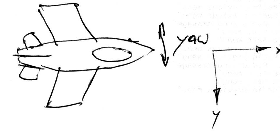

    All I want to say is: you don't need a third axis, namely the vertical axis, also called the yaw axis. This makes the design much easier.
    Why not build a platform like that on the video? It suits your needs, doesn't it?

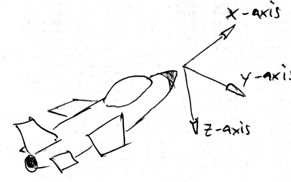

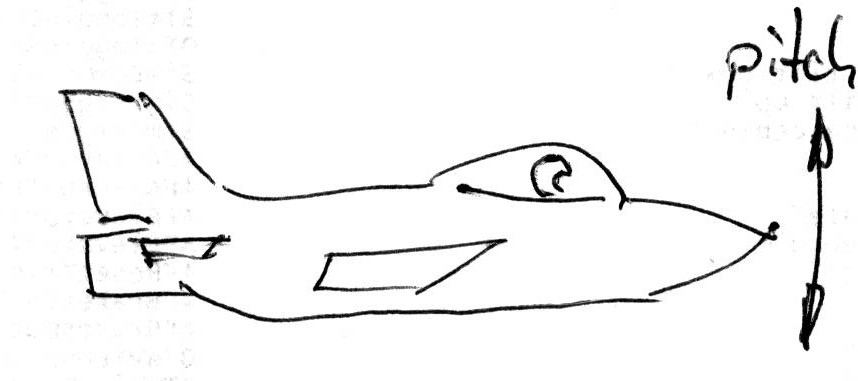

  4. ailer
    ailer New Member
    Nov 4, 2010
    10
    0Coins

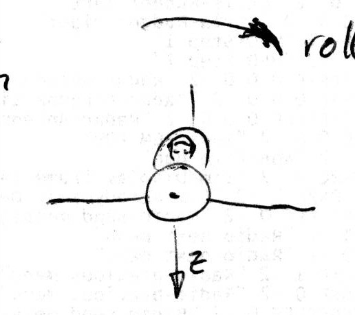

    Here are some sketches that will help us speak about the same things:

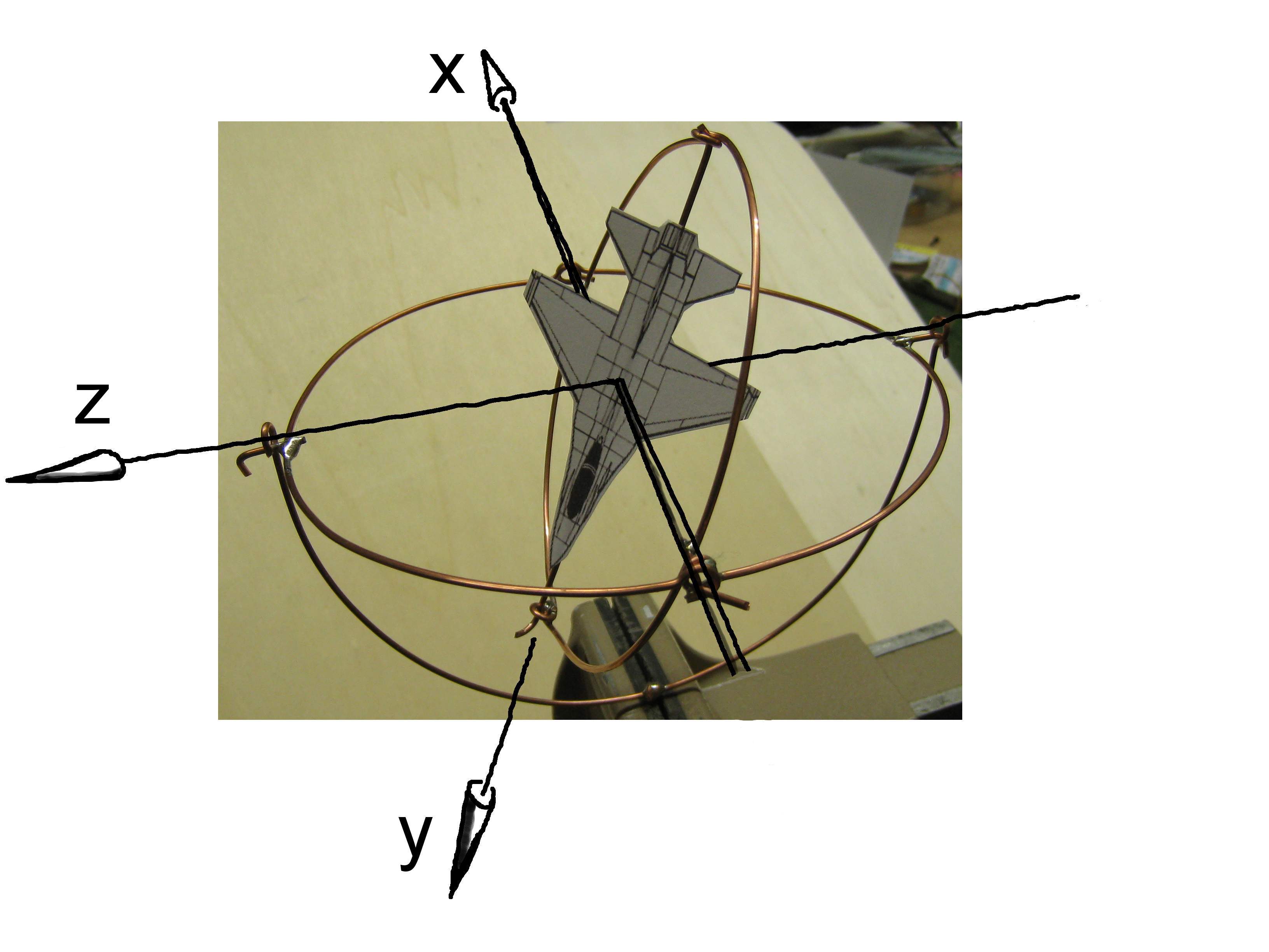

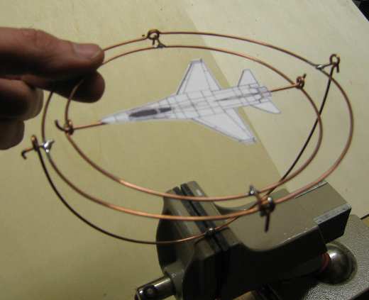

    You spoke about the gimbal lock problem, indeed a serious problem with gimbal constructions. That's one more reason why I prefer the 2DOF system instead of a 3DOF one. Yes, you got another problem then, you can't simulate flying the curve at all, which you could with a 3DOF system. But, what I said earlier in this thread, the sensation of turning in a curve isn't that much, since the rate of turn is at a maximum of 20°/s. And that is when you pull 9g's! Because the 9g (or even a 3g) experience delivers _much_ more - I repeat MUCH more - sensation then the turn rate of 20°/s you should have a look at simulating the g-forces first. Now that you can't simulate more than 1g (at least with the constructions we speak about) should we rack our brain over the missing turn capability (z axis)? I think: no. Important is the possibility to pitch to give you a feeling of flying over the top. That indeed puts the icing to the cake :) And even more important is the rolling capability, since roll rate is and exceeds 360°/s - just try to simulate that on your platform - that will give you a real kick... And forget about the z-axis of your platform. My suggestion.
    By the way, imho the following link will explain the gimbal lock even better:
    http://www.youtube.com/watch?v=zc8b2Jo7mno

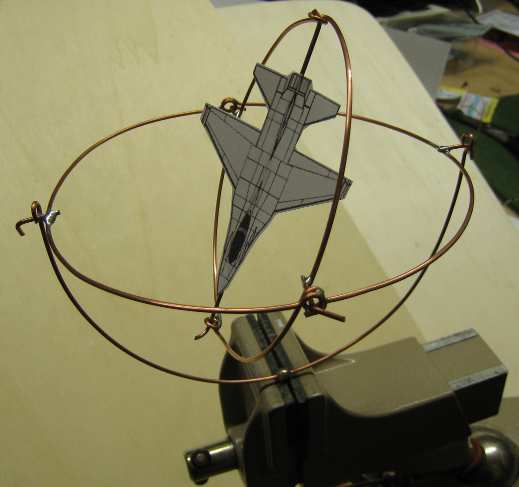

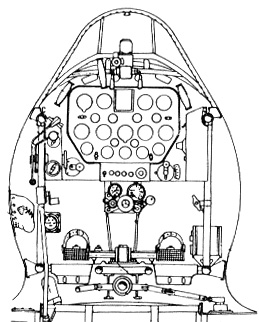

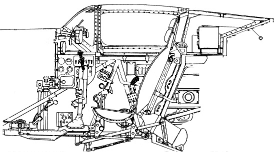

    I don't like models that don't show the axes but only turning wheels. So, to get a better understanding, I've quickly built a sim platform - with copper wire. Have a look at it, in my model you can recognize the axes. And: the wheels you see in my model don't compare to the wheels in the videos. The latter use the wheels to show a given axis rolling within. My wheels are mounting frames instead.
  8. ailer
    ailer New Member
    Nov 4, 2010
    10
    0Coins
    In this picture I added the axes' names. Note, that the axes shown are not the same as the plane's axes. The plane has it's own co-ordinate system, as well as the platform. When dealing with robots the systems have to be transformed (finding the equations is somewhat tricky). But that's stuff for a later issue.
    I decided the inner frame to be the roll frame (y axis). The reason is as simple as important: the inner frame has to perform the highest angle rate and so must be very agile. That means, it will be highly accelerated and therefore has to be very light. If we make, say, the x-axis the inner frame (coupled immediately to the cockpit) the roll frame has to roll the cockpit _plus_ all the material of the x-frame (could be 50 to 100 kg more!).
