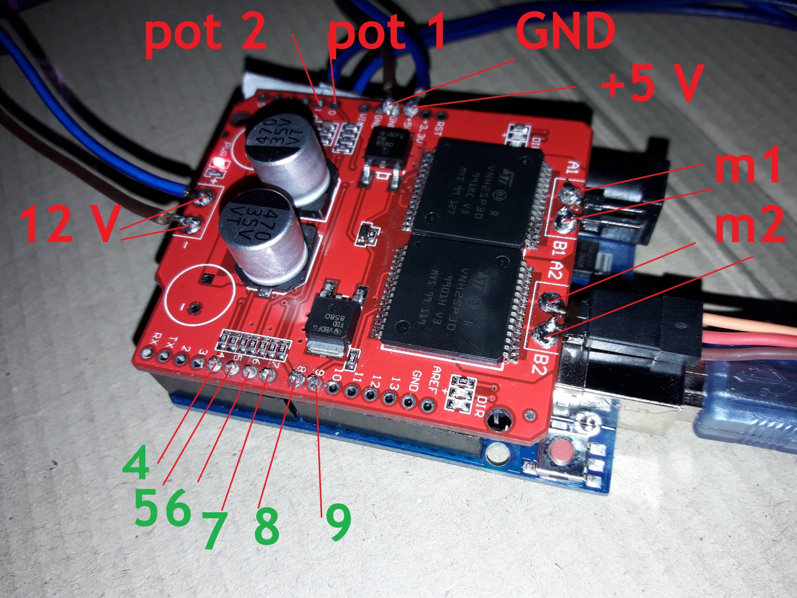

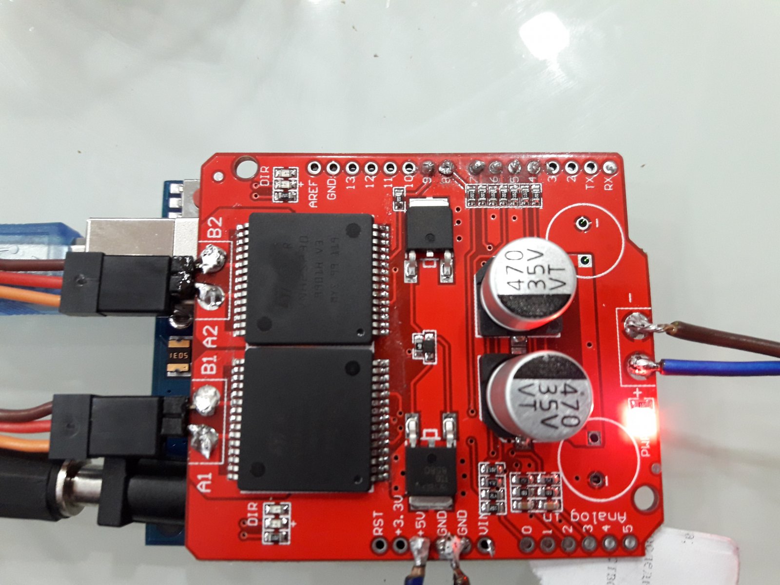

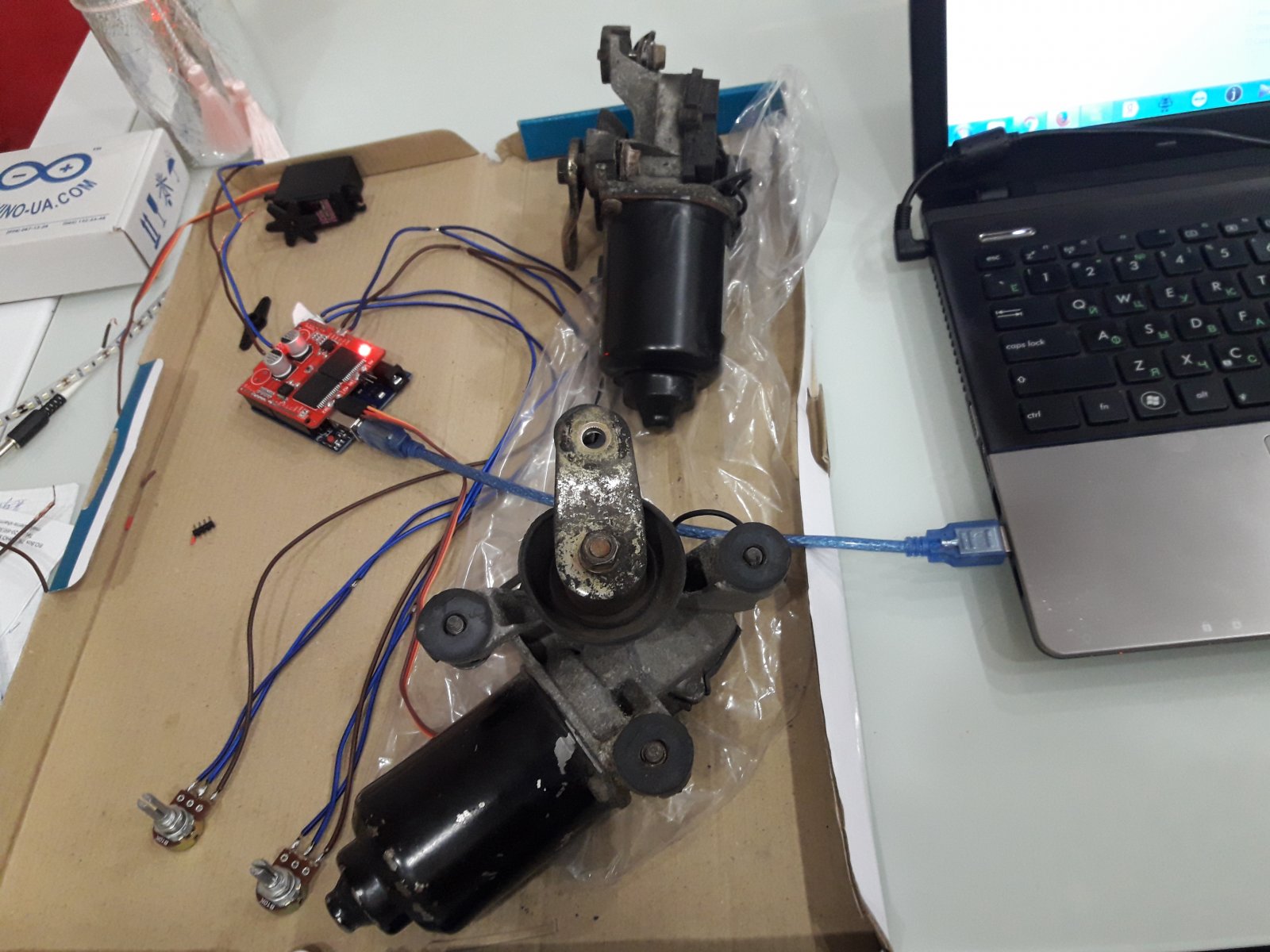

    Hello. I built my first 2of simulatord. 3 weeks ushle. There were many problems. but helped me on the forum. When examined, it turned out to be very simple))
    First you take the Arduino Uno - 1 piece, Monster Moto - 2 pcs, Resistors 10K (0,25-1 W) - 2 pcs, 12v engine - 2 pcs.

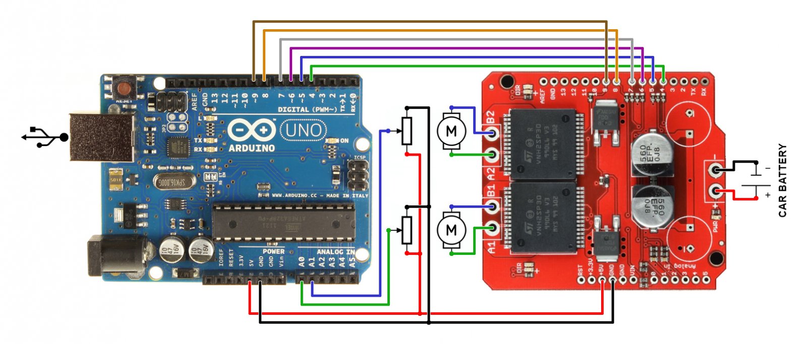

    This is the right plan! Collect the items exactly as indicated in the diagram.

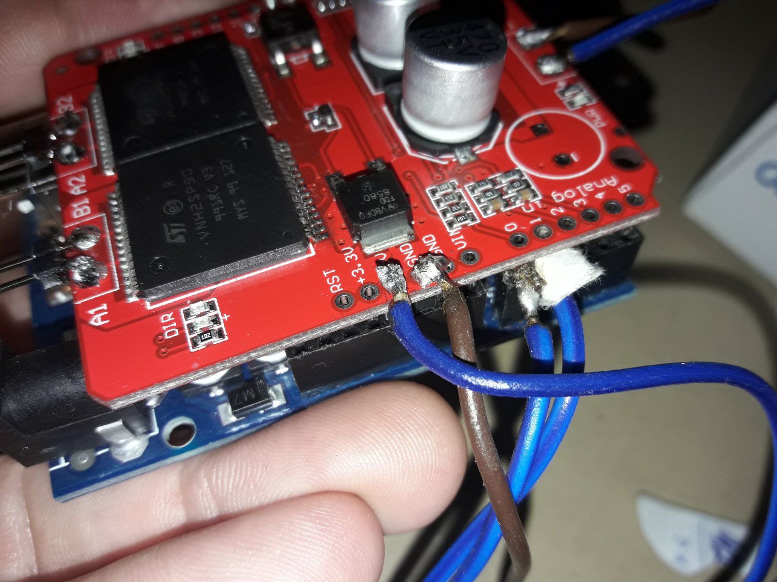

    I got this:
    at each other I soldered:

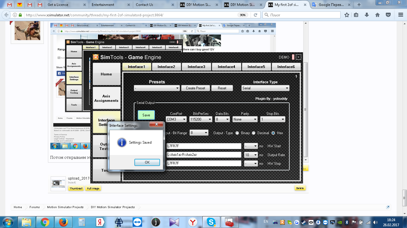

    Next you need to install and configure Sim Toolse - this Russian version of the instructions.

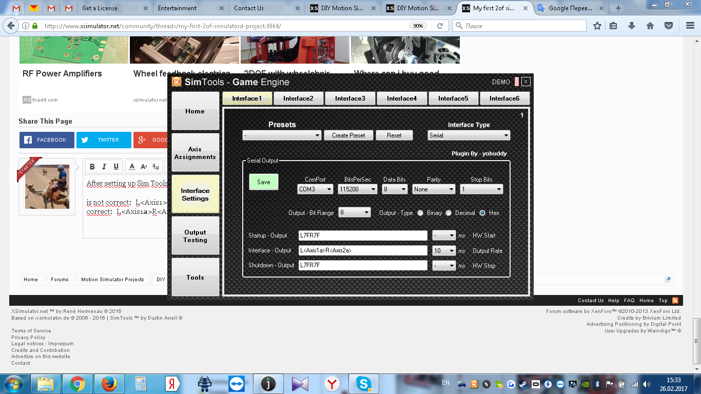

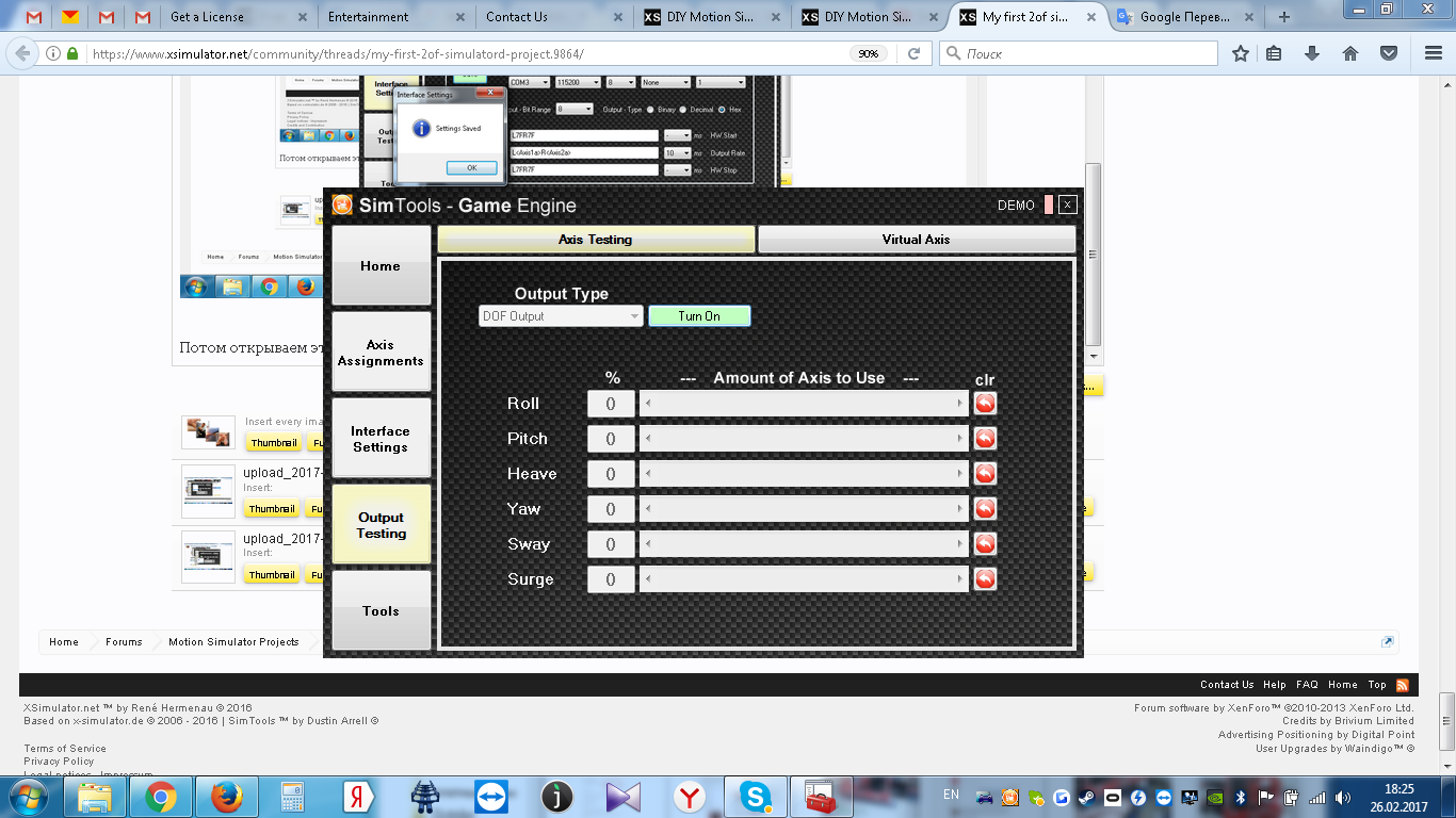

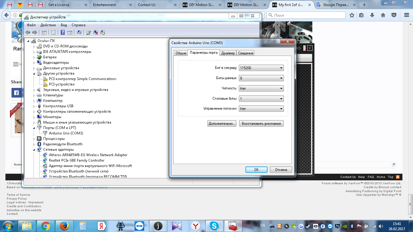

    After setting up Sim Tools I had an error:
    is not correct: L<Axis1>R<Axis2>
    correct: L<Axis1a>R<Axis2a> 10 ms (at 20 ms - does not work)
    be sure to set up as in the picture:

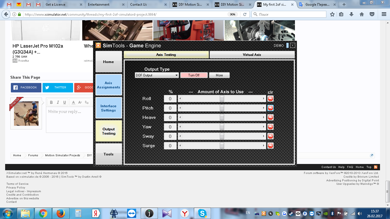

    Turning on the power circuit to the motor, then we click - Output Testing - Turn On.
    Motors are to engines.
    Now I take off video!!!

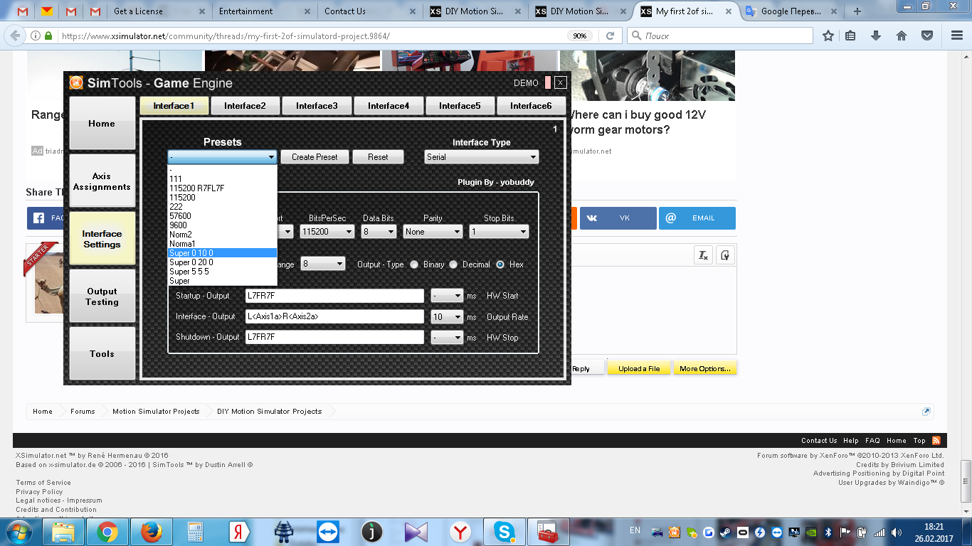

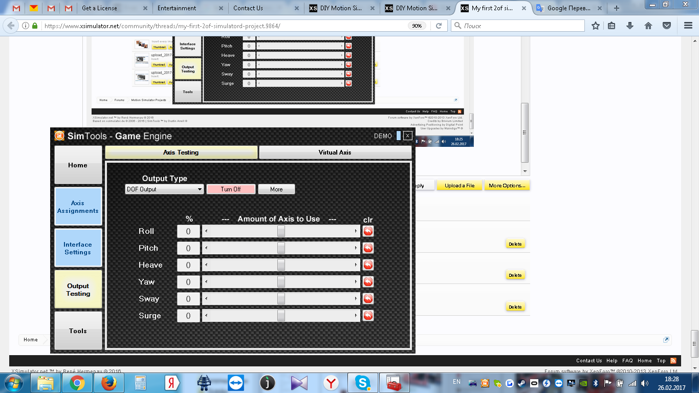

    If you run a test in the Sim Tulls and the engine is not running, then:
    1) you need to close the Game Manager and Game Engine
    2) disconnect the USB (Arduino Uno)
    3) Insert USB (Arduino Uno)
    4) initially run Game Engine, and then the Game Manager
    5) open the tab and enter data, or select from a list of saved,
    and be sure to press after each "Save" button.
    Then open this tab, click on "Turn On" (testing engines):
    If all is well, then you will see the light "yellow LED" on the Arduino Uno board:

    Put some heatsinks on that motomonster

    radiators be sure to put motomonster )

    in addition to the heat sinks must also put a nice fan because you risk frying

    OK, now I buy radiators.

    Don't forget to put great big heatsinks on those motomoster chips. I used the exact same wiper motors. They both got very hot - the motors and the chips.
