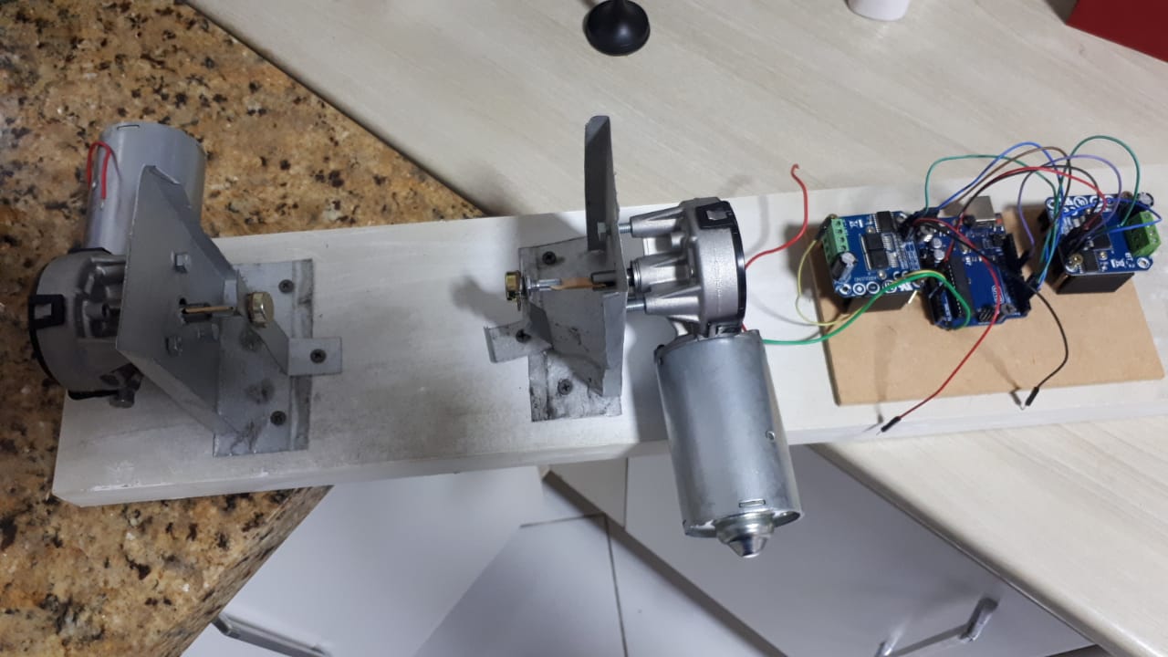

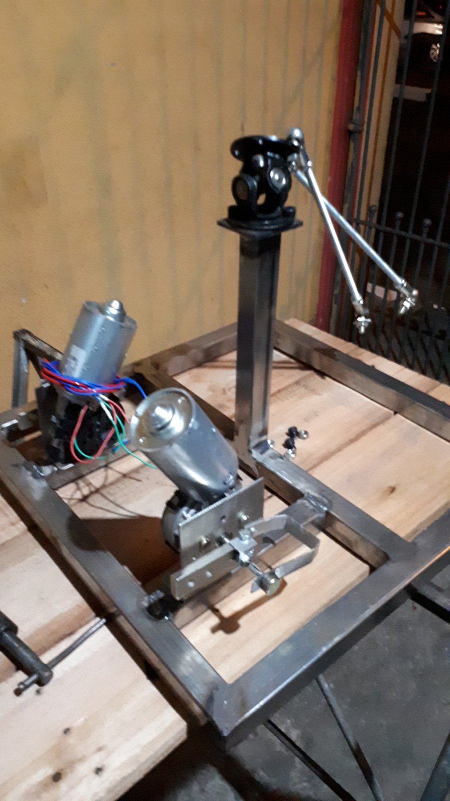

    Building my first 2DOF simulator.

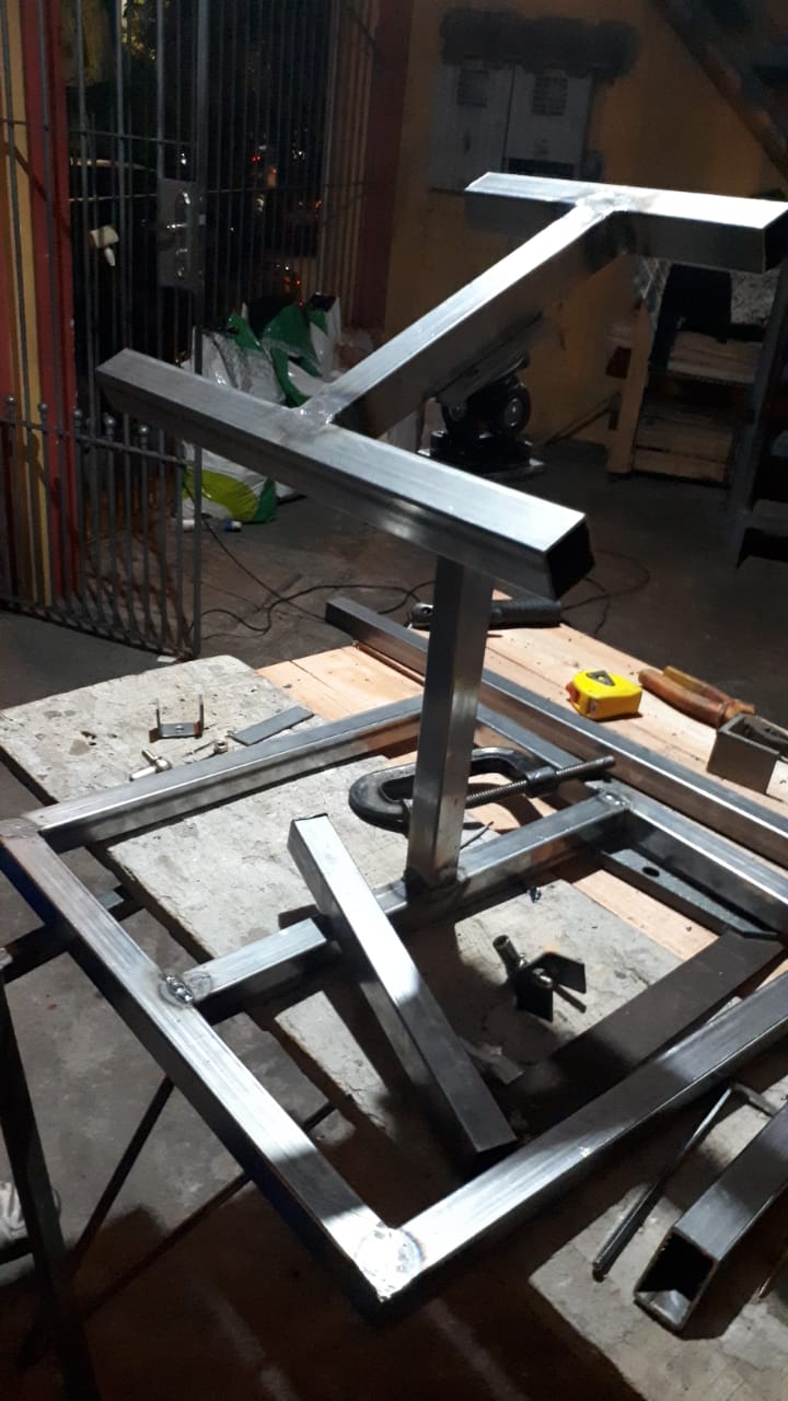

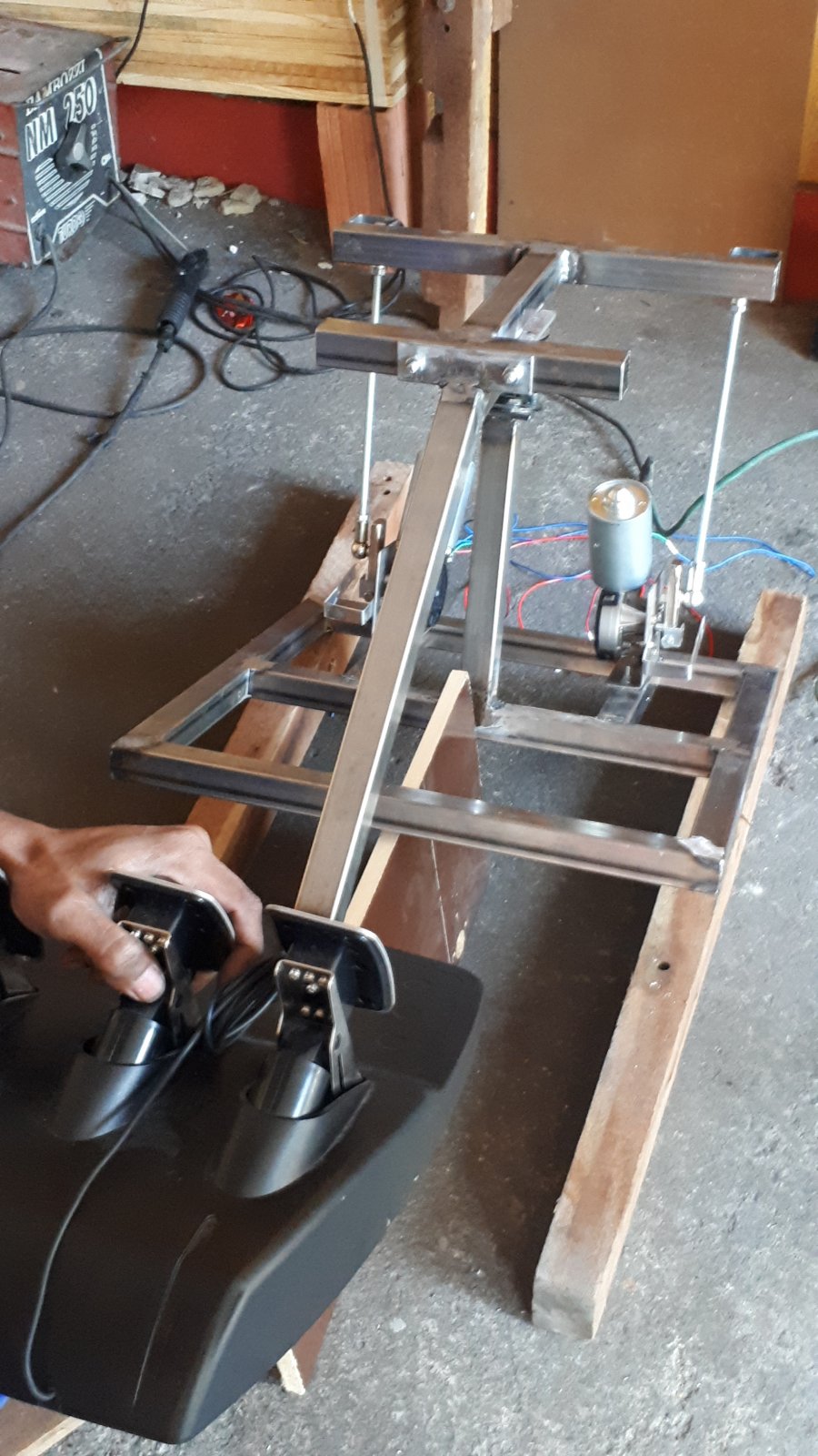

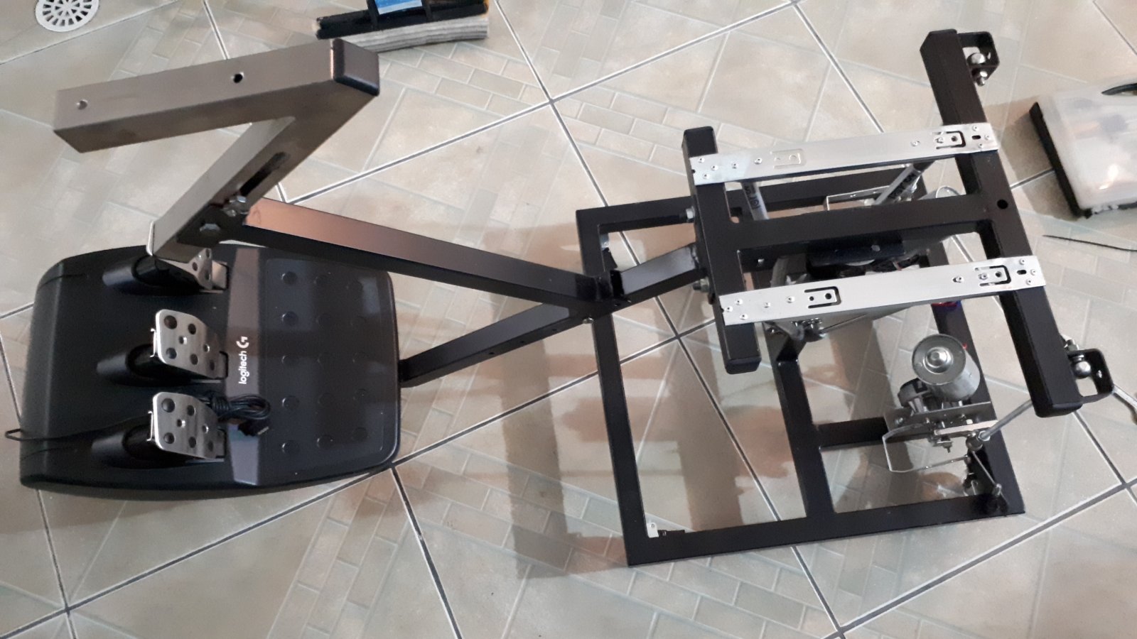

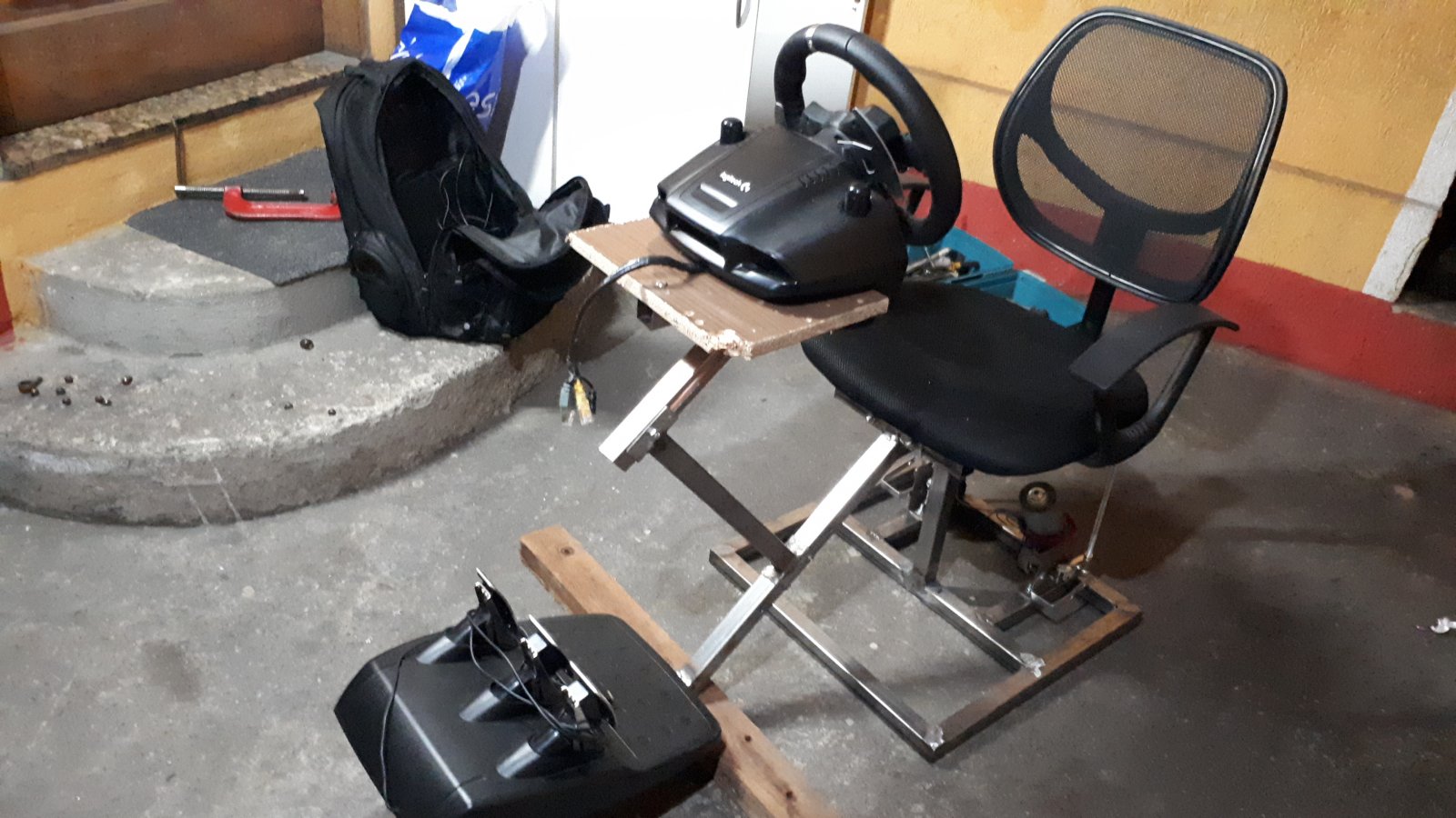

    Status updating:
    Finishing this phase. Next step: paint the structure.

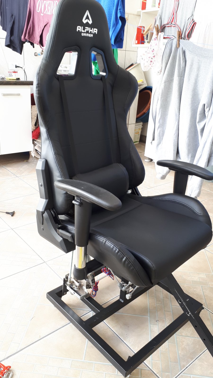

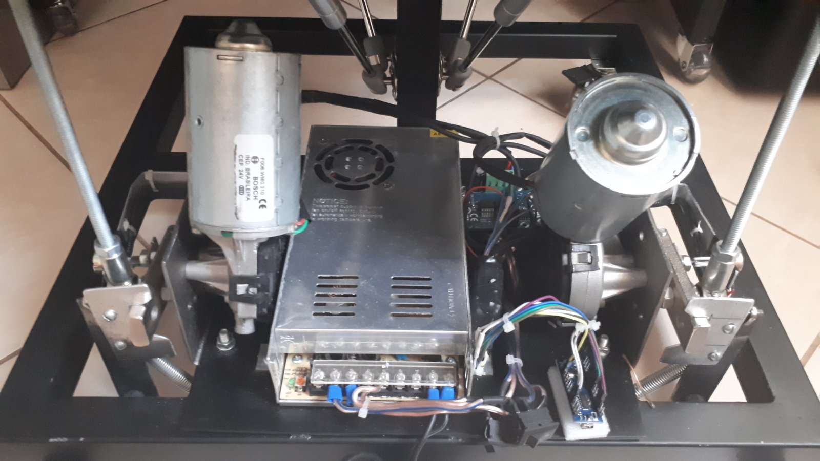

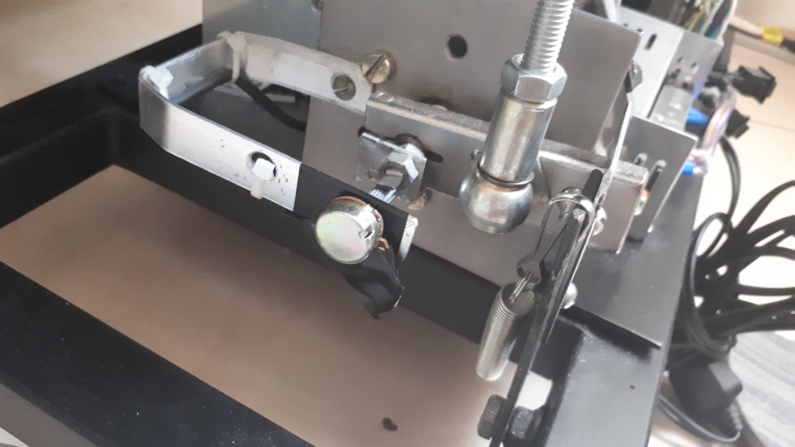

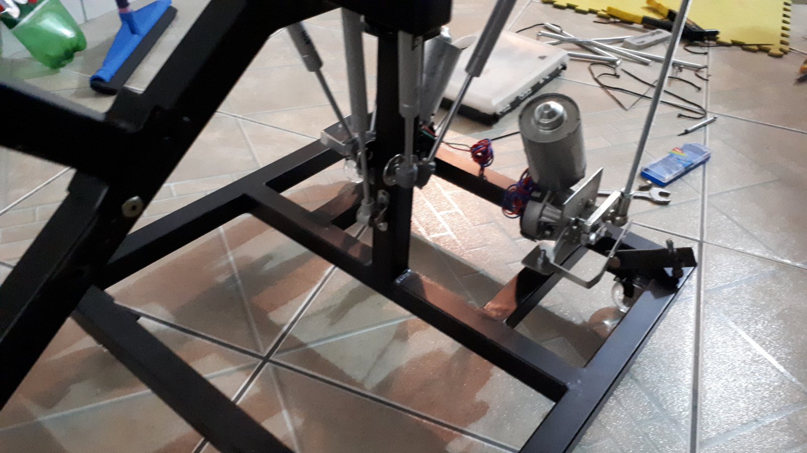

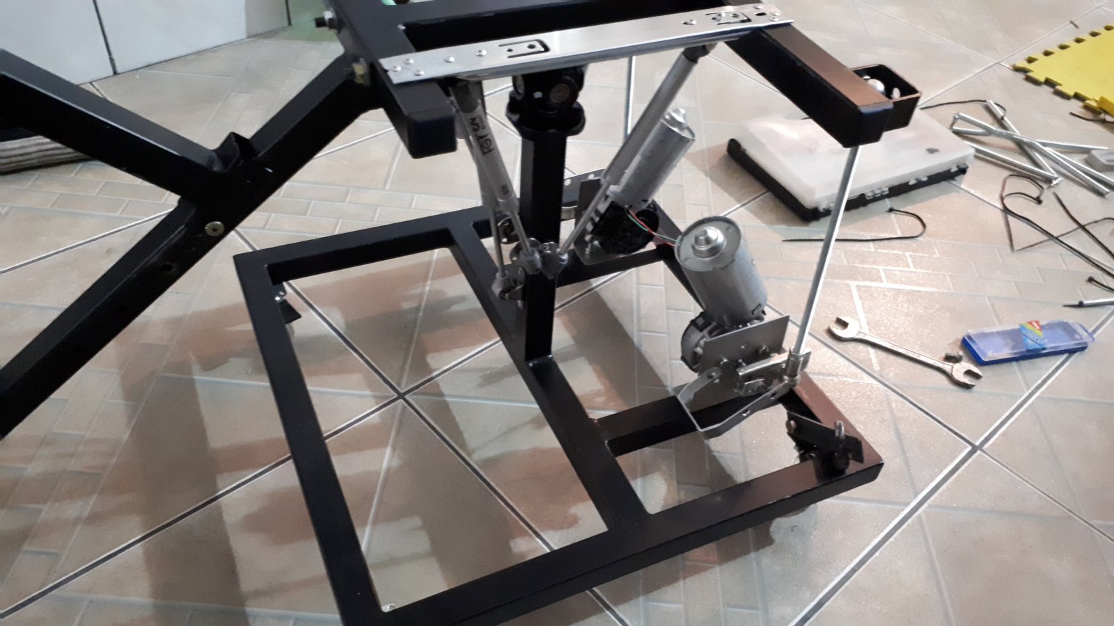

    The structure was concluded and painted. I`m starting to connect the parts to finish the building.

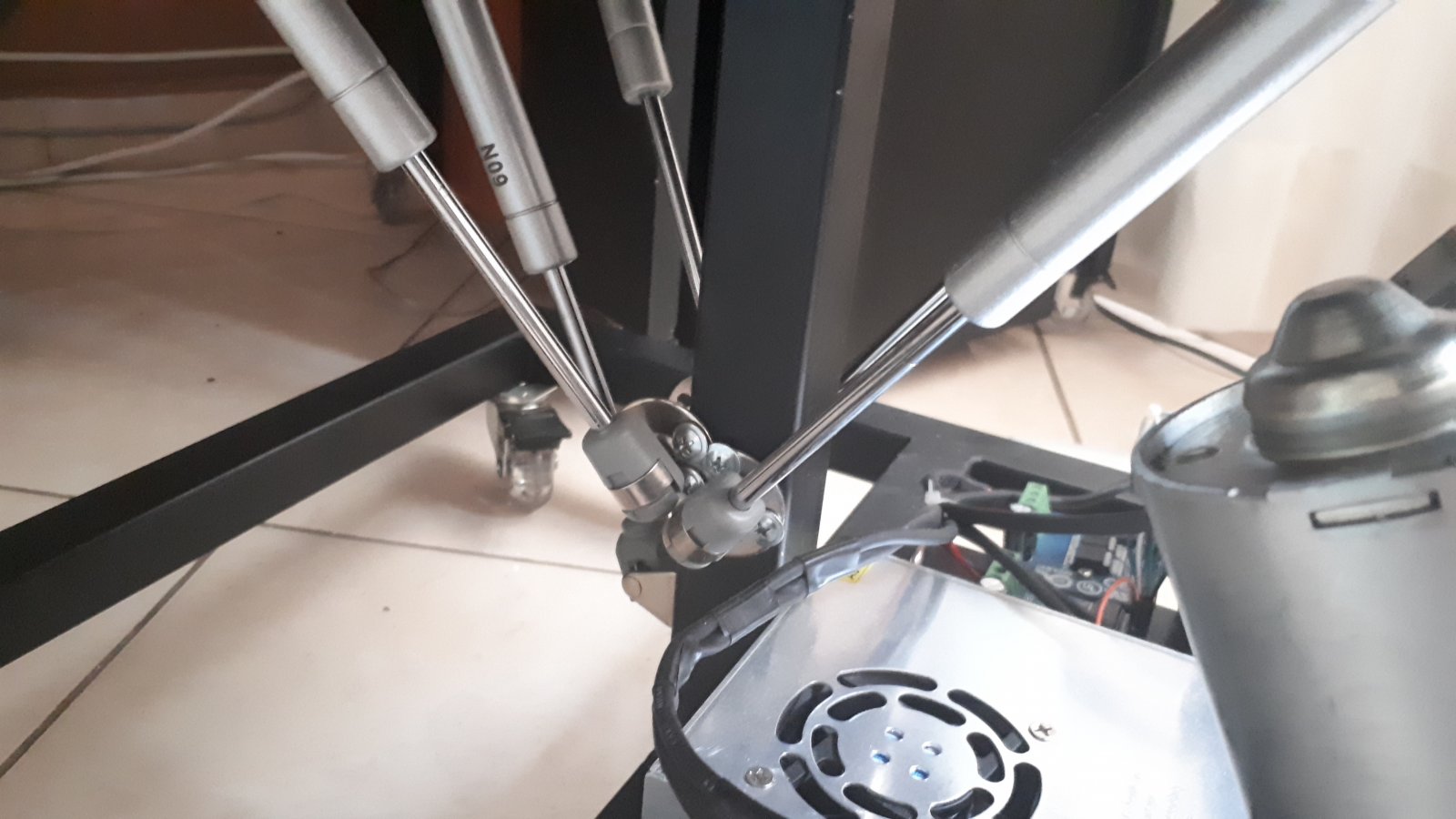

    Now, I have a problem with the chair balance because when the engine is not working and someone is sitting down the chair move an inadequate way. I did some tests with springs but it was not enough to solve the problem. If someone has an idea, I'll really appreciate the help. Thank you.
    21,592
    151,215Coins
    It sounds like you are describing motors being back driven when not powered on, that is common for 25:1 gearbox ratios.
    A mechanical chock is about the easiest solution.
    I have found that even 50:1 ratio gearboxes can be back driven once they are worn in, but 60:1 can't be back driven under normal sim loads.
  8. Erisvaltom
    Erisvaltom New Member
    Jun 1, 2019
    6
    Brazil
    72Coins
    +8 / 0 / -0
    Dear, thank you for the information and support. I'm using engines with 63:1 gearbox. I confess to you that I didn't wait for this problem. As your recommendation, I installed five mechanical chocks (four with 60N and one with 120N of force) and the balance was improved, but I need to do the test with the chair and game to be certain. Thank you again.
