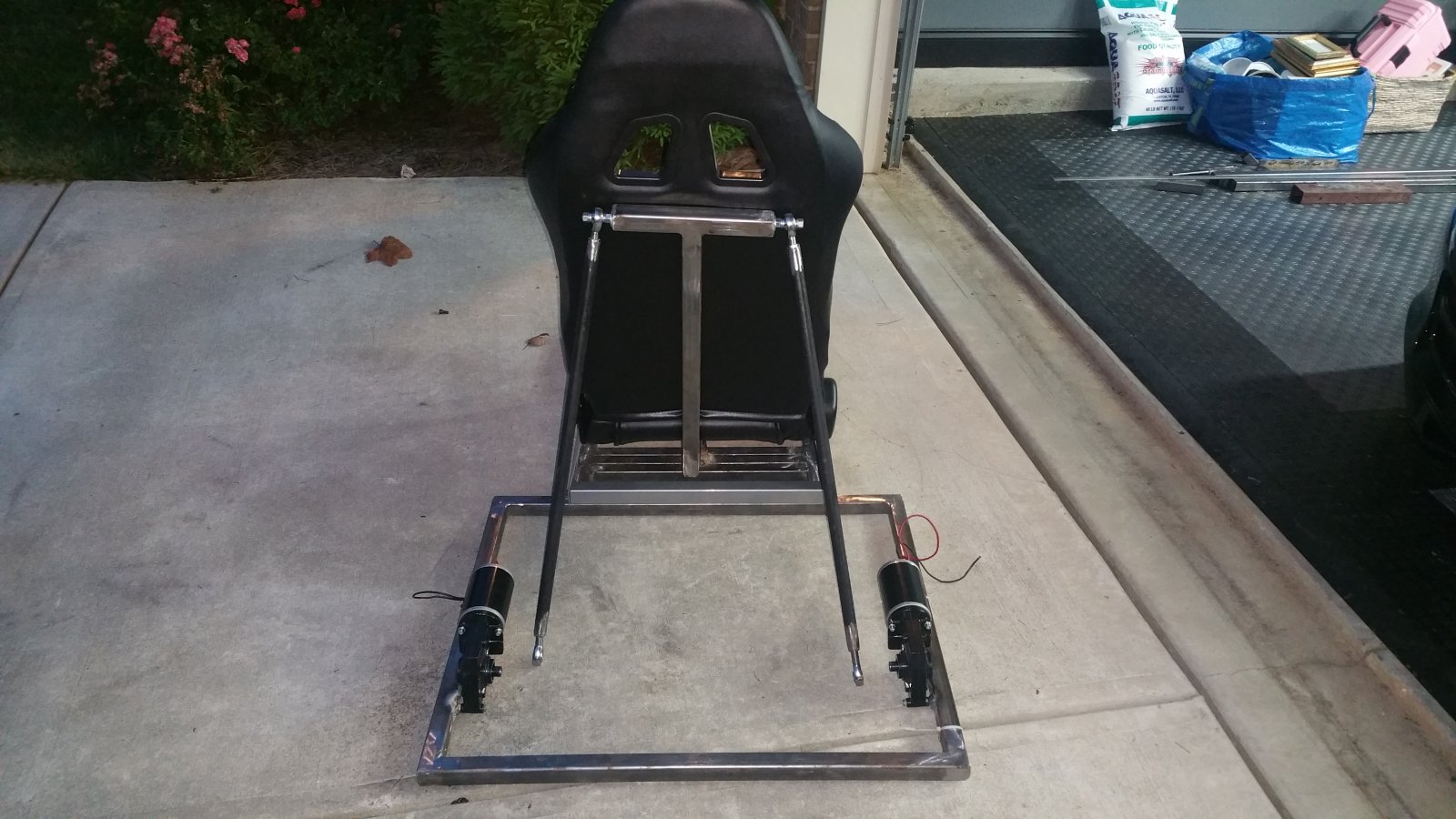

    I've been browsing this forum off and on for the past year and finally decided to take the plunge. I plan on keeping this thread up to date with as much info and as many pictures as I can to hopefully make it a one stop shop for all future first timers.

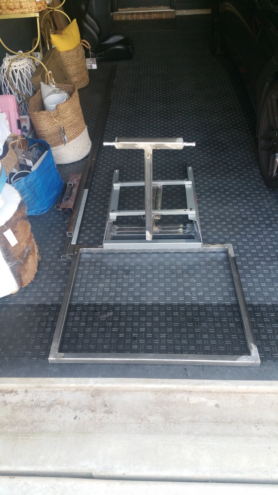

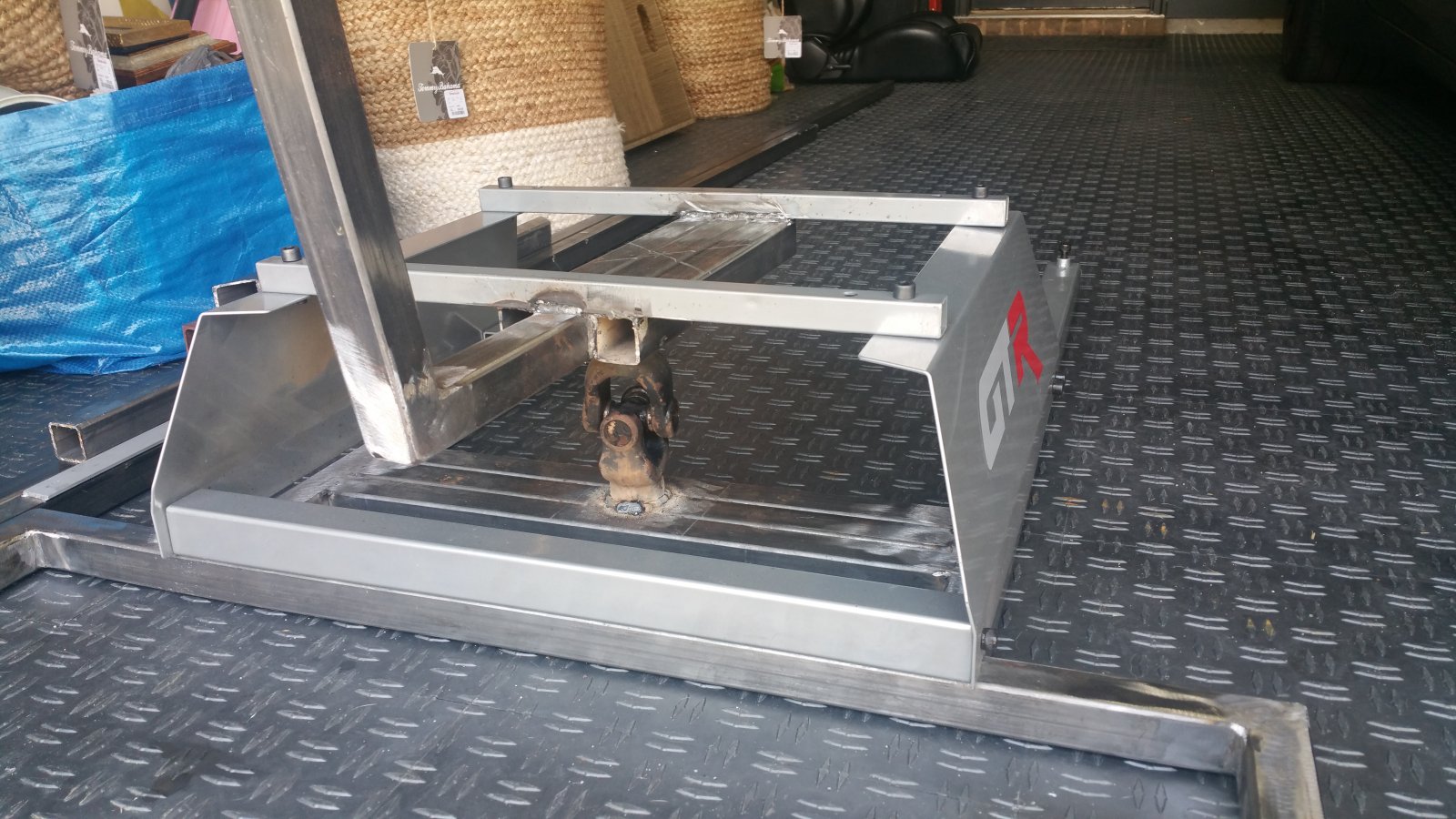

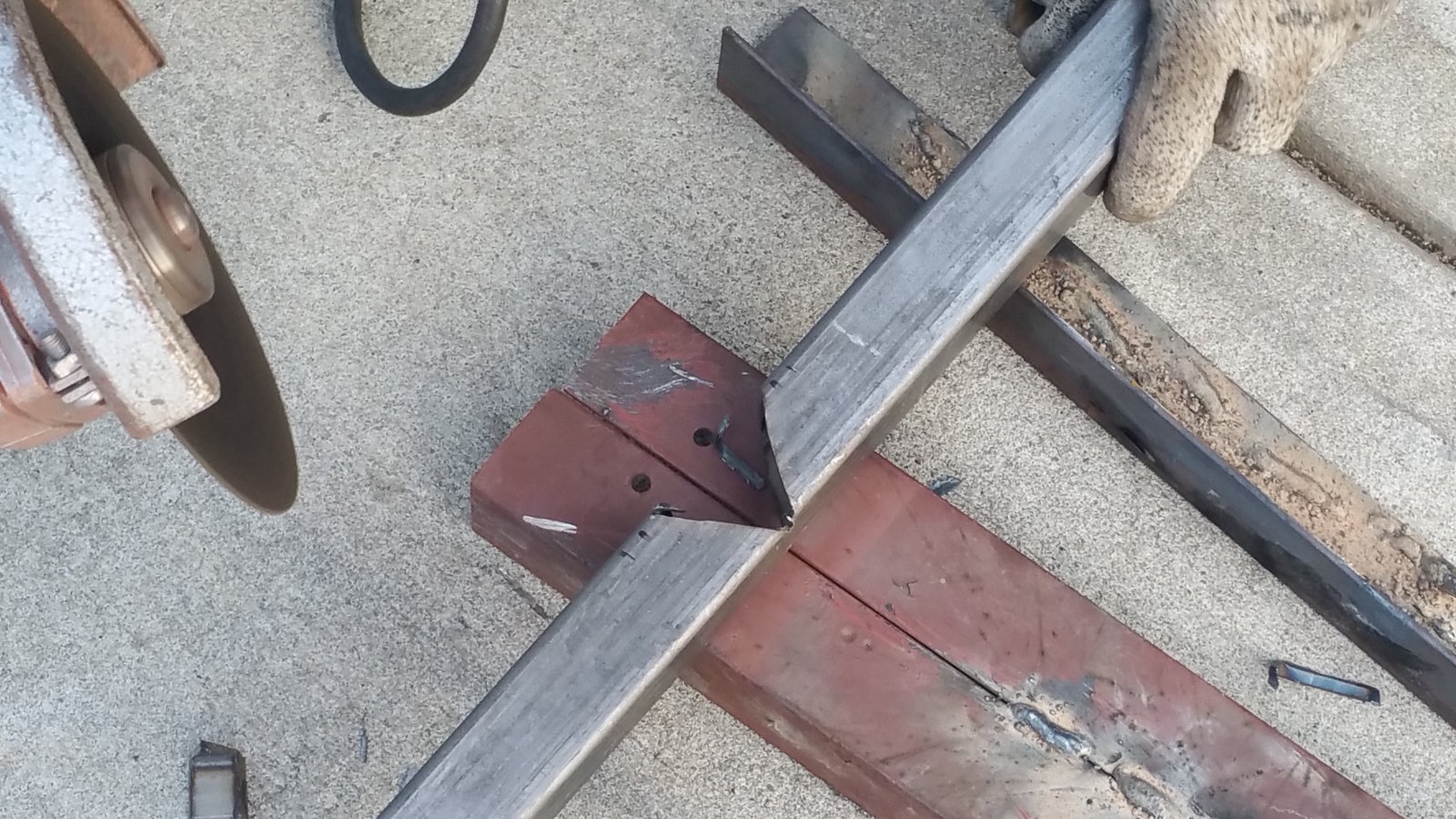

    7/24/16 - Lots of Progress Today

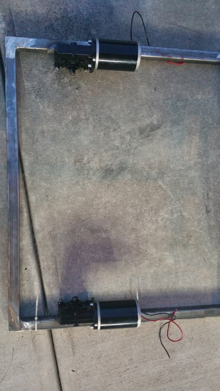

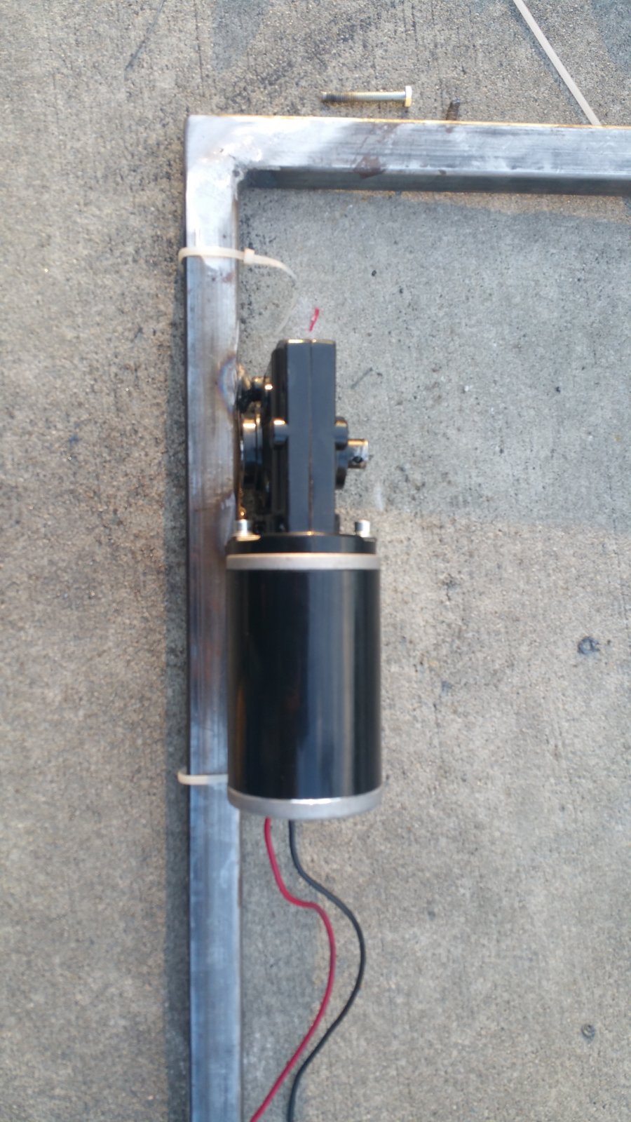

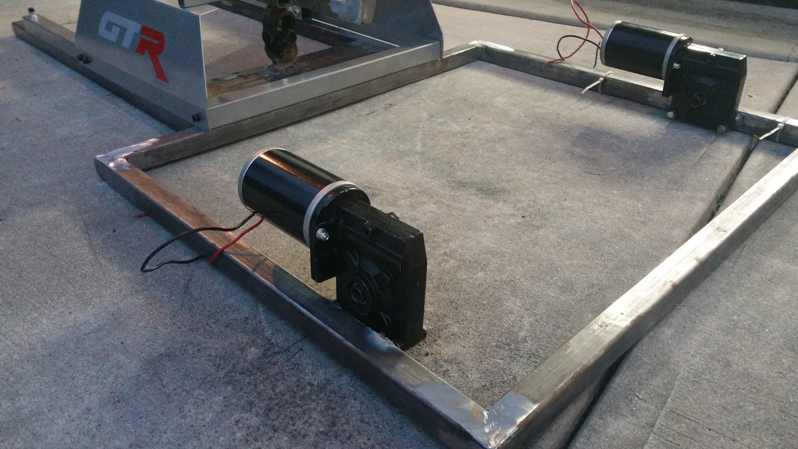

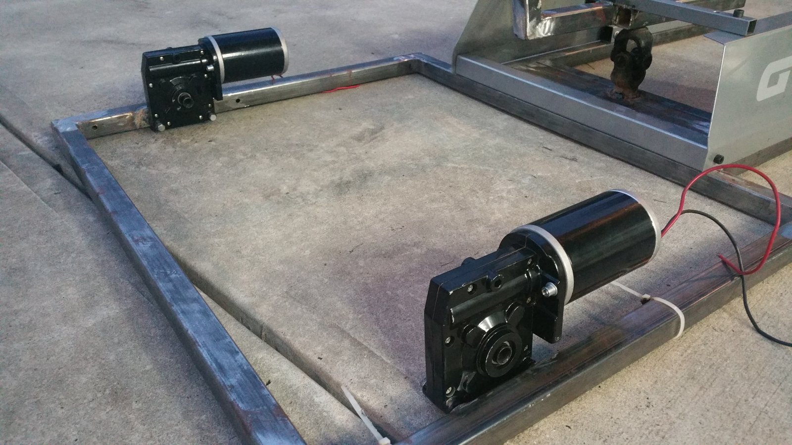

    Is there anyway to remove the shaft from the motor and reverse it? I have the motors from pgsaw on ebay.
    20,571
    145,244Coins
    +10,783 / 52 / -2
    You can easily knock out the rivets, split the gear case and turn the shaft around, then bolt it back together. I am pretty sure others have had no issues with doing that, but I did have problems with a 60:1 gearbox where I reversed the shaft.

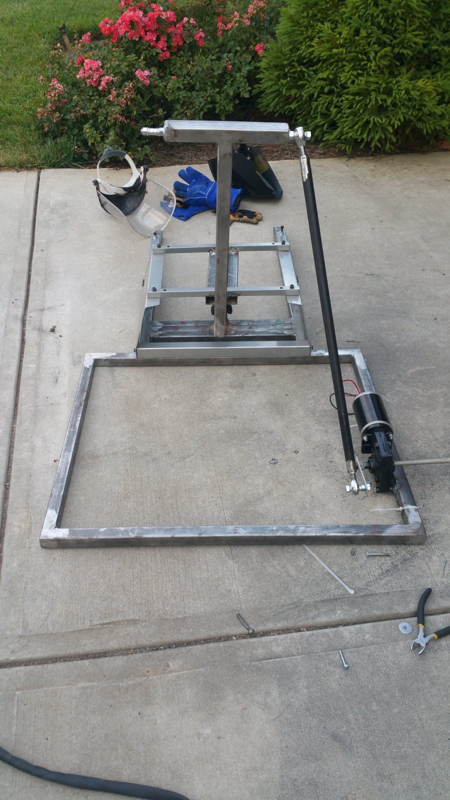

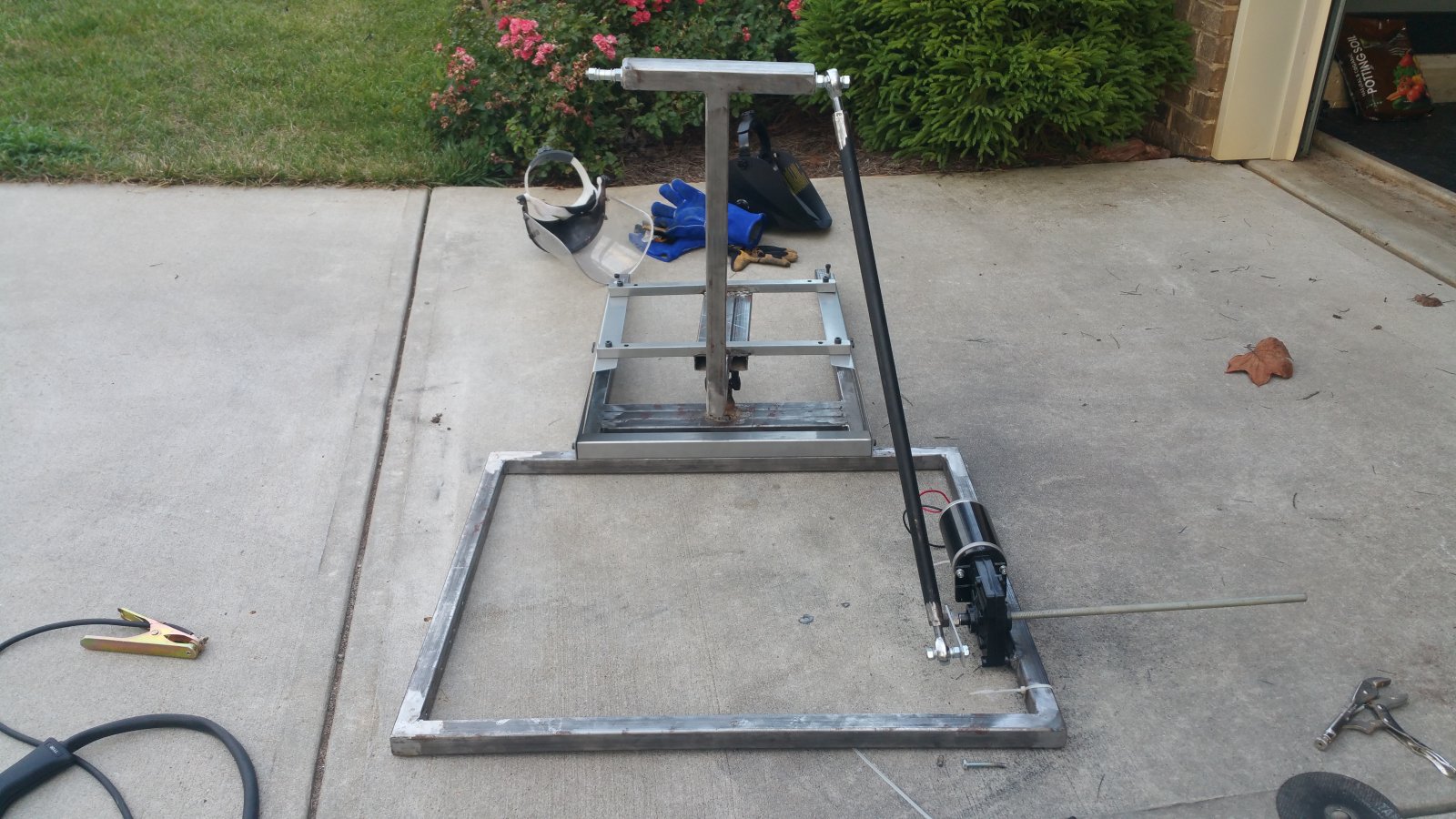

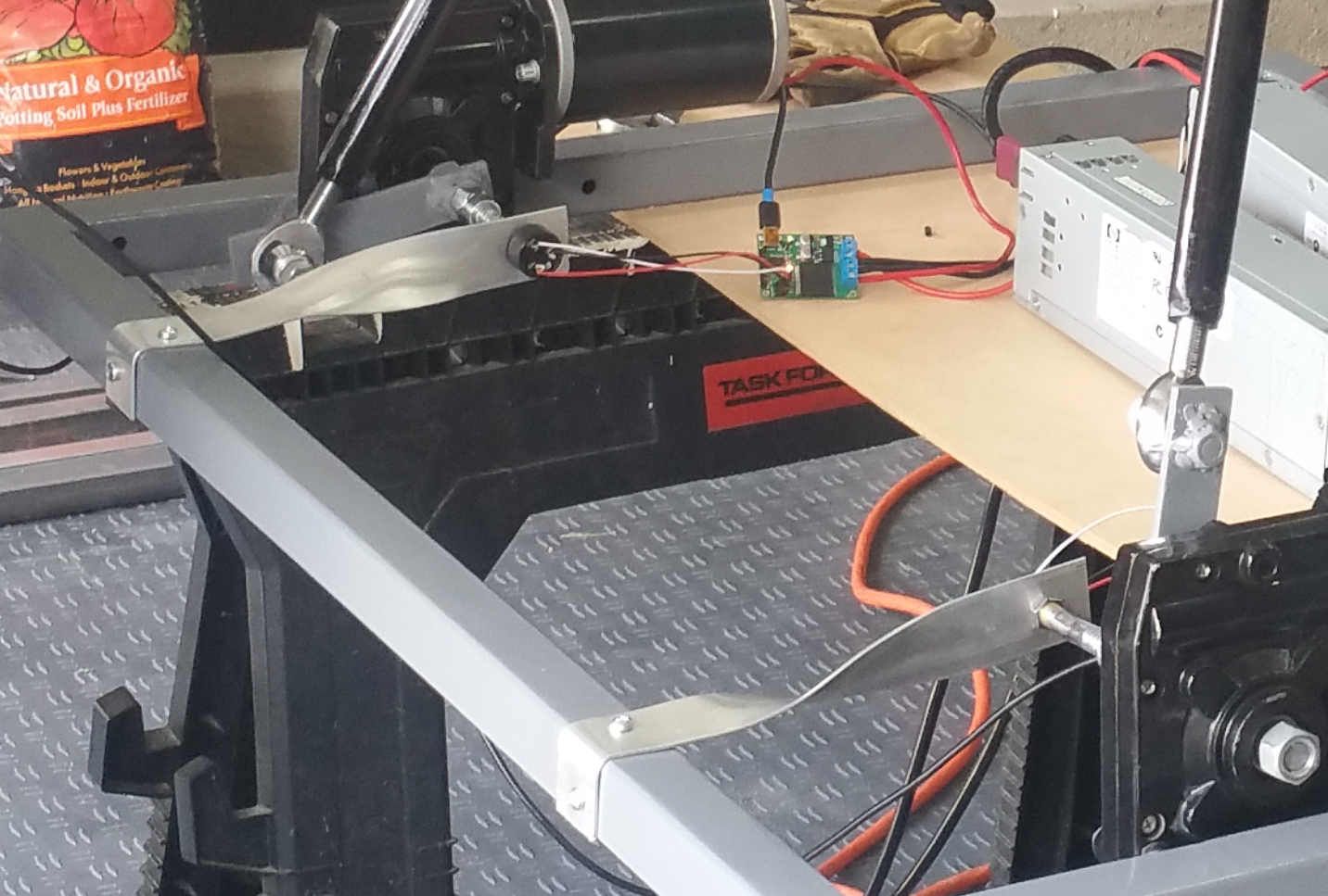

    More progress...
    I had a hard time reversing the motor shaft. I couldn't bang it out for the life of me. I ended up having to rent gear puller which did the trick.

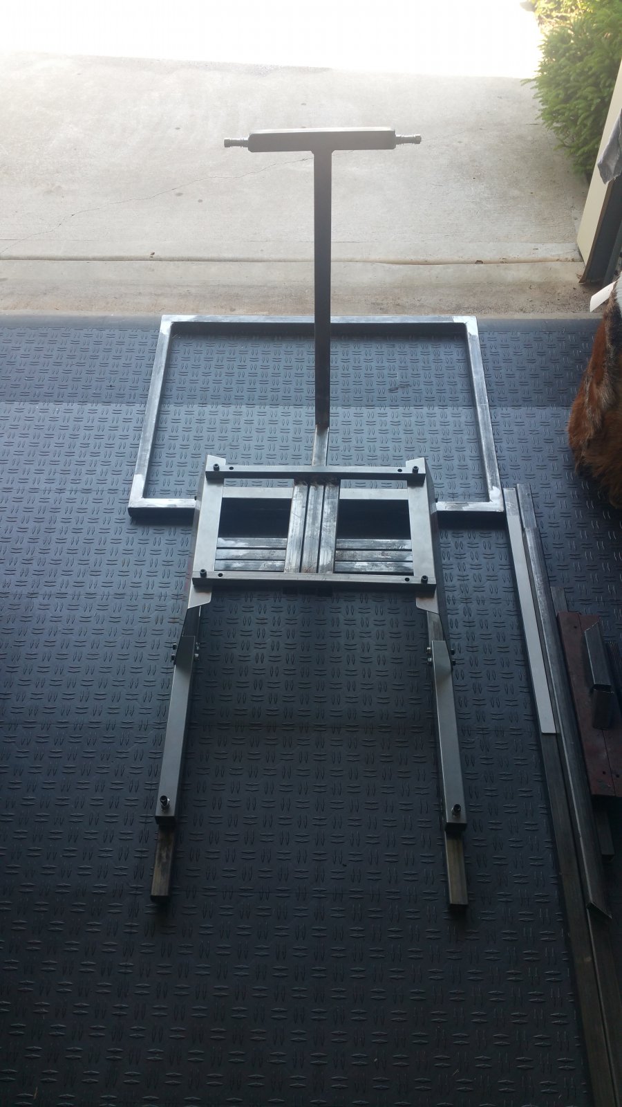

    7/25/2016 - Finished the frame
    8/2/2016 - Got the motors mounted to the frame

    I had screws where noorbeasts rivets were so it was just a matter of unscrewing the case and opening it up. The hardest part for me was getting bearing off of the shaft which is where the gear puller came in handy.

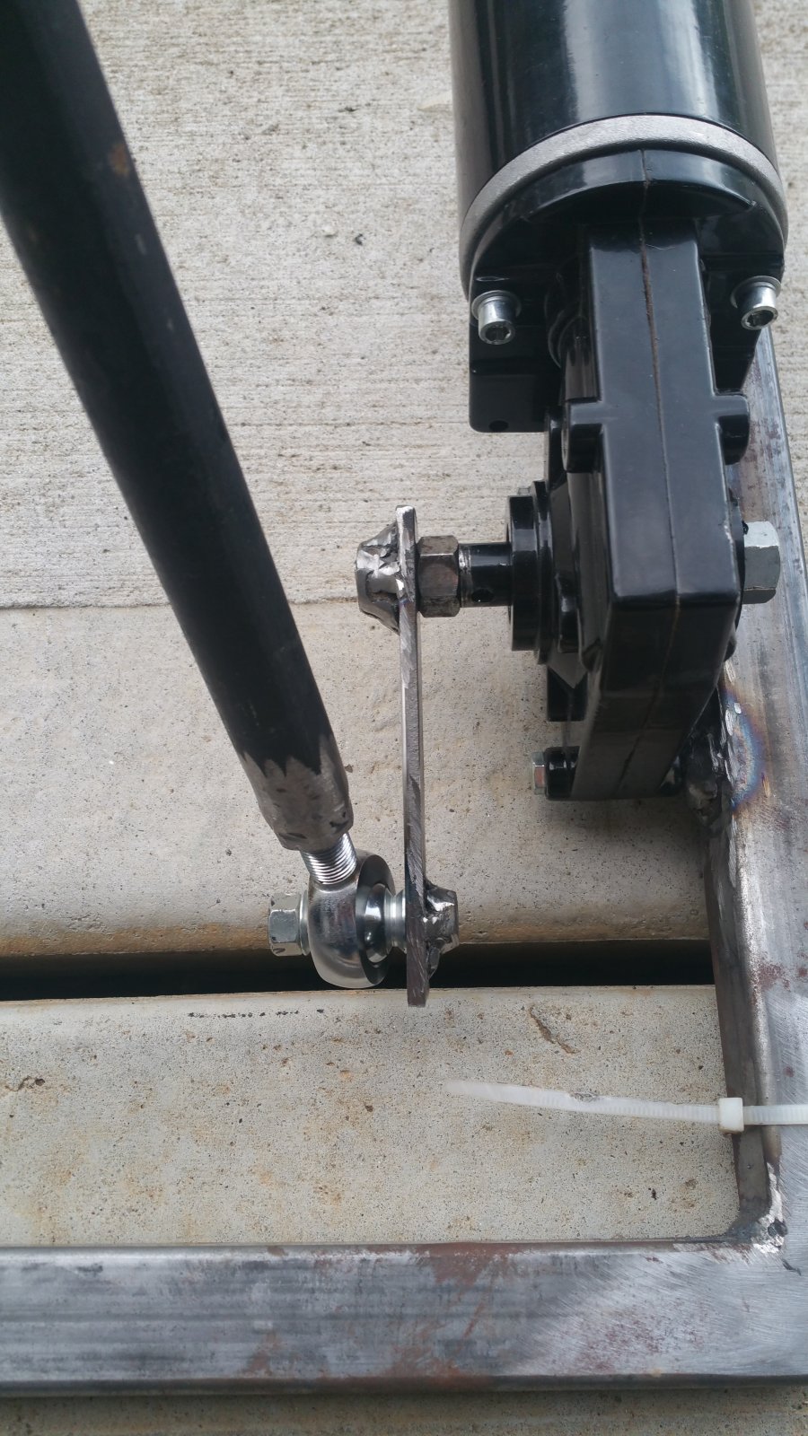

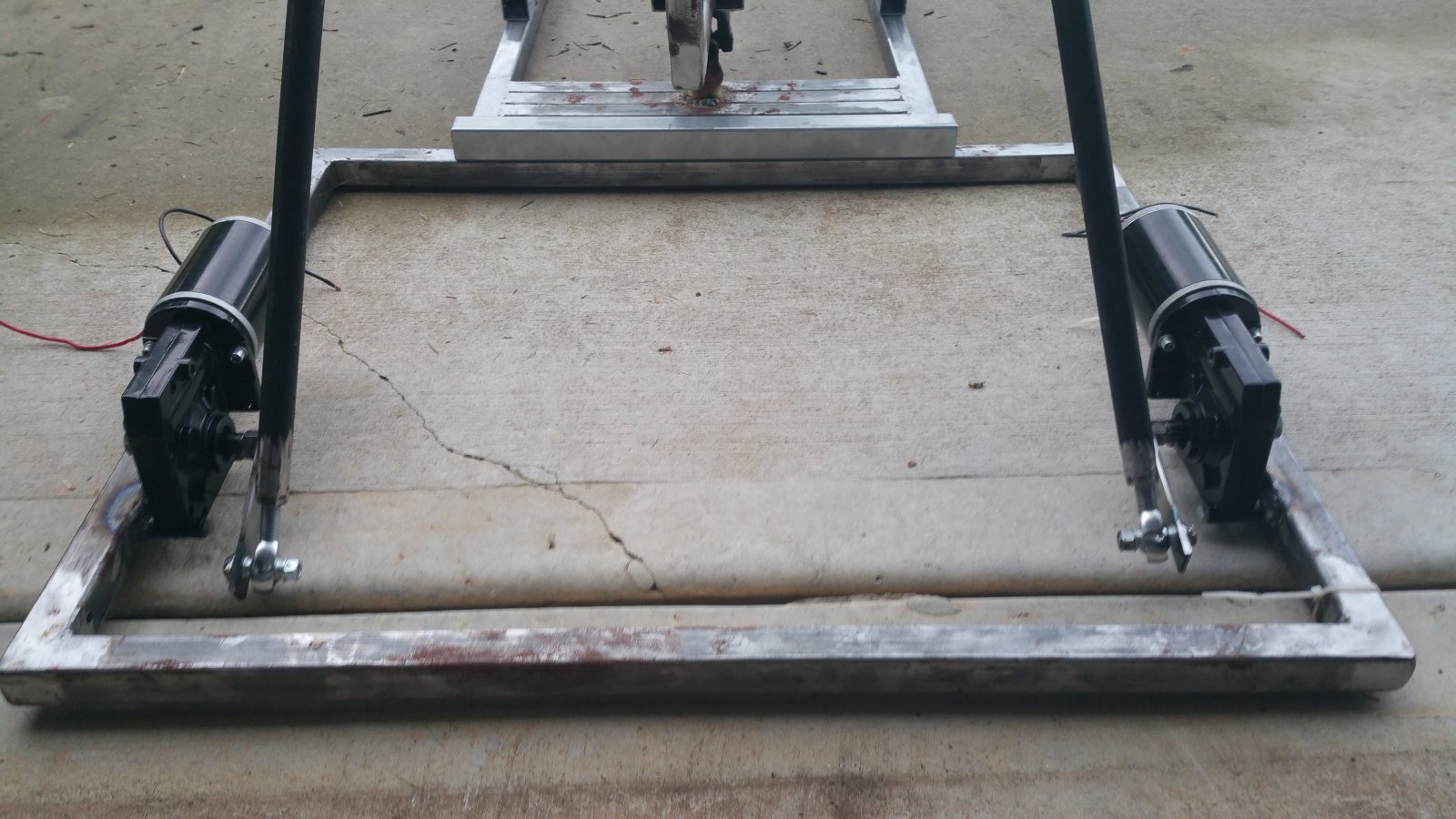

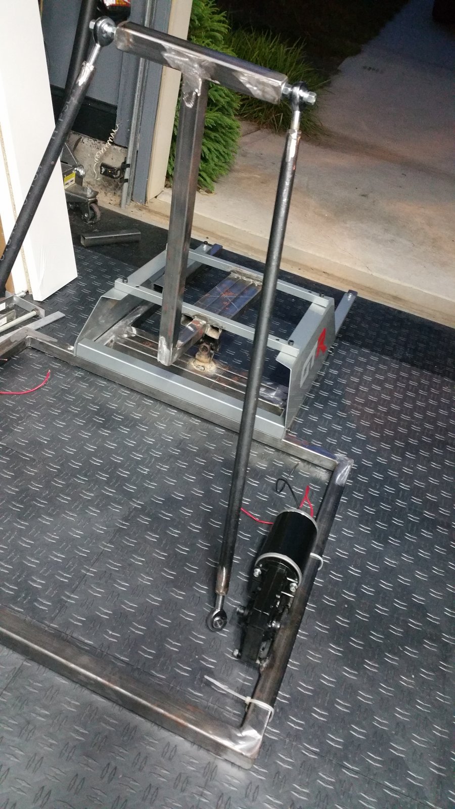

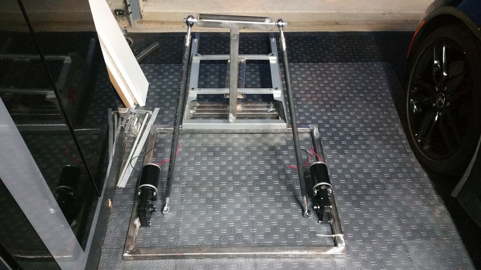

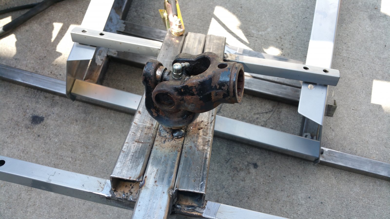

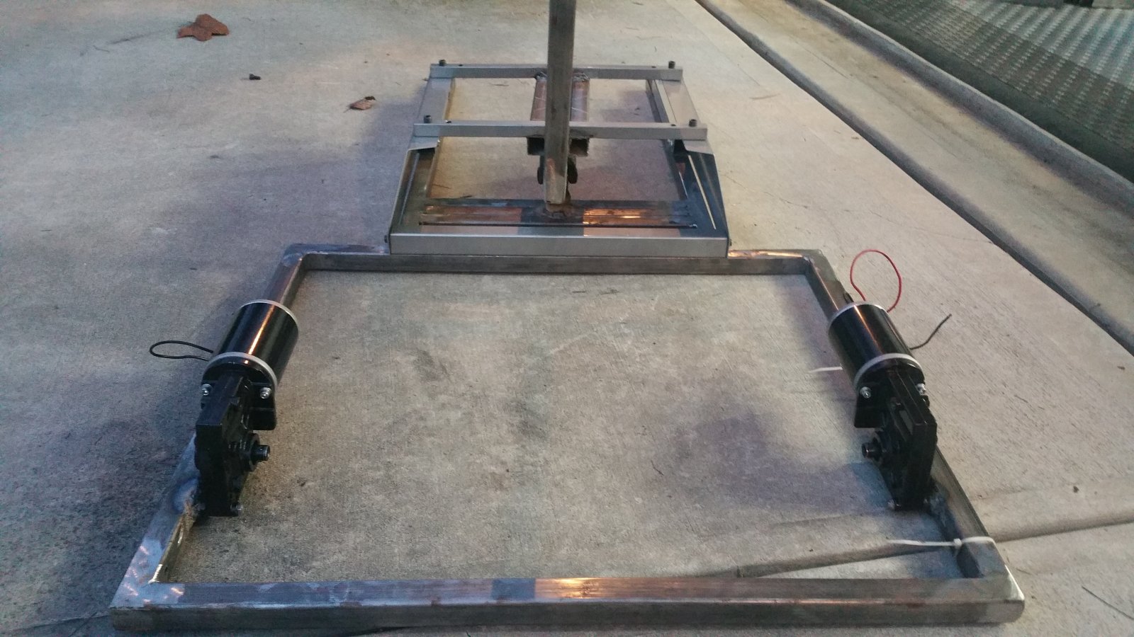

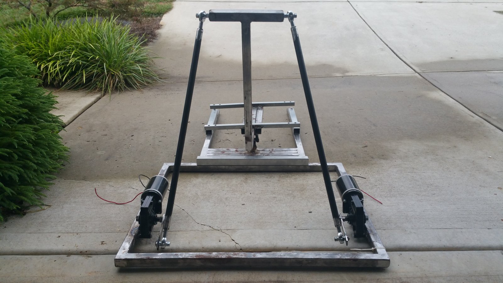

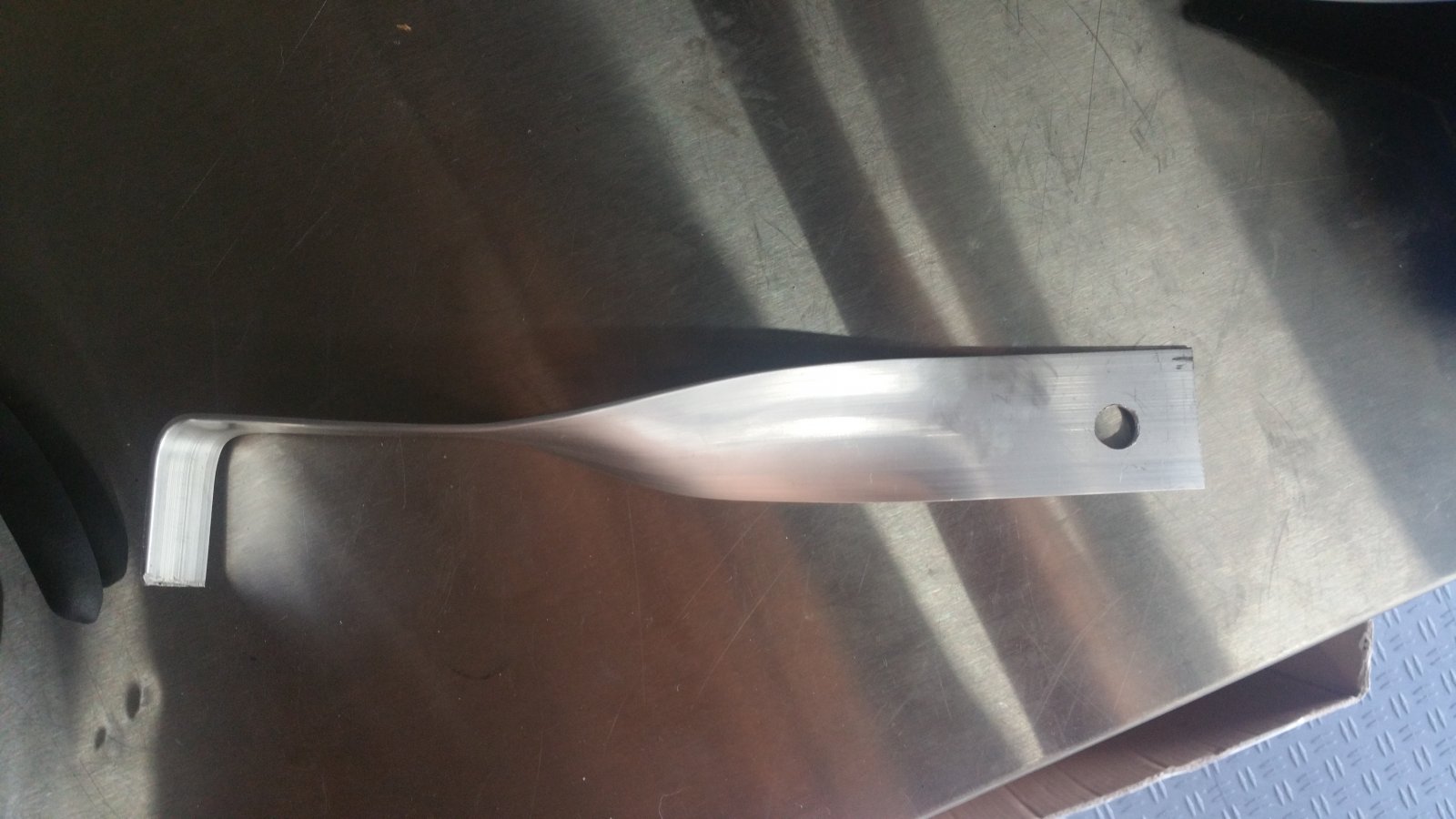

    8/9/2016
    Big milestone today. Finished off the levers on the motors. All major welding is done.
    Next step, clean and paint the frame.
  12. noorbeast
    20,571
    145,244Coins
    +10,783 / 52 / -2
    What is the Center To Center distance on the levers, it looks pretty big?
  13. pittperson
    pittperson Member
    Aug 21, 2015
    40
    North Carolina
    550Coins
    +25 / 0 / -0
    Center to center is 3.5 inches. Should it be shorter?
    20,571
    145,244Coins
    +10,783 / 52 / -2
    That is about 90mm. By all means try it, but if the motors struggle at all then try around 60mm.

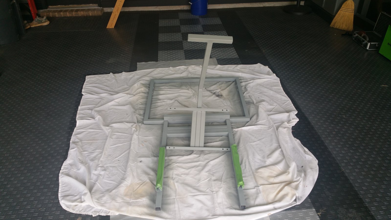

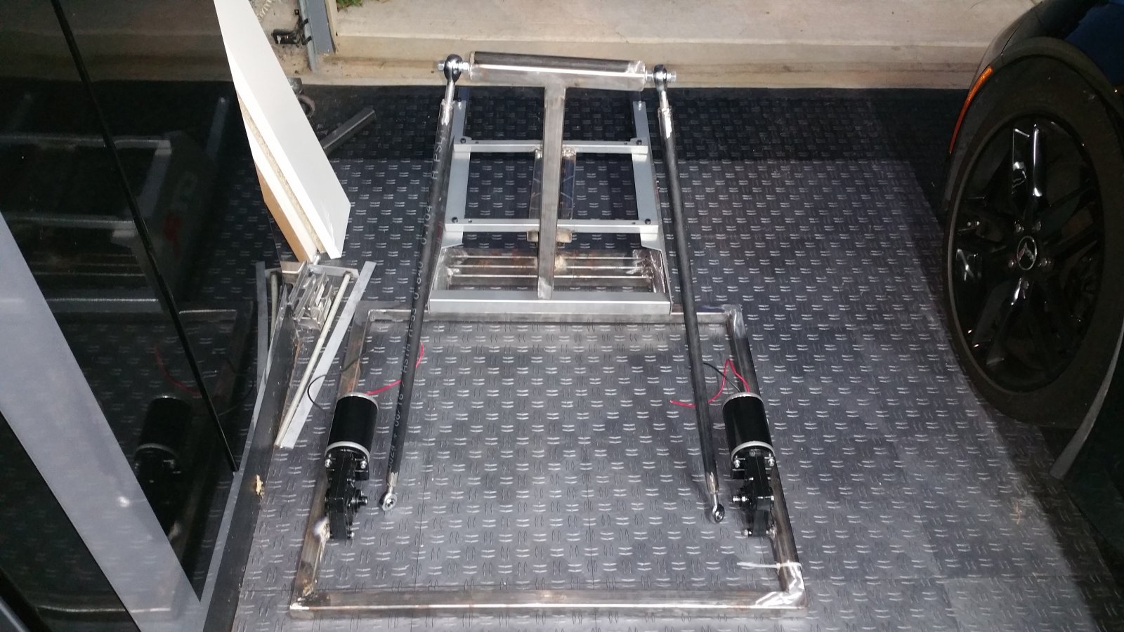

    All primed and ready for paint...

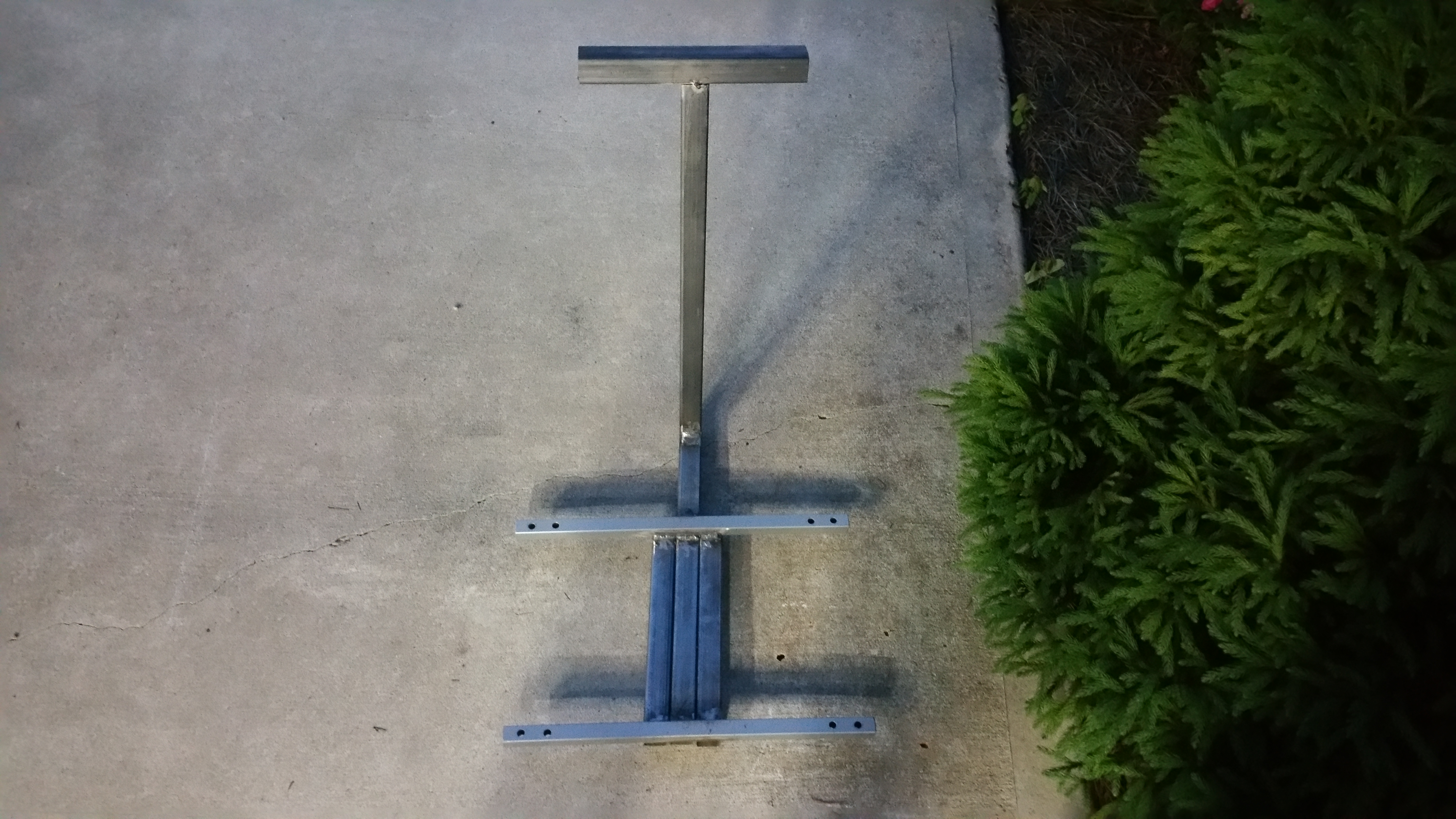

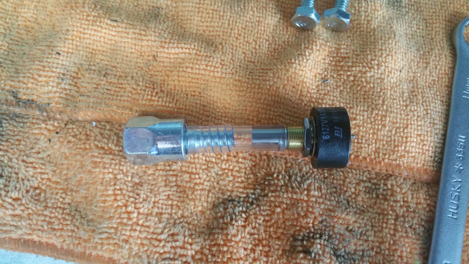

    8/13/16
    - Frame all painted
    - POT mounts created (used some 1/8in aluminum and twisted it, cut down the hex drive screws and connected the two with some rubber tubing to create these)
    Unfortunately I fried one of my JRKs so work is on hold until the new one shows up.

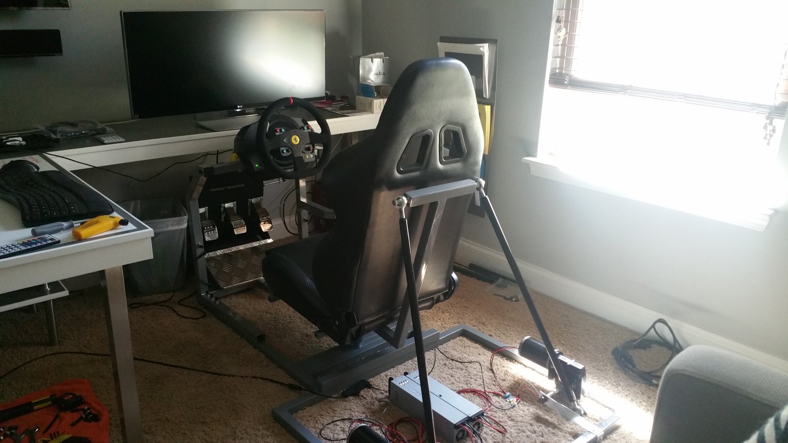

    8/17/16

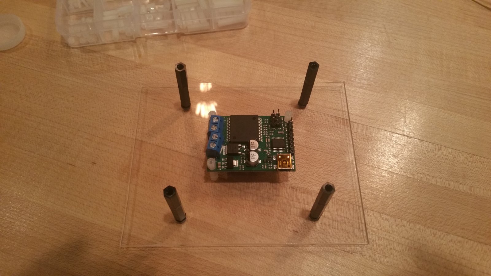

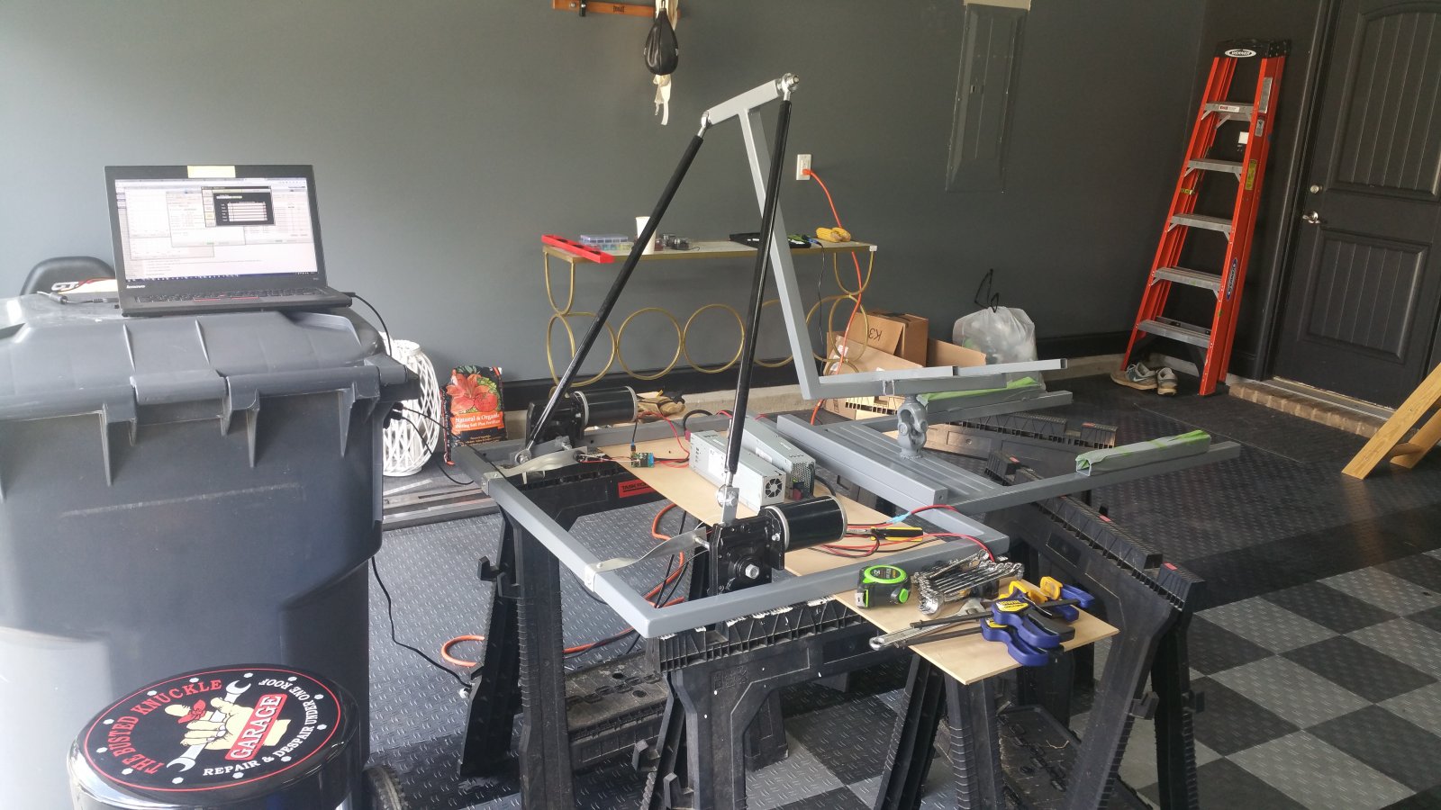

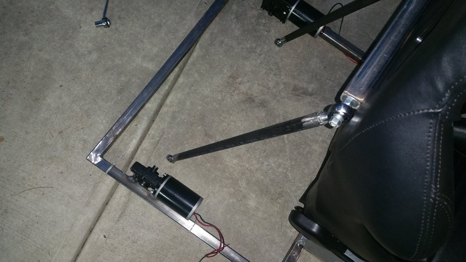

    It's alive! Next steps
    - Clean up the wiring
    - Create protection for the JRKs
    - Mount power supplies and JRKs to a solid base.

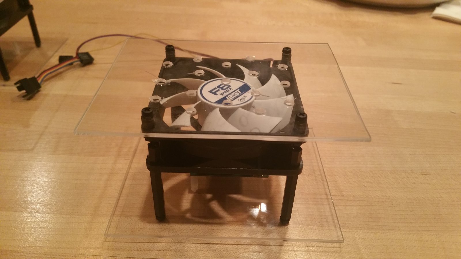

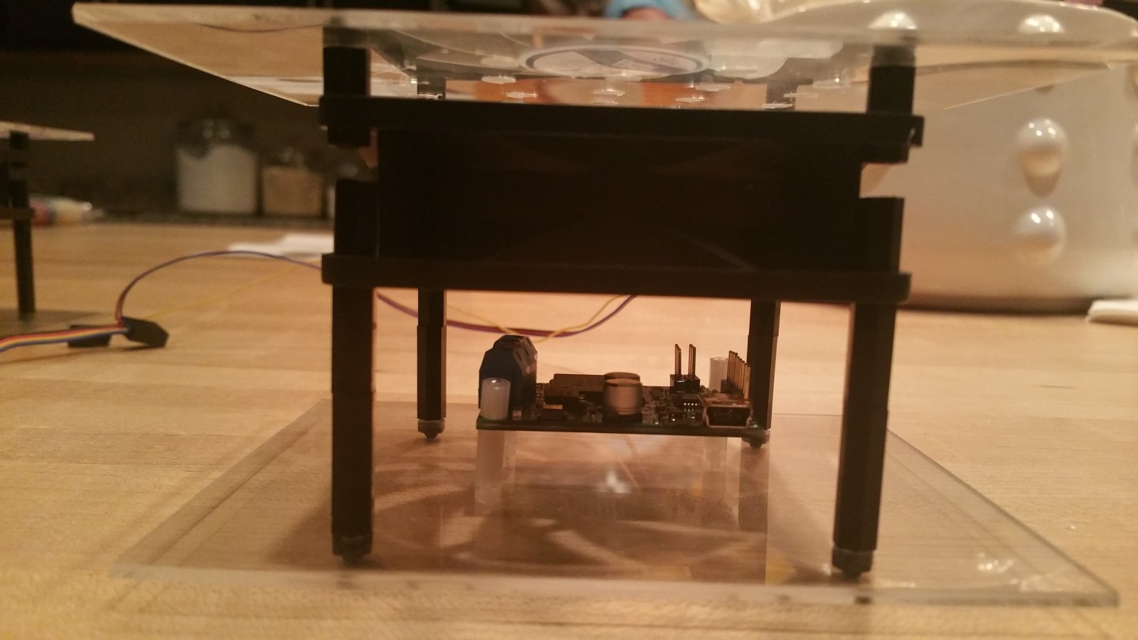

    8/24/16

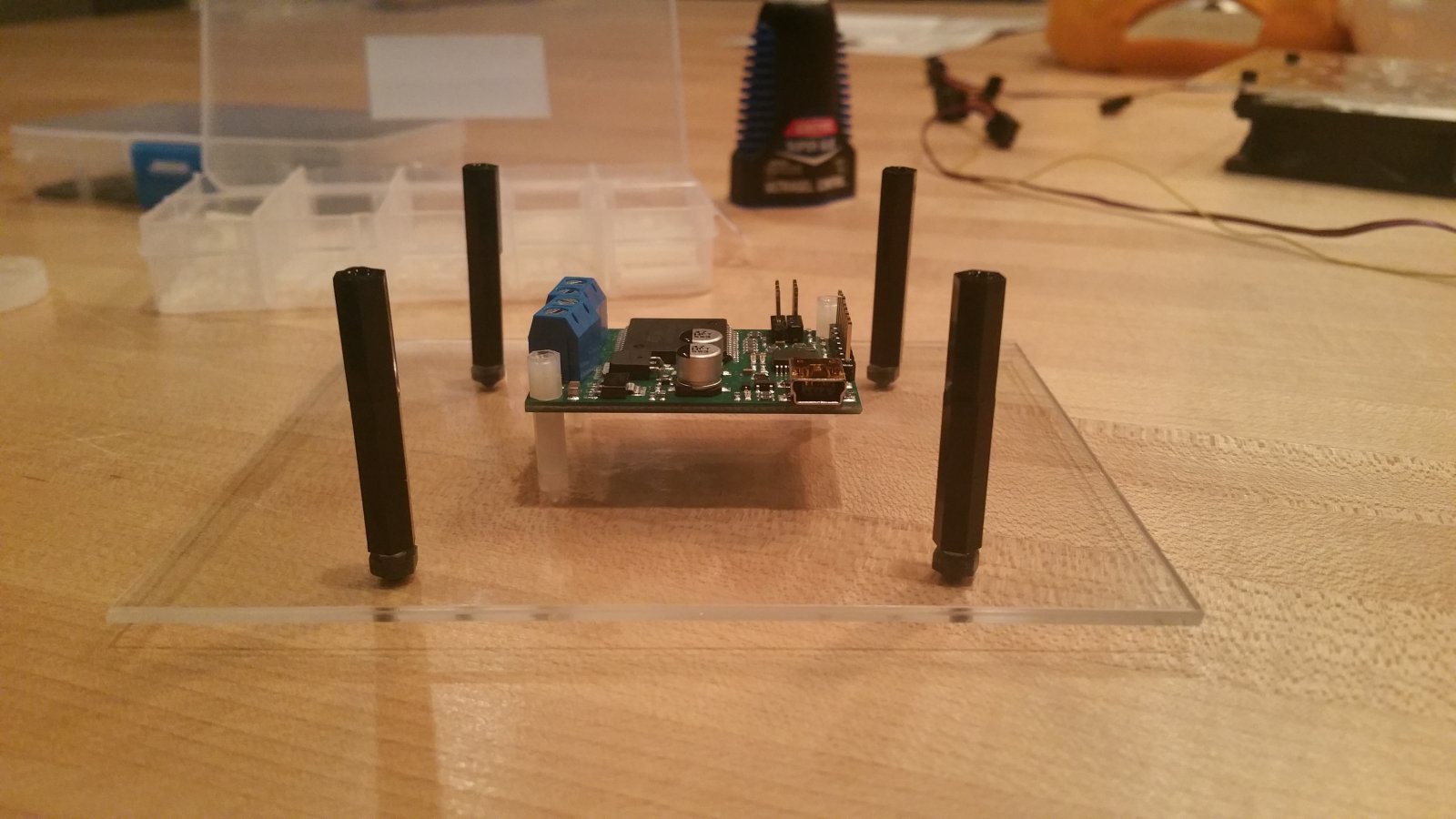

    Built a couple fan mounts/JRK protectors with some spare parts.
