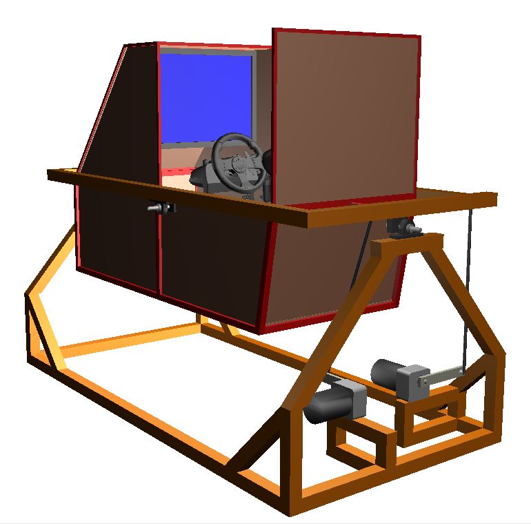

    My current plan is to connect one end of a bar to the motor's drive shaft and the other to the gimbal frame. This seemed like the easiest assembly I could think of. I am currently concerned about stopping the motor at the thresholds.

    Below is a [terrible] photo mock of how I was thinking about attaching the motor to the joyrider gimbal frame. Let me know what you think.
    Thanks,
    Michael.

    These motors can exert a lot of force, how rigid are the hose clamps and PVC?

    Hi @noorbeast,
    Thanks for taking time to look at my build! After you pointed it out I am concerned as well. I would now like to mount the motor on the ground and use threaded rods and couplings to make it safer. I took a look at some of your builds and they are awesome! I would like to try and adopt the rod and coupling assembly that you have used. I had a question about some of the parts that you have used, because, unfortunately, I don't know what they are. I have attached one of your photo's and circled the parts. I would like to try and use something like this to attach my motor to the joyrider gimbal frame. What are they? I would like to try and purchase them if I can.
    Thanks for all of your help!
    Michael.

    Hi @Icefox,
    Thanks for the information, that helped me out alot! I was able to translate it to an English variance, which is
    ROD ENDS/HEIM JOINTS/UNIBALLS
    Thanks again for your help,
    Michael.

    HI @Thirsty
    I think these motors can be used for this application. My hope/goal was to get a greater degree of movement on my flight simulator. I have made some modifications to my designs based on some input from community members. In my research I have seen the belts used the way I had described. I tried to look for the build that I had seen this on but I fell a bit short in my recollection. I will continue to look for where I saw this and post a reference to it for you when I find it.
    After talking to a few members about this I think the main concern I came away with was:
    • keeping appropriate tension on the belt
    • making sure you could stop the motor if something failed, i.e. potentiometer failure
    I still have not settled on an approach for the motor mounts or configuration but I will keep you posted on what I find.
