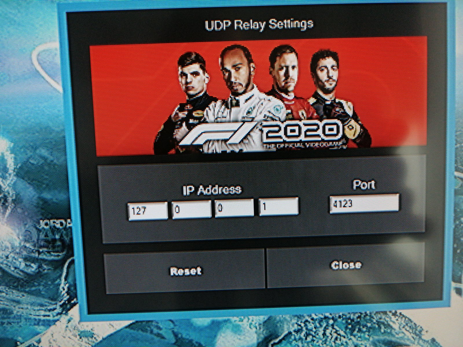

    Ok, I changed the local settings, now it works in LFS, but not in f1, when I stop the game from simtools, simtools closes

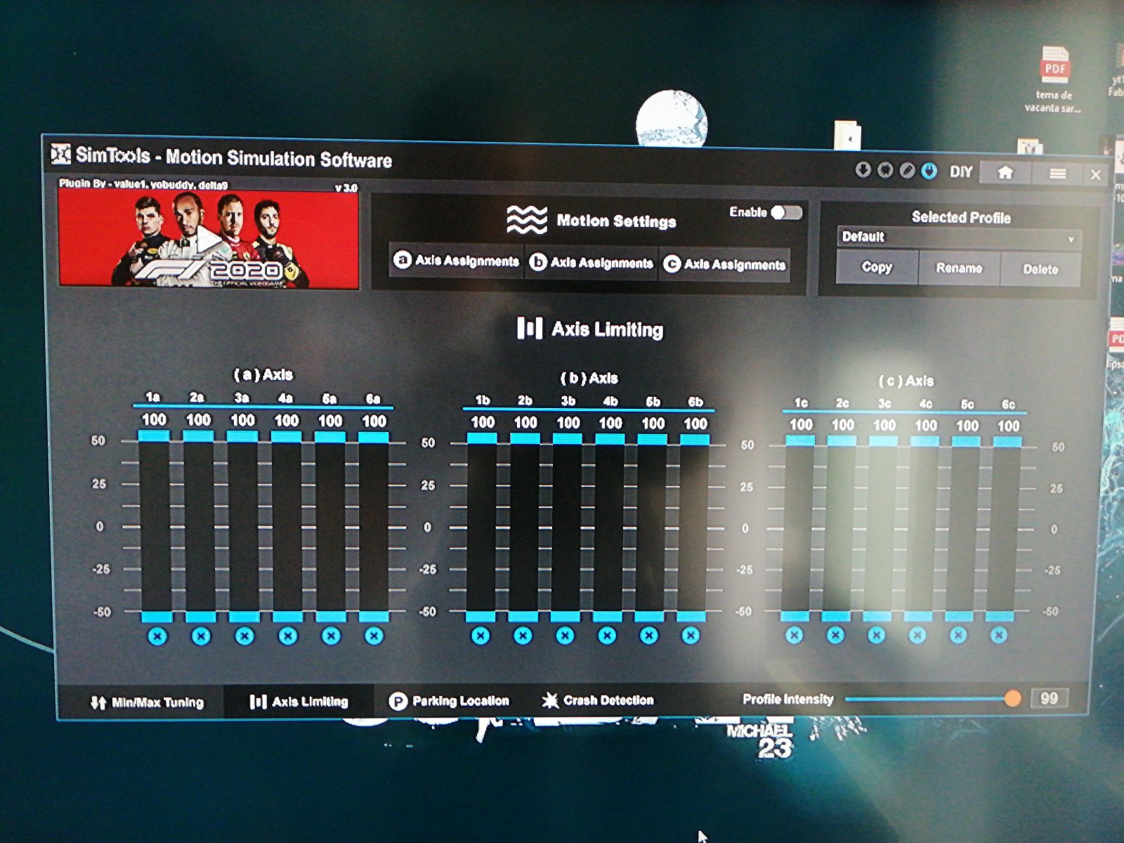

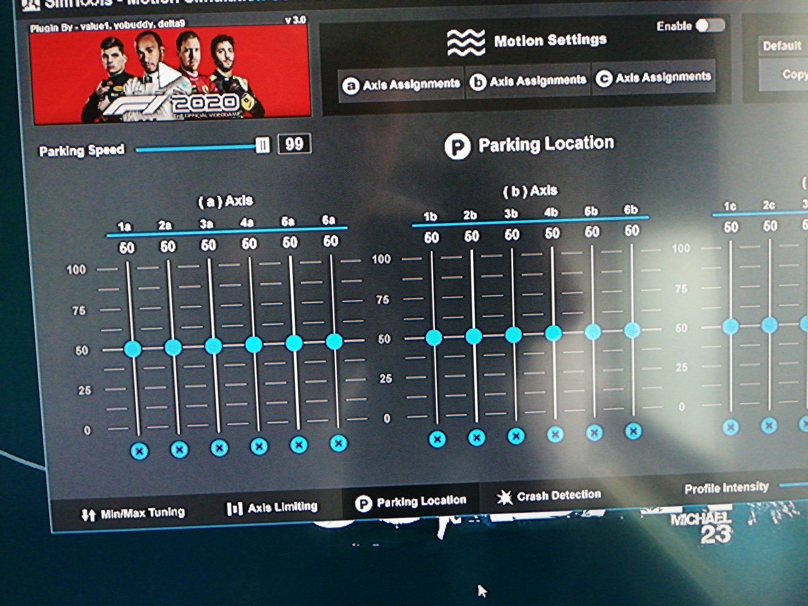

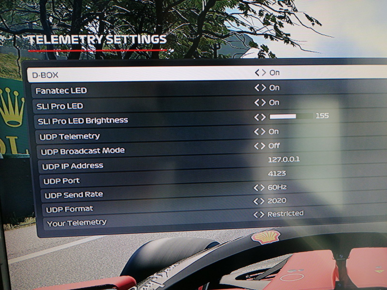

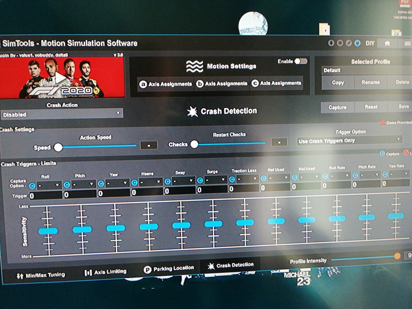

    Thanks for confirming that, that the language bug seems to persist with SimTools v3 is something @yobuddy can consider further.
    If it works OK in LFS it is likely settings need to be refined for F1. If SimTools crashing on closing a game how are you actually doing the closure?
    And can you please post pictures of all you F1 settings.

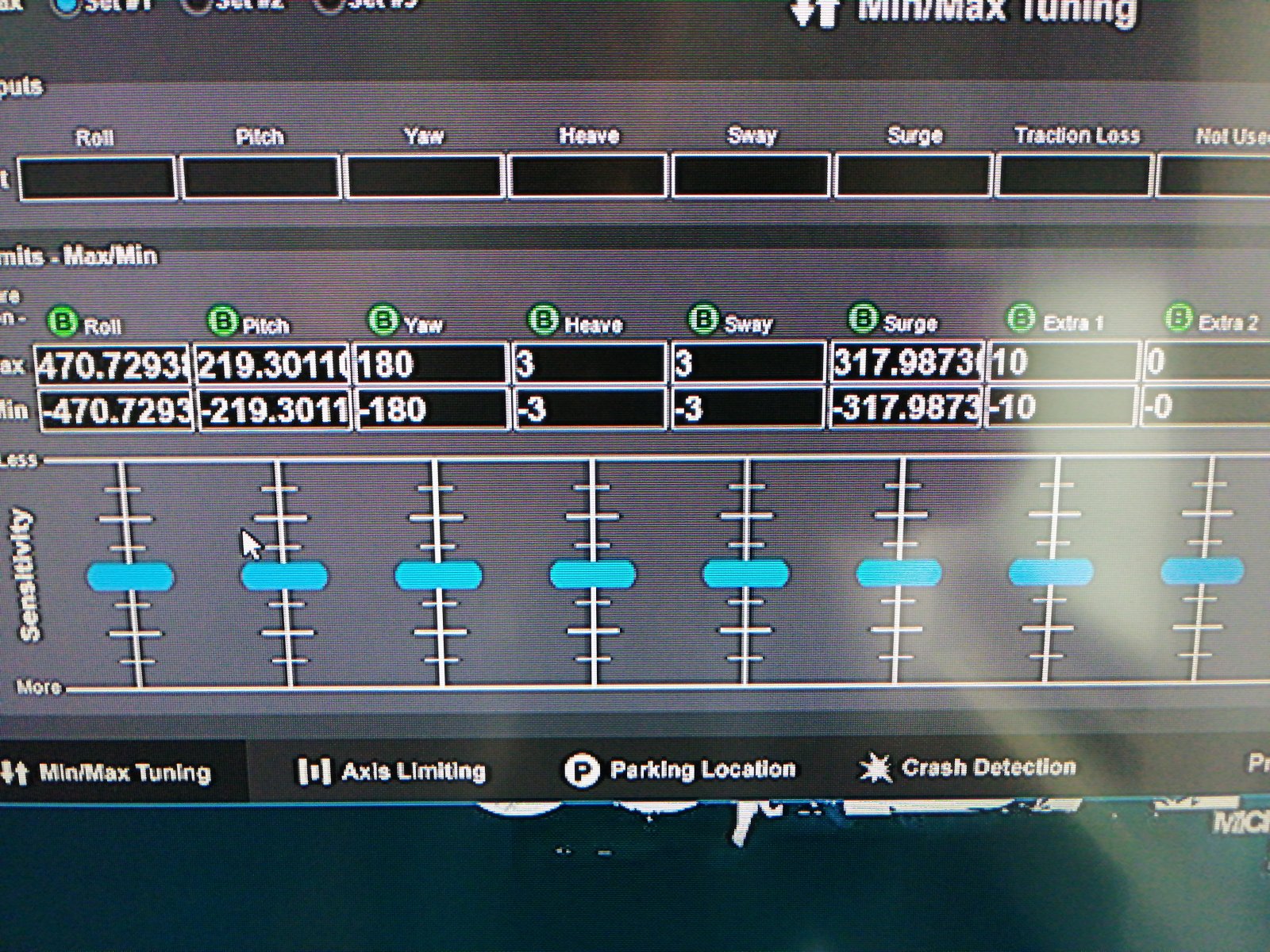

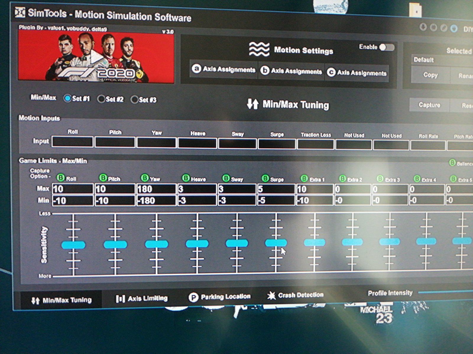

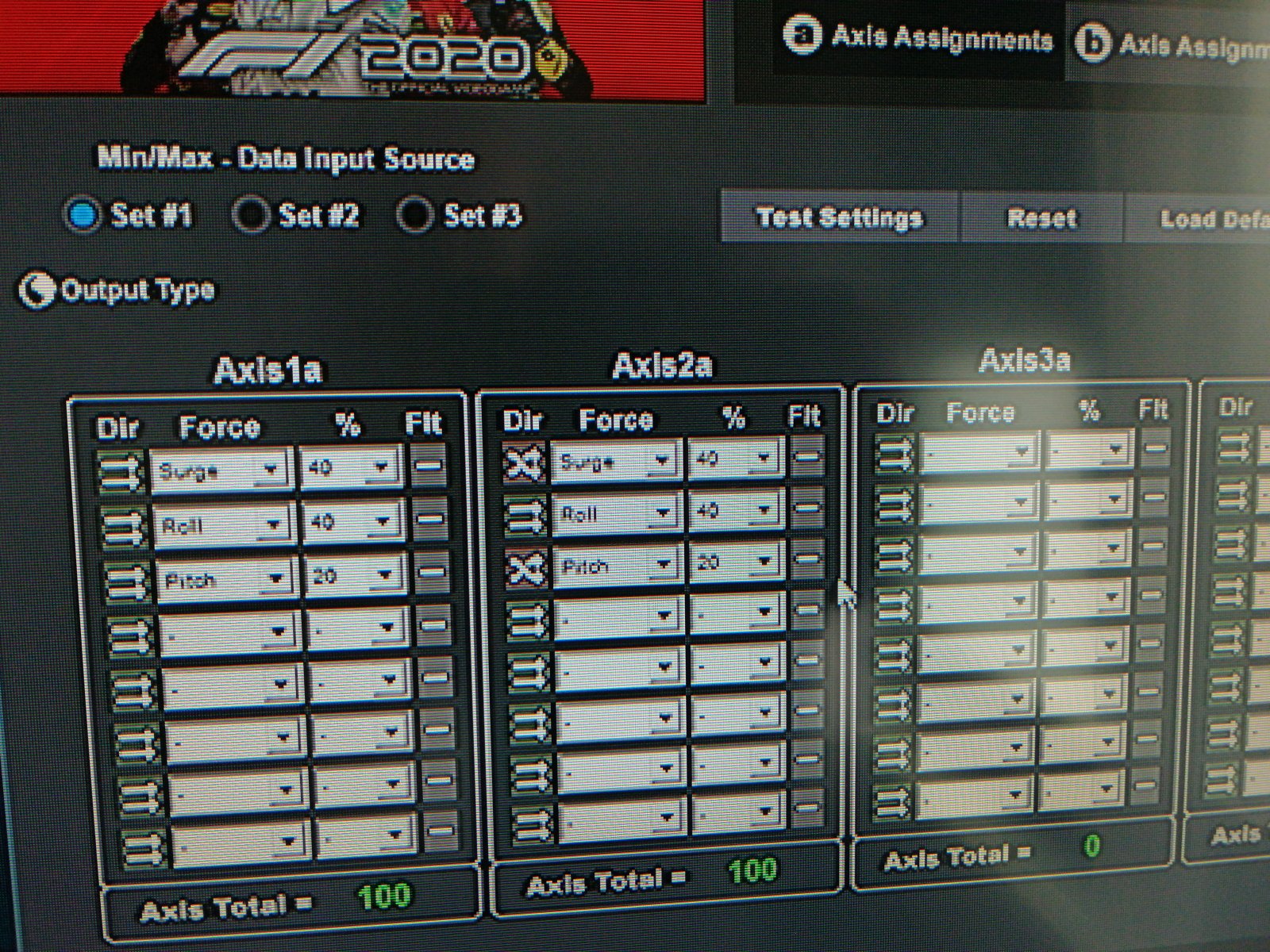

    What is the max value In the tuning setting?, because I tried to increase the value to 50%, but I noticed that it goes way over 50

    And I can't save the values
    22,225
    154,819Coins
    +11,226 / 57 / -2
    Try Capturing the Max/Min values then save.
    Also try reducing the Profile Intensity, say to 96 and see if that stops the crashes.

    I tried to increase the value in tuning but still not working
  18. noorbeast
    22,225
    154,819Coins
    +11,226 / 57 / -2
    You need to capture the Max/Min values and the tweak from there.
    The smaller the value the snappier the response over a smaller range, the bigger the value the more gentle the response, over a greater range.

    I solved the problem, I downloaded the f1 2019 plugin and now it works, my opinion is that there is something wrong with the f1 2020 plugin
