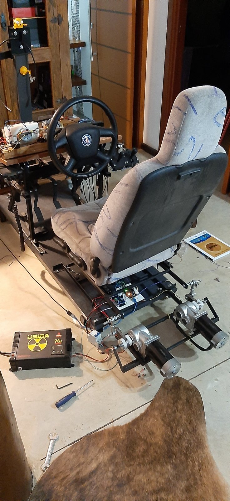

    my motor loses power and falls when i sit on the bench, can someone help me, they are wheelchair motors, 24v/70a source, ibt2 h bridge, arduino uno

    It works perfectly, when the weight of the body is placed, it stops working, as if the engine turns off.

    Is the rig balanced with you on it?
    Maybe that would take some load of the motors.
    What is the power (Watts) of the motors?
    Sounds like it draws to much currant( amperage) .

    The motors are around 300 watts with a reduction of 32/1 each, I use a 24v 70a source, I put car batteries for testing but it was the same thing, it could be the SMC3 configuration, it works well but suddenly it falls apart

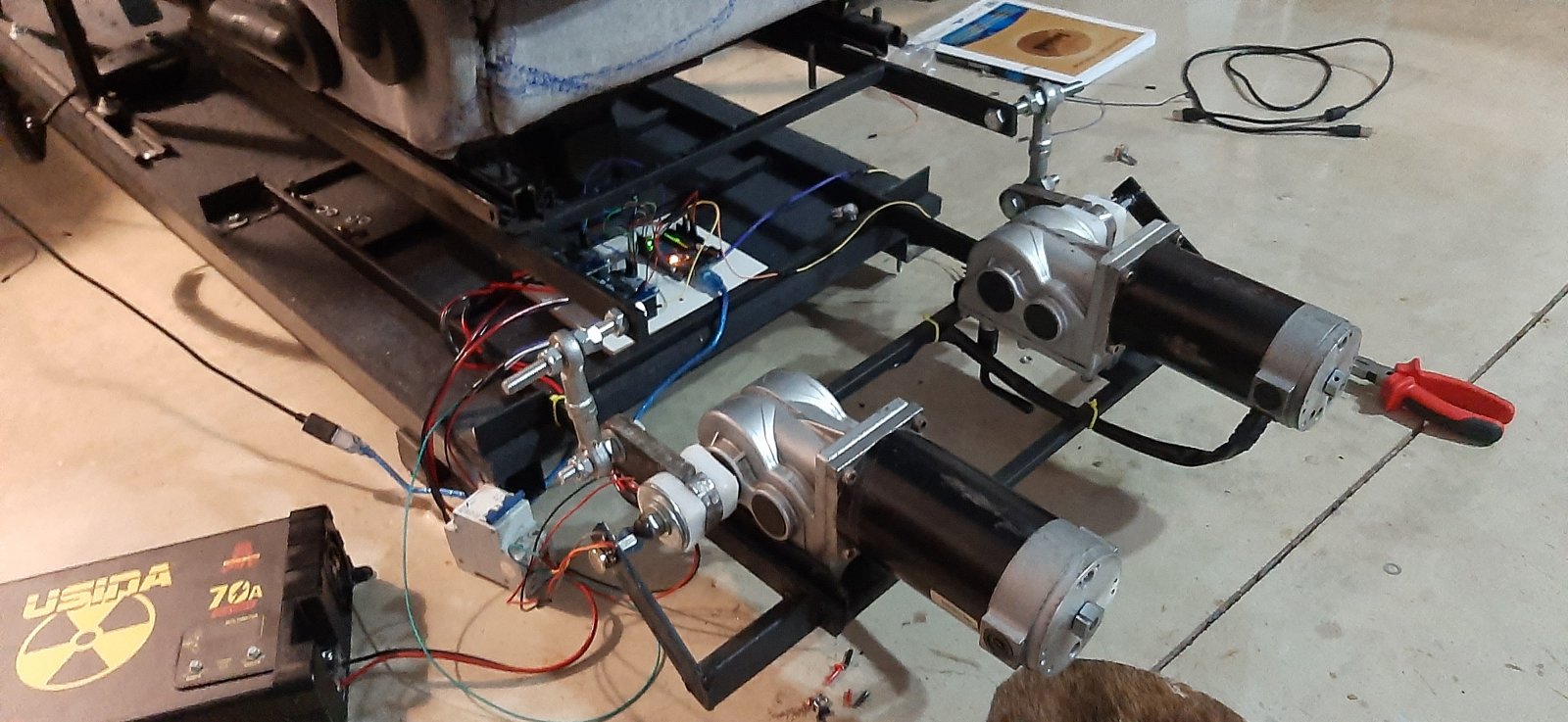

    I did a new test, my power supply works at least at 24v, I put a fan on the ibt2 bridges, in the ammeter test it reaches 3 amps and the motor is turned off, in theory the bridges are 43 amps and my supply 70 amps, it shouldn't there is this stop in the engine

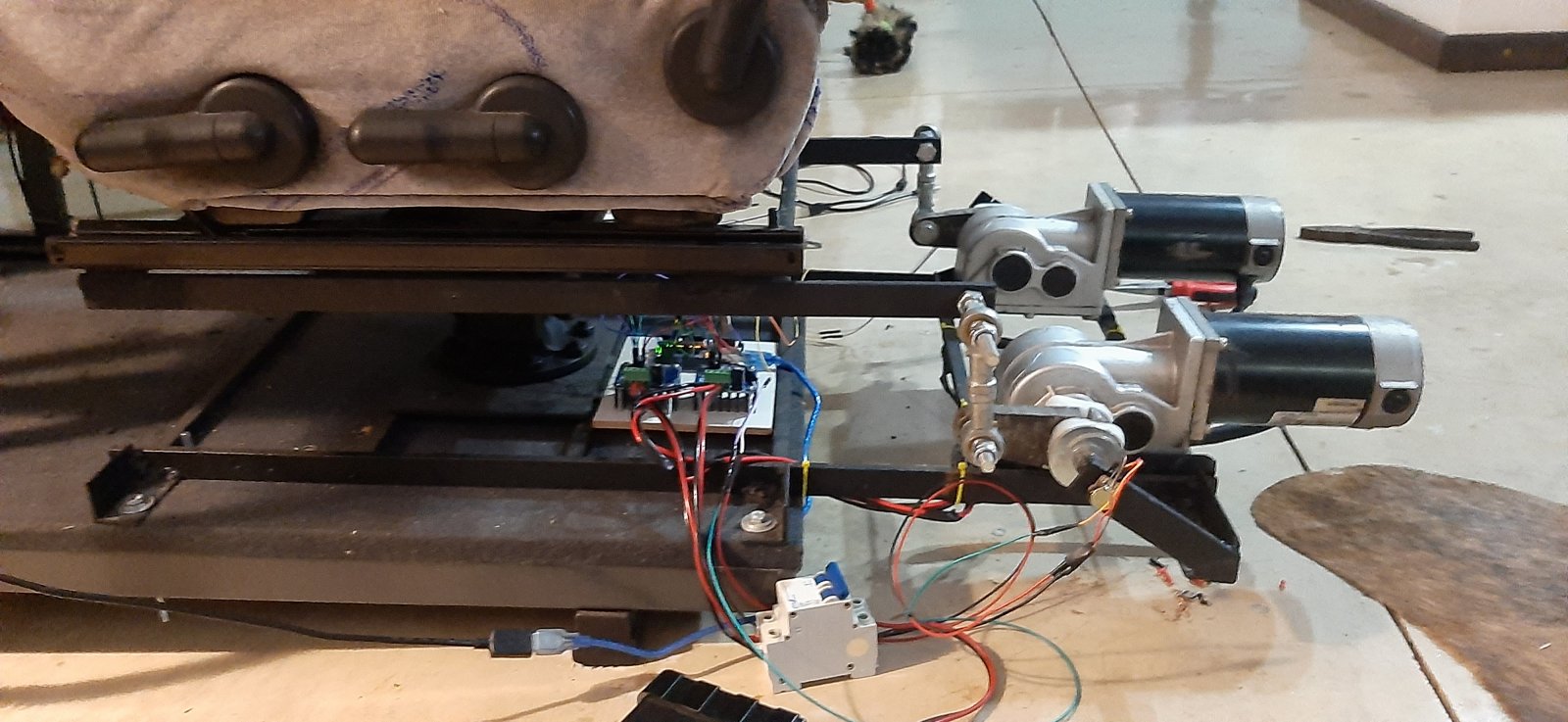

    Could be that the PSU is shutting down because of voltage received from motors when slowing down. This can easily exceed the supply voltage voltage. Some PSU can't handle that well. The bts7960 also doesn't like it much from what I read. A battery can handle this. Maybe the USB cable wich is pretty close to to the PSU lines, emi? Bad ground connection somewhere so could be a ground loop. I don't know exactly what the switch between the PSU line is. Looks like a 230v 16a breaker. Maybe it's faulty. Try to use one moter with the PSU so you know that it isn't the motors back emf that is working against each other. Just my 2 cents.

    I already changed everything, checked everything, and I don't find the problem, the 2dof works but suddenly I have to restart and it starts working again, the motors generate reverse energy could this be the problem, it would be as if the ibt2 h bridge goes into protection and turns off, closing smc3 and starting again the system works again.

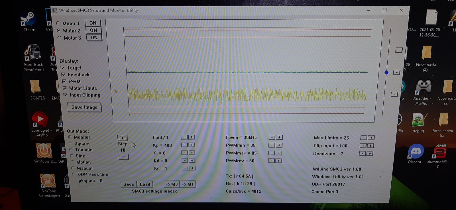

  16. noorbeast
    21,921
    153,137Coins
    +11,117 / 56 / -2
    Can you please post pictures of all of your SMC3 settings.
    If it is cutting out in
    Please post pictures of al of your settings, that will help other in giving advice.

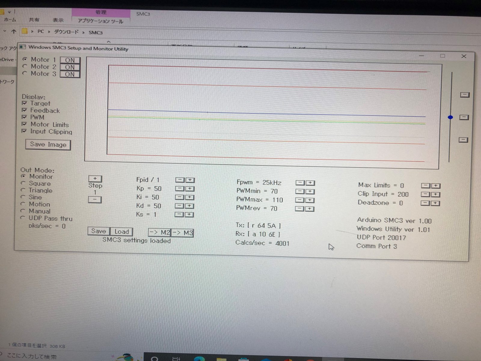

  17. nmk
    nmk New Member
    Jun 22, 2022
    12
    61Coins
    +6 / 1 / -0
    2DOF, 3DOF, DC motor, SimAxe, Arduino, Motion platform
    good morning to all of the forum, my friend my configuration is like this Kp=50,Ki=50,Kd=50,Ks=1, PWMin=70,PWMmax=110,PWMrev=70 ,Max Limits=0 ,Clip Input=200 , Deadzone=0 , this is my configuration , depending on the engine it changes , so you need to do your configuration, hope I helped .

  18. noorbeast
    21,921
    153,137Coins
    +11,117 / 56 / -2
    The SMC3 settings are explained here: https://www.xsimulator.net/communit...driver-and-windows-utilities.4957/#post-48121
    You have Max Limits at zero, which needs to be fixed, as if the set value is exceeded it will shutdown the drivers:
    Max Limits Used to create a band at either limit of the feedback range beyond which if the motors move (typically through inertia) the SMC3 will automatically shutdown the drivers and keep them disabled until reset. This is essentially a safety mechanism if something goes wrong.
  19. nmk
    nmk New Member
    Jun 22, 2022
    12
    61Coins
    +6 / 1 / -0
    Hello everyone on the forum, yes I will correct it, thank you very much for the tip.
