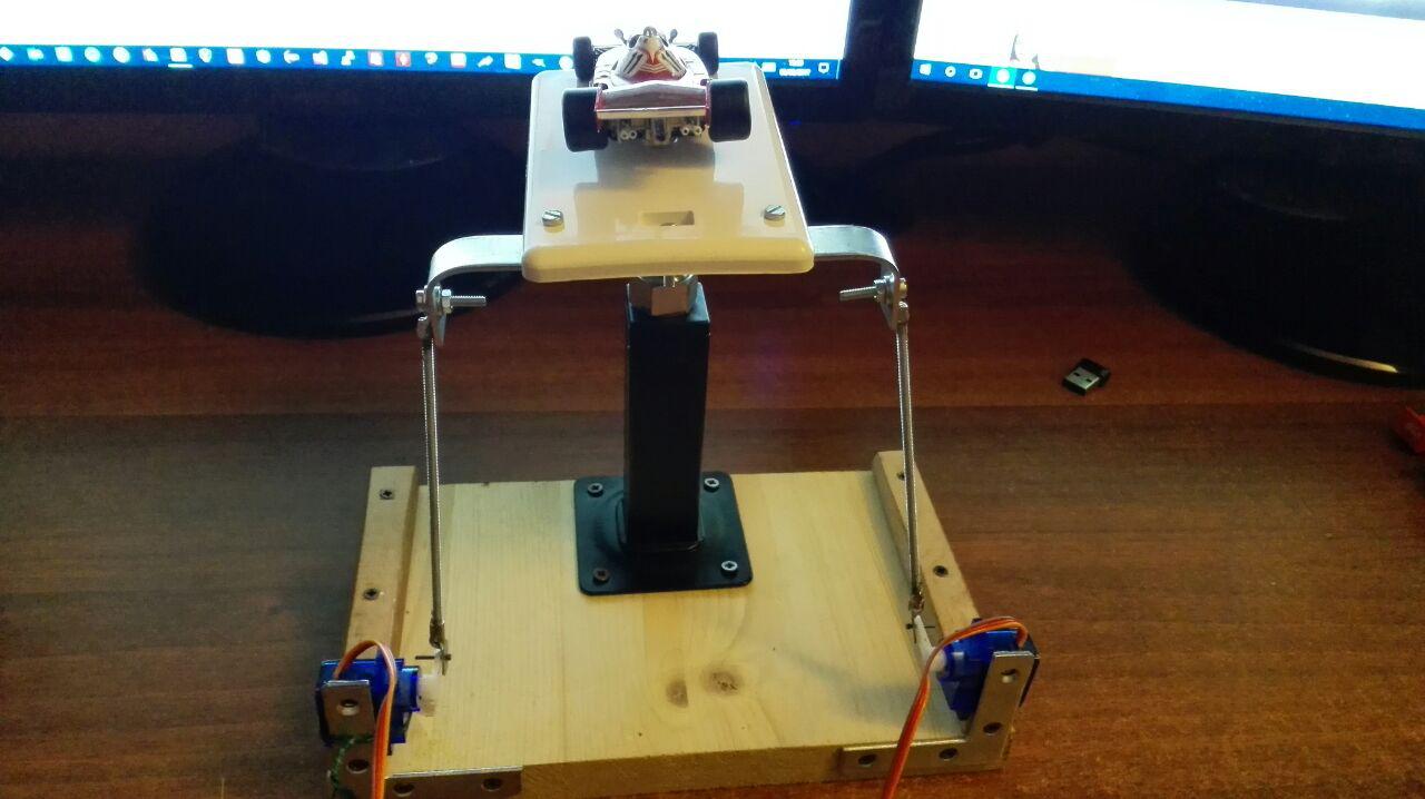

    Something like this is "seat mover", right? :)

    What you want to aim for is maximising the design leverage available for any particular design.
    Mine started as a 2DOF and for a compact design I had a bit longer leverage length with front mounted motors, once I had found where the balance point was for my particular rig.
    I have extended the top connection bracket back to add the 3DOF for heave and run a longer lever tube on that motor. If I had done the 3DOF from the start I would have made the base 500x600mm, instead of the 500x500mm it is now.

    Thanks @noorbeast , and thanks @Bernd Manger,
    now i'm playing with this model, this is my first test...
    When I have some times, I will create new thread.
    In this simulation I have setting Roll (70%), Sway(70%), Surge(90%) and Heave (80%). Next step will be to put motors on front to see differences and make model more compact.
