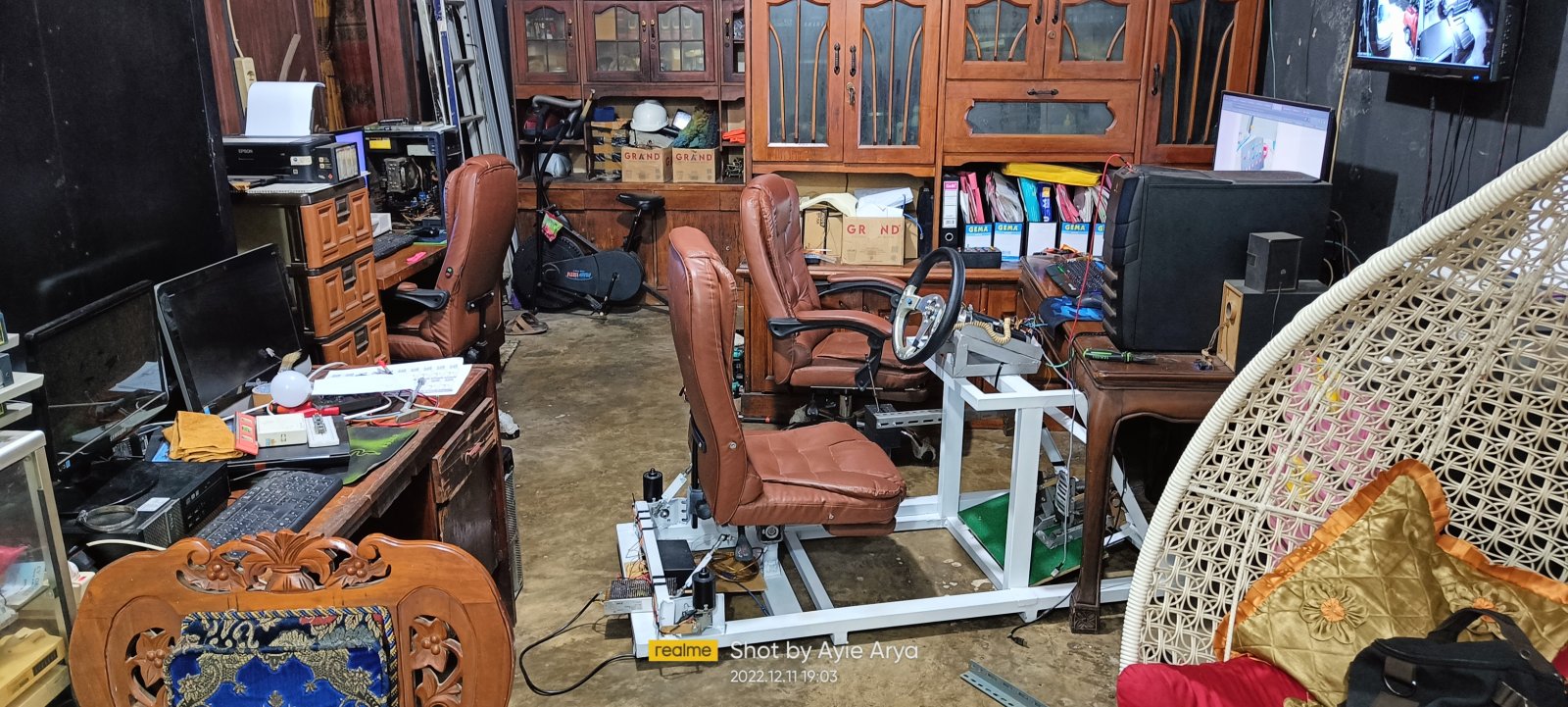

    Hello all friends,
    introduce :
    Other Name : PRIMADONA MEDIA
    Call Name : Ayie
    AGE : 34 Years
    Country Origin : INDONESIA
    The purpose of this use is as :
    1. Means of communication and community development for SIM MOTION DIY
    2. Upgrade Personal Level Account FOR DIY LICENSE
    3. DEVELOPMENT OF KNOWLEDGE IN COMPUTATION TECHNOLOGY
    I am a new member in this group and community
    I joined here because I wanted to continue my wish a few years ago, in 2013 to be precise, which I really wanted to have a motion simulator.
    with 2 arduino projects
    1. Arduino Leonardo Base Steering Wheel
    2. 2 DOF Motion Simulator Arduino Uno Base
    and today after so many years being delayed by time and busyness, I have been making a 2 DOF motion simulator racing and Stering Wheel inspired by my friend's youtube channel in Indonesia https://www.youtube.com/@muh.ismail
    DMAX youtube channel https://www.youtube.com/@DMAX_DIY
    DIY ARDUINO STEERING youtube channel https://www.youtube.com/@mypc-id
    makes me want to build DIY DOF SIM and STEERING WHEEL
    Video motion test on Youtube https://www.youtube.com/@primadonamediadigitalindo2096

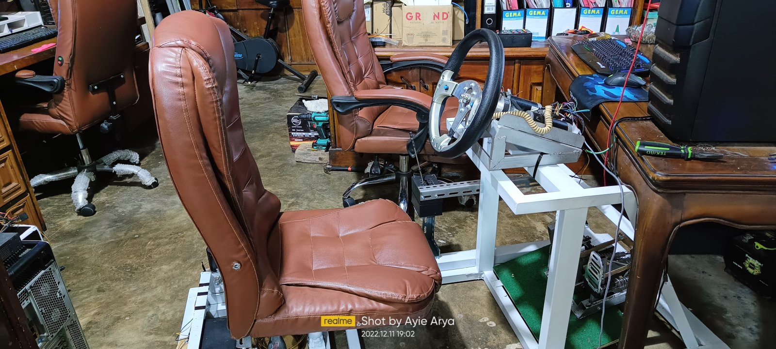

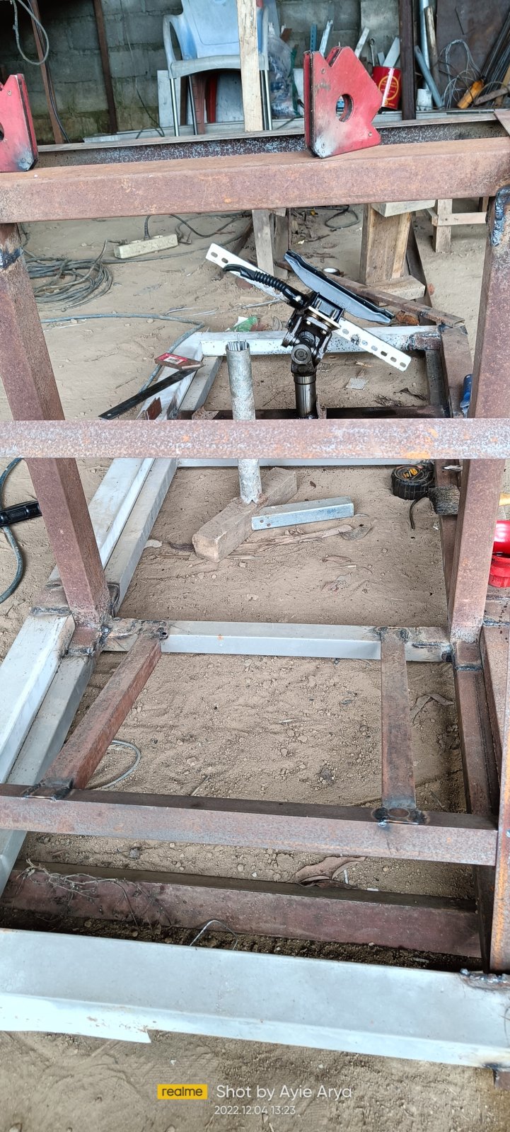

    I made this 2dof project only for the chair the motion effect
    And in the future I will build a FULL RIG MOTION so that I can feel the full effect of the game simulation game
    Thanks You

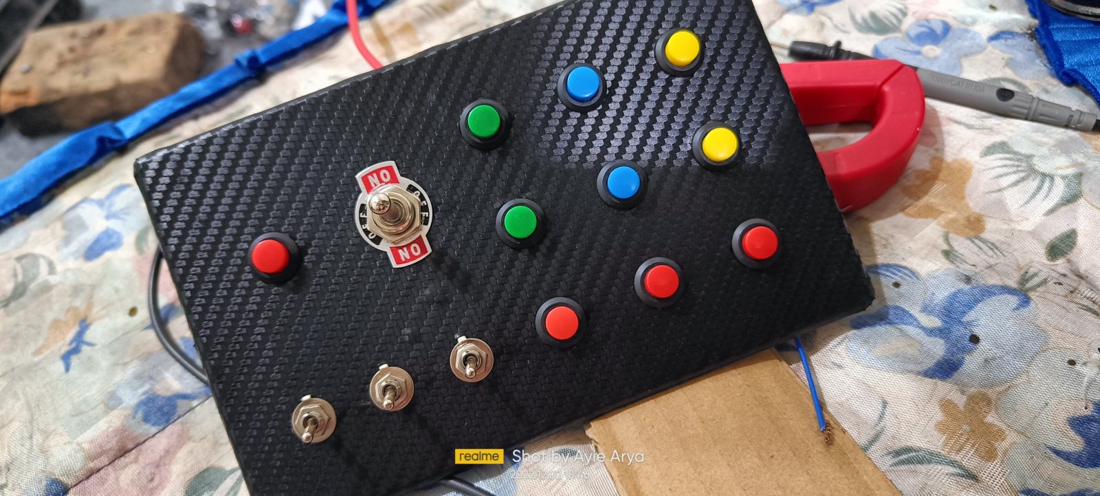

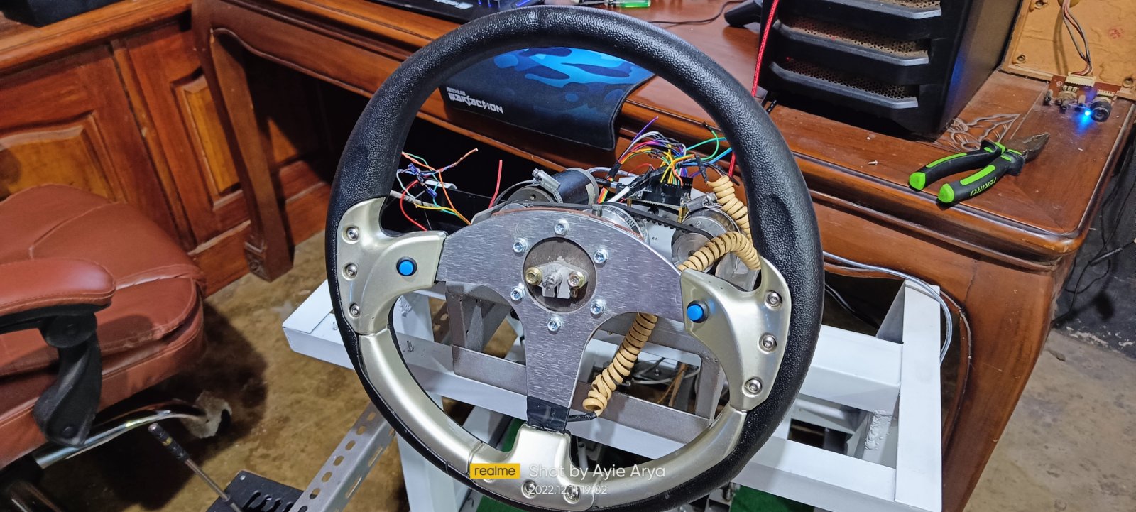

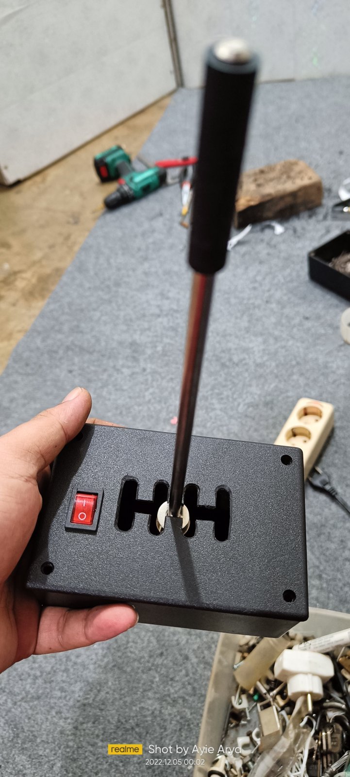

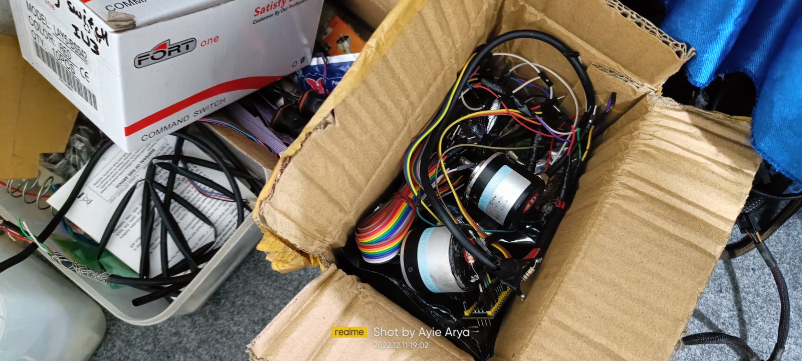

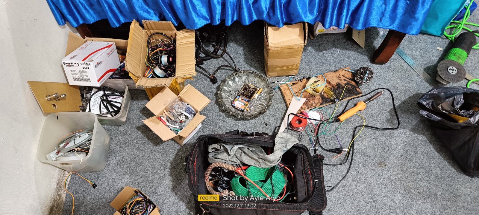

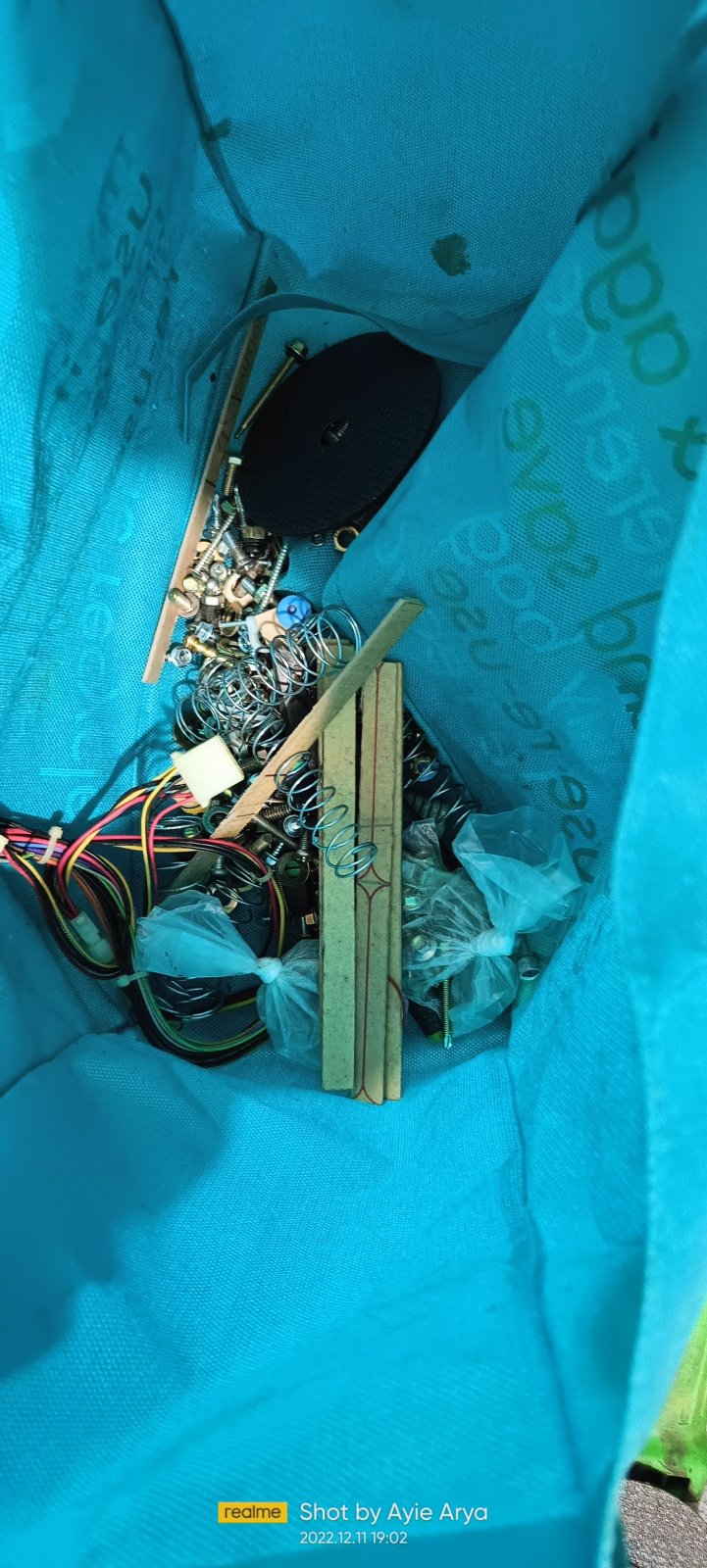

    Materials for the STEERING WHEEL and 2 DOF MOTION SIMULATOR

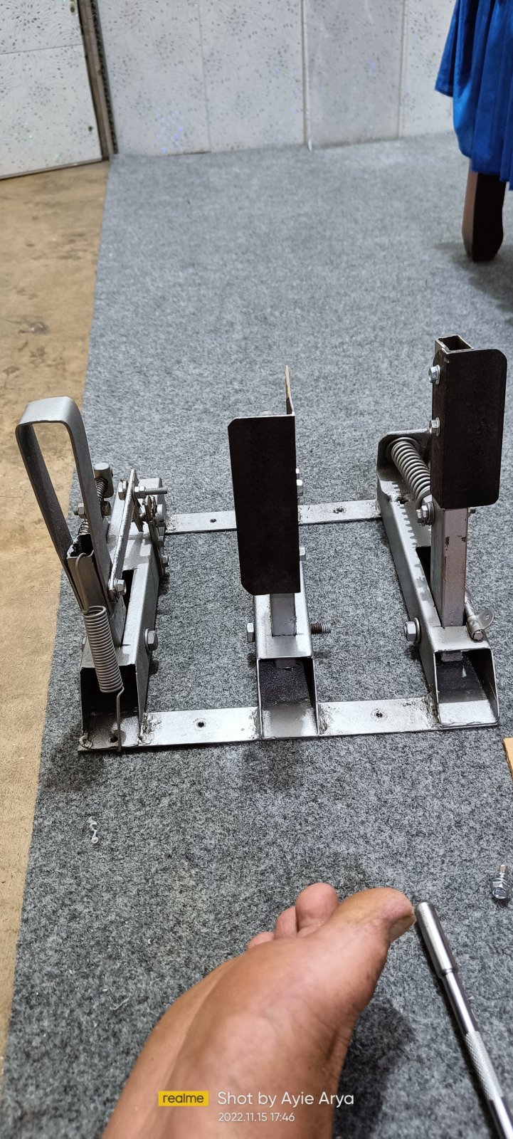

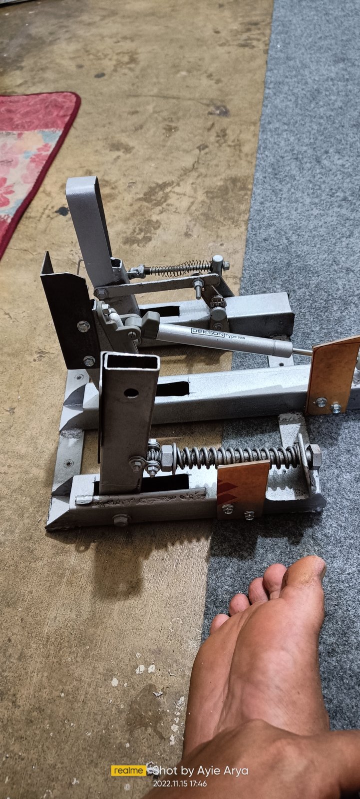

    DIY PEDAL

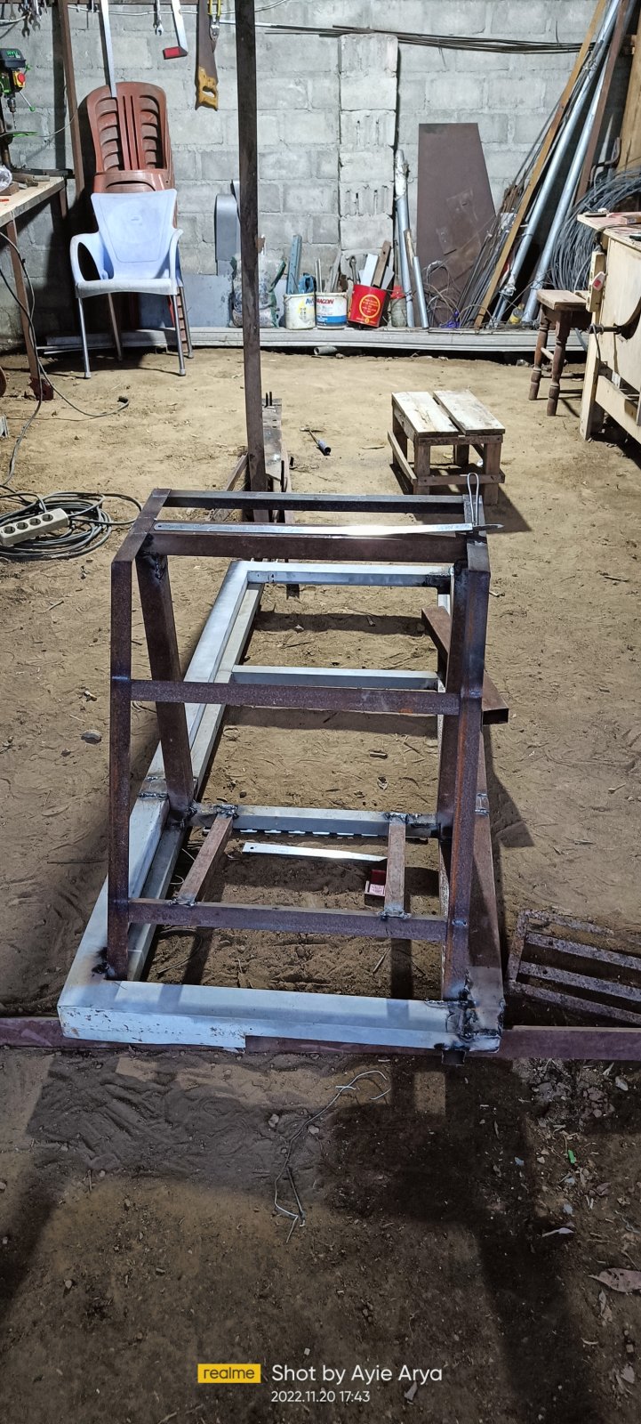

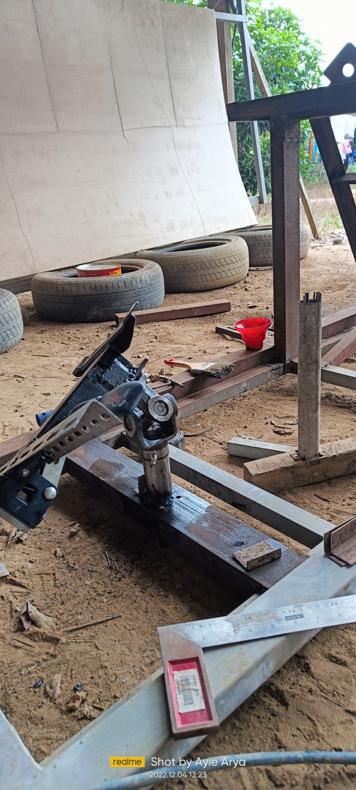

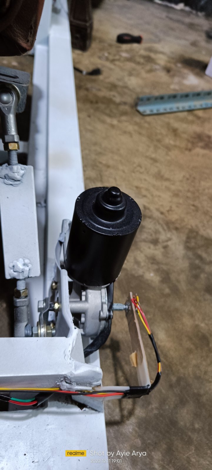

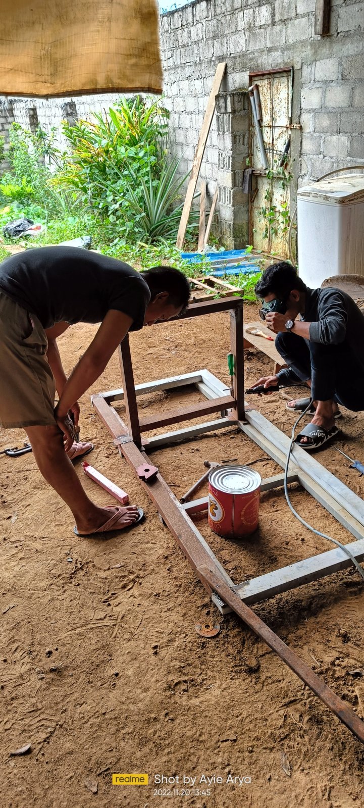

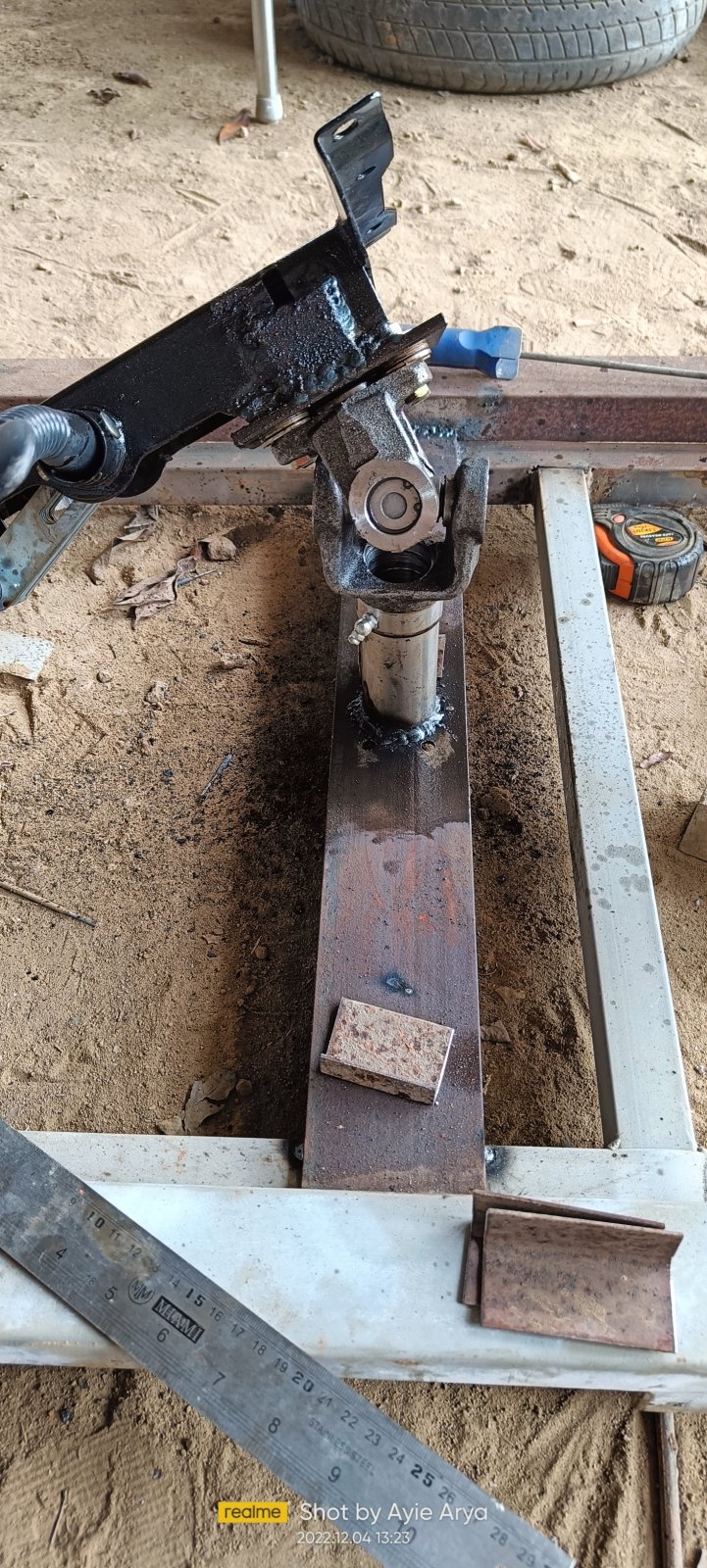

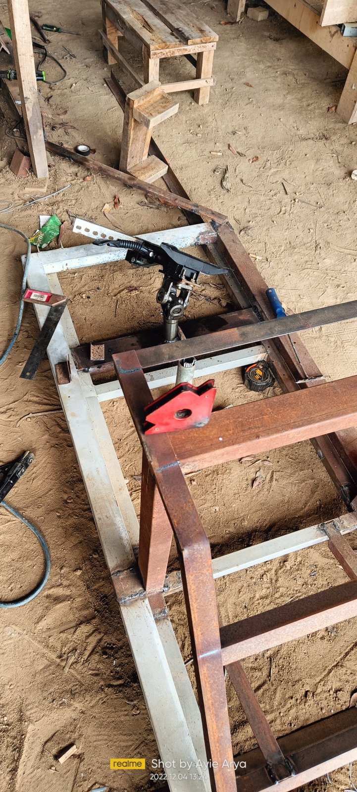

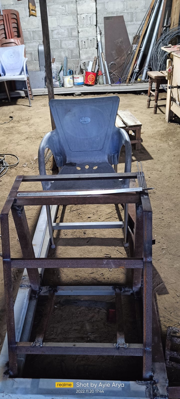

    DIY RIG 1
    RIG Build (4).jpg RIG Build (5).jpg RIG Build (6).jpg RIG Build (7).jpg RIG Build (10).jpg RIG Build (11).jpg RIG Build (12).jpg RIG Build (13).jpg RIG Build (16).jpg RIG Build (18).jpg RIG Build (8).jpg RIG Build (9).jpg RIG Build (14).jpg
    RIG FINISH
    FINISH RIG (1).jpg FINISH RIG (2).jpg FINISH RIG (3).jpg FINISH RIG (4).jpg FINISH RIG (5).jpg FINISH RIG (6).jpg FINISH RIG (7).jpg FINISH RIG (8).jpg FINISH RIG (9).jpg FINISH RIG (10).jpg FINISH RIG (11).jpg FINISH RIG (12).jpg FINISH RIG (13).jpg FINISH RIG (14).jpg FINISH RIG (15).jpg

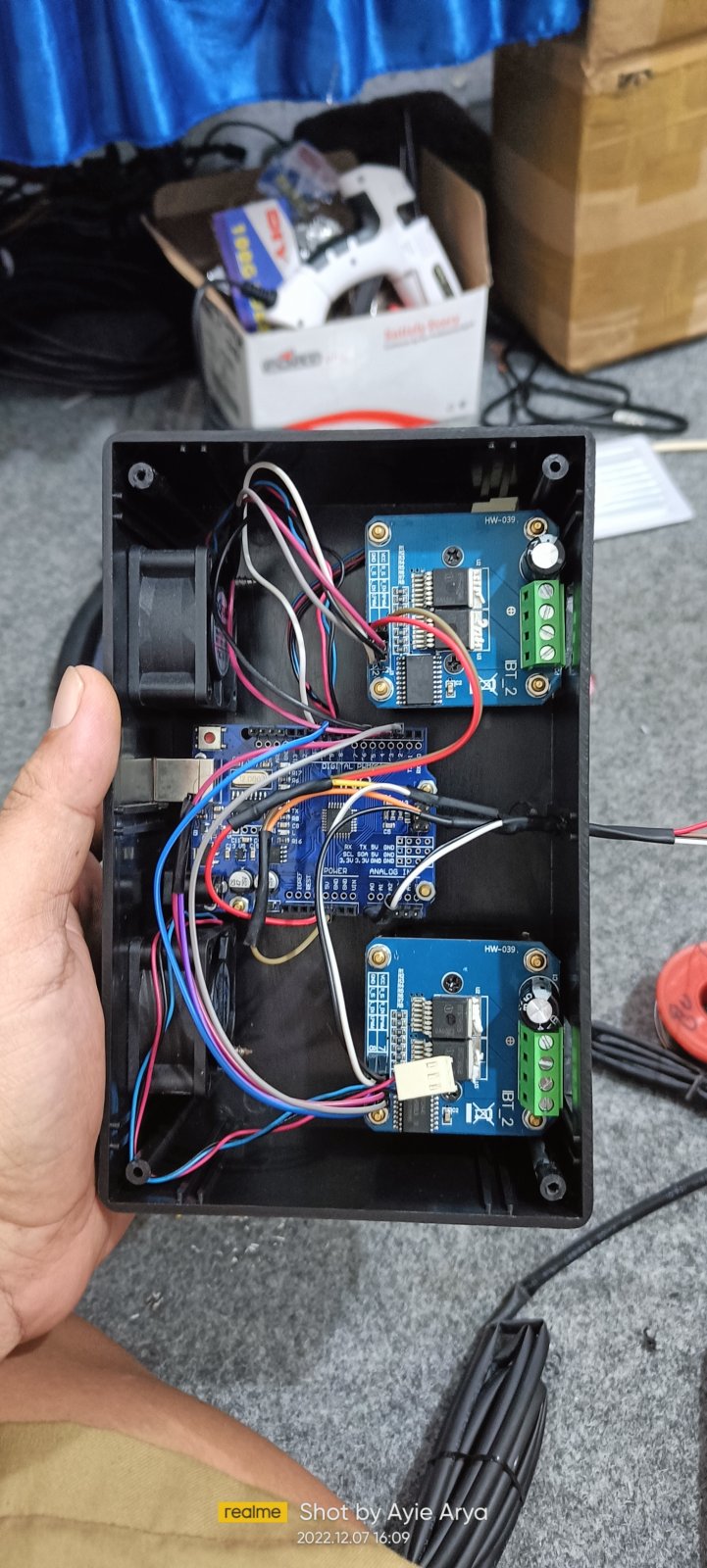

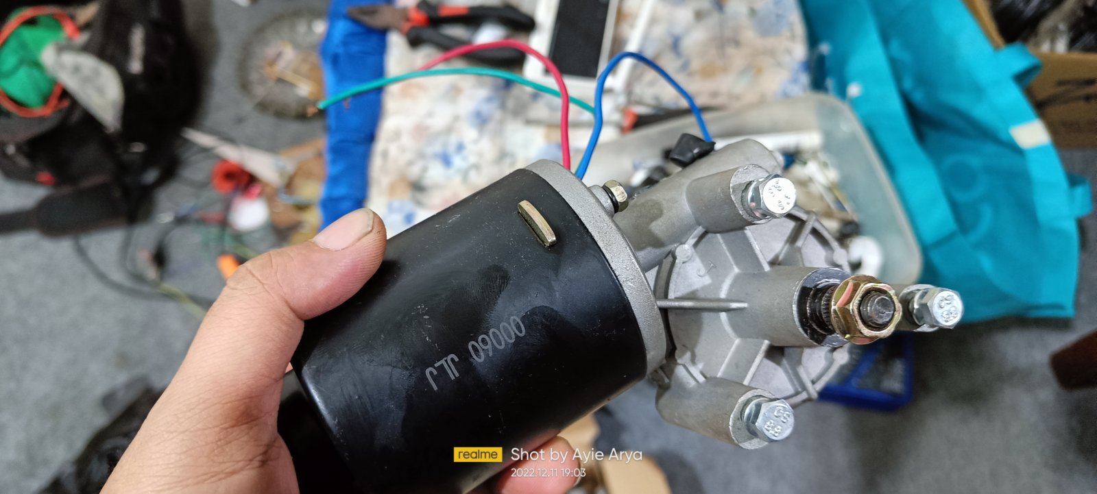

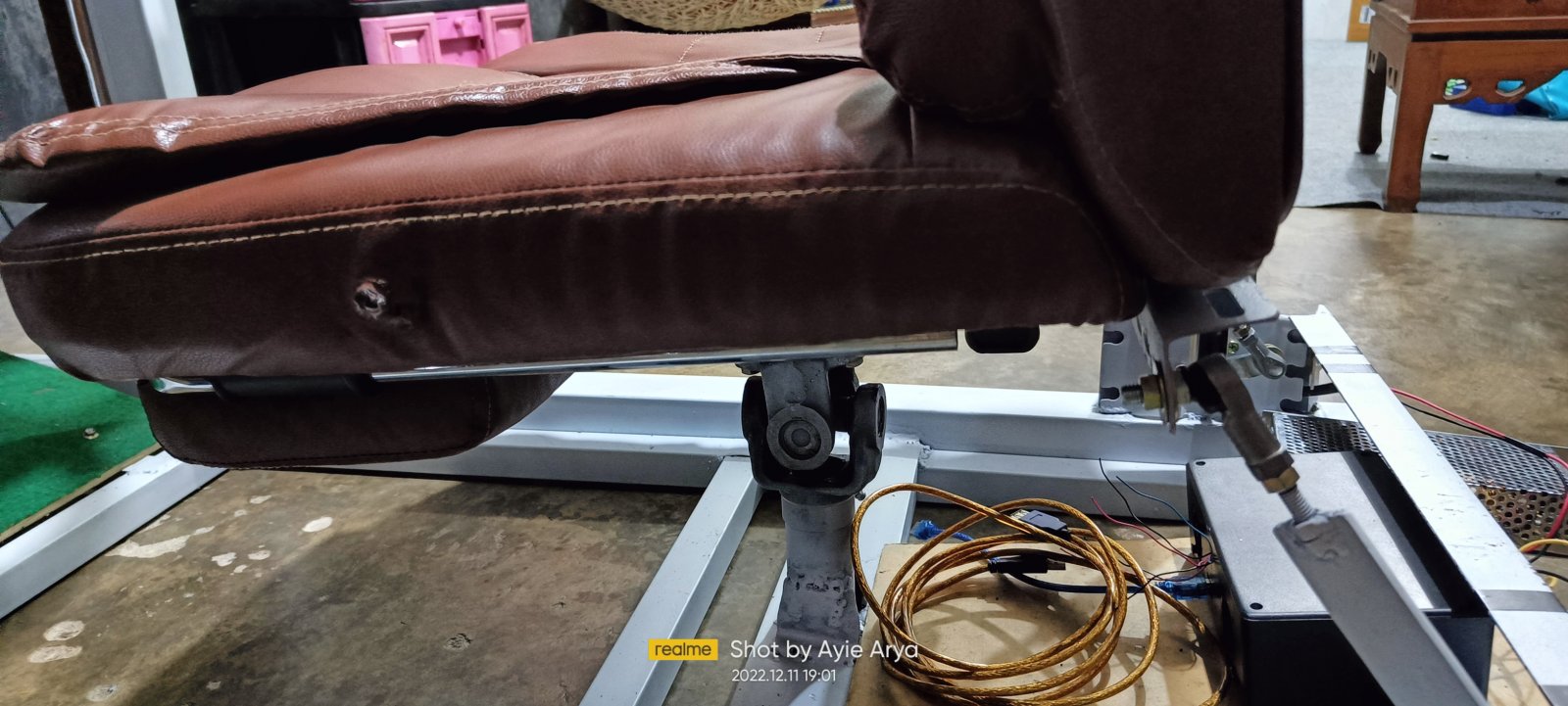

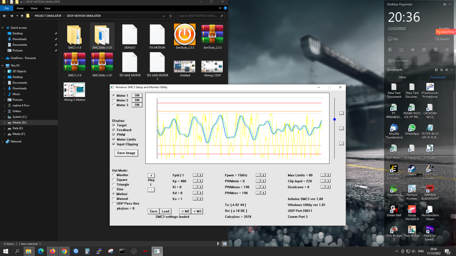

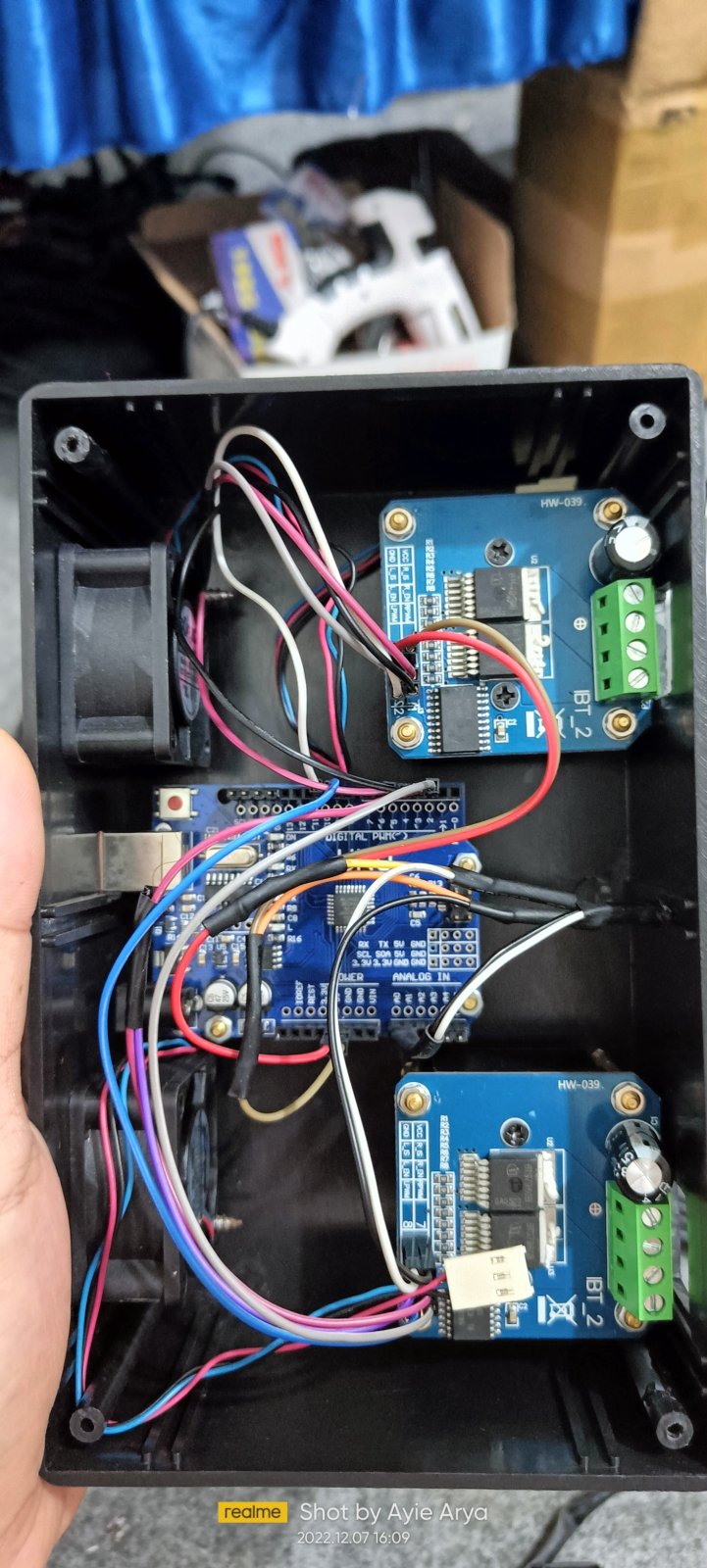

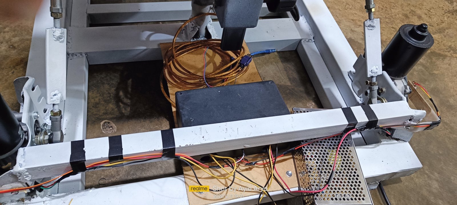

    Can you please add some detail about the hardware and software for your rig, for those who do not know what they are looking at in the photos.
    Seems to be IBT2s drive wiper motors (are they ground isolated?) I presume using SMC3 for the Arduino, is that correct?

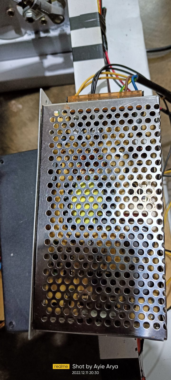

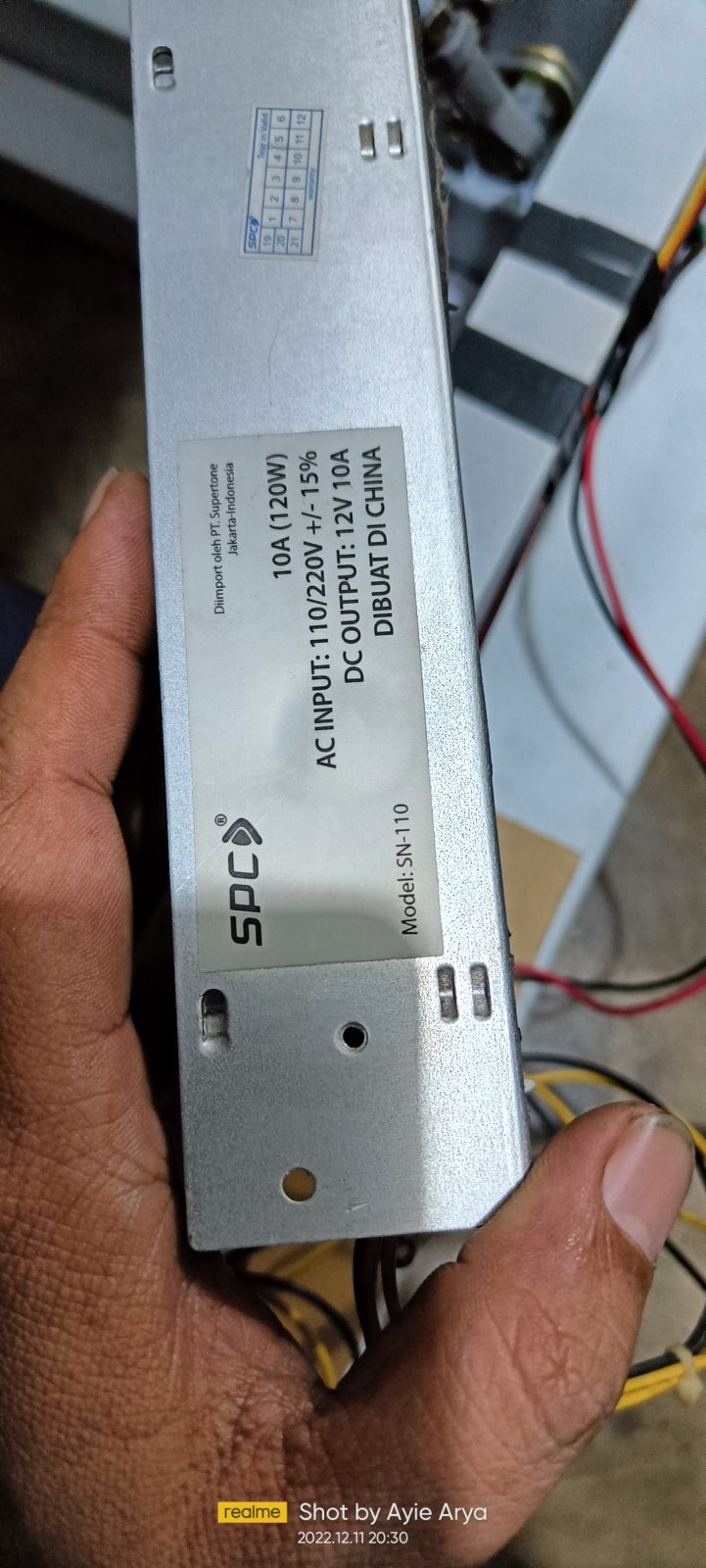

    What PSU(s) are being used?

    1. Hardware Use
    Arduino Uno R3 and PWM Driver IBT 2 ( BTS 7960 ) and put them hardware on 1 box panel

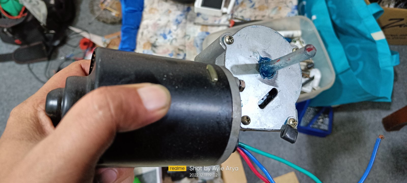

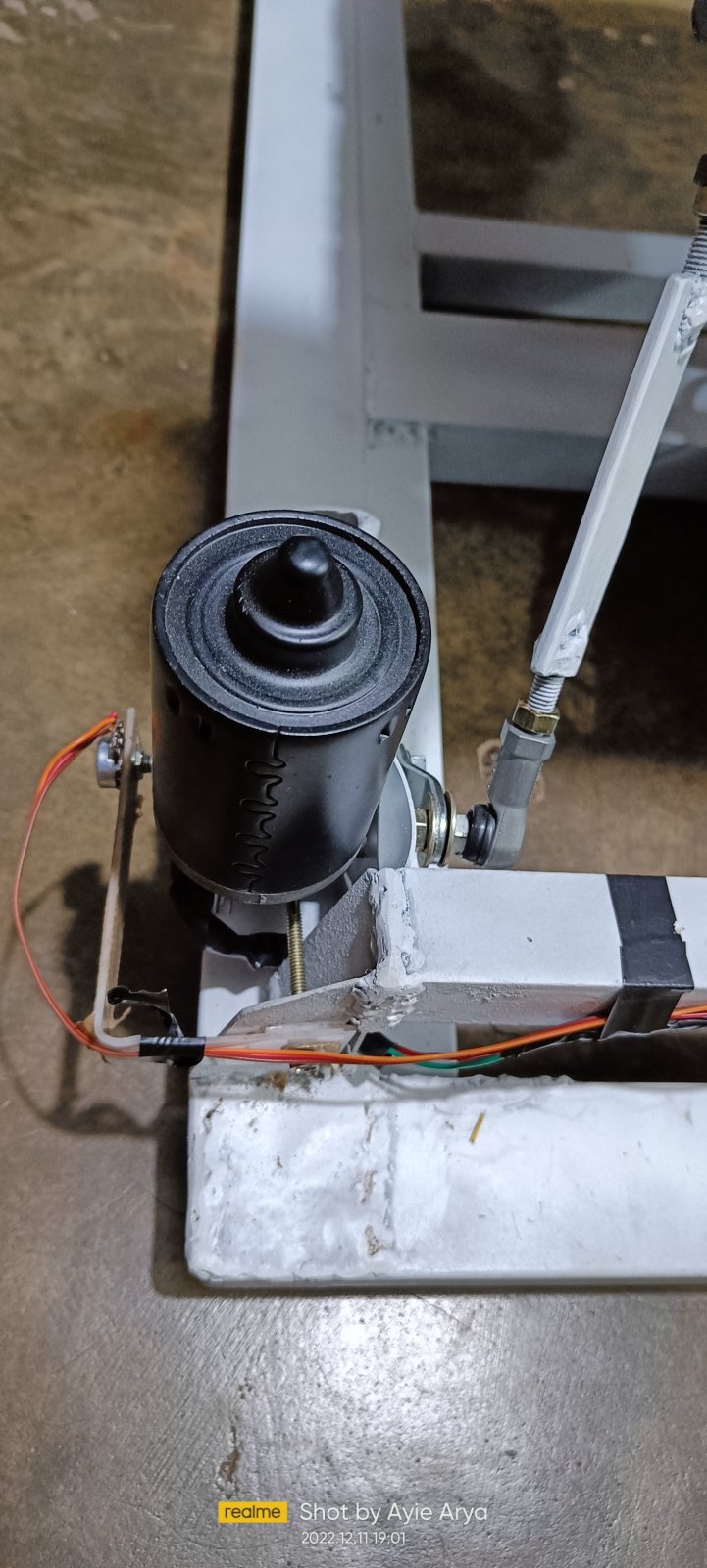

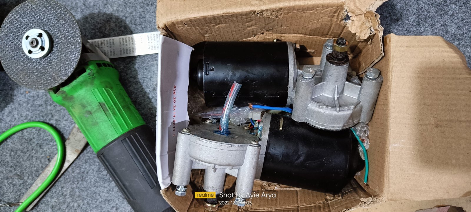

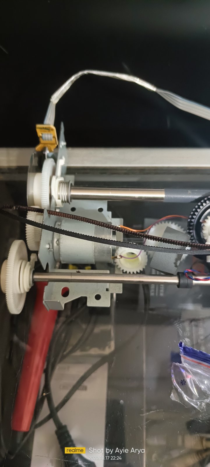

    2. Wiper Motor Use From Car Wiper Mitsubishi L300 Series and YES Ground Isolated ( ground isolate forget to take picture
    3. Power Suply use 1x CCTV Power Suply 12volt and 10 ampere

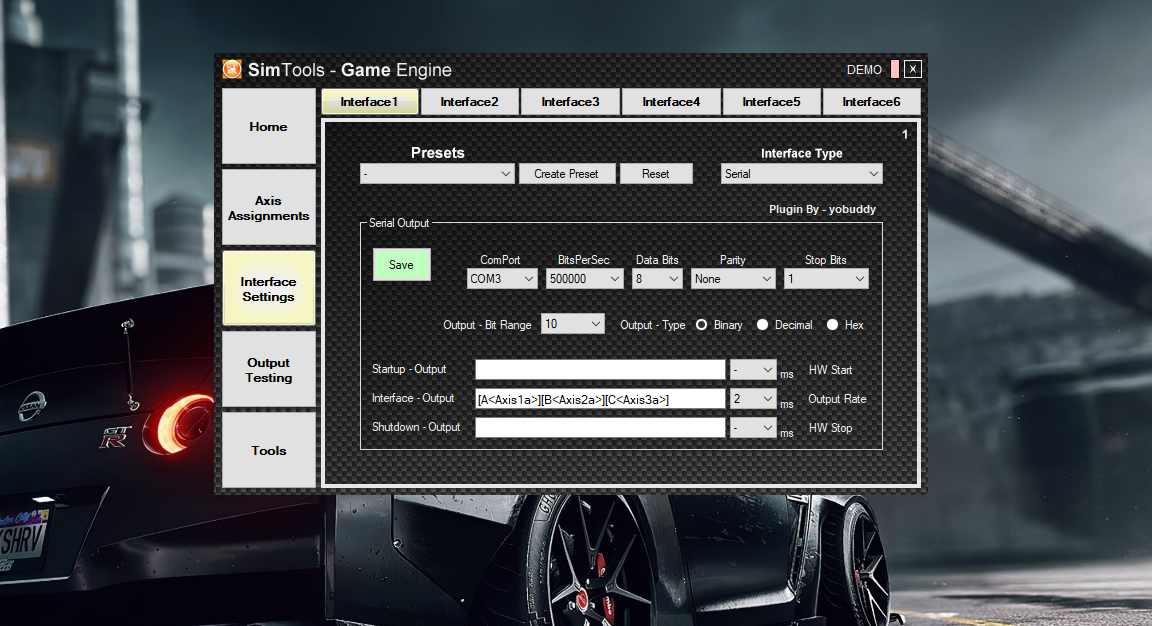

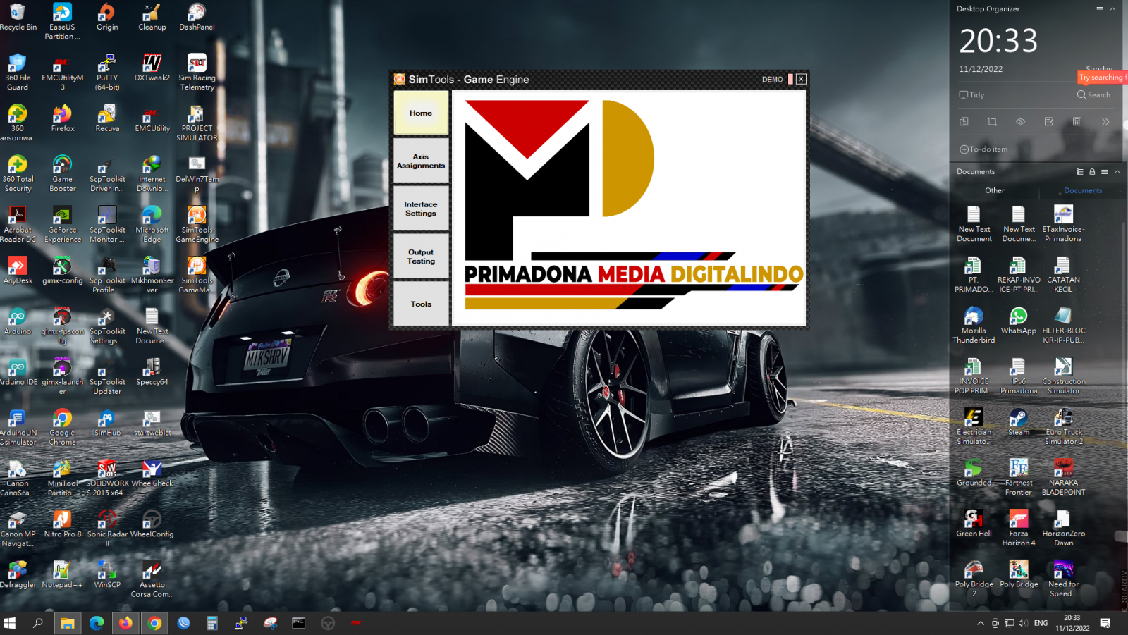

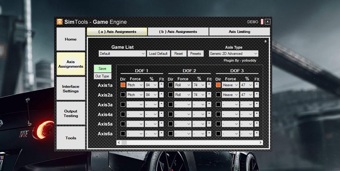

    SOFWARE USED : From This Forum
    1. SMC3 V1 Arduino Uno Edit MODE 2 ( because use IBT 2 / BTS 7960 PWM )
    2. SMC Utils V1.01 ( from this website )
    3. SimTools V 2.5.5
