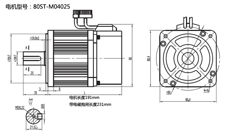

    Cool. Can we use those servomotors in cranked systems?
    Are they fitting in nema34 flange ?
    What’s their max speed and continue and peak torque curves ?

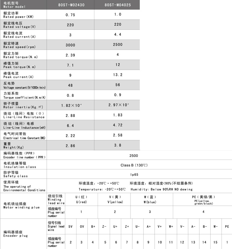

  8. Trip Rodriguez
    Trip Rodriguez VR Pilot
    May 8, 2016
    683
    Lake Ariel, Pennsylvania
    3,977Coins
    +331 / 7 / -0
    I believe they are NEMA 32, I think some people have used them for cranked but I'm not 100% certain. Attaching an image with specs, I cropped it to show the specs only for the motors most of Thanos AAMC users are using, and the more powerful ones I purchased. I got the set of six for $1,600 USD including shipping and tax!
    Specs:
    Dimensions:

    @Dirty @Thanos @hexpod Thanks for the info and the reassurances guys.
    I'm hoping the PWM noise won't be as bad as my current setup, but I can just drown it out with audio from the simulator regardless.
    Aside from that the value for the money seems incredible with Thanos' recommended setup here. Lots of power, basically plug and play, and with no need for external sensors all for this kind of money is great! Clearpath look fantastic, but to get the same kind of power I think it would have cost me about $2,500 more to go that route.
    @Thanos what I was looking for with this RAS thing was to get rid of the "jerk" at the beginning of a big simulator movement. Hopefully I'll be able to do this with the FlyPT/Simtools/HeXpod filters once I get my AASD rig built. The whole reason I'm building a new sim is to get it silky smooth, my first one works well otherwise.

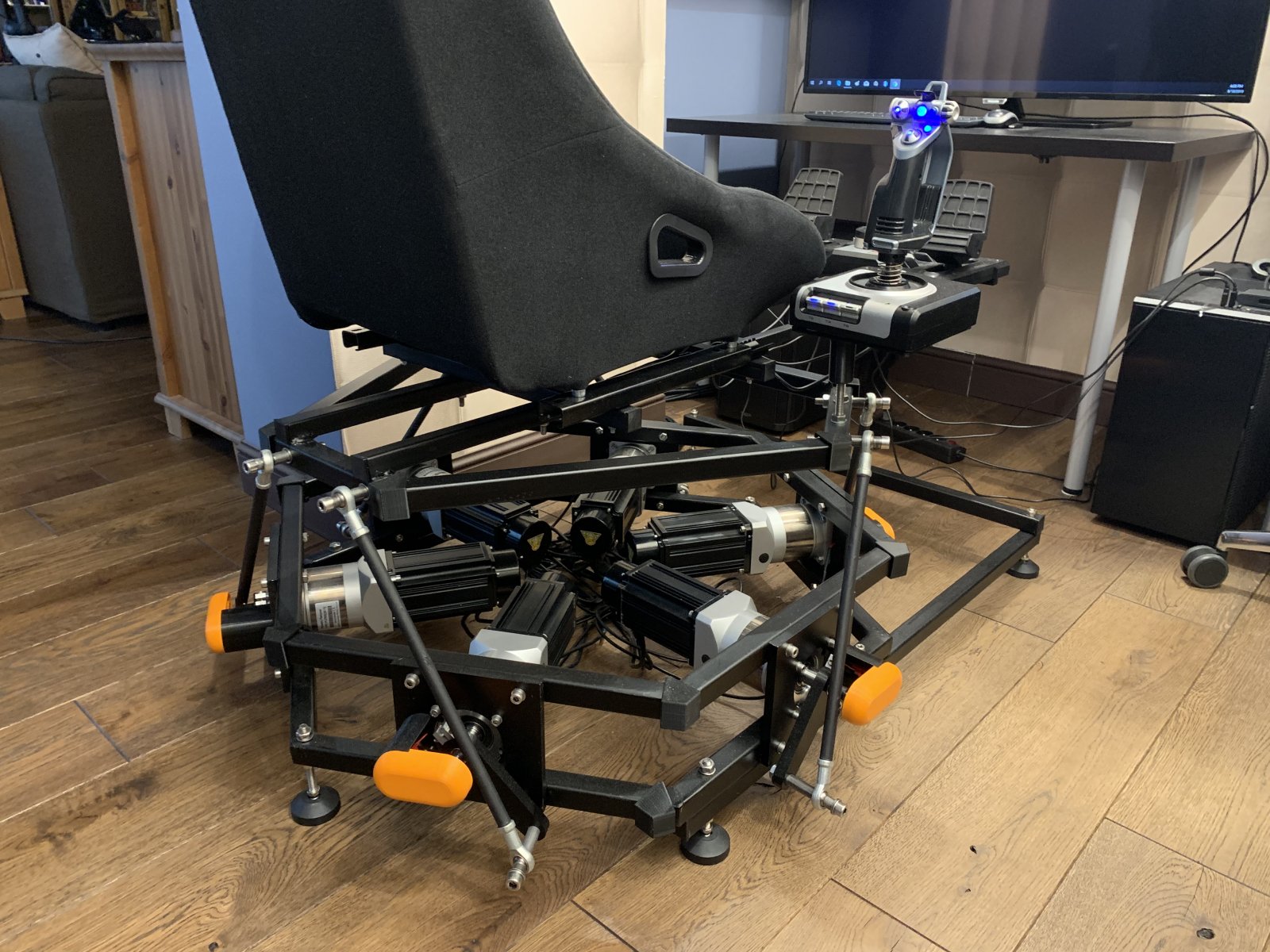

  11. Thanos
    Jul 6, 2017
    1,373
    Electronics Engineer
    United States
    2,871Coins
    +1,075 / 10 / -0
    Also its totally doable with planetary gearboxes, see a photo of a rig with similar servomotors (but other controller that needs feedback).
