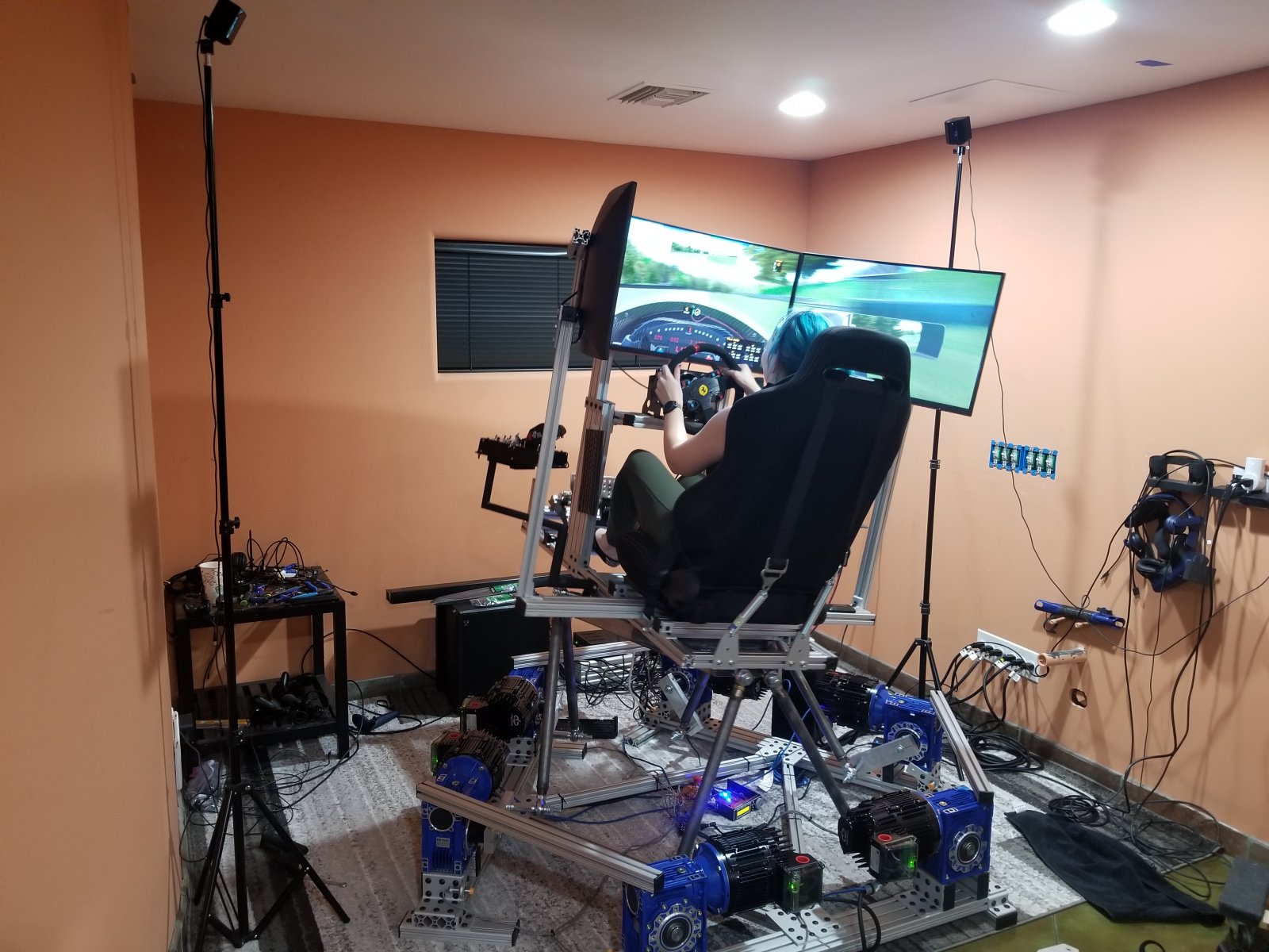

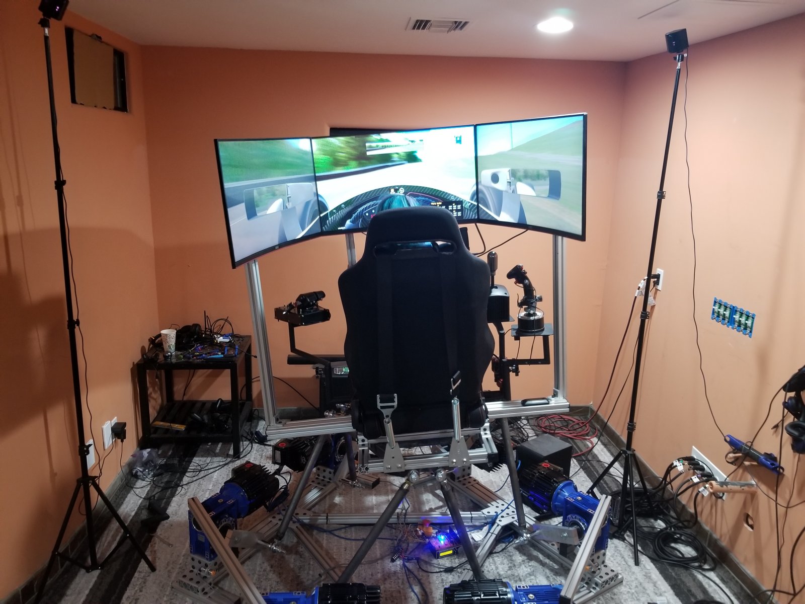

  12. Nisch
    Nisch Member Gold Contributor
    Feb 20, 2019
    56
    Technically retired software developer
    Phoenix, AZ
    293Coins
    +125 / 0 / -0
    Motion platform, 6DOF
    Got all three monitors mounted, flight controls added and moved it into the corner where it will reside. Still have more tweaking to do, but it's getting much better.

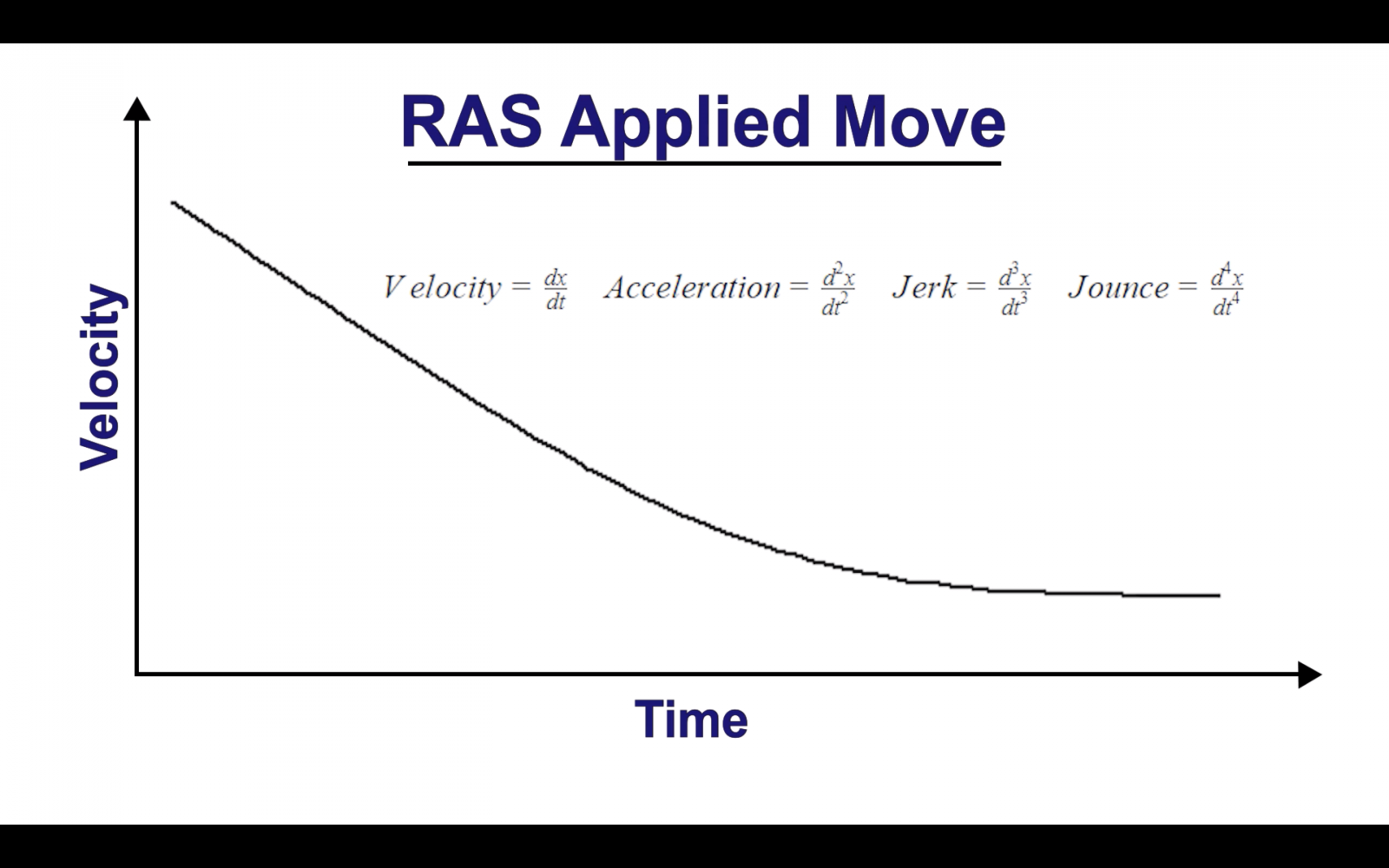

  19. hexpod
    hexpod http://heXpod.xyz
    Apr 18, 2016
    1,207
    berlin
    7,770Coins
    +375 / 5 / -0
    DC motor, 6DOF
    The most important in my setup was the right RAS delay vs acceleration.
    I would definitely spend time to play with it.
    I set the RAS at 40 ms and was able to increase the acceleration to a crazy 40.000 RPM/SS making the motion stable and smooth.
    More about the feature here:
  20. Dirty
    Oct 15, 2017
    746
    All the way up front.
    7,963Coins
    +884 / 3 / -0
    That's a very good video! I think more people should try to understand exactly that:
    In the thread on my software I talk about these very curves and the calculations are actually already in Nutkicker :)
    FlyPT_Mover has them too, if you select the right filters for the right DOF :thumbs So, even simple BLDC motors will get a certain amount of jerk- and jerk-derivative smoothing.
    As far as I understood, the deadband should be set to zero for motion simulation.
    Prost,... Dirty :cheers
