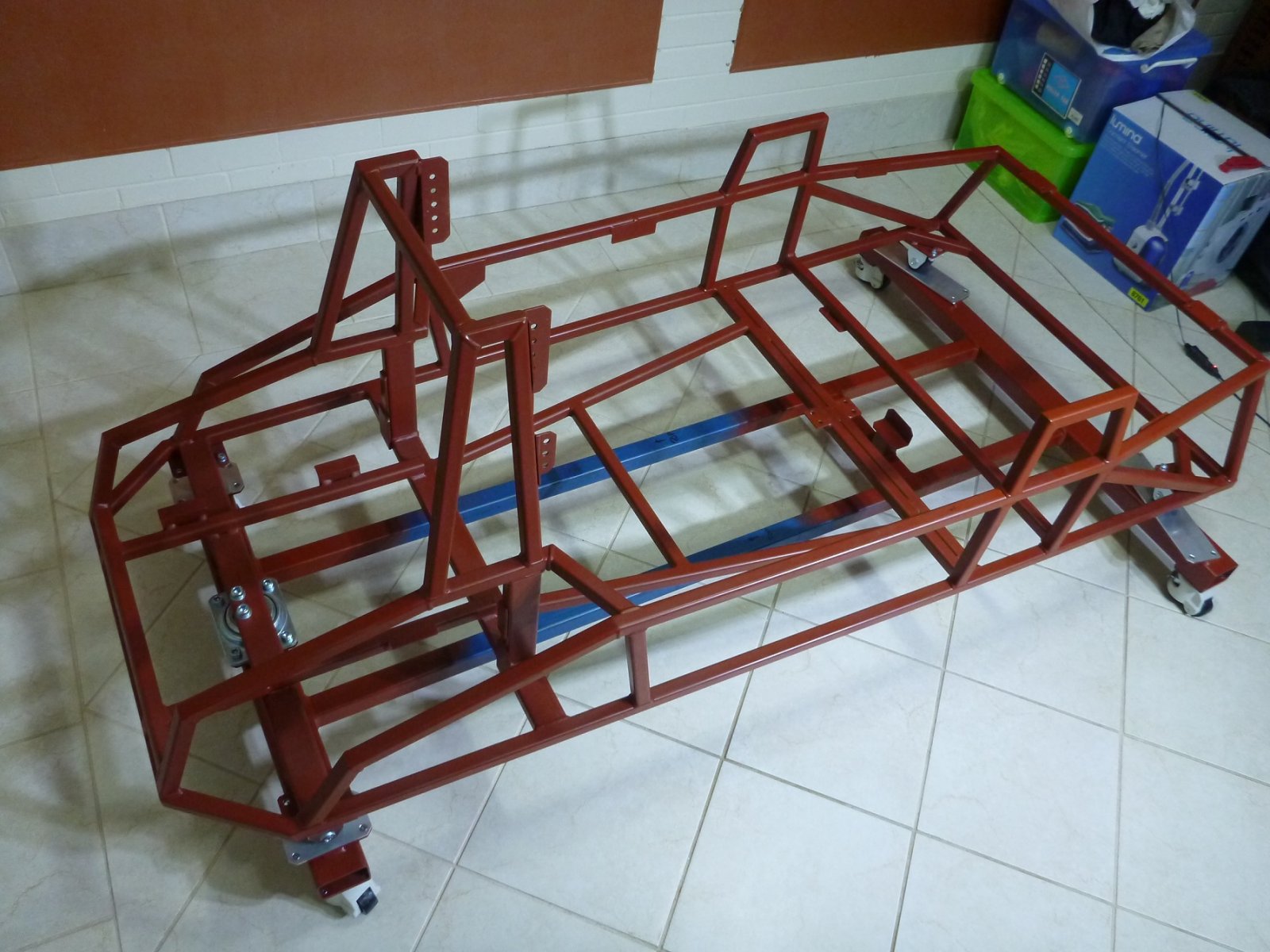

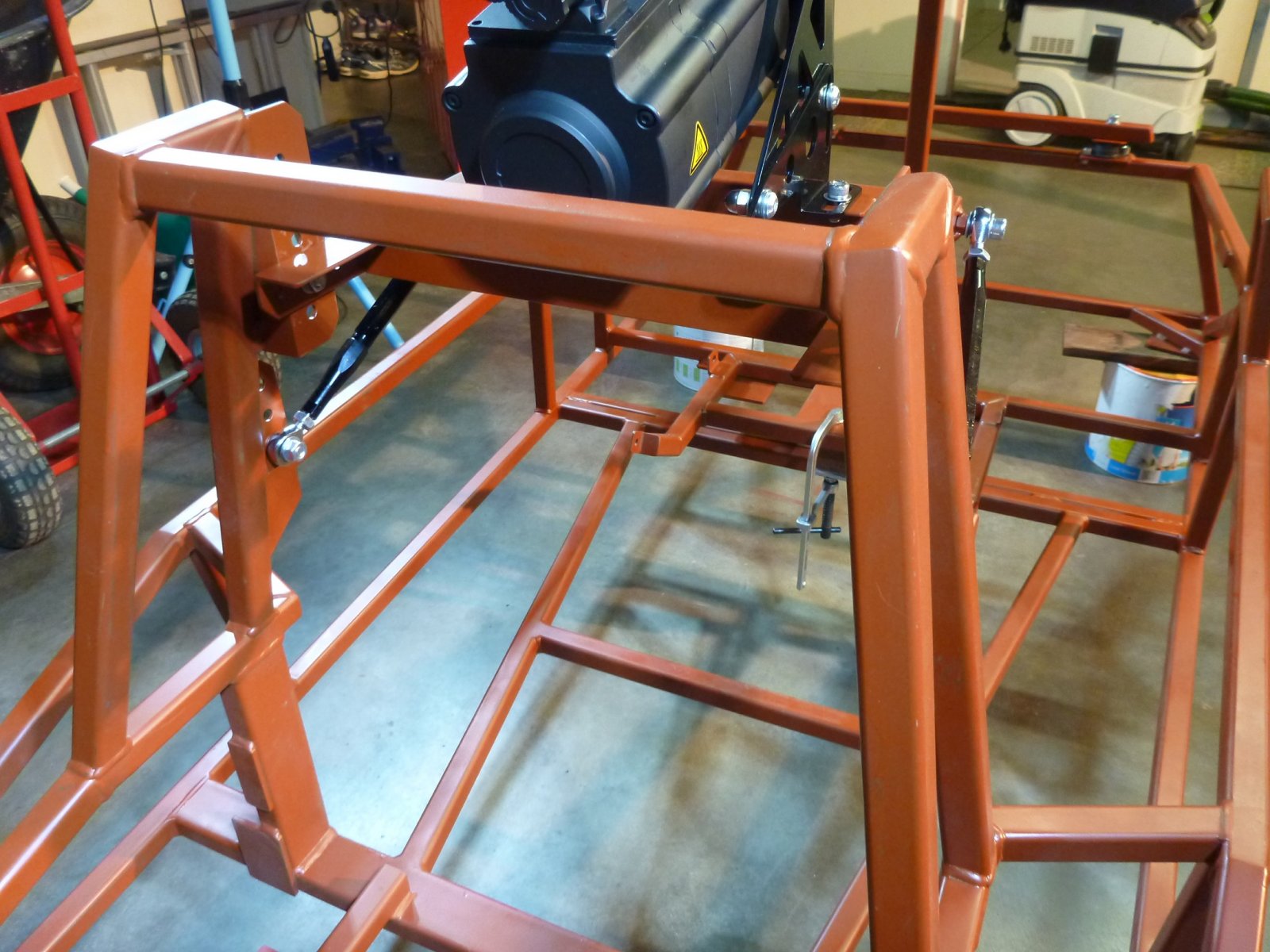

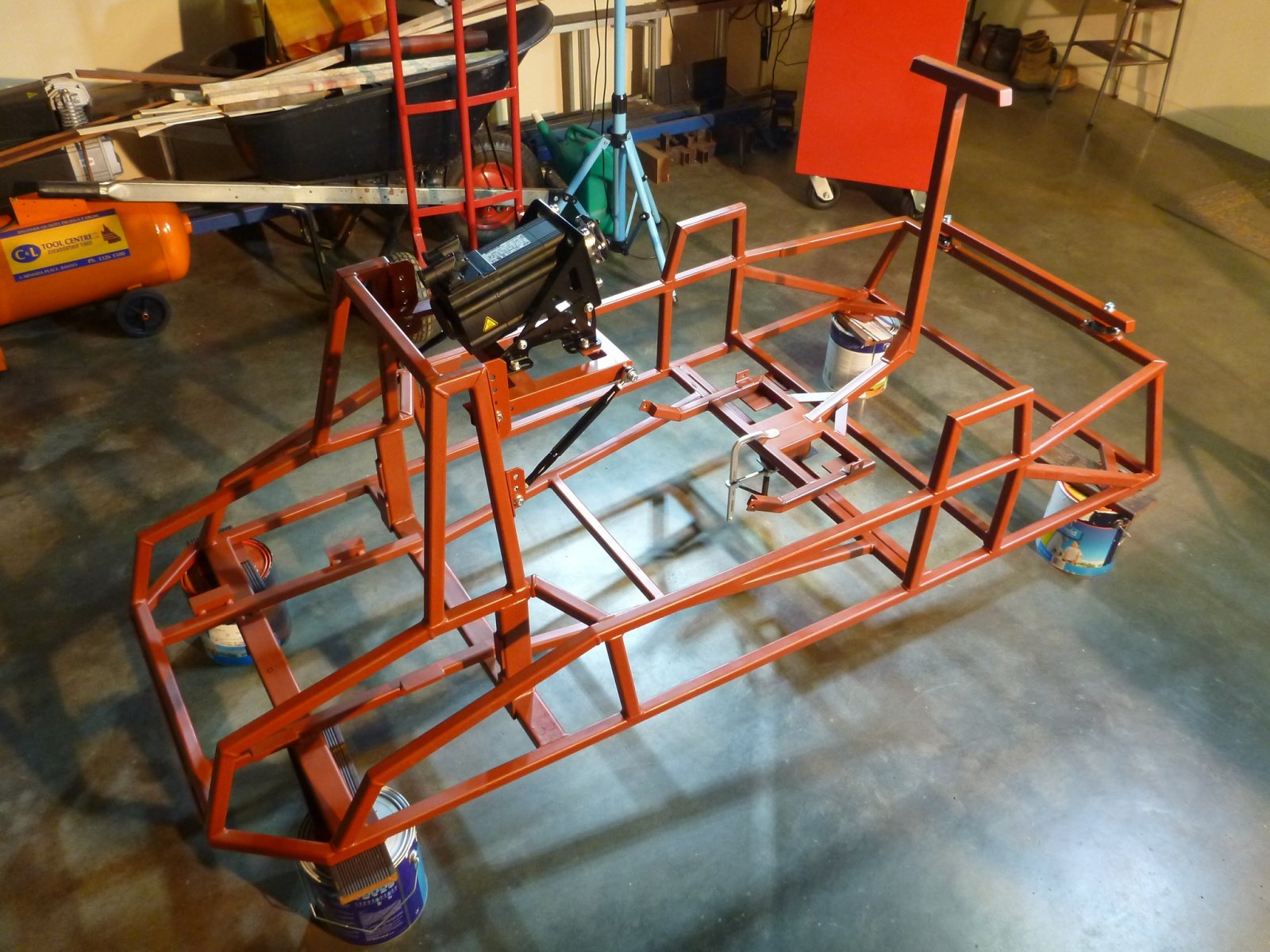

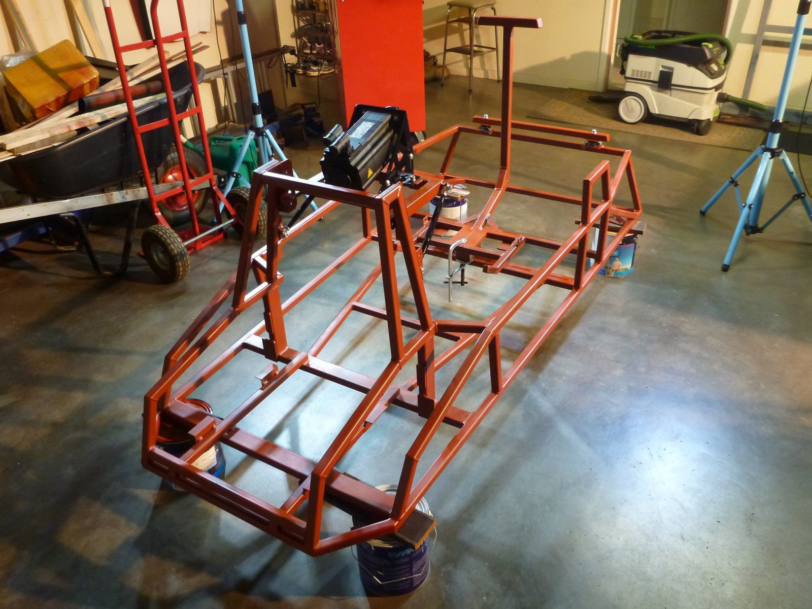

    There's plenty of distraction in my life, but my project is still alive :)
    I got myself an OSw in the meantime as well.
    Here the latest pics:
    The whole thing is extremely solid.
    Color is not final, just primer.
    Now I gotta shorten the Simx mounting and dampening kit, fit the steering knuckle under the seat and then we're getting started on the base frame for rear traction loss.
    That one is pretty simple by comparison so I'm not too far off anymore :)
    Cheers

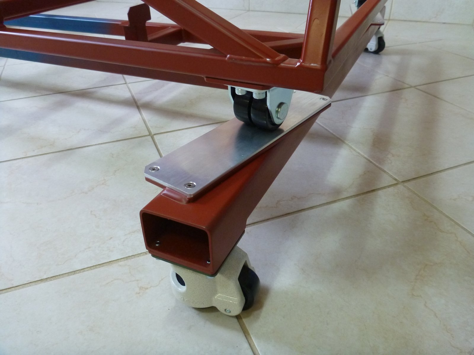

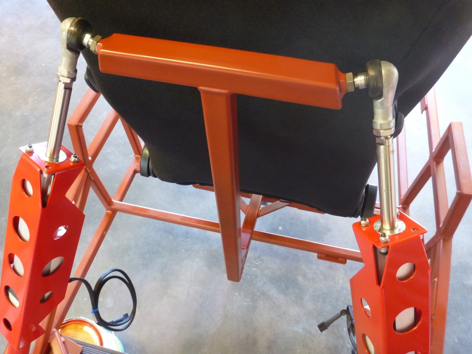

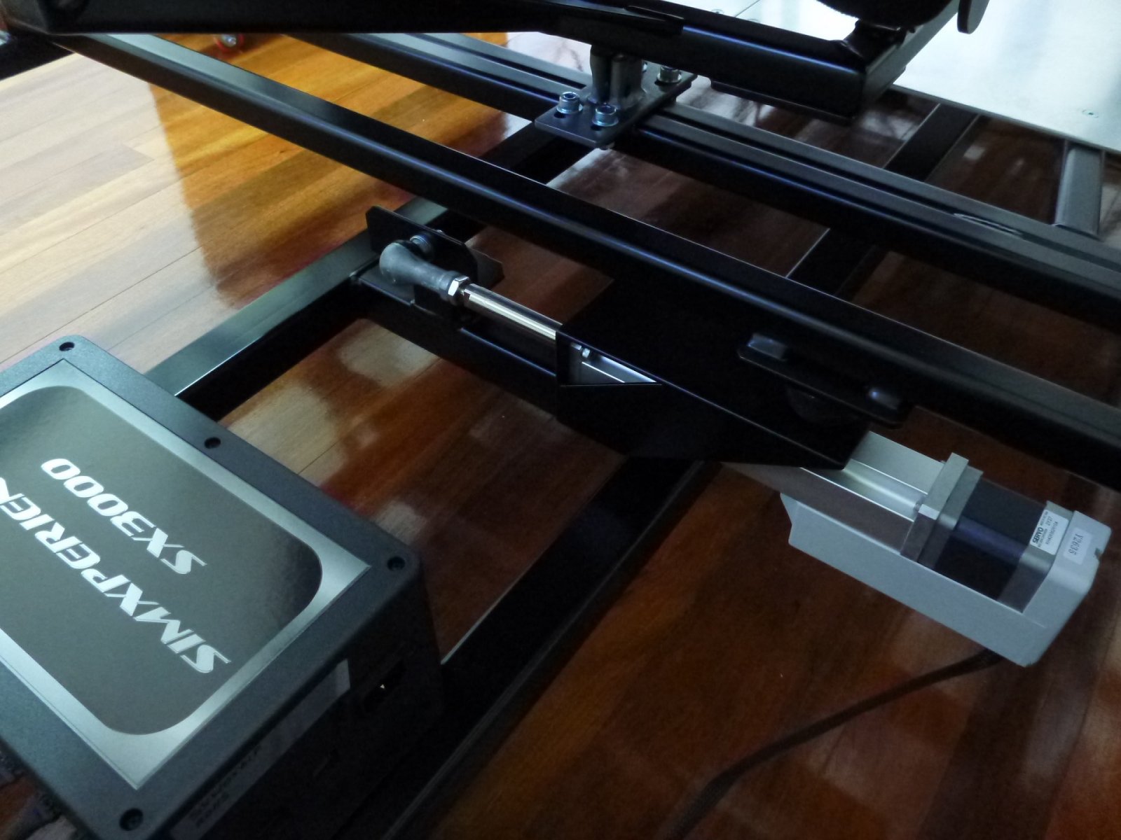

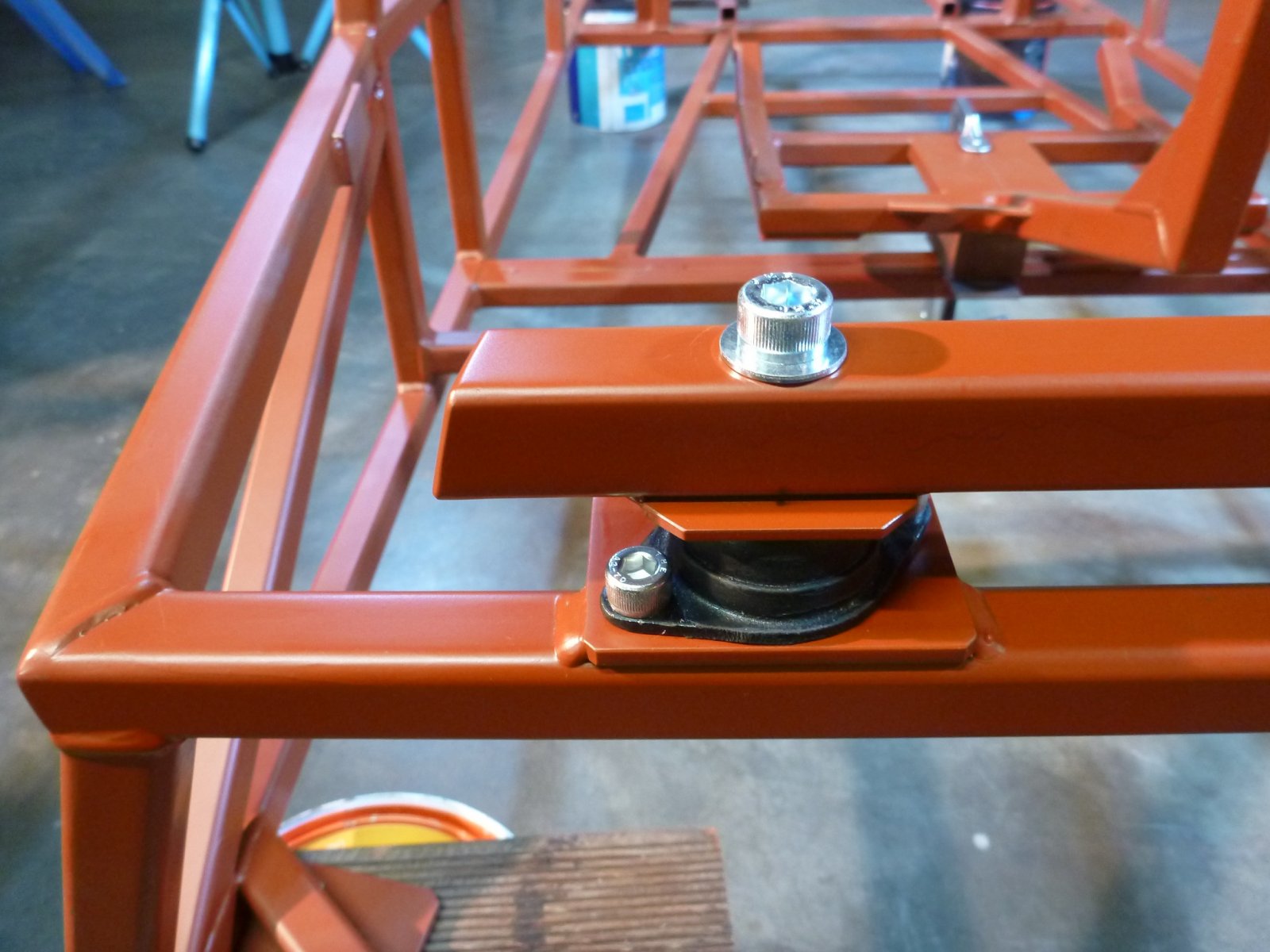

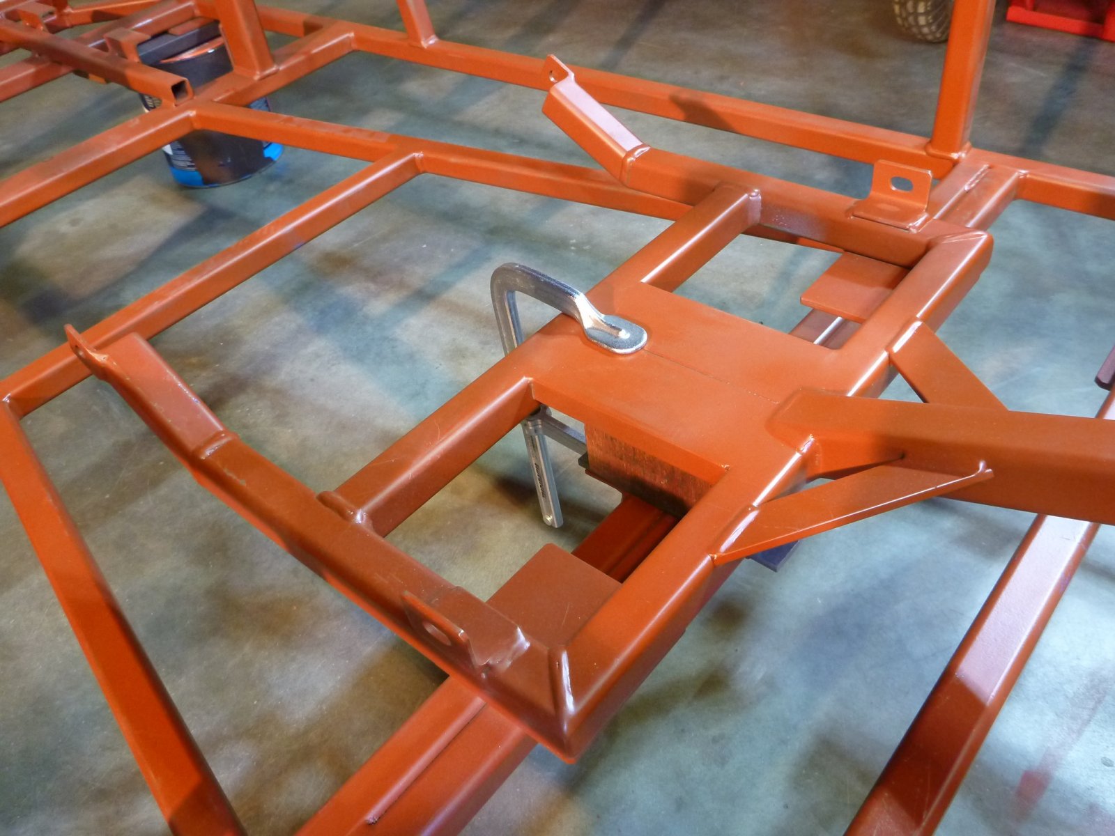

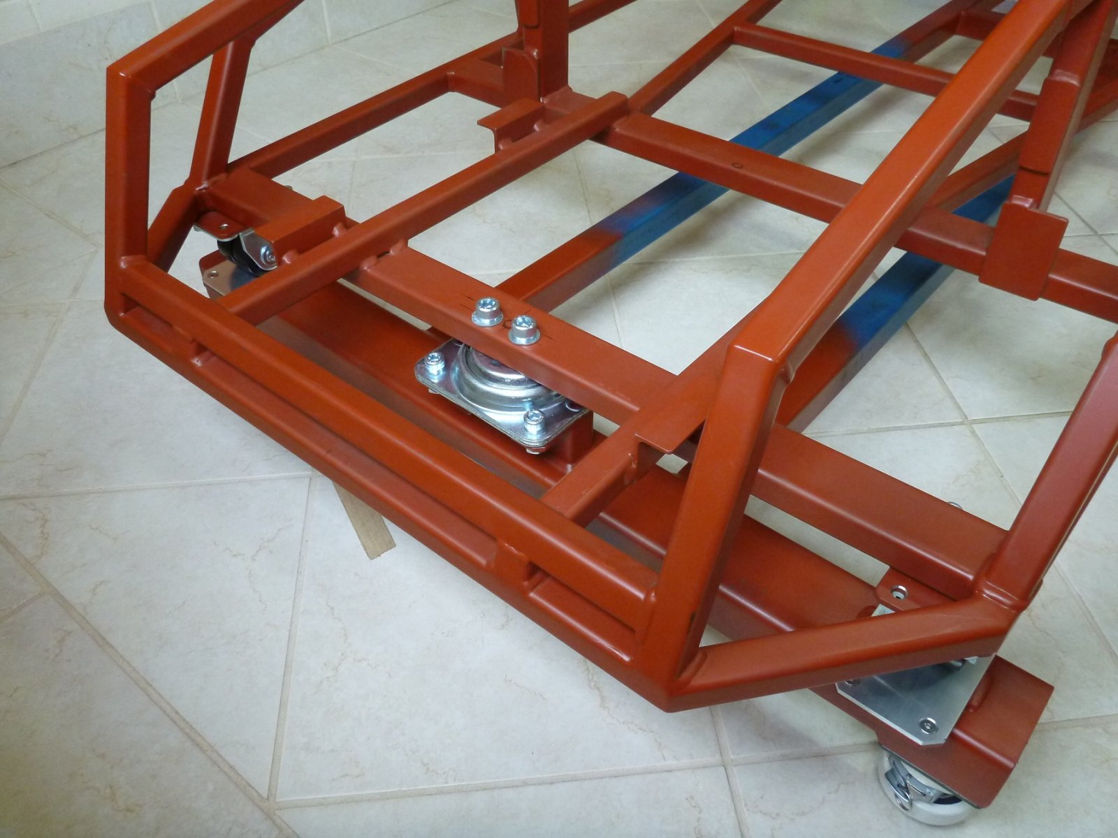

    The actuator mounting kit has been shortened and that means the main frame is finally and I started working on the base frame.

    Nice craftsmanship :thumbs

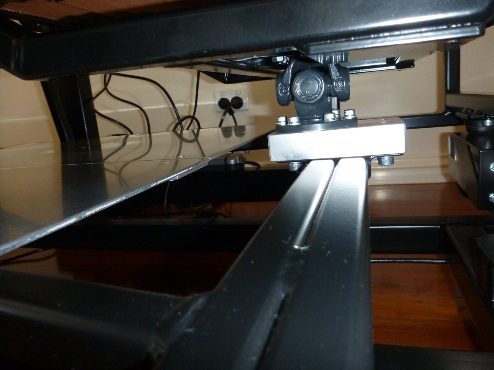

    How thick is the plate that the base of the universal joint bolts to? It is going to be subjected to some significant force.
  11. Thirsty
    Thirsty Member
    Jul 14, 2013
    85
    Brisbane
    593Coins
    +54 / 0 / -0
    Cheers mate.
    It's actually not a plate, there are two pieces of angle steel welded on both sides of the double cross member. They are 3mm thick. The plate on the joint is 5mm. They are bolted together with 2 M8 bolts either side. So a deformation of the angles on the main frame would affect the 5mm joint plate as well. It's pretty much 8mm of steel which is dealing with these forces...hope that will do :)

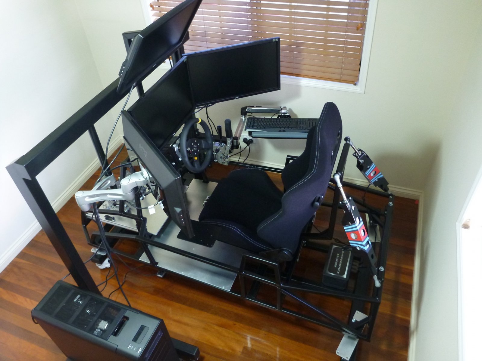

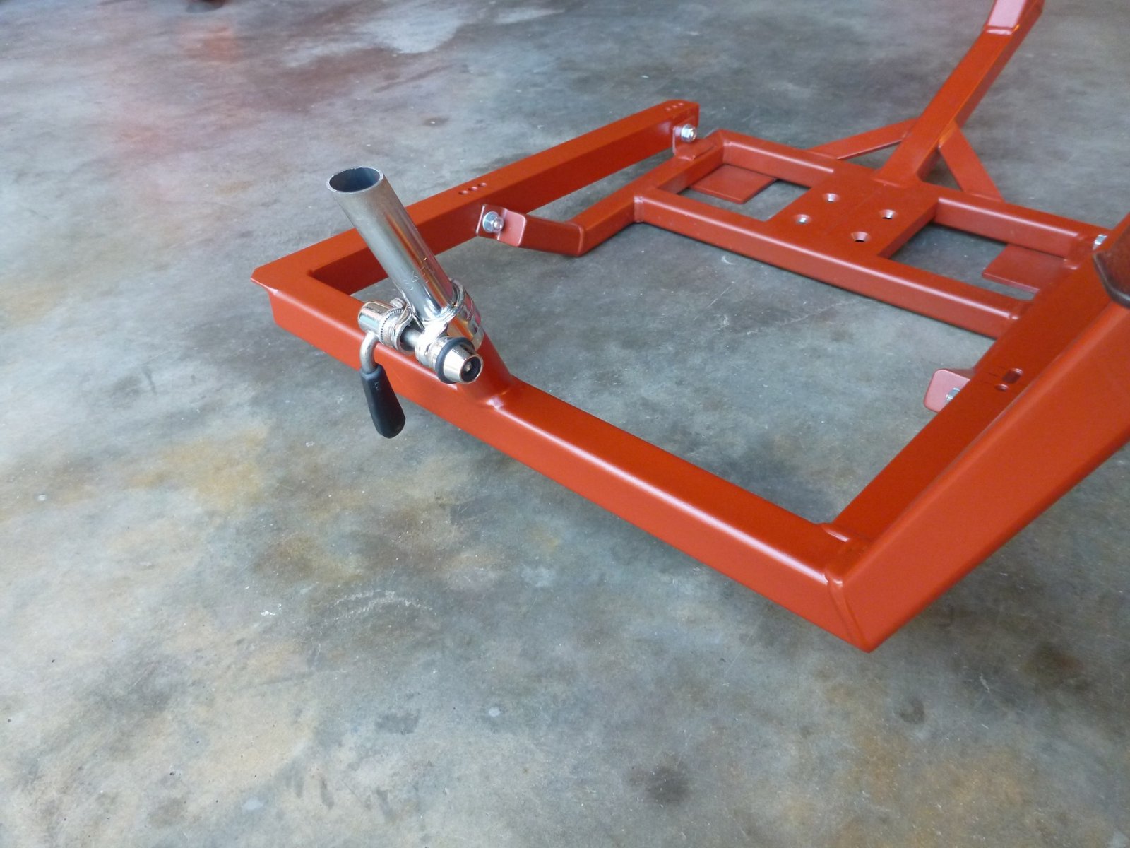

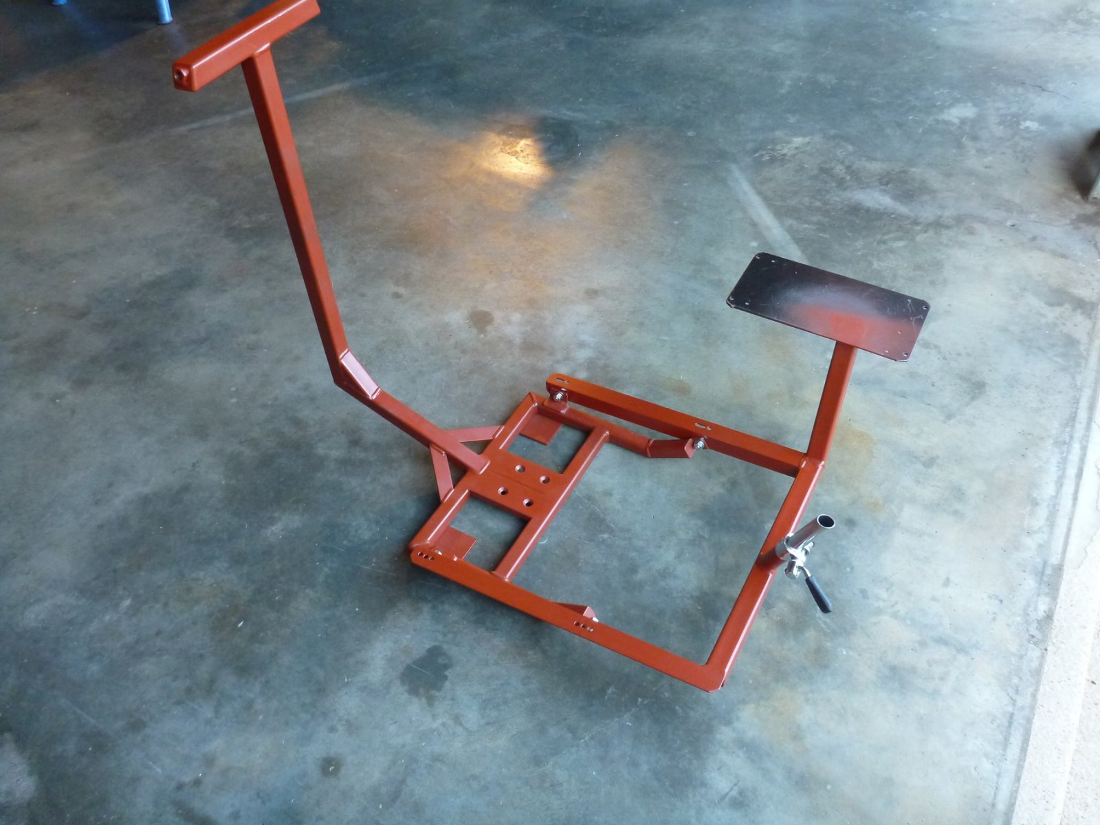

    The base frame is done. I decided to make this rig a flight simulator as well. So I had to sort out position and mounting of the joystick and throttle. It seems to me it's the best fitting that to the seat mover frame.
    I got myself the TM HOTAS Warthog. The throttle is gonna be installed permanently and the joystick will be mounted after accessing the rig.
    P1000839 lres.jpg P1000844 lres.jpg P1000845 lres.jpg P1000863 lres.jpg P1000865 lres.jpg

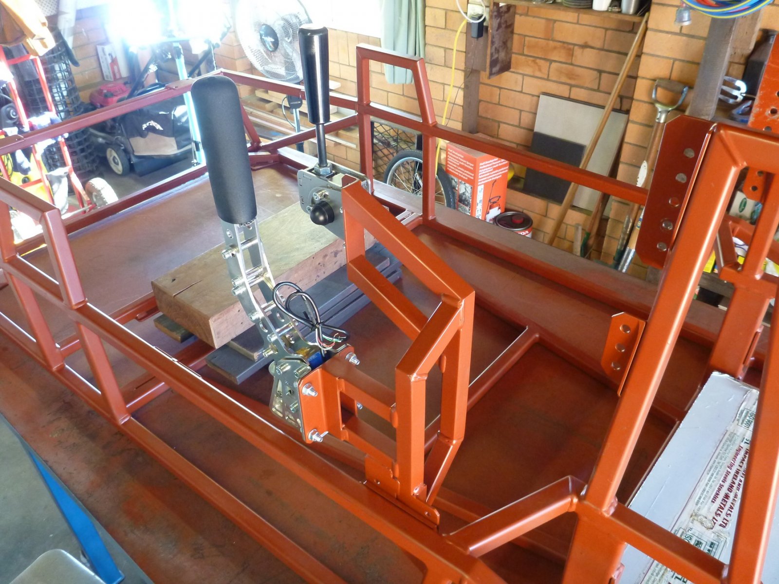

    I am a bit embarrassed about not being able to come up with the completed rig, but I can finally say the rig is done...except the powder coating I mean.
    So I'm working on the quad monitor stand now and it won't be long and it's all done.
    Here the latest bit, the bracket for my handbrake and sequential shifter:

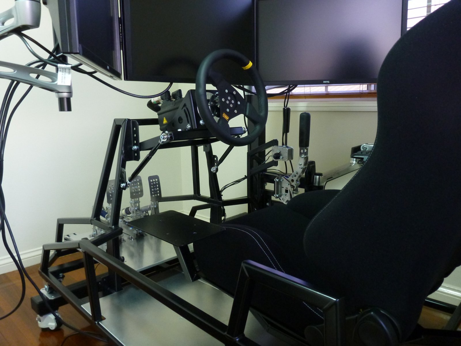

    I got an aluminium plate for the pedals done as well - 10mm, so it's pretty robust.
    There will be the rudder pedals mounted on it as well, but only if I use my rig as a flight sim. For that I'll slide the pedal plate fore by approx. 150mm. Camlock screws will be used for that - so no tools required.
    The change from racing sim to flight sim should only take about a minute or two.

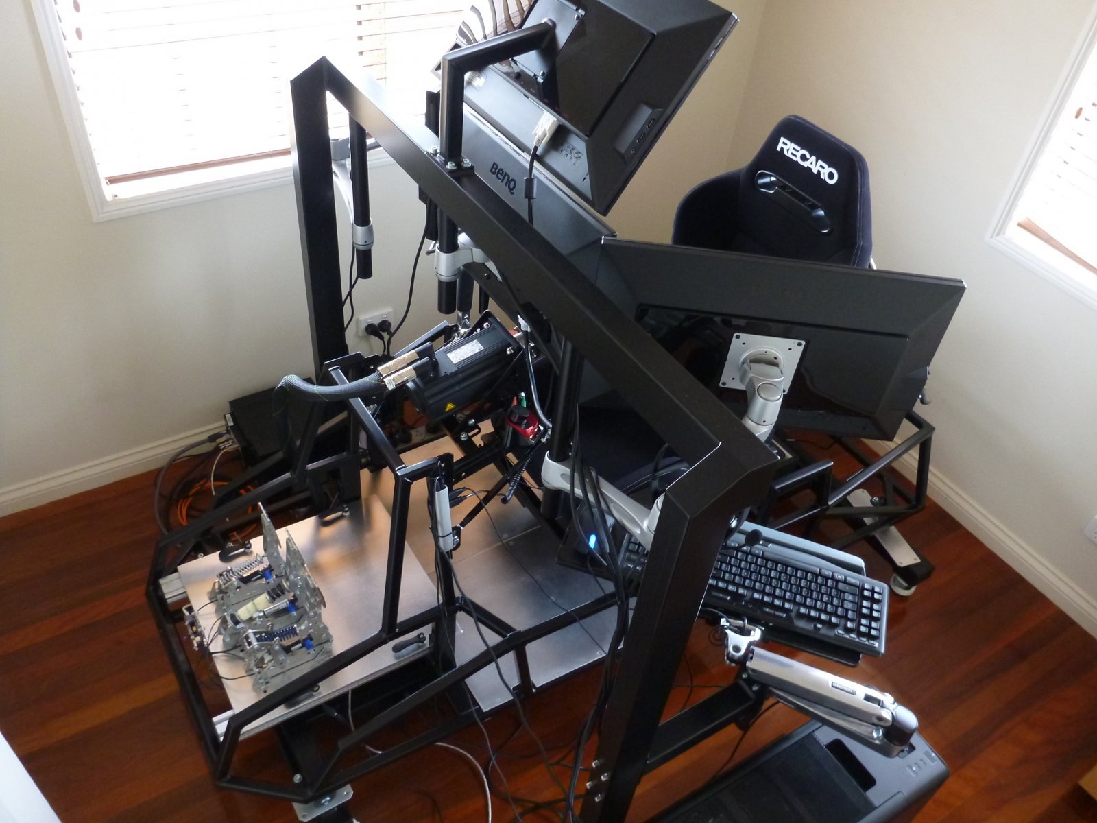

    The quad monitor stand is done as well.

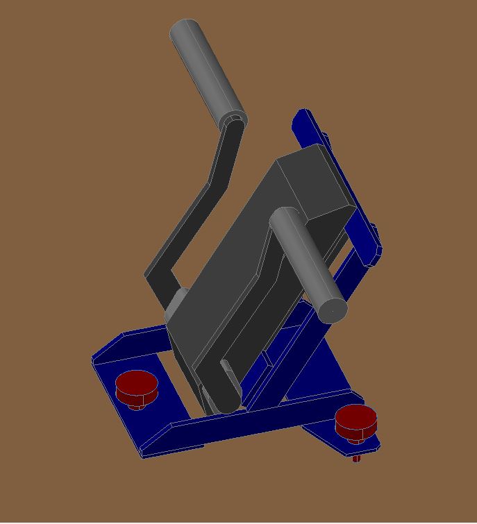

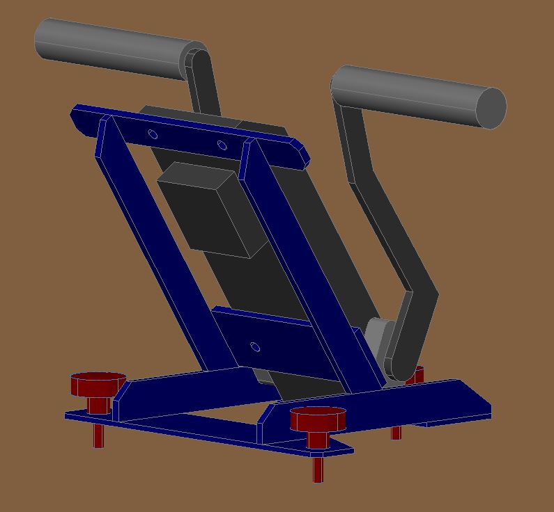

    That is the flight sim rudder I'm using:
    http://vkb-sim.pro/T-Rudder-MkIII/index.php

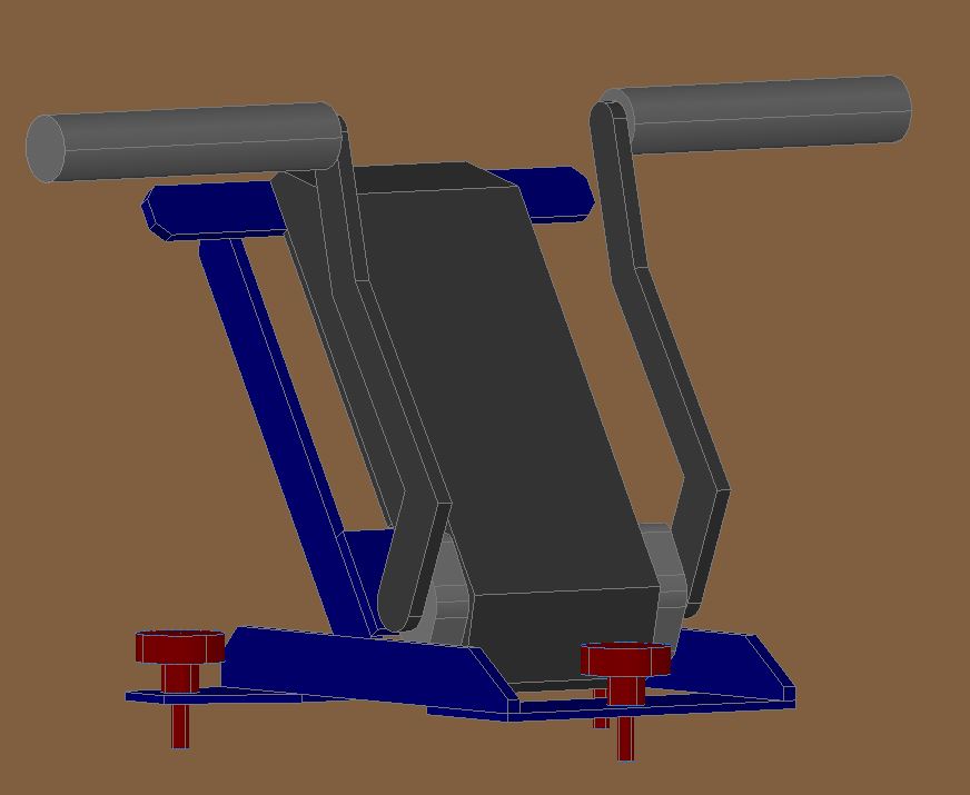

    My pedal plate is quite high in reference to the seat, so I had to work out a diy bracket for it. I put it on an angle of 57.5°.
    I'm using thumb screws to fix the rudder to the pedal plate temporarily while in flight sim mode.
    Here we go - the design :)
    Cheers

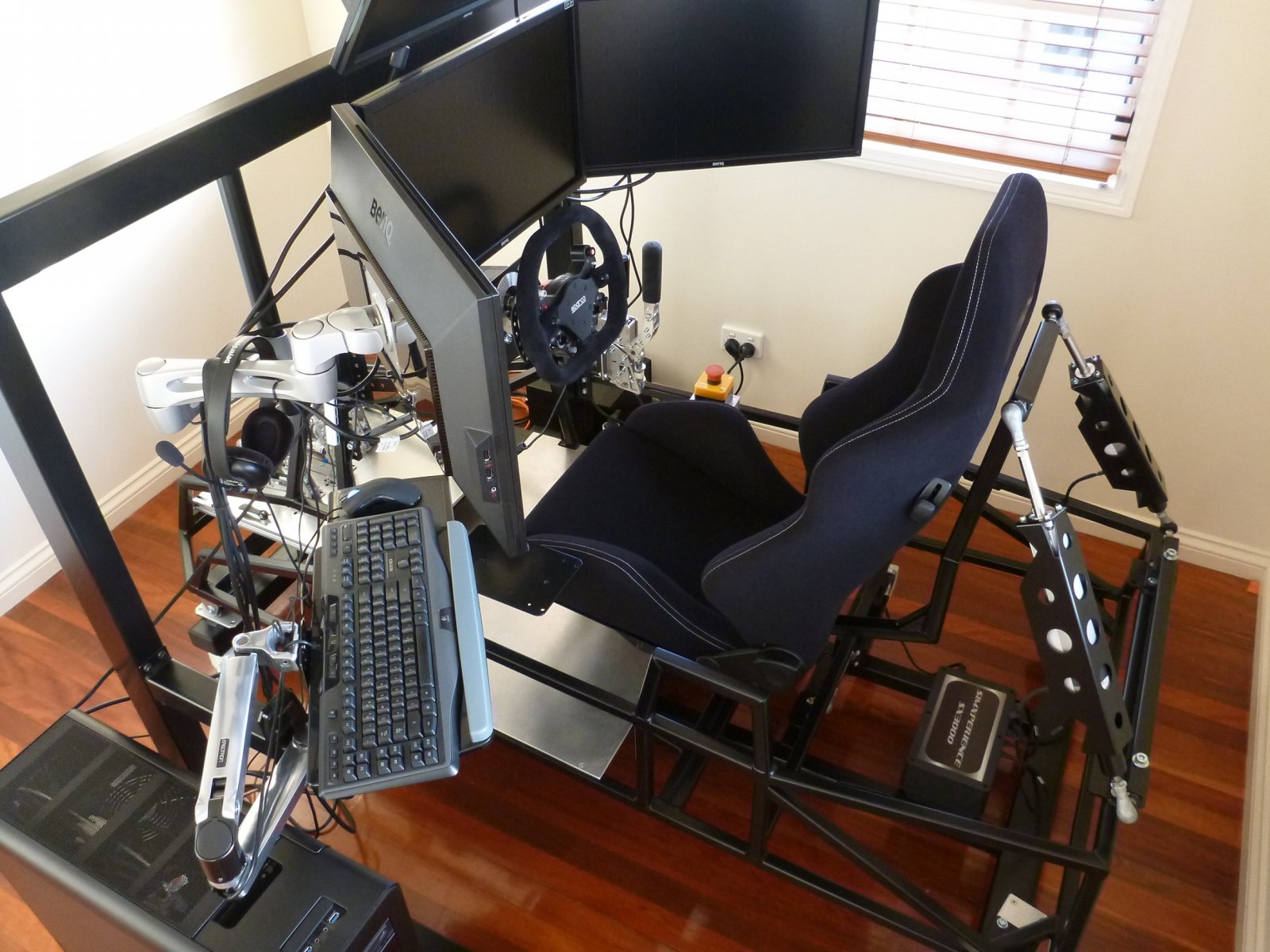

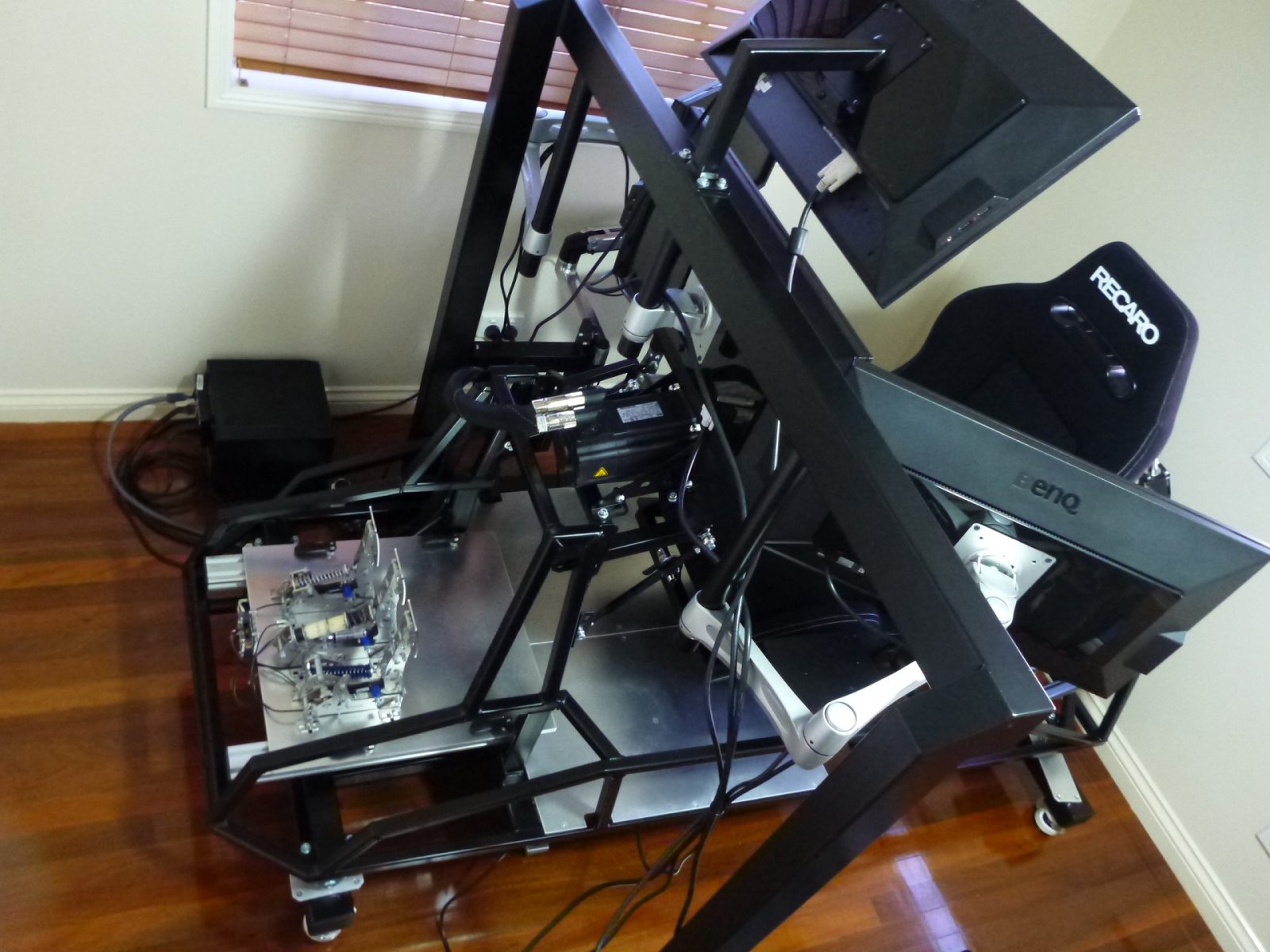

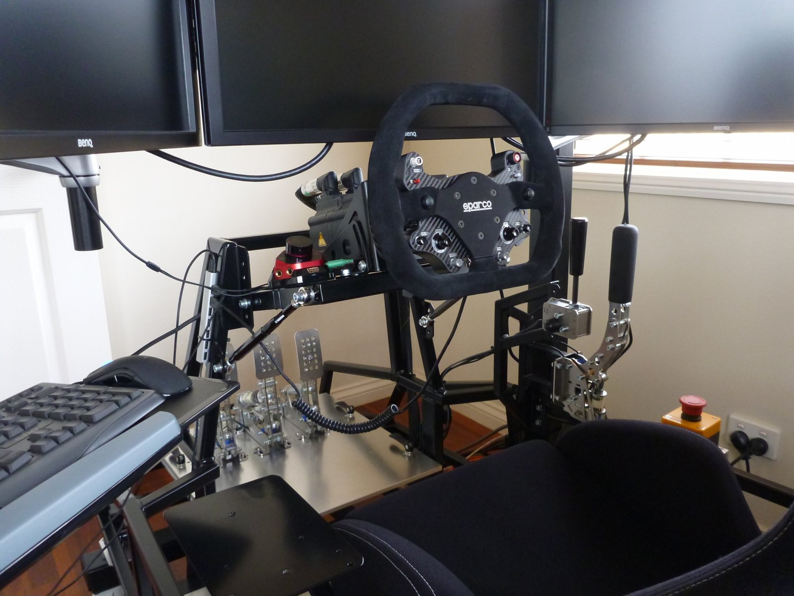

    Tada! :)
    • Like Like x 7
  16. noorbeast
    22,185
    154,750Coins
    +11,196 / 57 / -2
    Brilliant detail, well done :grin

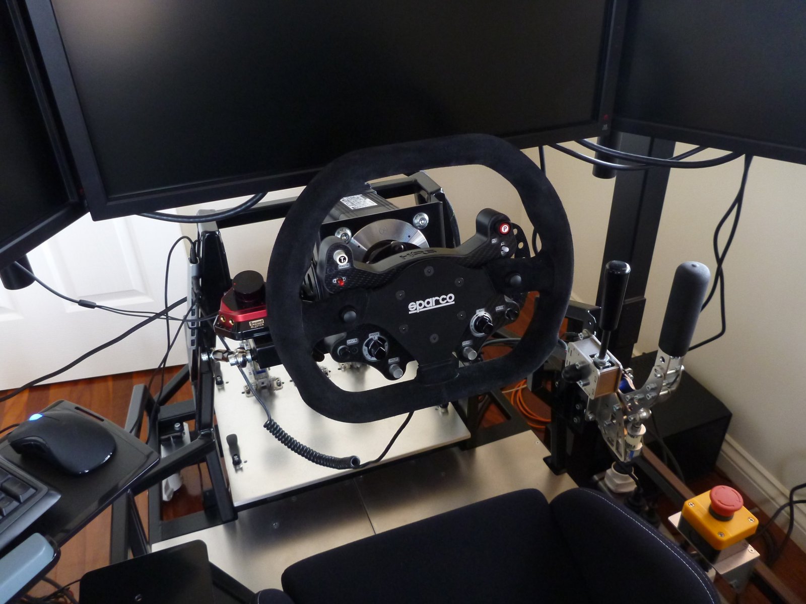

    I really like the adjustable screen arms and keyboard mount, what brand are they?

    Yeah, that's really good quality stuff.
    That Ergotron keyboard tray was the only one I found which is adjustable in height. However, just recently I noticed a similar one in a Jaycar store. That one was around $80-90 if I remember correctly. It's probably not quite as good, but the chances are not too bad it will do the job ok...too late for me unfortunately.

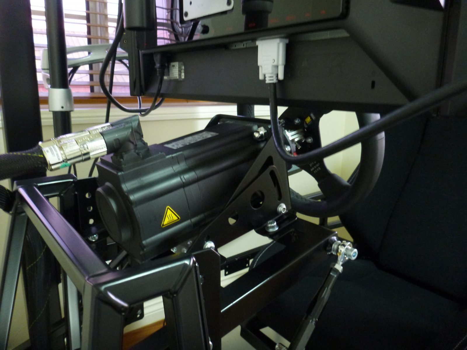

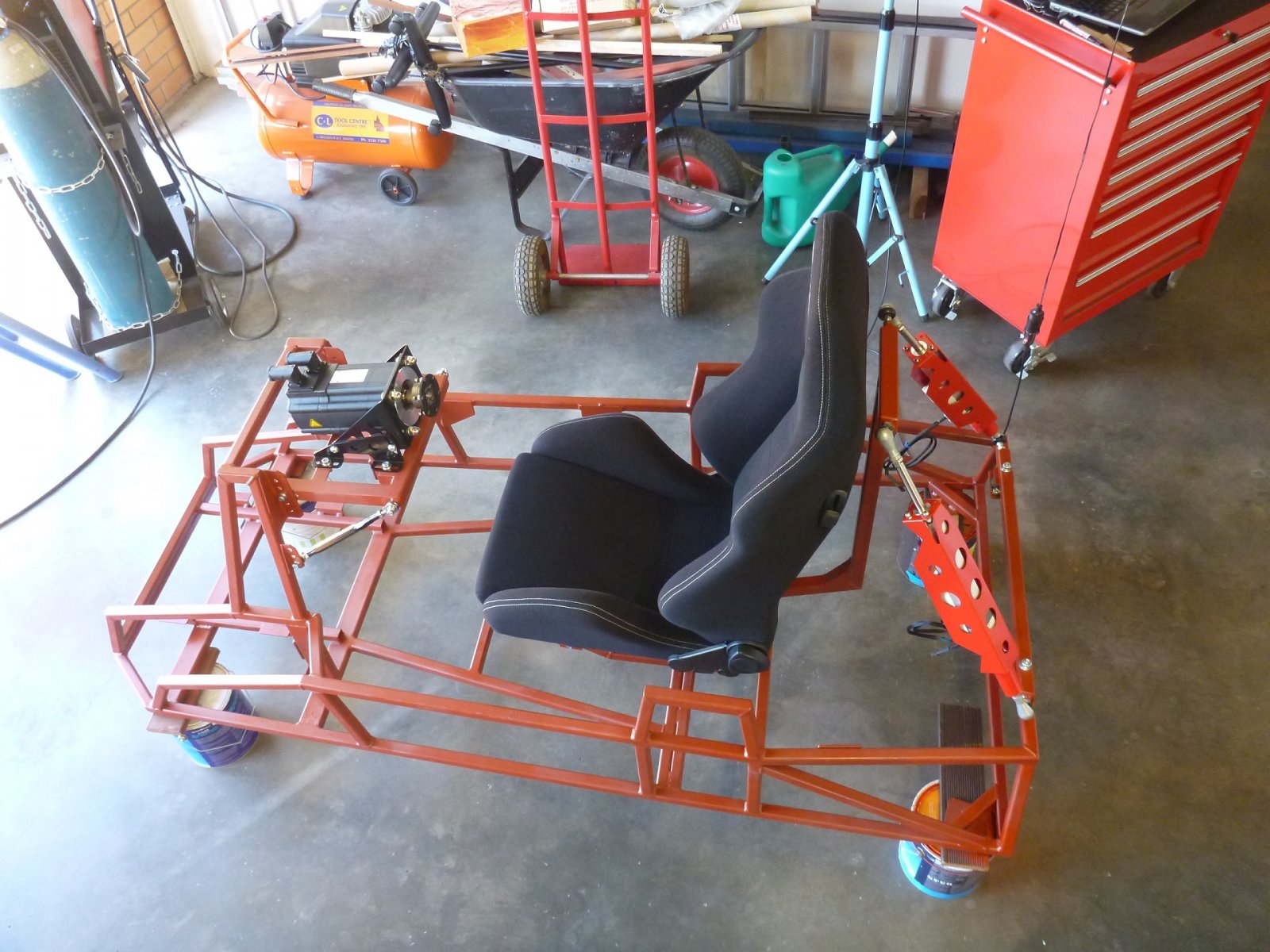

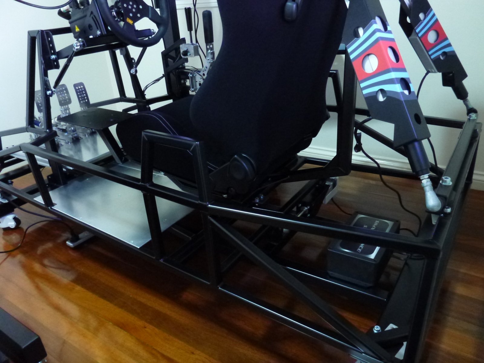

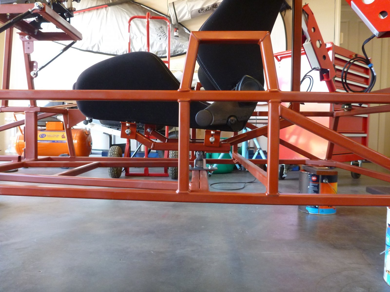

    There's a problem with the seating position, it was too upright. So I had to make some modifications. Apart from that I switched to a cardan u-joint.
    The flight stick will be permanently mounted on the right hand side on the seat frame.
    Here some pics:
