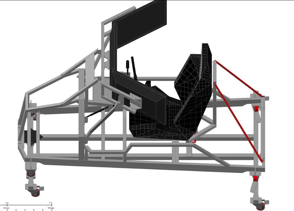

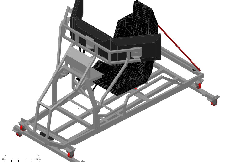

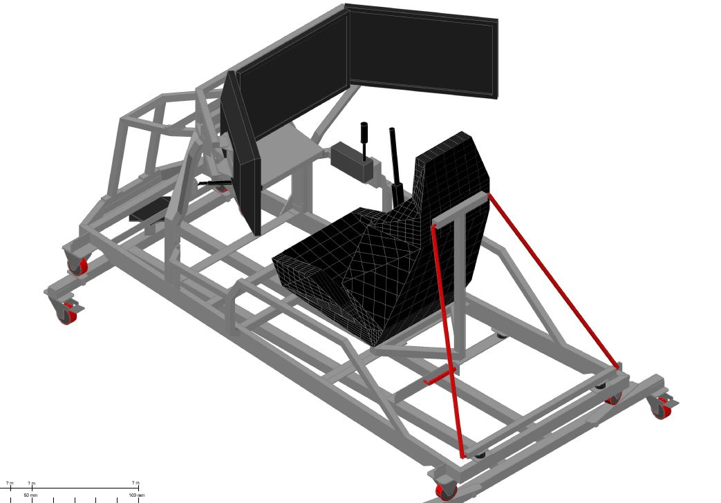

    Phew, done...finally:)
    Here's what it's gonna look like - really don't wanna change it again:
    It's wider now - exactly 80mm more than previously - in length and width pretty much the size of a SimX stage 5.
    It took me ages to work this out. You see the triple screen bracket/frame has quite a bit of leverage and that was a bit concerning and a challenge for me to get designed so there won't be any wobble when rear traction loss occurs...hopefully.
    The floor of the top frame in front of the seat is gonna be covered with aluminium plates.
    What's your opinion - you think it's all right and gonna work?
    I've got 3 150SCN5's and almost regret a bit not saving the money and go for dc motors like bsft suggested. However, I think they will do a great job for the seat mover. The thing I'm still a bit concerned about is using a SCN5 for the rear traction loss component. Someone, who I believe knows much more about motion rigs than me, said on another forum these SCN5's are only good for loads of up to 5kg. I was very surprise about that. I mean my rig is big and pretty heavy as well. I'm using a good bearing at the front pivot and good quality castors with a proper bearings so I'm confident it will move pretty easily sideways with very little friction. It's still a lot of weight to rapidly accelerate and slow down and I'm a bit concerned that a SCN5 might struggle to cope with that. Do you have any idea - is a SCN6 more suitable for a big rig?
    Cheers

    Nice to see your progress!
    (I don't know SCN5...)
    Maybe the structure below your rear rollers should be reinforced.
    Or bent your tube and weld a bracket on top of it?
  6. bsft
    SCN6 will work as they handle more, 20 kg I think. But at nearly $800 each, thats alotta dough.
    Design looks good though. If you are buying SCN from Simx, send the pic to him and ask if its right.
    Otherwise, anyone else here able to advise?
    DC motors good for seat mover to full frame, depending on design. Same with Actuators, design is the key.
    Personally I would like to try SCN actuators , but I do not have that sort of cash, so DC motors for me.
    Cheers and go hard.

    As long as it supports the weight nicely , cant see an issue plus mount a rubber dampener in between the base frame and the scn5 , this will take any vibrations away from the body of the scn5 and help with the shock load from repeative fast movements, mate. His never built an SCN5 system. I have built 2 SimX copies , 4 years on still going hard.

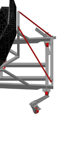

    RacingMat, I'm not sure what exactly might have to be reinforced. I've created another iso which might clarify things.
    There's a that flat steel bit welded on the square tube of the base frame and I've got 2 little supports either side of the tube. I think that's what you're talking about.
    the lat steel is actually a bit longer that the max. range of the wheel. At least 50% of the wheel will be on top of the square steel tube at all times.
    Can you let me know if you see a possible issue?

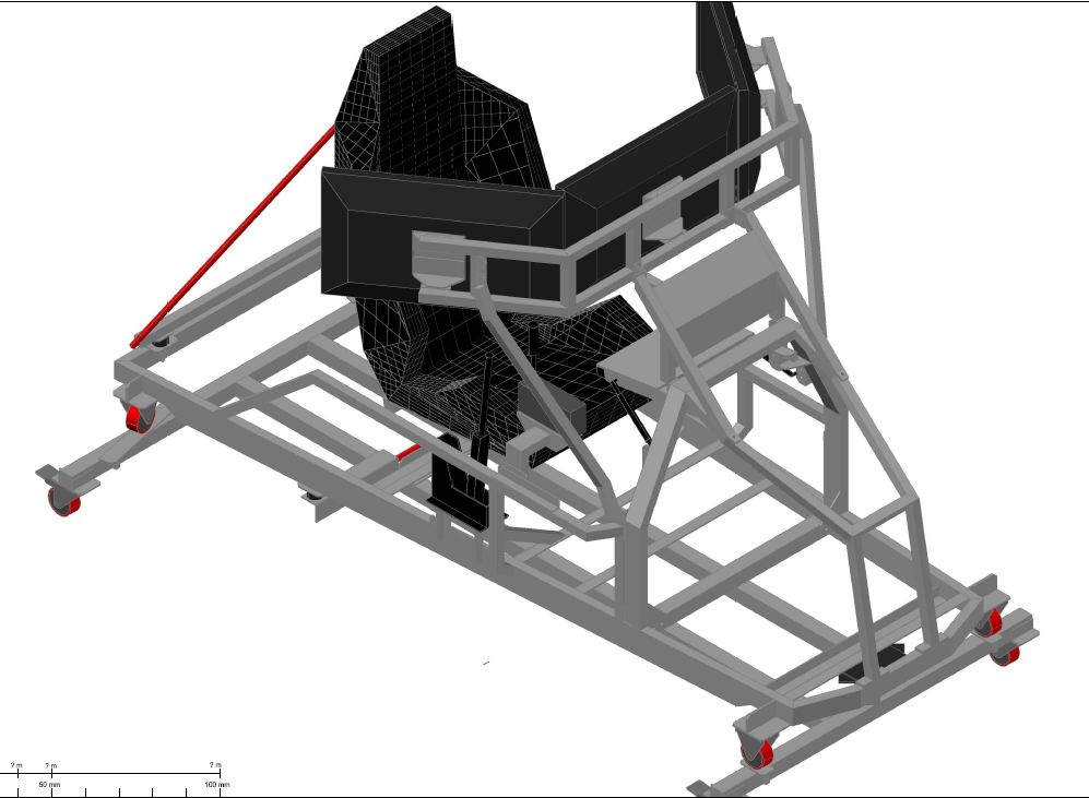

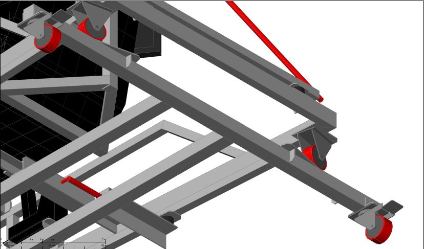

    This iso shows the underside of the rig:
    Cheers
  9. eaorobbie
    20,502Coins
    +1,687 / 23 / -2
    Looks good , I noticed the rubber dampeners, think that's what it is. A must with scn5 units.
    On the other hand a channel so the wheels don't turn and slip off the flat bar mate might help, if the casters can still turn 360 deg.
    One of the best designs I have seen in a long time, well thought out.

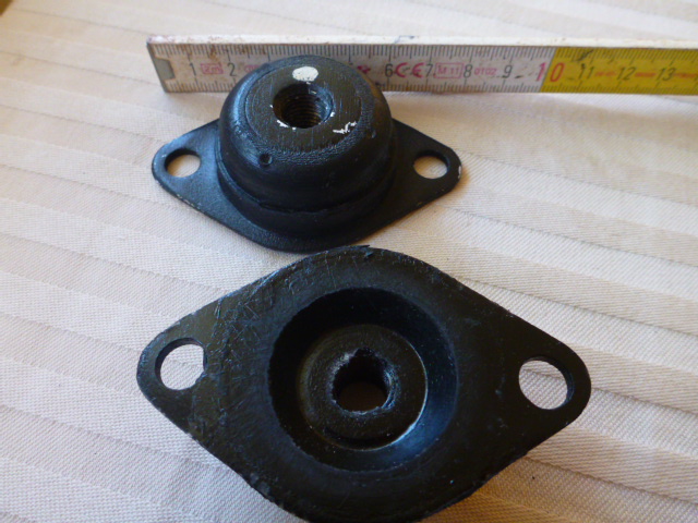

    Yes, I'm using these shear compression mounts (pretty expensive: $30 each):
    The iso above shows actually a bit better where they are.
    The castors between base frame and top frame (moving) are fixed on an angle depending on the distance to the pivot at the front. Only the castors under the base frame are rotating. Each of them has a max load of 110kg.
    Cheers

    Mounts will save a lot of tears, later on mate, they do work well, in suppression of vibrations as the scn5 can vibrate very well indeed. We actually use the same unit for mounting single piston engine motors on farm machinery. So they don't shake the frame apart. Worth the expense, you will also note SimX uses a similar damper on the ends of the mount for the scn5 for the same purpose.

    2,233
    21,082Coins
    @Thirsty : yes, it's this detail!
    If you bent the tube, you will spare these 2 kits of 3 little pieces ;-)
    Big diameter wheel will give you smooth movment.

    Cheers for taking the time to check my design. I don't have the tools to bend tubes, but I actually considered a kink in that tube before right in the centre and align them with the track of the wheels in that section.
    I dismissed it because I didn't want a weld in that tube. Not that I don't trust my welds, but I just feel better just having one continuous tube there. Agreed, it's a bit of fiddling around, but it's the best solution I could work out.
    Cheers

    I calced the weight of the rig. Just the steel will be approx. 90kg. Seat, screens, actuators and all the rest of the gear will add another 45-50kg which makes it 140kg without driver.
    Priority when designing was functionality stability and the looks of it. It would be possible to reduce the weight a bit, but that would make the rig look less good imo.
    I wonder what's your opinion - would you try to reduce the weight a bit (I think it might be possible to reduce it by 10-15kg) or do you think it doesn't really matter?
    Any ideas or suggestions would be much appreciated:)
  17. eaorobbie
    20,502Coins
    +1,687 / 23 / -2
    Weight shouldnt be an issue , it is a Seatmover on a tracation loss frame, so the std 2 scn5 will be fine driving the seat and a person. And the third is only push pulling a frame that is support with casters with bearings , so very little force should be needed to turn the frame. I hope I have understood your frame, please correct me if im wrong, sorry

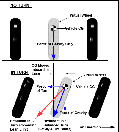

    Is your project finished? If I am understand things correctly your idea seem much like mine that I want to build. Basically a 2DOF seat mounted on top of a platform so it can sway.
    If casters are a problem (which I can see them being. Since they have to stop and "spin" 180 degrees before starting again) Then I was considering using roller blade wheels and mounting them at a ~60-75 degree angle. The wheels will not have to "spin"
    The Idea can from the principle of motorcycle riding. as it leans it turns
