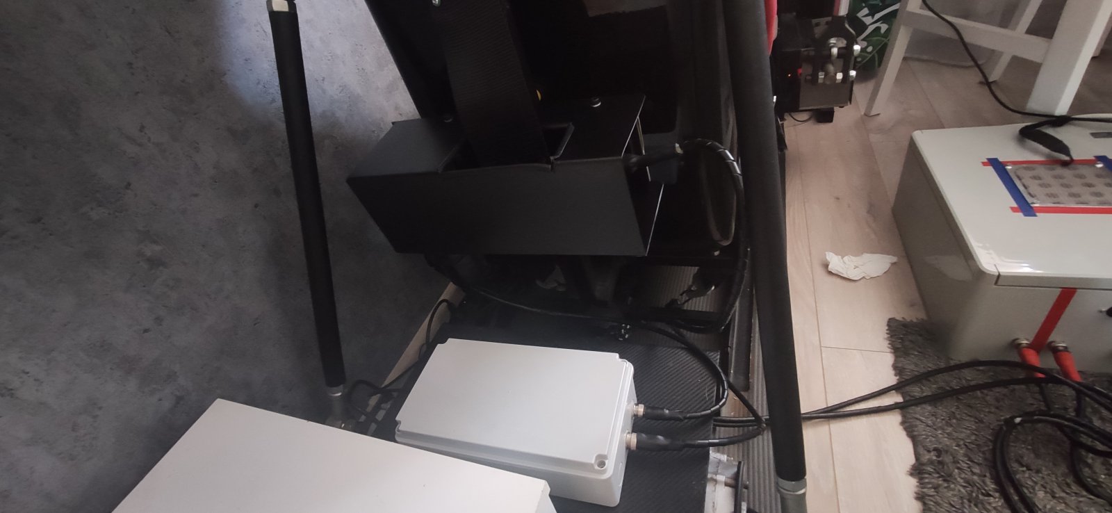

    Hi my belt tensioner working well. It's must have thing when u have sim tools for racing for me. Another immersive job done

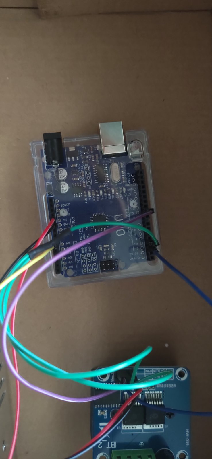

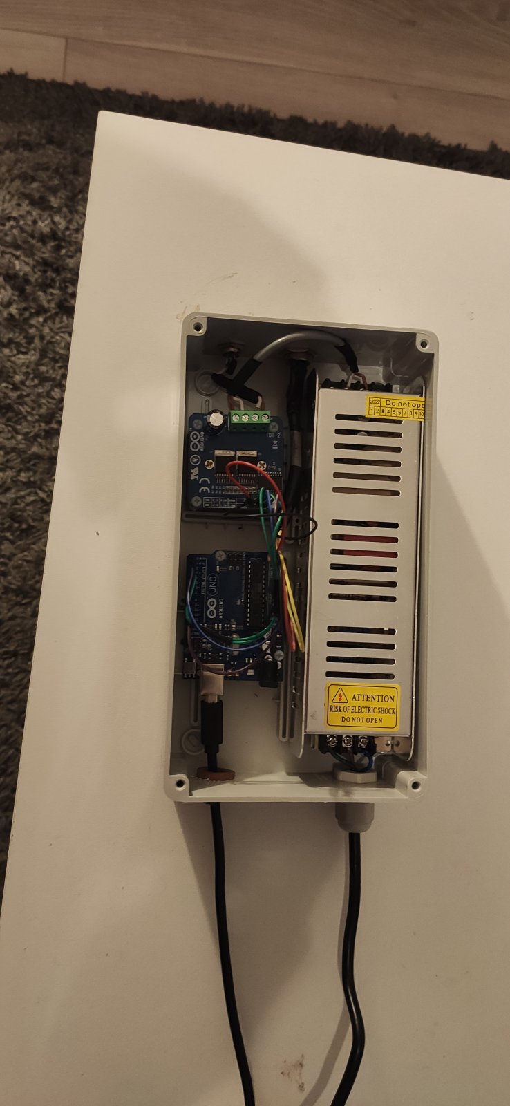

    Hi. I wonder what motor to use. How much watt must be for it to work efficiently and at the same time the engine was not too big
    @noorbeast can u look at this?
    https://a.aliexpress.com/_mPRRyUK
    Will this work with the h-bridge controller?

    Hi after summer I start with this belt tensioner on smc3 code. I have a question. I have 2dof on smc3. Do I neet to add another axis to this code, or I can use another interface?

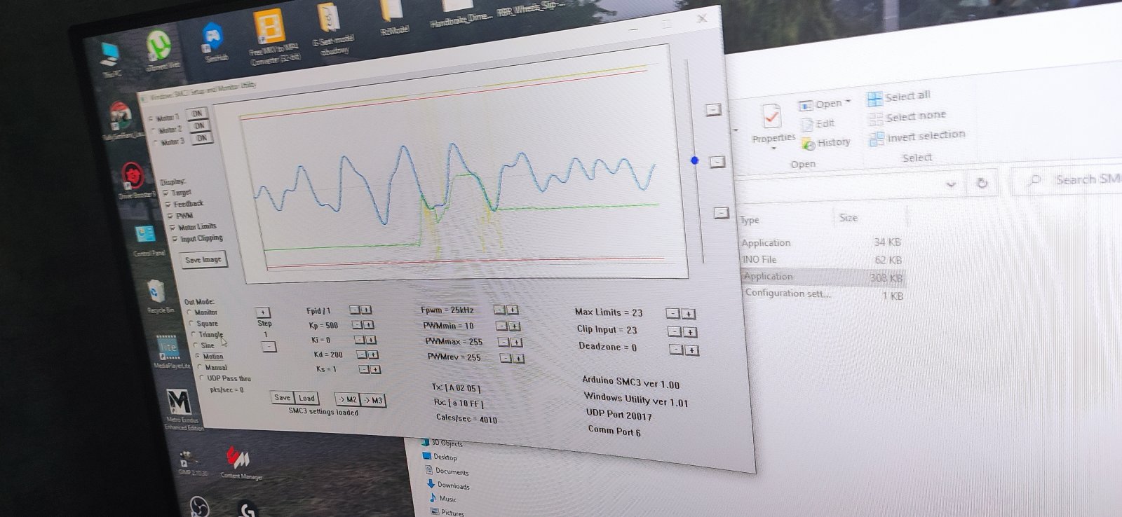

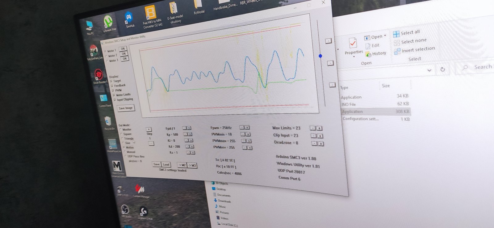

    So the middle point is moving down when the signal is on it and don't returning to the center point

    I try to connect motor to my 2dof and see what will happen and what I have is changing dorection when the middle point is reached but turning all the way and changing direction only. Maybe i can't write it properly becouse lack of English words bu I have film. :
    @noorbeast can u give me some advice?
    On sim tools it doesn't work at all
    22,049
    153,890Coins
    +11,154 / 57 / -2
    The pot needs to have a bracket to fix it in position.

    OK but I hold it by myself for test

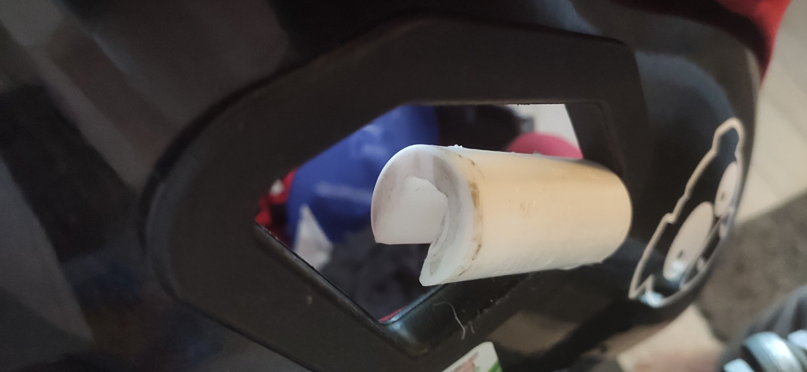

    Hi I have this motor :
    brush motor: 12V
    power: 120W
    no-load speed: 3350 RPM
    RPM under load: 2500 RPM
    no-load current: 1,2 A
    current under load: 15,4 A
    torque 0.46 N.m.
    motors include a roller.
    S2 operation type
    I see it's to weak for me. I have Pwmax 255 and don't have enough power to take belt. Is it posibble? Is it foult of smal torque? @noorbeast

    I made my belt tensioner. Also add some cheap solution sliders (working well) I had a problem because on tests it often worked fine and when I hooked it up to the rig it started to go crazy. In addition, I tested several motors and it turned out that the motor without a gearbox even though it has 150 watts is not suitable for this. The biggest problem I had was a faulty usb card that I have on the motherboard. Some worked some didn't, so the worst. When I noticed my problems were solved
